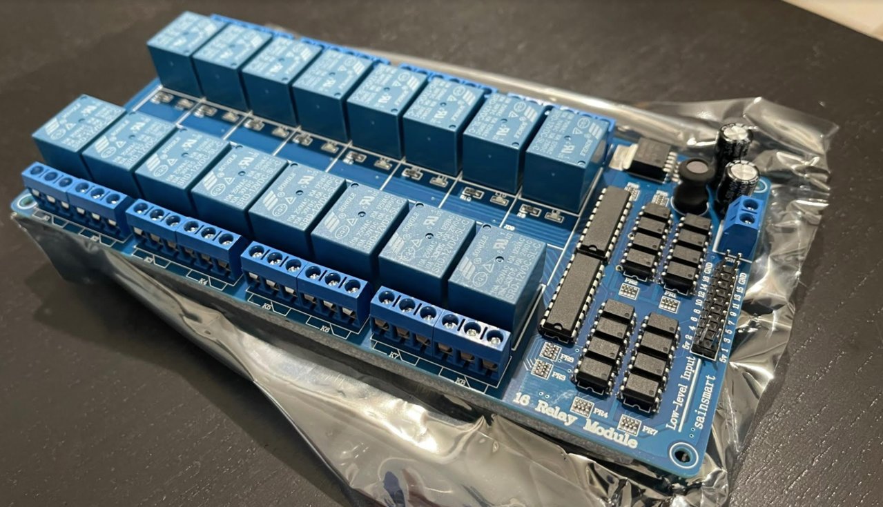

    So I bought a 16 relay board
    This weekend I will attempt to hack the 4WD ECU and the Transfer Case actuator. The goal is to trick the truck into thinking it's in 2WD while I manually shift it into 4WD.
    Why? My truck has not been shifting when in 4LO, it's stuck in first gear, but shifts fine when in 2WD or 4HI. Also, when in 2WD everybody here knows that the Tow Haul Mode button gives the truck some extra oomph when the ECM shifts the throttle angle more open by a few degrees. However, the Tow Haul Mode is disabled when you go into 4WD.
    I will hopefully be solving two problems at once 1) shifting issue in 4LO and 2) torque issues when crawling big obstacles.
    Through an Arduino the relay board will be used to disconnect certain pins on the wire harness between the 4WD ECU and the Actuator so that the actuator is unable to notify the ECU, via internal trigger switch position changes, that voltages have changed. I will also configure it so that the relays apply power to rotate the actuator motor that shifts in/out of 4HI/4LO. There are still a couple of unknowns that I need to figure out but won't know until I start chopping shit.
    :fingerscrossed:

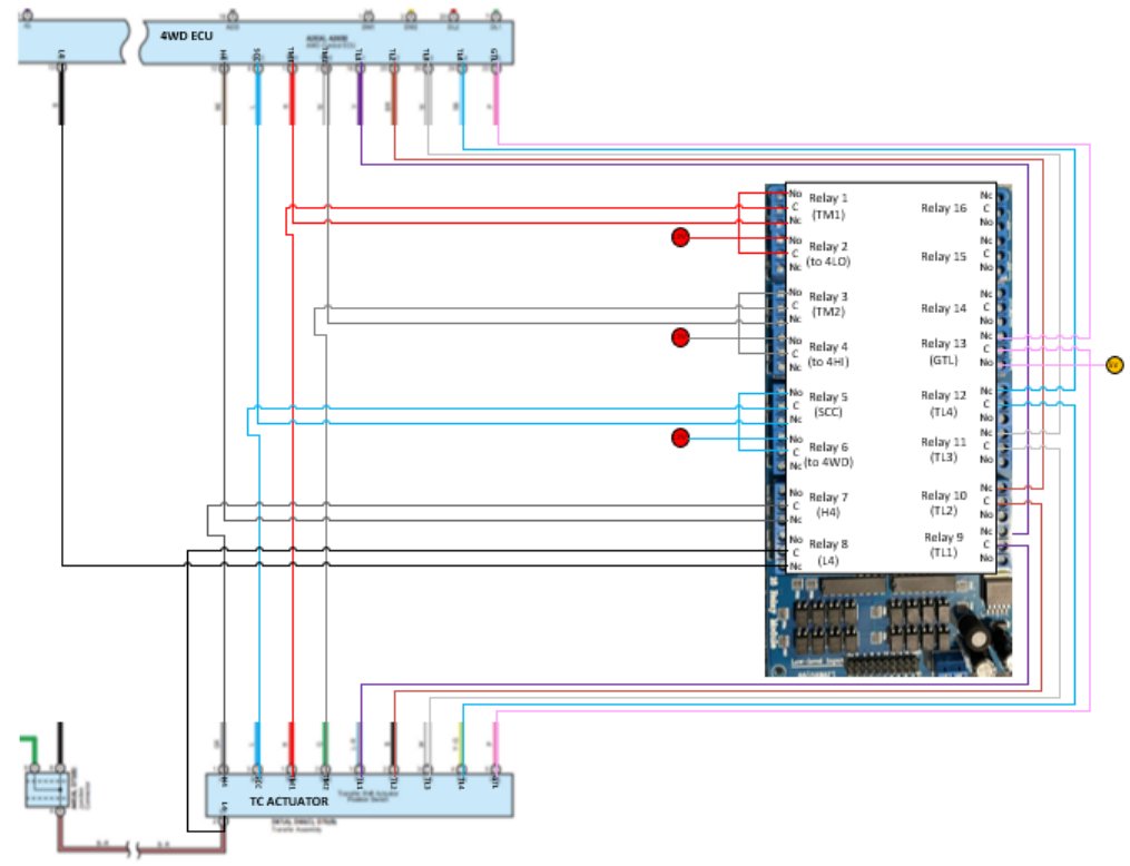

    Here's my initial wiring plan. I just need to figure out how TL1-TL4 works with the actuator motor (TM1/TM2) and the Solenoid Coil (SCC). I want to automate as much as possible so I'm hoping that I can use TL1-TL4 as a trigger to stop applying voltage to the motor and coil. Won't know until I get in there.

    looks like you have been and still have some signal chasing to do.
    Cruzer[QUOTED][OP] likes this.
  16. Mar 2, 2023 at 7:57 AM
    #1036
    SAGE63
    Dec 9, 2020
    #55939
    3,676
    San Diego County
    Cruz just ignorant curiosity, are you just transferring signals or actual power? if power I understand the relays but if digital signals why not a smaller pcb utilizing and gate ICs and remove the potential for sticking relays
    eccracer104 likes this.

    The relays are definitely needed to operate the motors and coil. I could probably use ICs for the other pins but this board is the quick and dirty version for me. If this works, then I may have to pick your brain at T2S to figure out how to shrink this :D

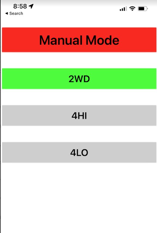

    9 out of 10 pins tricked! I'm thinking I can ignore this last pin to SCC. So I'm moving forward. I'm writing up the code to create an app that will change the modes. Pretty basic, looks like this. Hoping I can do a test drive tomorrow.

    What does manual mode do?
  24. Mar 18, 2023 at 9:14 PM
    #1044
    Cruzer
    Cruzer [OP] Wheeling Full Size
    Oct 12, 2020
    #53461
    3,249
    Cruz
    Sunnyvale, CA
    Build Page: Cruzer's Re-Build for the Rubicon
    That's when relays are triggered prior to ignition start to trick the ECU that it's in 2wd. When I manually change to 4hi or 4lo, the ECU will still think it's in 2wd.
