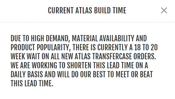

    I’m going to make my own adapter out of aluminum block. I’m also getting a custom spud shaft made as well because apparently nobody makes a 22 female Toyota spline to a 23 male Mopar spline adapter.
    I plan to remove the stock TC a couple times prior to installing the Atlas. Once to measure how far the adapter sticks out from the tranny bell housing and to measure the size of the sheer pins. The second time will be to actually get started on making the adapter. Third time will be for the swap.

    Terry
    Redding, CA
    2019 Platinum
    5100s, Icon Rebounds, Maxxis Razors
    That's crazy that you cannot find an adapter !

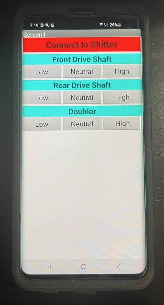

    I previously mentioned that I wanted to hide the triple stick Atlas Transfer Case shifters in the center console so that the :ballchain: doesn't see it. Well, I looked underneath the truck and found out that the transmission cable goes right under the center console, which means I cannot cut a hole to install the shifters there. Looked for other potential spots but couldn't find anything that could easily hide the sticks.
    :monocle:
    So I looked online and found someone that used pneumatics to shift their transfer case but after digging into it a bit it looked very complicated.
    :monocle:
    Then I started looking into servos. Found out that robotic servos can generate a lot of force. One thing led to another and now I'm thinking of using 3 servos instead of triple sticks that will be housed in a weatherproof box that uses a bluetooth trigger.
    :yes:
    I was able to create an Android app, a very simple one, that will send signals to the servo controller via bluetooth
    Each button I press will rotate an arm connected to the servo, which will slide the collar into low, neutral, or high gear.
    Just waiting on the servos and equipment so that I can test it.
  24. Oct 5, 2022 at 8:03 PM
    #894
    Yzed608
    Yzed608 New Member
    Jul 1, 2017
    #8351
    981
    Wisconsin
    Now that's thinkin outside the box. Looking forward to see how it progresses!

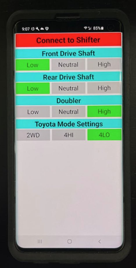

    I might get carried away with this app thing. Added buttons so that when I turn the Tundra 4Hi/4Lo/2wd dial I can press the corresponding button on the app to configure whatever relays I put in place to trick the ECU into thinking the OEM TC is in the correct mode, which would enable/disable nannies accordingly.

    You made that whole thing? You gotta give us some more details on it!
  30. Oct 10, 2022 at 7:58 PM
    #900
    Cruzer
    Cruzer [OP] Wheeling Full Size
    Oct 12, 2020
    #53461
    3,249
    Cruz
    Sunnyvale, CA
    Build Page: Cruzer's Re-Build for the Rubicon
    Nothing fancy really. I have an Arduino UNO with a 16 servo shield and an HC-05 Bluetooth module. I wrote the code so that each button on the app sends a unique digit. I have 12 buttons so numbers 1-12 can be sent over BT. When the Arduino receives a number I programmed it to rotate to a specific degree. For example, if button 2 is pressed, the number 2 is sent over BT, which translates to 180 degrees.
    The tricky part will be figuring out where to put these guys. Right now I'm back to thinking of sticking them into the center console where I would only need to drill 3 holes to get the servo shafts to poke through. This will keep the electronics out of the elements.
