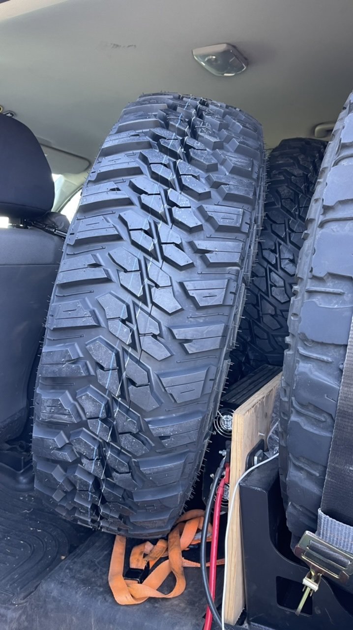

    The Kanati Mudhog MT 39x12.50r17 tires that I won at the T2S raffle back in April is finally shipping! Still waiting for the wheels though. And I'm still waiting on the 40" Mickey Thompson Baja Pro XS tires that I ordered back in March.....baby steps.
    Will use these as my street tires.

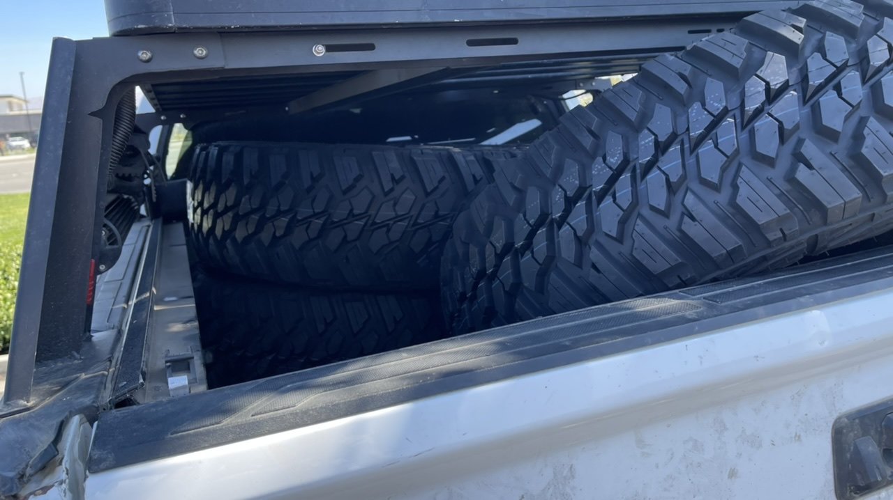

    Getting stuffy in here:

    Where does the food er...alchol...fit
    How many tires you got in there?
    Cruzer[QUOTED][OP] likes this.
  5. Sep 1, 2022 at 1:16 PM
    #845
    des2mtn
    Jul 1, 2020
    #48721
    4,664
    SW
    2004 Black DC Limited 4x4
    Tonto cover
    I'm wondering how he sleeps because apparently his driver's seat is his bed.

    If you drink enough you can sleep pretty much anywhere.

    Does discount tires see you coming and tries to just close the roll up doors at this point

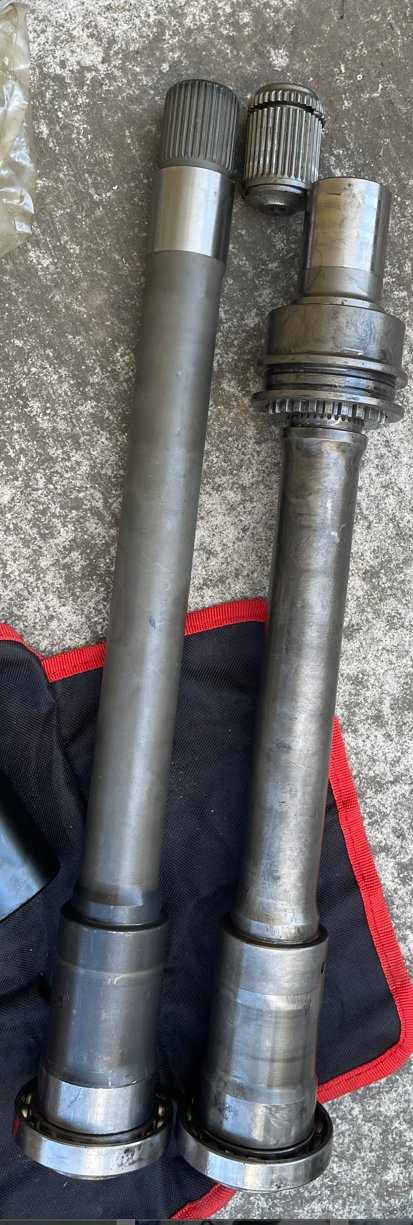

    Sooooooo. I took apart my spare front diff, did a size comparison and test fit with the bearings and fits perfectly! :yes:
    The side by side comparison shows the Tundra intermediate shaft + collar + (broken) stub shaft. Will try to install it this weekend :)
