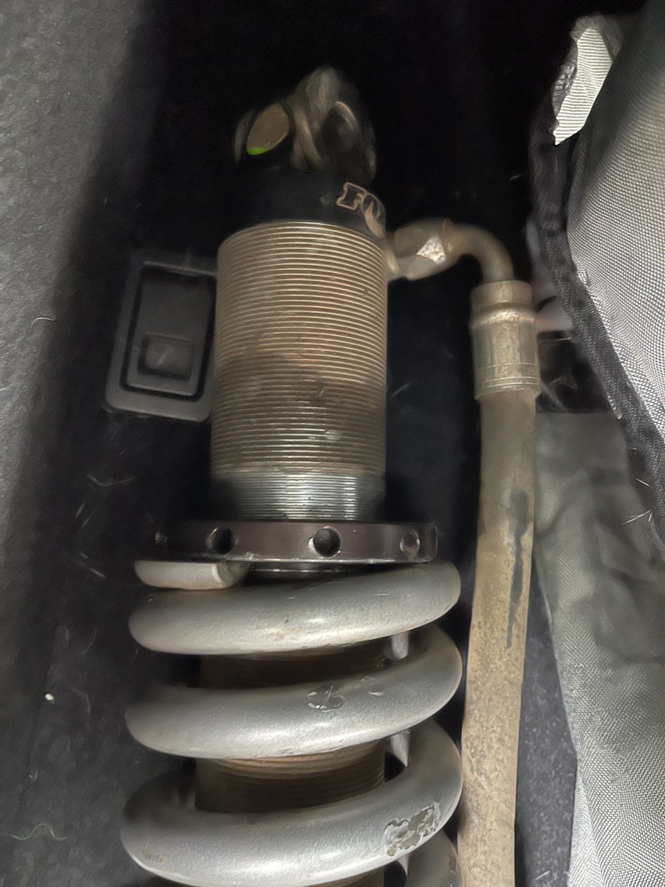

    Found out the hard and annoying way that those spring compressors you rent at Orielly suck balls - like real big ones! Now I have to take the whole thing to a shop, just to adjust the driver side preload to level it out to compensate for all the additional weight on the driver side.
    Kiddnapped Tundra, des2mtn and Hbjeff like this.
  11. Nov 14, 2021 at 6:37 PM
    #491
    Trdwillie14
    Trdwillie14 New Member
    Sep 23, 2018
    #19743
    2,233
    Billy
    2014 trd off road
    2.5 fox 2.5 ads triple bypass T/C uppers Nfab front bumper Westin rear Bajas Rci skids All pro sliders Icon rxt leafs Stt pros Method 701s 37 Mickey Thompson
    That’s a ton of preload.
    wexttxco and Cruzer[QUOTED][OP] like this.

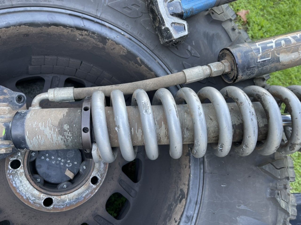

    I tried messing around with those spring compressors once before realizing it wasn't going to work. It's almost like a rite of passage on here :rofl:
    I don't know as much about the newer trucks and stuff... so please pardon my ignorance if this doesn't apply. The adjustment collar on my Kings have a similar design; when I'd try to adjust the preload with them on the truck, my tools would contact the UCA and make it impossible to turn. If I disconnect the spindle from the LBJ, I can jack the spindle and UCA up by the lugs and get them out of the way, then get my tools on the shock to turn the collar.
    Of course this doesn't work for fine tuning the height where the pinch bolt might be hidden on the frame side of the shock tower...
    Cruzer[QUOTED][OP] likes this.

    That picture shows 3” but it was originally at 3.5” and I’m trying to get to 4”. When I loosened the collar it jumped the thread.

    I have the fox tool
    If you need it. I have like 3 inches and it’s 4 threads

    That makes sense and should be applicable to my truck except I don’t have the spanning tool :rofl: I read somewhere I could turn the collar with basically a screwdriver in the holes - NOT. Too much preload, too much tension.
    FrenchToasty and des2mtn[QUOTED] like this.

    I have a 7” lift up front :D My coilovers originally came with 3.5” of thread showing so since it’s sagging on the driver side, adding more preload should level it out.
