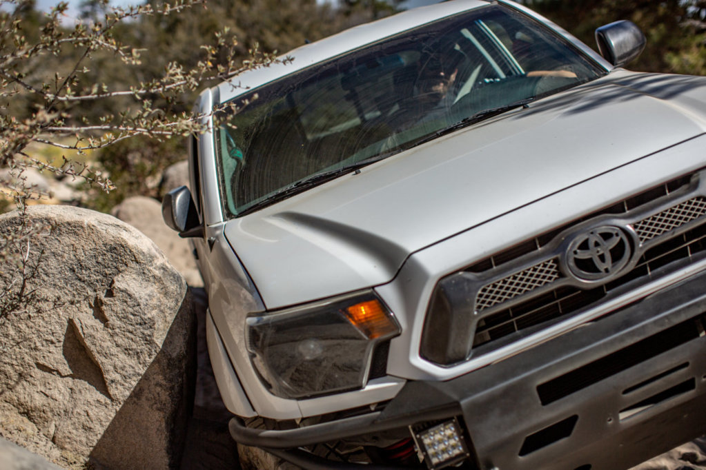

    I obviously haven’t done it in the Tundra yet, but did it in my Tacoma on 33” tires and mid travel.
    Rear locker was a requirement. Big ass boulder, I hugged as tight to the wall as possible and with some luck was able to make it over without too much of a fight.

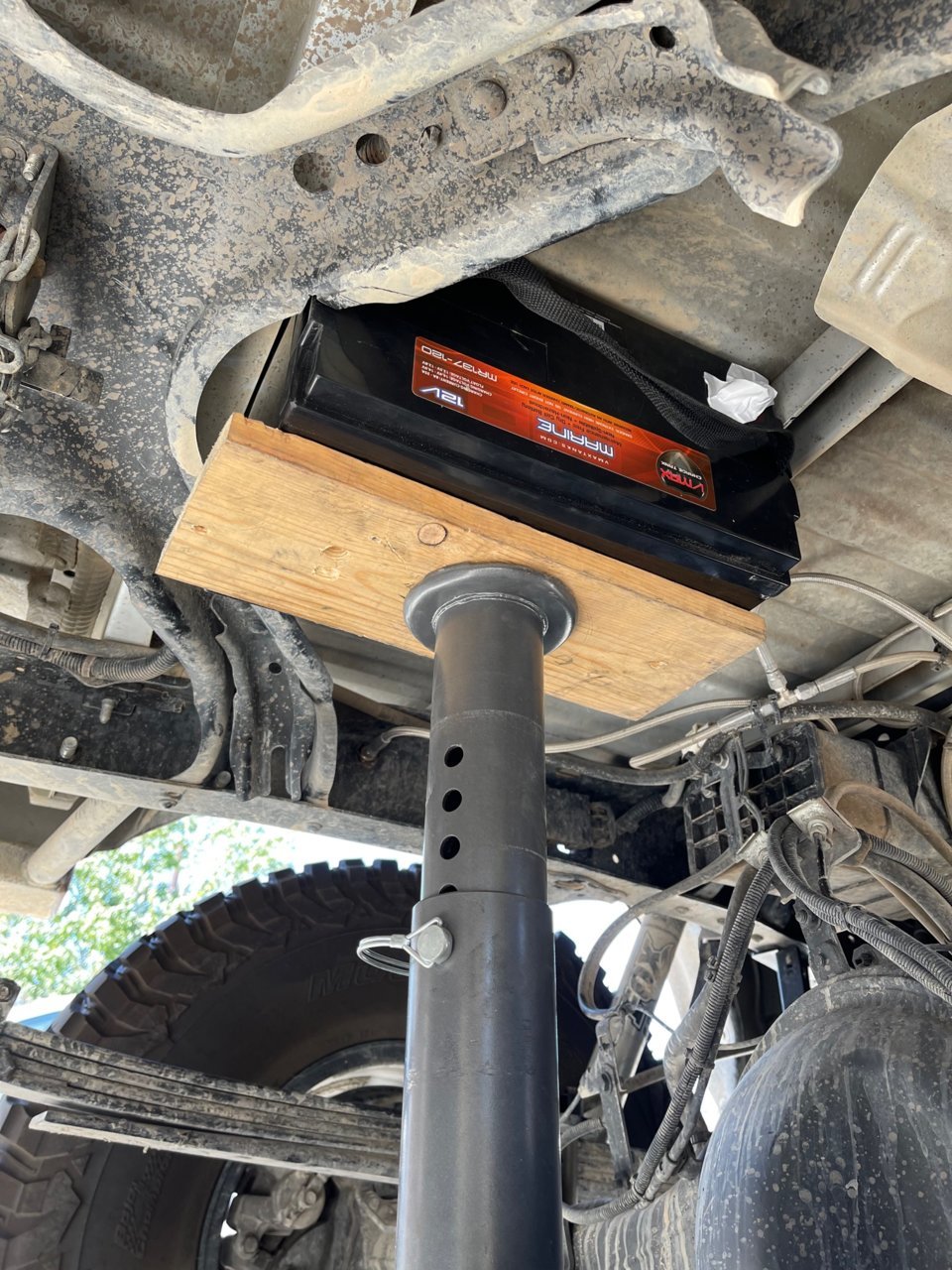

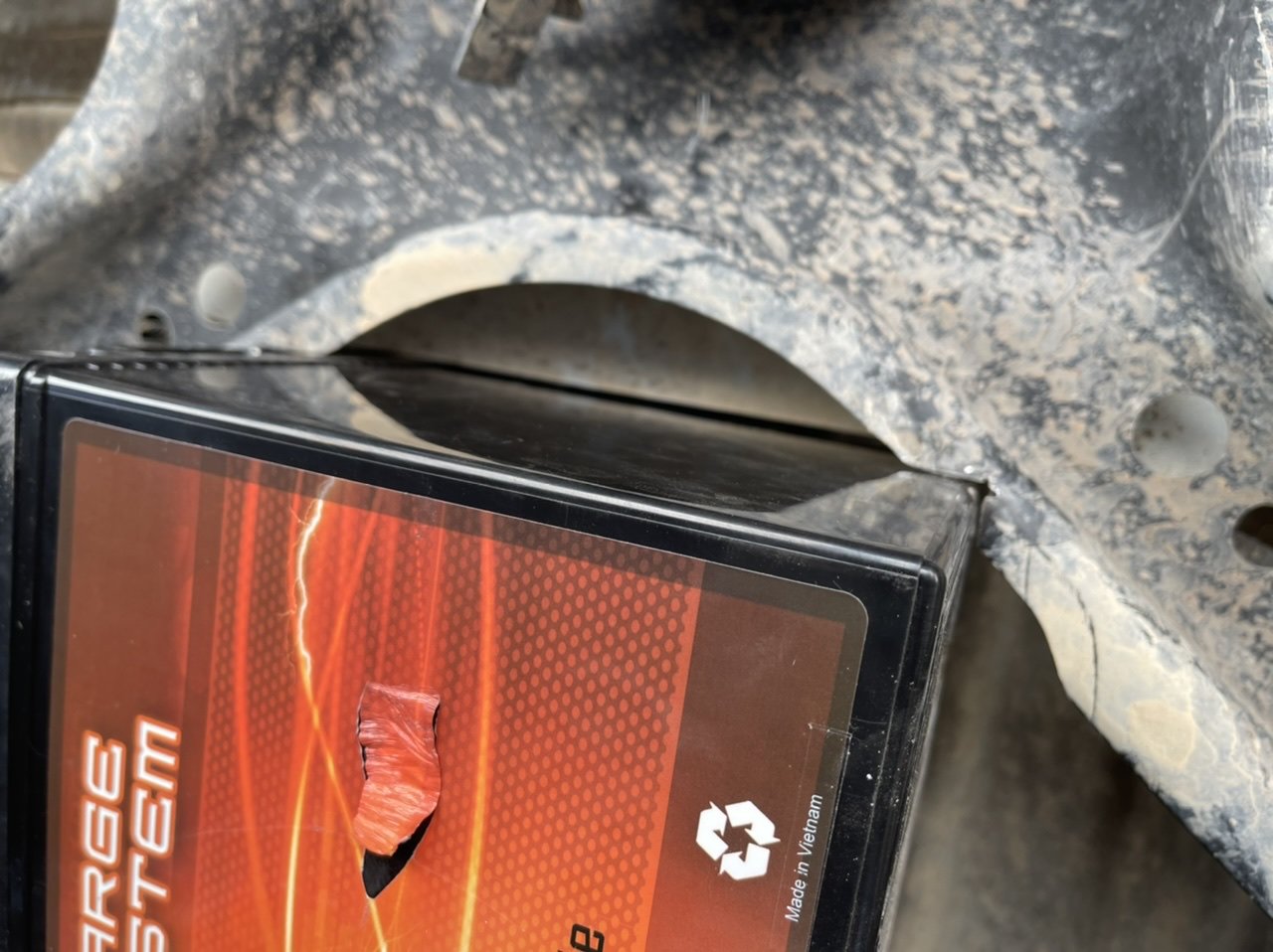

    I notched the spare tire carrier to squeeze my secondary battery into place.
    Gonna have a buddy create a tray and figure out a way to secure it in place. Happy where it’s at. It’s very tucked in, the the battery is snug up against the underside of the bed and is using the spare tire mount and bed brace to prevent forward/rear movement.

    Submergible?

    It's a sealed battery but :notsure: I wouldn't want to cross any water if it was deep enough to cover that battery, I'd be better off in a boat :D

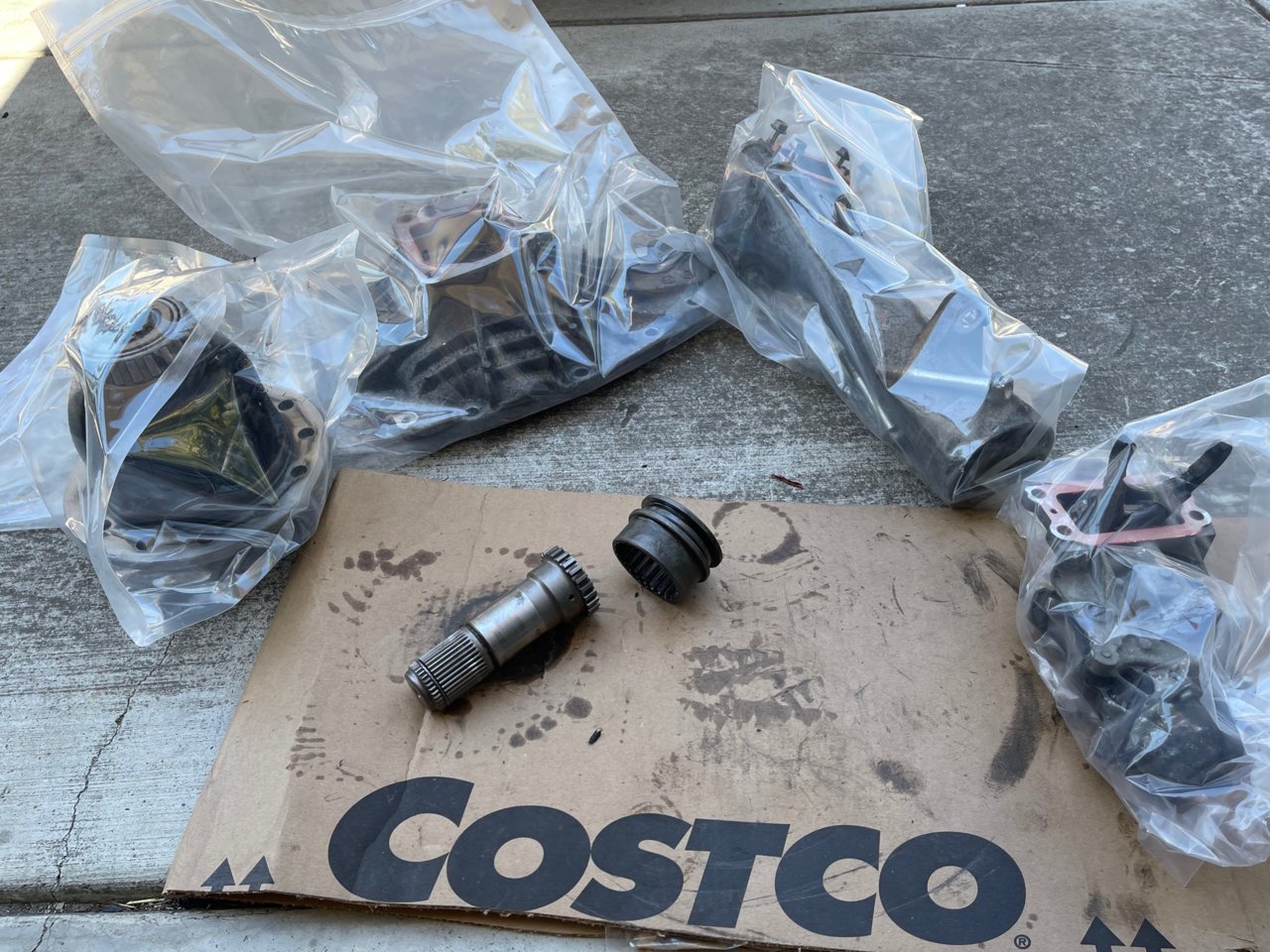

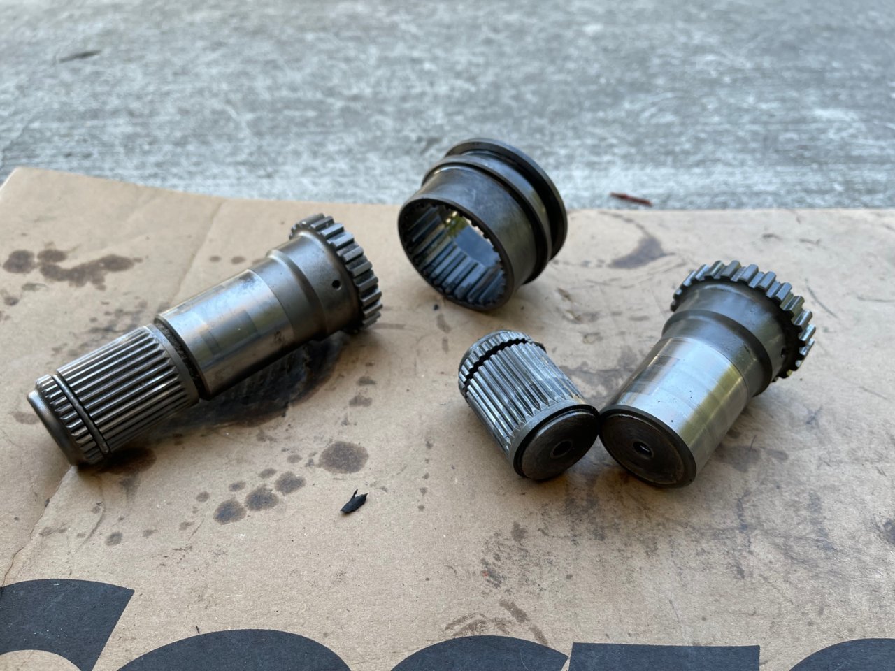

    Took apart my spare front diff to send out to a shop in Indiana that has agreed to make replicas of the stub shaft and differential sleeve made out of 300M alloy. Took me quite a while to find a shop that had the equipment to reverse engineer and make the stub shaft - the stub shaft is hollow in the middle to allow for the mating shaft to slip inside while allowing gear oil to escape out the other end.
    The stub shaft will be a replica of the stock shaft. The differential sleeve I'm going to have the shop double the thickness around the splines. Even though the sleeve is being upgraded I think it will still be the weakest link in the front diff, which I will be ok with as it is much easier to replace than the stub shaft.
    If these parts are able to handle how I wheel, then I will consider actually selling them, probably on eBay, since NOBODY has them (at least from the research I've done). The whole reverse engineering and building out a prototype is costing me several Dometic fridges - hence why I went cheap with the Amazon fridge :rofl:

    That’s dope dude, I will buy it if available.
