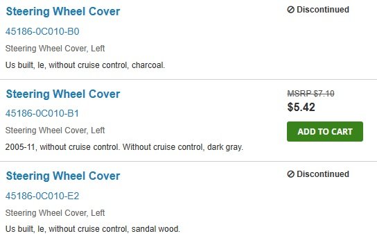

    There are a number that could be linked, this is one that has a pdf attached that will give you a general idea. I would also suggest using a Google search with these type formats or similar variation, quotes needed where applicable. Many of our sister/brother sites have these but some have lost their pics especially tundra solutions.
    Limited choices on tundras.com
    add cruise site:tundrasolutions.com
    add cruise site:tundrasolutions.com "1Gen-Tundra"
    add cruise site:toyotanation.com "Tundra 1st Generation (2000–2006)"
    In looking at a number of DIY's, my personal thoughts....
    * When working on/around airbag, undo battery
    * You may be aware but when ordering cruise switch cover, the last 2 digits....example B0, E2 is your particular cover color....examples below. Some discontinued items will have to be amacon or fleabay purchases
    Steering Wheel & Trim for 2005 Toyota Tundra | Toyota Parts (mcgeorgetoyota.com)
