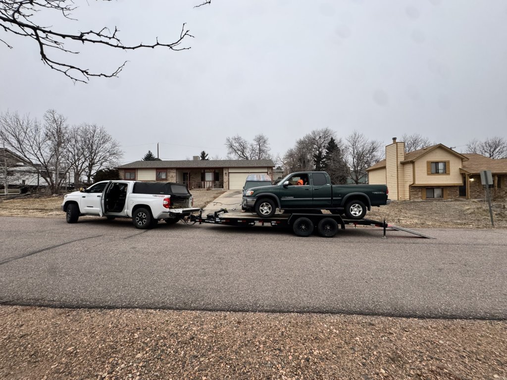

    So, without further ado, here is the purchase. I picked up this '02 off Facebook, with 278k, with the previous owner saying she has a blown transmission. She starts, and has a rattle from the bellhousing area, but no codes and no movement whatsoever which has me leaning towards a bad flex plate. I've never personally seen a 4.7 or a 1st gen lose a flex plate but I suppose anything is possible. She's in great shape otherwise, motor sounds good, no leaking manifolds, new tires, new LCA's but old lower ball joints, and a newer steering rack.
    I'll probably be in to see what ideas you all have for this old girl; I'm going to be fixing her up for my son's first truck. I've joined a few 1st gen Facebook groups but I'm not a fan, as the advice over here seems much more sound and less hectic/opinionated. He's 11 now but with the prices of used cars/trucks constantly going up I pounced on this one because of the price.

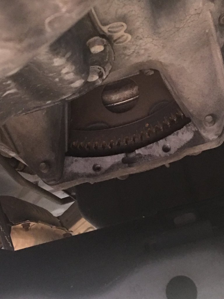

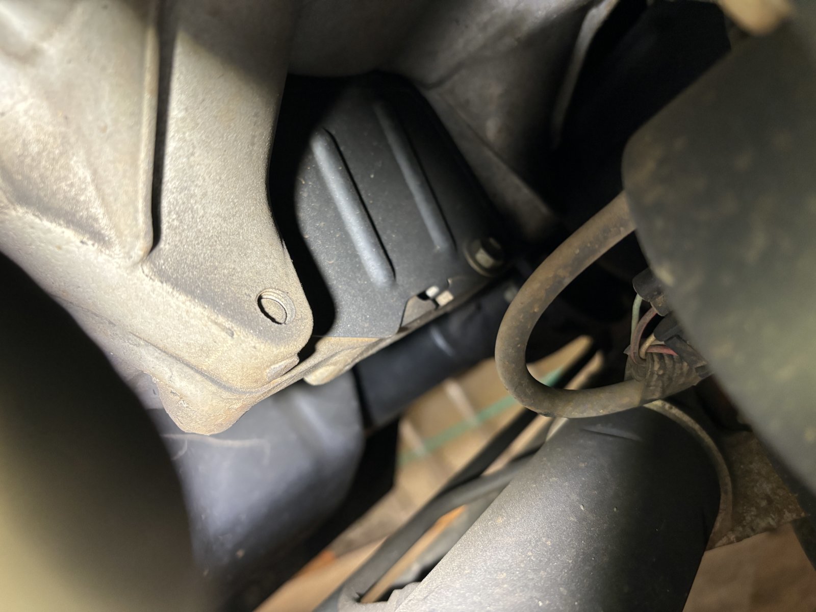

    YES!, there's a small plastic cover at around the back of the motor/bellhousing you can pop off. It's smile-shaped. Let me post a couple of pics with the cover off, and the cover on, hopefully you can find it. Note the pan and the cat in the 1st pic for referential. Lst two are from my truck, others are from different members. NOTE: It's normal there's only one bolt holding the cover on.

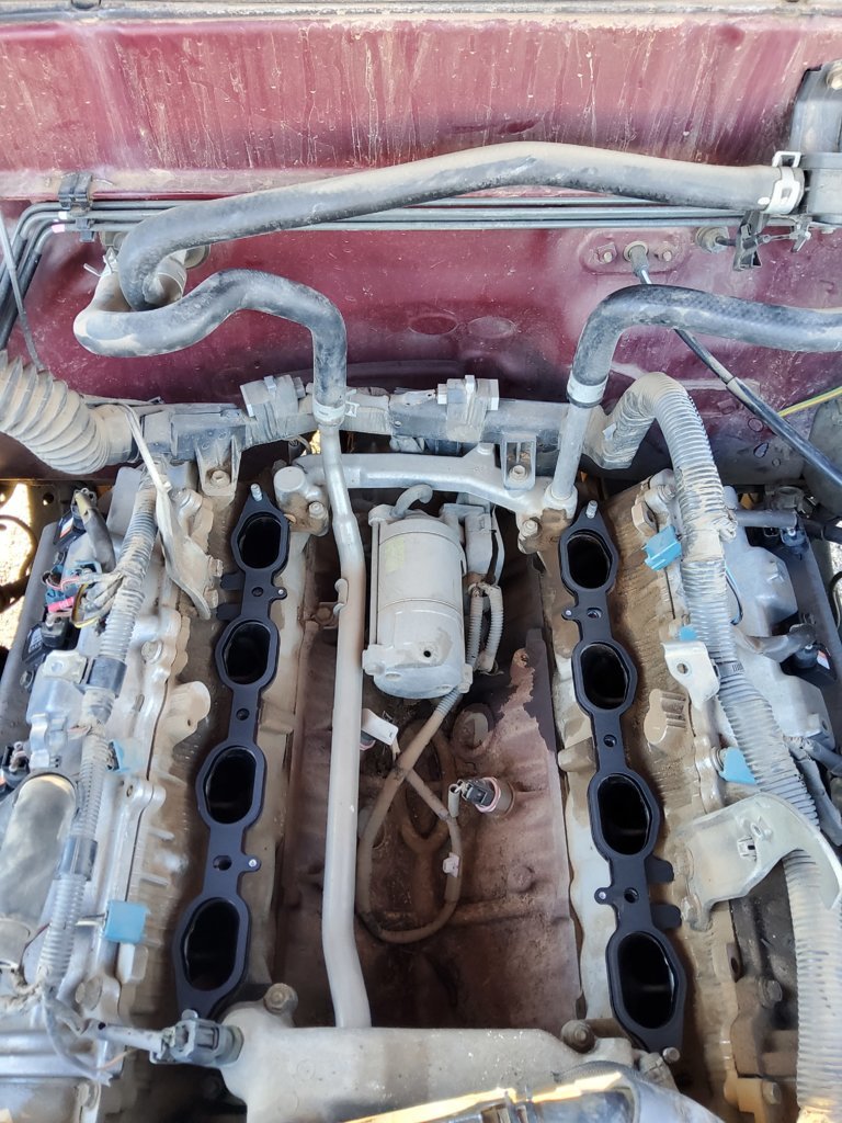

    The starter is under the intake manifold.

    Thanks! I thought there was one but again, I haven’t had my head under the hood of a first gen in a minute.
