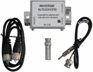

    Spent some time noodling around for CB and HAM antenna mounting ideas. I have a Midland 75-822 and Firestick on the way from Right Channel Radios. Same setup I had in the FJ. Good radio and I liked the compact size. I wasn't sure where to mount the antenna. With the FJ, I had what they called a bandi mount which allowed for an antenna to be mounted on the outside hinge of the rear door. It worked really well but, the Tundra doesn't have a spot like that.
    One idea was to put a NGP mount on the side of the topper shell but I'd rather limit the number of holes I have to drill through the truck. I could've used an NMO mount in the roof but, more on that in a second. Then there's hood mounts which is a bracket that uses a fender bolt under the hood. Also thought about sticking it on the front bumper but then I'd need a huge antenna to clear the roof line. I want subtle and low key.
    I grabbed a ********, who I know from Rising Sun, hood mount yesterday but someone pointed me to this little piece of electronic wizadry.
    It's a splitter that allows me to use the stereo antenna as a CB antenna. Can't get much more subtle than that. It'd cut down on the range but I figure the CB is really trail use only. If I need range, that is what the HAM is for. Anyway, we'll see how it works as I like the idea but if it totally sucks, I'll throw the hood mount on with the Firestick.
    For the HAM, I'll be using a Diamond antenna which, again, I had used in the past. With the FJ, I had it on the roof rack with a foldable mount which was nice. This time around, I'm leaning towards an NMO mount in the roof. Only problem is that I don't know where to put it yet as I haven't figured out what I'll be doing for a roof rack. With my luck, I'd drill the hole, get everything set up, find a rack I like and realize that the cross bars go directly over the NMO mount.

    Then, I wired in the CB to the first slot. Still need to figure out the antenna. The splitter box I bought only works with antenna cords that have an RCA plug on it. Stock head unit does not connect that way so I can't use the splitter. Spent a little bit of time exploring behind the dash but can't find any place to run the coax out into the engine bay. I guess I could cut the end off, feed it through the firewall plug then recrimp a new connector. Might need to borrow some coax tools from someone. For now, I'll just use it with the attached stubby while I try to figure out what to do with 18' of coax. I need to put a mic clip on the dash.
