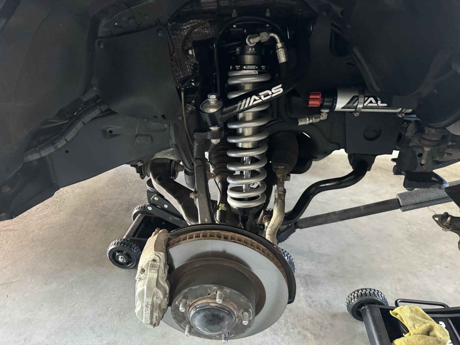

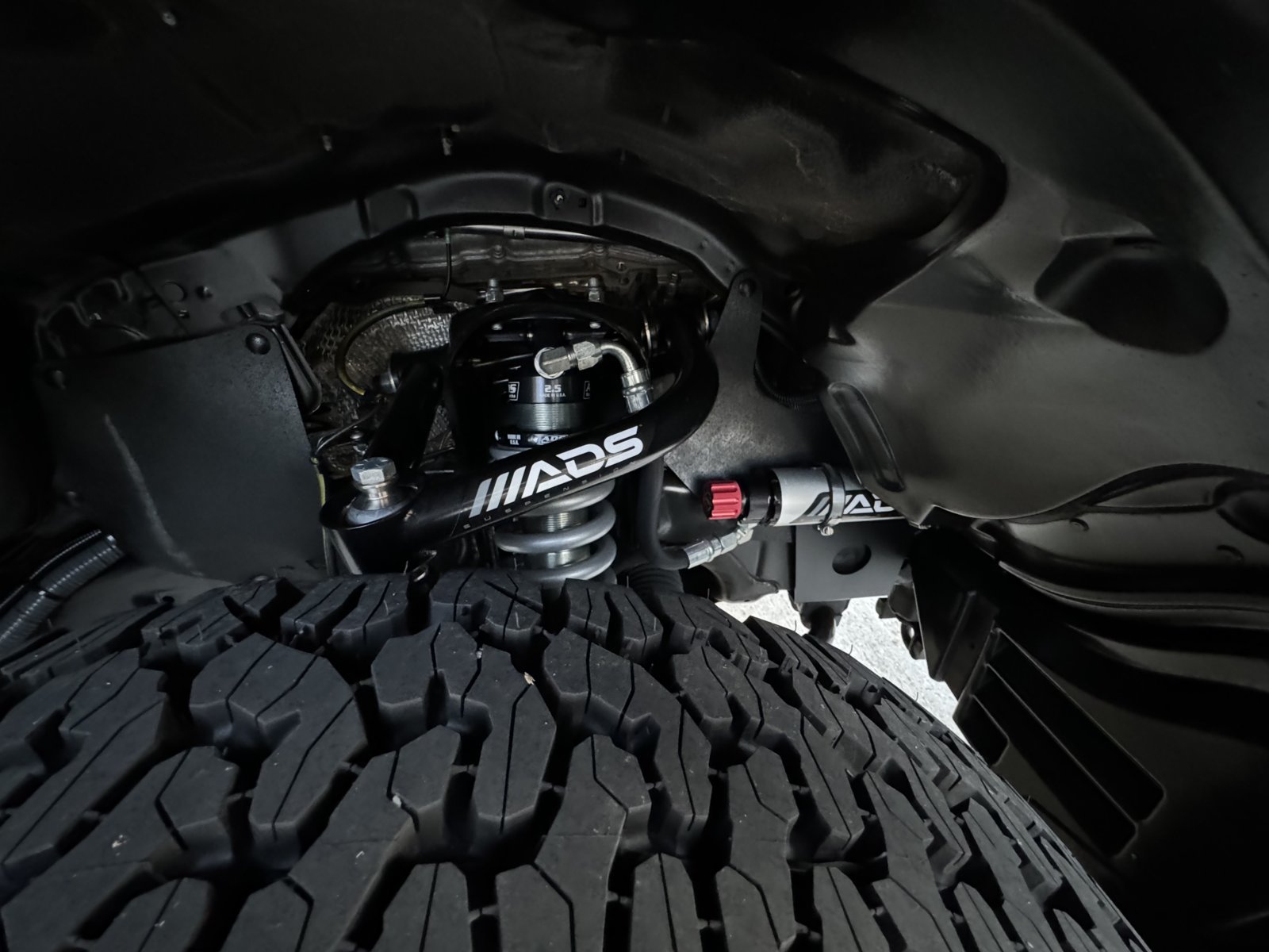

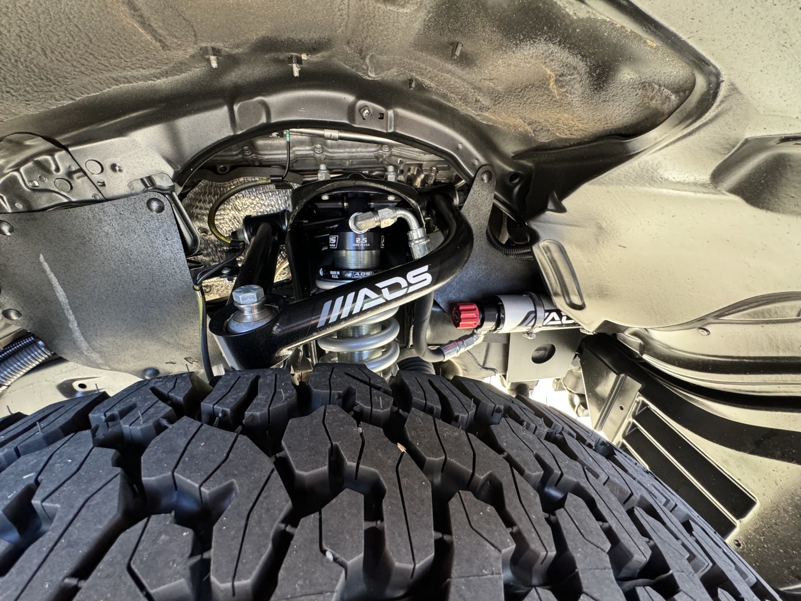

    After installing a 3” suspension lift on my 2020 CM, I’m getting a creeping noise coming from front passenger side. It’s driving me insane. Noticeable when turning, at low speed and coming over a small bump. My tires aren’t rubbing on anything, have plenty of clearance. I have retorqued everything three times now. I sprayed some white lithium grease on the UPC & low bottom shock collar. I went with good components, just need to find out where and what’s causing the creep. Any help or advice would be great. Don’t know what to do next, want to fix it before it gets worse.

    Did you tighten/torque all of the components before setting the vehicle on the ground? What method did you use to remove/install the coilovers? For example, did you unbolt the lower ball joint from the knuckle and slip the CO down and out? Or loosen the alignment tabs and drop the lower arms? Since you put on new UCA’s, you obviously unbolted the upper ball joint, too.
    All of the components should be torqued after the vehicle is resting on the suspension instead of up on Jack stands with the suspension drooped. A arms, UCA through bolt, lower shock bolt (the upper bolts on the shock tower are fine to torque with the wheels in the air, but give them another pass with the vehicle on the ground), sway bar links, etc. If you torque anything with a bushing in it while the suspension is dropped out, the bushing can bind and squeak at ride height. If you tightened them all down before dropping them vehicle off the Jack stands, I would lift the truck back up, loosen things, drop it back down, then torque them.
    I suspected the sway bar end linked as has been suggested earlier.
    I had a similar squeak a while back that behaved similarly after swapping suspensions. In my haste, I tightened a few thing down before setting the vehicle down but didn’t think about it. Squeak Drove me nuts. Looked hard at the skid plate, too. I finally put it all back up in the air and loosened all the bolts, dropped it down and tightened it back up. The squeak was gone.
    My sequoia had a similar squeak in the rear suspension after swapping in new shocks. Turns out the rear shocks need some hefty torque on the top mount to make it right and tight, so follow the torque spec instead of going by uggah-duggahs.

    Ended up taking it to a shop and they looked over the suspension, retorqued everything. Noise is still there, they basically told me the noise is coming from the UCA Uni-Ball. He was saying that Uni-Balls are stronger than ball joints but are noisy. Can anybody confirm that Uni-Balls are more noisier that ball joints? Was also told that with time they will get noisier. Trying to figure out if I want to see if replacing the Uni-Ball will on will quiet it down, or go with ball joint UCA. What are your guys thought's?
  23. Sep 16, 2024 at 6:17 AM
    KNABORES
    KNABORES Sarcasm incoming
    Jan 1, 2020
    #40572
    15,344
    Arkansas
    If properly installed and lubed, they should be quiet. They do require some cleaning and re-lubing since they are exposed to the elements. If they were all noisy, why isn’t your drivers side making the same noise?
