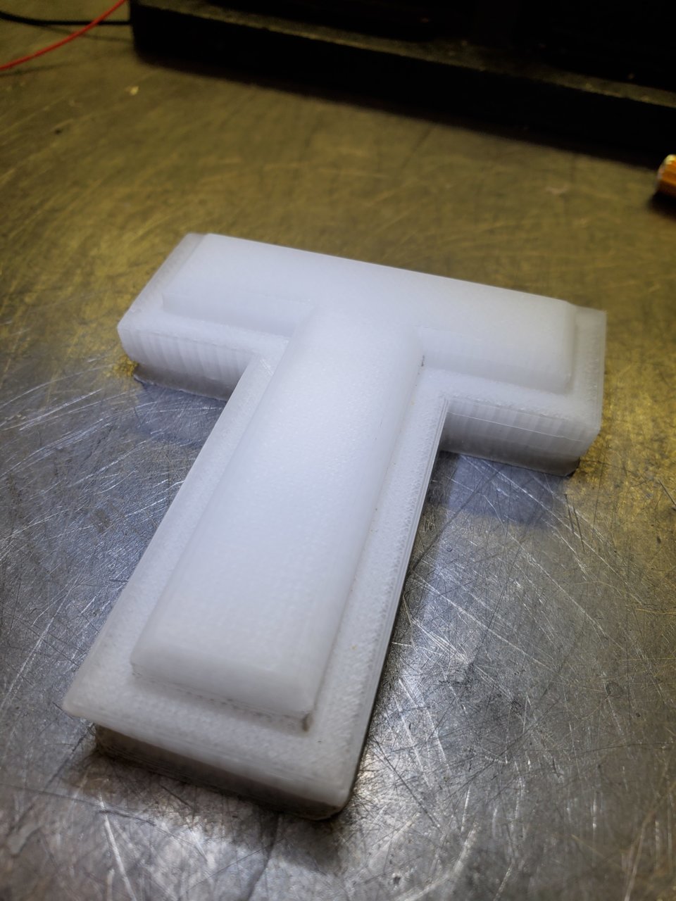

    I saw a someone had made shadow back lit letters for the TRD Pro Grill. I have decided to give this a try with my own spin. I will be 3D printing the letters using clear abs filament. I will then paint the raised part on top with silver paint (to reflect light back in) then final coat with MGM. I have started with the T. The model has been designed to be screwed into place from the back side using the alignment holes. Right now it is designed to use 3 x 5mm through hole LEDs. I may change this once I finish the first prototype. Once the project is complete I will publish the models.
    Here is the model for the T to give you an idea.

    May have to switch to solid infill. Can see the infill through the sides. May not matter though. Will see when its done. Will probably tweak some settings though as it's not printing the best. My first time using this clear filament.

    So the bottom layers need some help. I just need to tweak some settings. The top layers came out sweet. Its definitely good enough to test how well it carries the light. Ill get the raised part painted and wire up the leds to test. Overall though it is very encouraging.

    Sanded it a little to make the surface smoother and more consistant. Looks a lot better. Also going to try beveling the part that will stay translucent so that i can print it upside down. The channels for the leds and wiring came out really bad.

    I tested it already with some blue leds. I actually think it's going to work pretty good. I have some white leds coming in tomorrow. I dont need to have perfect lighting for this to work well. We will see. Would probably be perfect on a SLA printer.

    Covered up the raised part with electrical tape to test. There are definitely hot spots. They're not as noticeable in person as they are on the phone. I think it will looks good from any amount of distance. if not i can add more smaller LEDs to get more even lighting.

    Just using generic 5mm 20mA leds. They fit inside a channel on the back that I will fill with epoxy.

    So i printed once upside down and it came out like crap. Then I learned about the issues with my model that were causing it to not put support under the channels in the bottom for the wires/LEDs and got it going again right side up, but this time too much support and it basically filled the channels. ill have to adjust the supports and reprint today. Other than the support underneath the rest of the third attemps came out reallly good.

    Managed to dig out the features enough to put the white LEDs in for another test. These look even more awesome!
