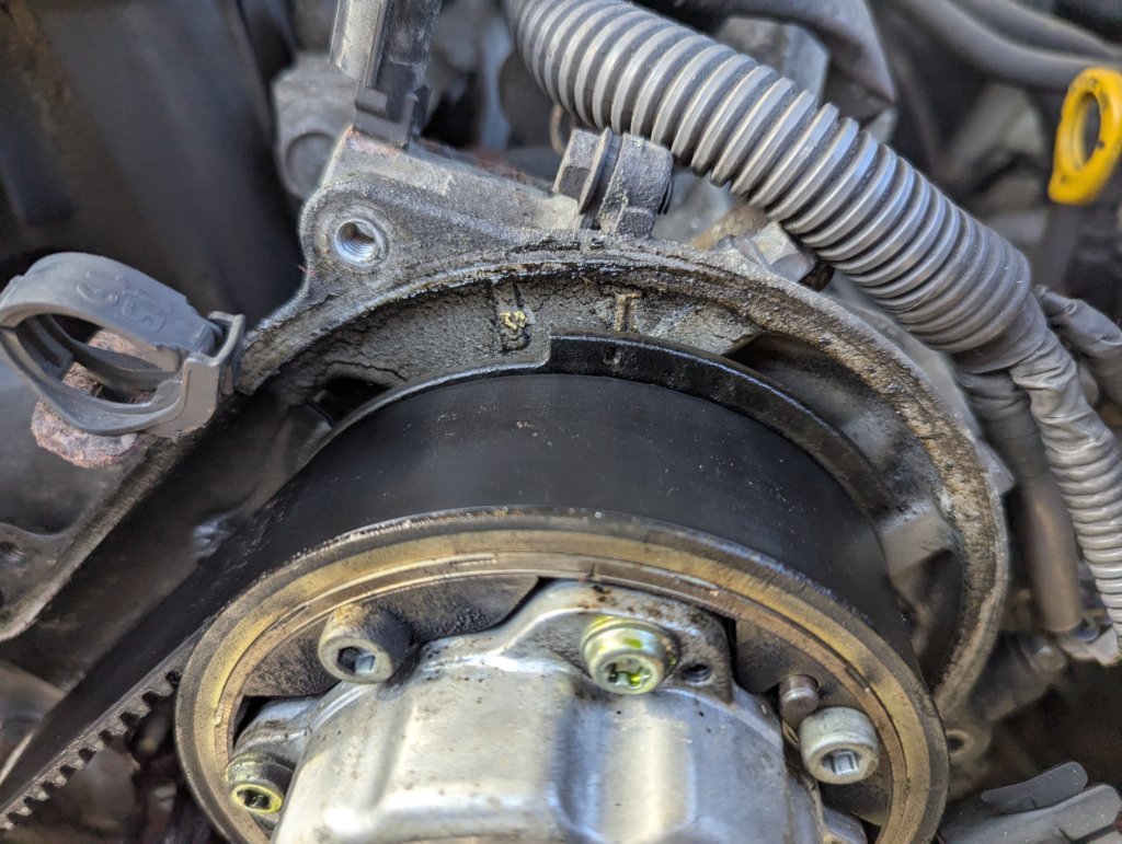

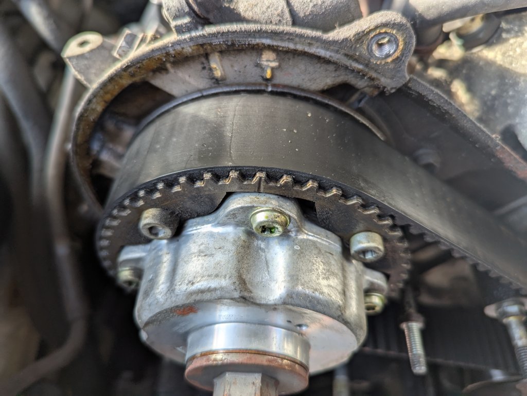

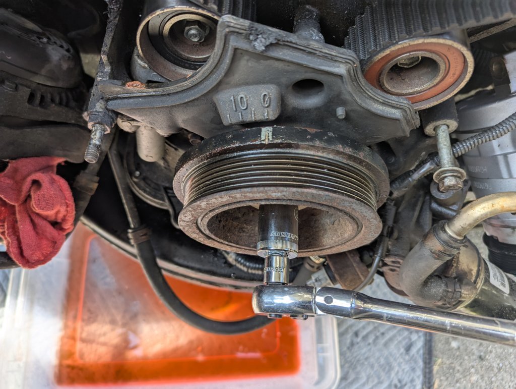

    Hey all, I'm doing the timing belt on my 2006 Sequoia, and my timing marks aren't lining up. When I put the crank pulley at 0°, my cam pulleys are both at the T indicator.
    PXL_20250811_142040017.jpg PXL_20250811_142045524.jpg PXL_20250811_142108158.jpg
    If I understand the various threads and videos I've read and watched, I need to continue taking things apart and then reset these to the correct marks with the belt off.
    My question is: should I leave the crank at TDC, or move it to the timing mark (putting the cams well past their timing marks) before continuing?

    No, I haven't taken the belt off yet. This is how it was when I got in here.
    Watching that first video it seems like I should leave the cams at ATDC, pull the crank pulley and take the belt off? Making sure the belts marks line up everywhere when putting it on?

    Quick update for anyone in the future who may find this post while researching a similar issue:
    As stated above I left my cam pulleys pointing at their "T" marks, and finished taking off all the covers. I then took off the old belt and advanced just the crank pulley to its timing mark. I changed the water pump while I was in there, then buttoned everything back up.
    All of my timing codes were gone when I started it back up. My Sequoia was also much quieter and felt smoother as well. I had a Nissan Versa before I got my tree, so I didn't have much to compare it to, but it sounds and feels much healthier now.
