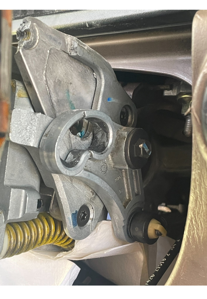

    My shifter is really floppy at this point, I'm not sure if it's a tension pin issue, or if my ear is on the outs. When I had it in for alignment after lifting, the tech mentioned it. "Our shop truck had it happen already, looks like yours is not far off..." so I told him I was aware.
    someone needs to CAD up a part someone can machine off a few dozen pieces of that beefs up the area where the split normally happens. It would make a great 'problem solver' part that would actually sell pretty well. $$ opportunity for someone with CAD skills and a machine stuff.

    You are able to drive while it’s broken. Just unbolt and remove the top and bottom covers… and Just need a leather glove so you can rotate the mechanism by hand, to protect your skin during the park to drive rotation.
    until someone machines a part, I took my ss bbq spatula and cut a 1/16 x 3 inch metal plate and bent it in a c shape with jb weld to reinforce the replacement.

    Anyone that’s had this issue feel free to pm me with photos, I can look into designing a better part. From my research looks like the part has two common failure points.

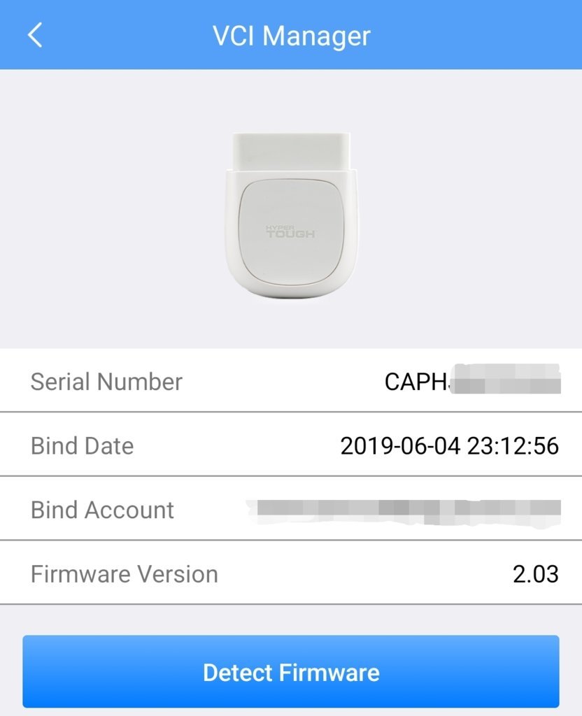

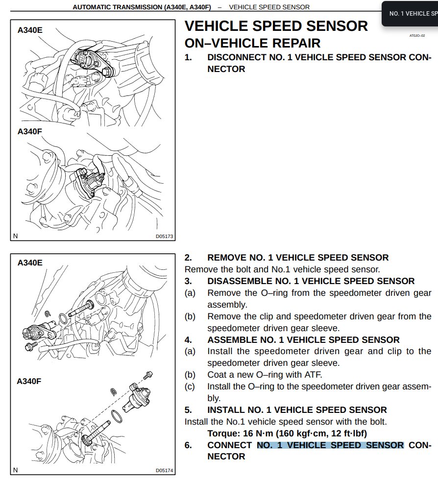

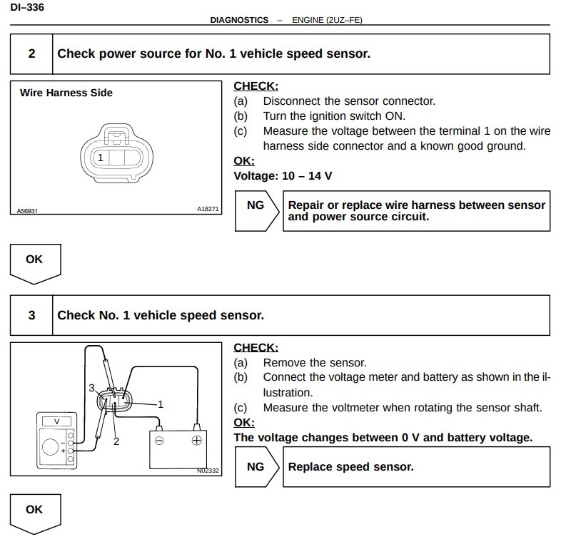

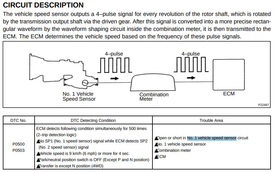

    Crackie's speedo has been out for a good while. He's been driving fine so I haven't worried too much about it. Live Data from my scan tool shows vehicle speed No. 1 has NO data. Vehicle speed No. 2 has data. WHYDTYFGT Link
    Sensor Location per the FSM. (Output Shaft)
    __________________________________________________________________________________________________
    Here's diagnostic info from the FSM.
    I will be looking at this for diagnostics soon, hopefully today

    @FiatRunner I recorded this just for you bud, this shows the whole process I use with the app, and extra features. I'm sure there's more I can do with it, but neither of my vehicles have tpms or any other fancy features.
    I don't think I have a wiring issue because anytime I hit 4th gear, the output from the sensor drops to zero. Even though I have data for both speed sensors, I had no speedometer movement. Interesting. I hope it's not my instrument cluster.
    Still don't understand why it drops out in 4th.
    https://youtu.be/LCCnCo6IFQs?si=acXjEsHDPVMLkncT

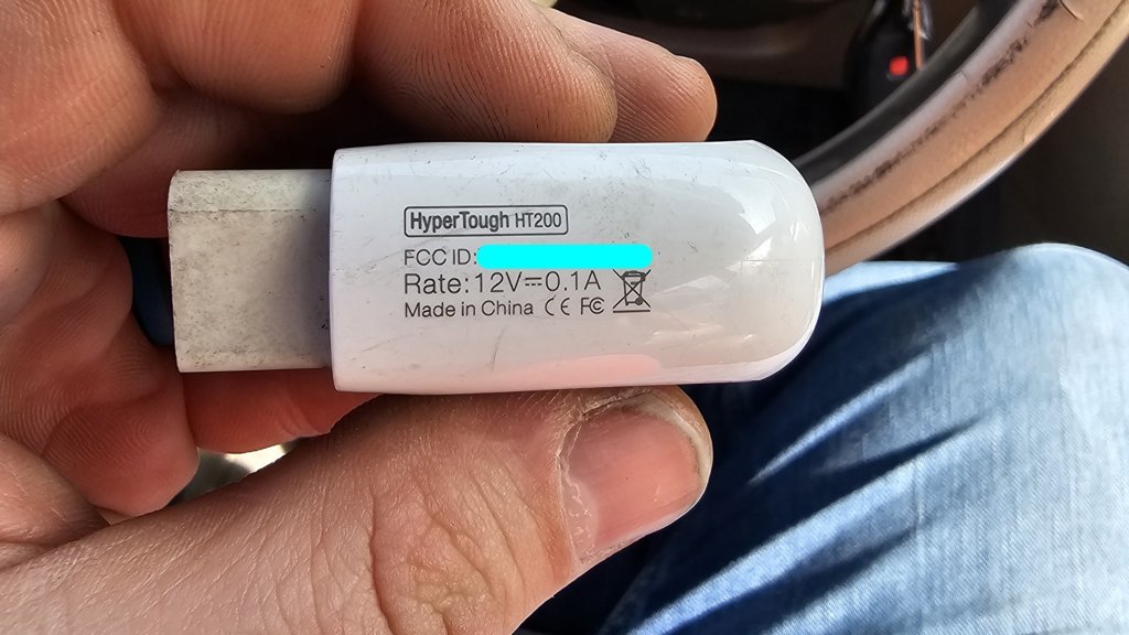

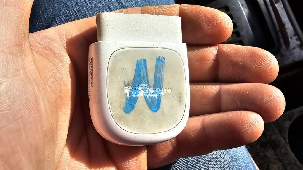

    Not a problem bro! I'm always here to help if I've got the time, my little guys keep me pretty busy.
    I have LOVED this scan tool, if it's still the same now as it was then... they give you one free code to use for any manufacturer of vehicles that's good for 100 years. Every other "decoder" you have to buy for $20 or so and its good for a year.
    I obviously paired that with their toyota code since that's all I ever plan on buying
    You can scan any vehicle for basic codes just like autozone or O'Reillys will, but the decoder gives you pinpointing. I've had dodge codes, nissan, and cheby. The decoder ones are way more accurate but you have to pay for them. Worth the $20 per code if you're an owner to me

    Oooop, mines actually a hypertough.
    I've had this thing awhile....

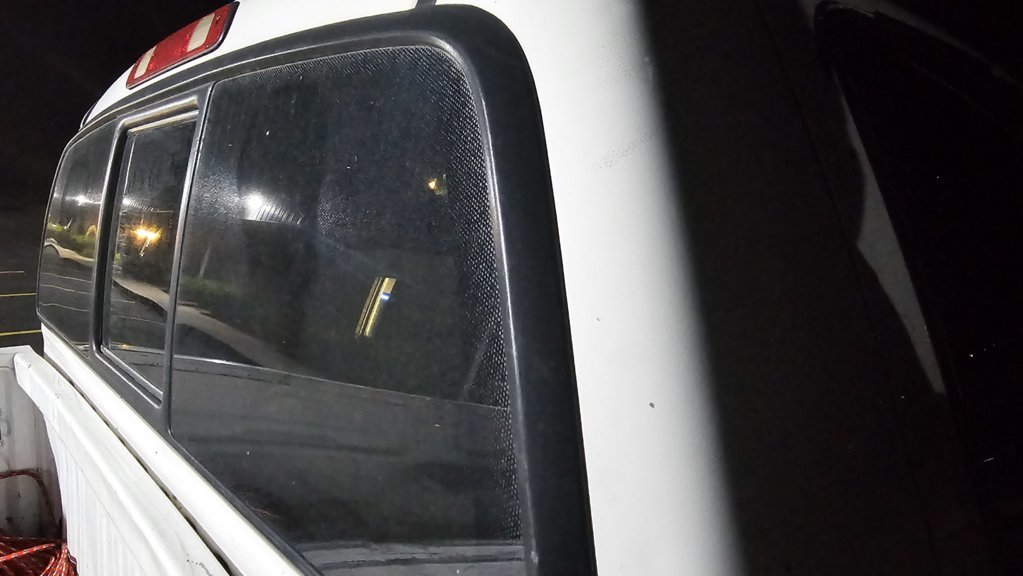

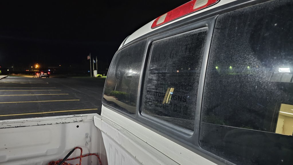

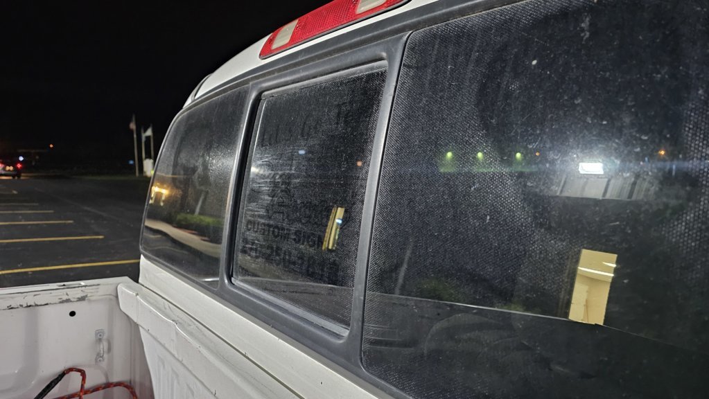

    The longer I have crackie, the more I learn about him. Look at these pictures of the back glass.
    I knew the "Sign America" advertisement was there, and they're still in business which I think is cool, but NOW there's a fuckin Ghost Skull on the drivers side! This is wild, and I love it!
    This one on the passengers side is sorta head shaped, but I can't make positive confirmation.

    You'd be surprised at how well a little rubbing compound will bring that glass back to looking like that stuff was never there.

    In the perfect lighting I can see "Grand Ledge" on my door. but none of the rest of it.
    It's a town 55mi away. Fun Easter egg :thumbsup:

    I was going to say some 0000 ultrafine brass wool and window cleaner. It'll typically do the job. I use it on all my windows once or twice a year to get them clean-clean, get that residual buildup and filth off.
    Previous owner of my shell had SIG/Legion sticker bottom-center of the back glass. I don't like stickers on my back glass usually, unless they're in the lower corners, so best believe it got shaved off, and I bronze wool'd the glass. But I should probably compound the glass also, to your point.
