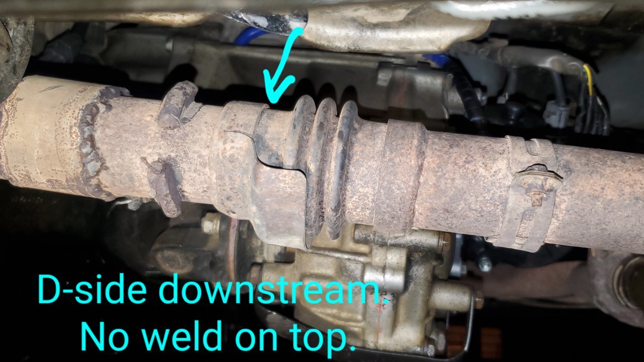

    Give me a few minutes. Most of them are on the "top" of the pipe where crackhead couldn't get the stick welder in between the cab and the pipe.

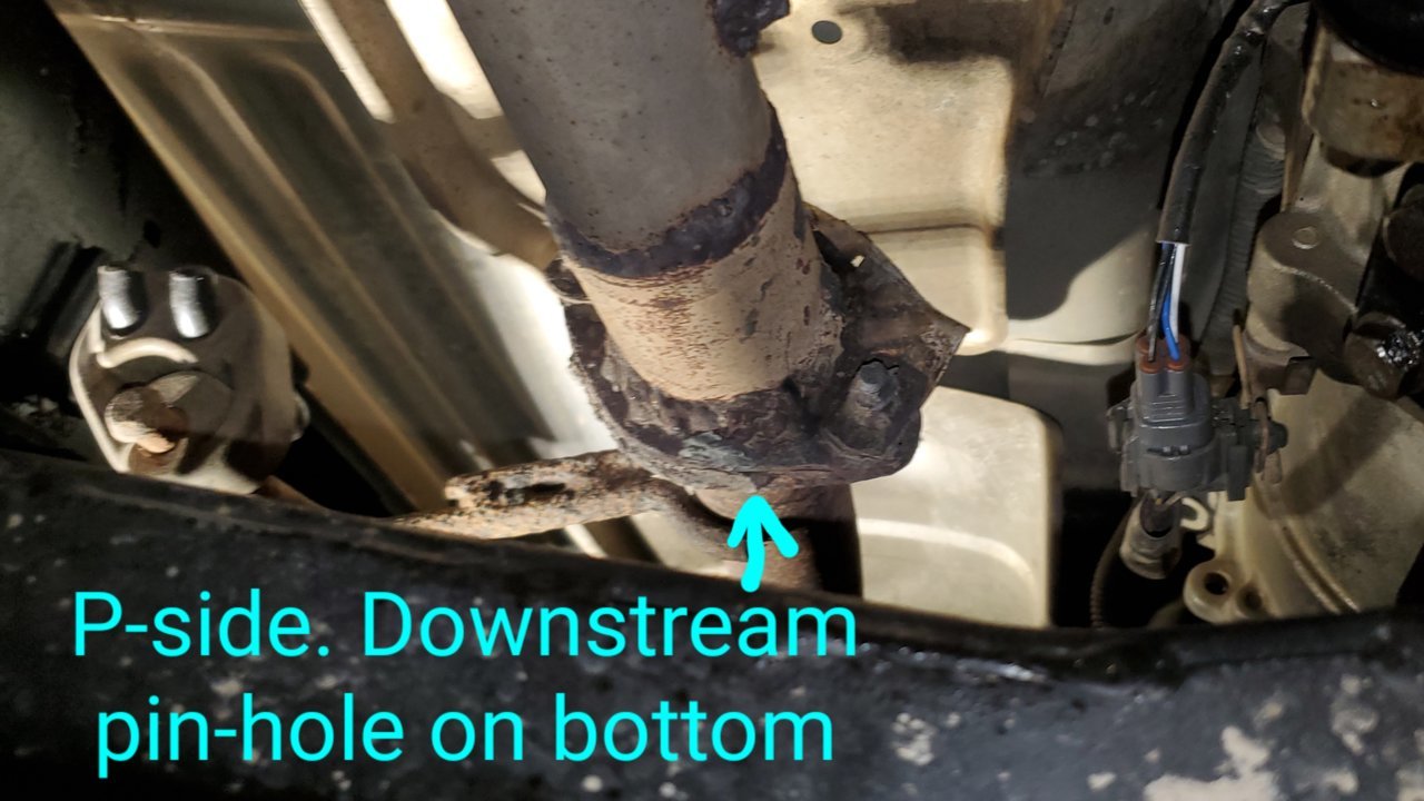

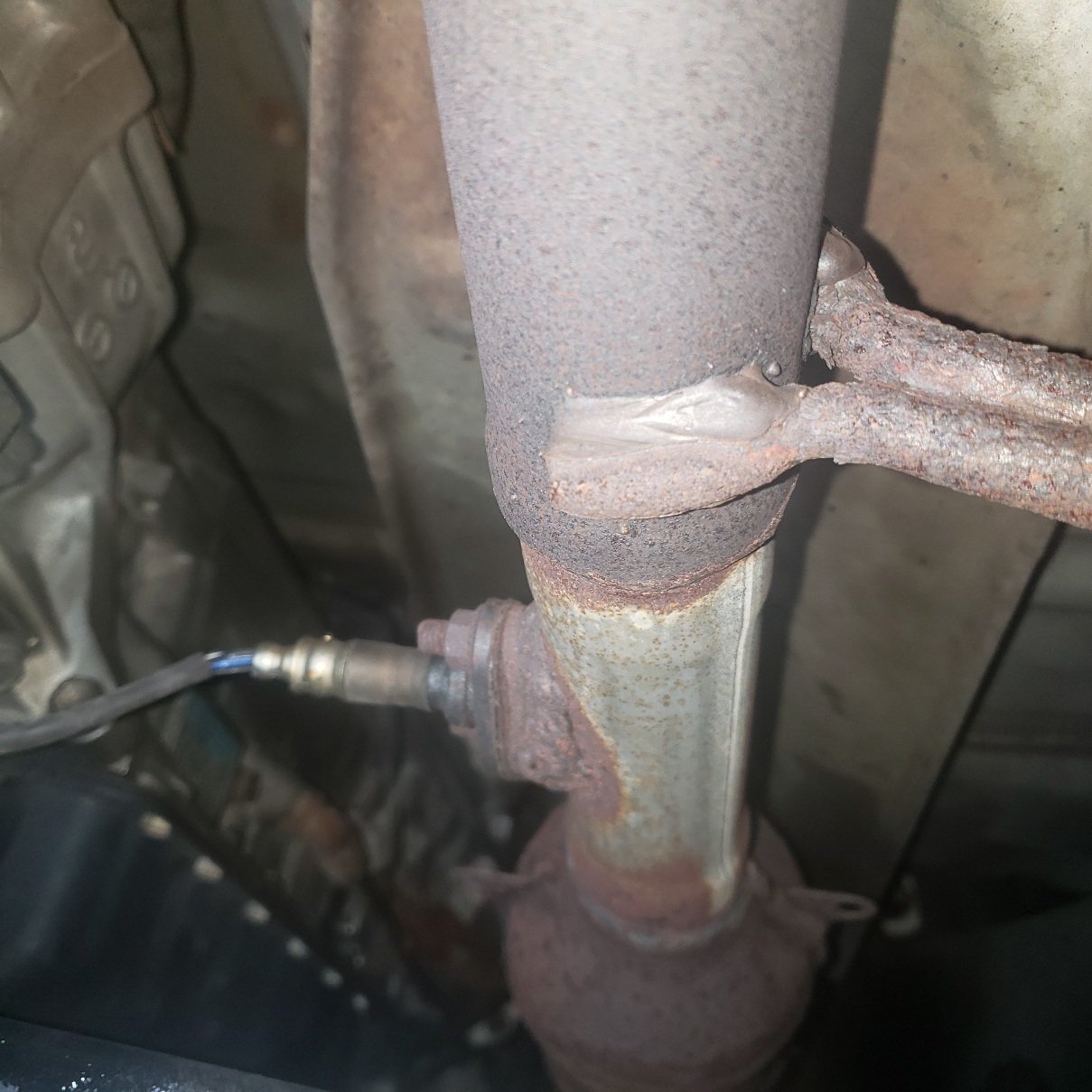

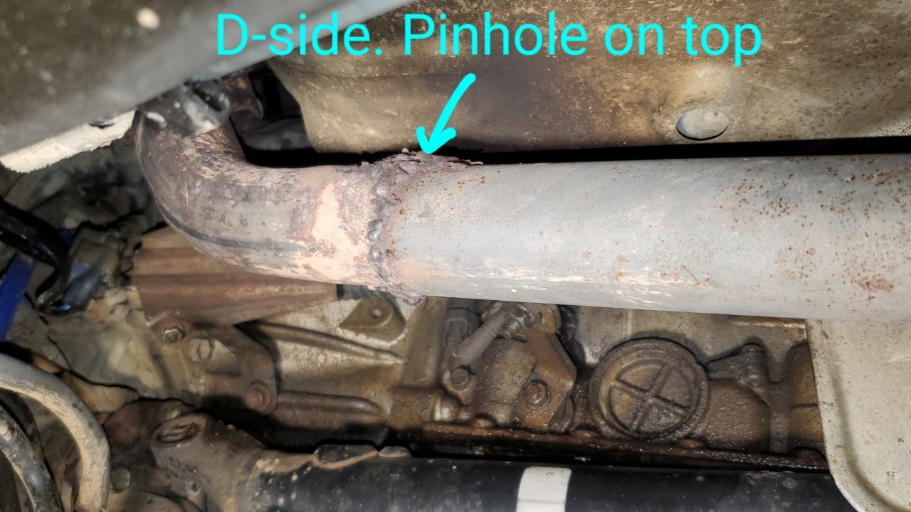

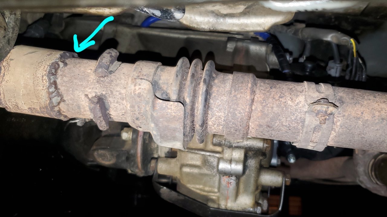

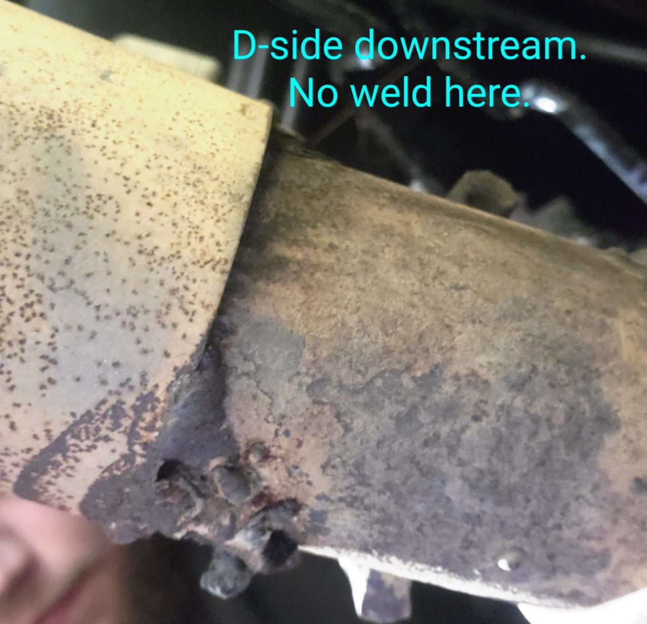

    Here you are. The first two pictures go together.
    This is the otherside of that pipe.
    Driver side upstream with just a pin hole on top of it. I can't see it, but I can feel it.
    And then at this flange.
  9. Jan 3, 2022 at 4:03 PM

    I don't think that it's a coincidence that most of my leaks are near the sensor that doesn't seem to work.

    I'm just trying to understand how this was butchered in the past. :rofl:
    I'm taking a closer look on my computer. The pics on the phone don't show very well.

    That first arrow should be further up the pipe near the weld like so. That was my bad for trying to rush.

    So, correct me if I'm wrong, but the collector flange after the upstream sensor was removed and is that an aftermarket cat or resonator afterwards? :confused:
    If you have enough "meat" (metal thickness) on what was put in there, it could be cut out and sleeved with a new pipe section. The JB weld approach is probably a quick fix if it'll work. I would think you need to clean up the weld area to show clean metal so it'll stick. I'll defer that to someone with better knowledge.
    Probably the same with the semi-flex joint where it could be removed entirely and new metal put in to fix it. You COULD try the bandage wrap approach, but I've only done that on colder sections of the pipe where it probably wouldn't smoke from the heat.
    The flange leak...would a new gasket in between the two pipes help or is that strictly a leak on the junction of the flange and the pipe?
    Unfortunately, they all look like tricky areas to fix I'm afraid.

    These are straight pipes Jack. They aren't aftermarket anything. These are literally pipes they had laying around that they stuck on here with the worst welds I've ever fuckin seen
    Think I'll just take it to Bruce if my steel stick adventure doesn't work.

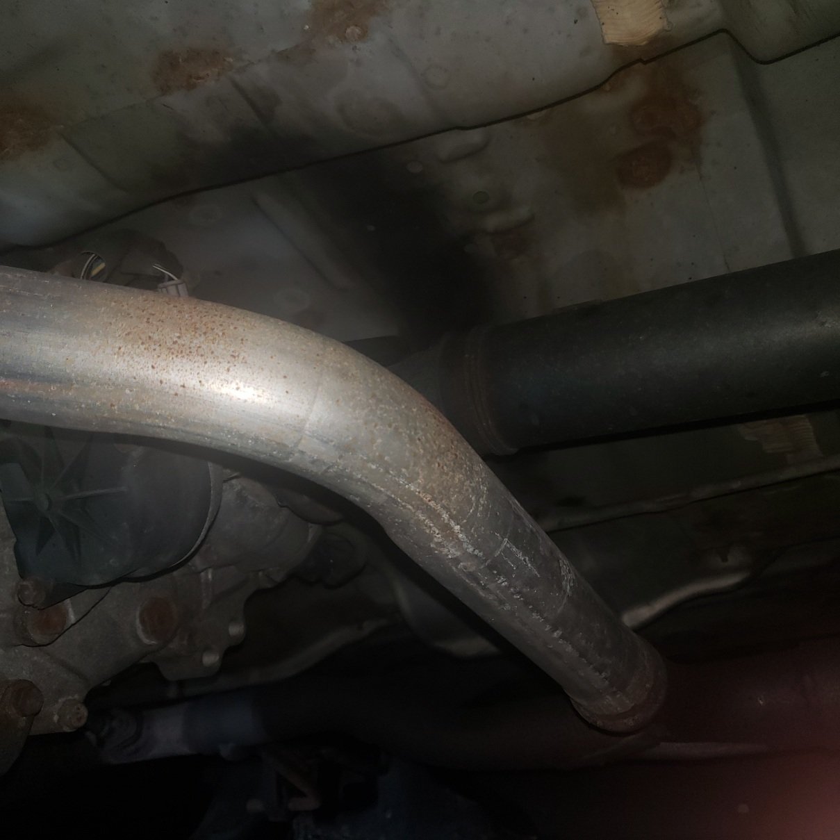

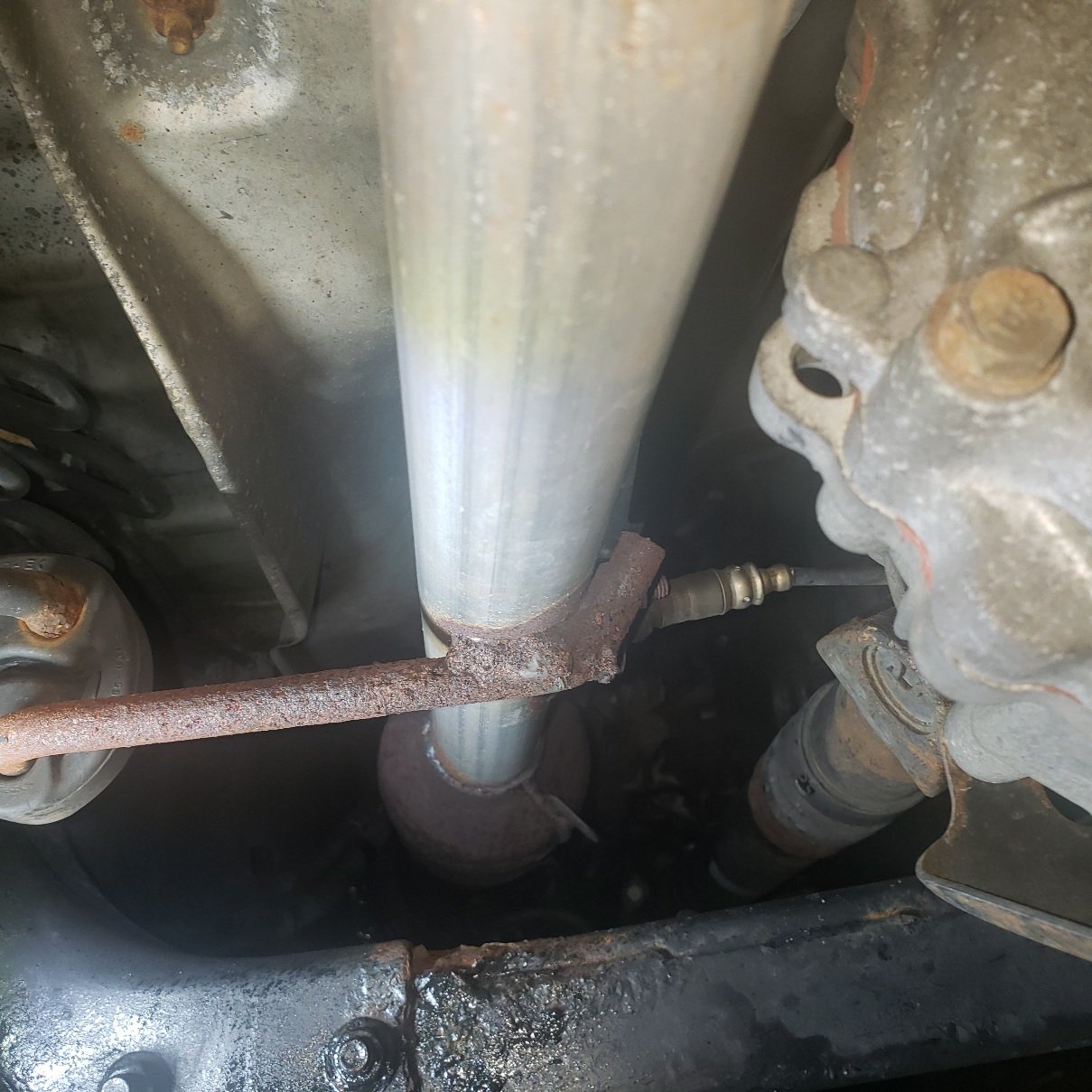

    I'll show you what was done to replace mine. Hold on while I snap a few pics.

    Mine don't seem to be a helluva lot better with rusting aluminized pipes. :rofl:
    Had i known about the shortage of trucks I would've spent the extra $100 to get stainless steel.
    Looks like the welding filler material is what's causing the rust.

    Thanks for taking the time to snap these. At least whoever did yours welded on the right oxygen sensor bungs. Lol

    If you do get it redone, I would suggest you supply the bungs in stainless steel since nobody at these shops carry them. They only have mild steel.
