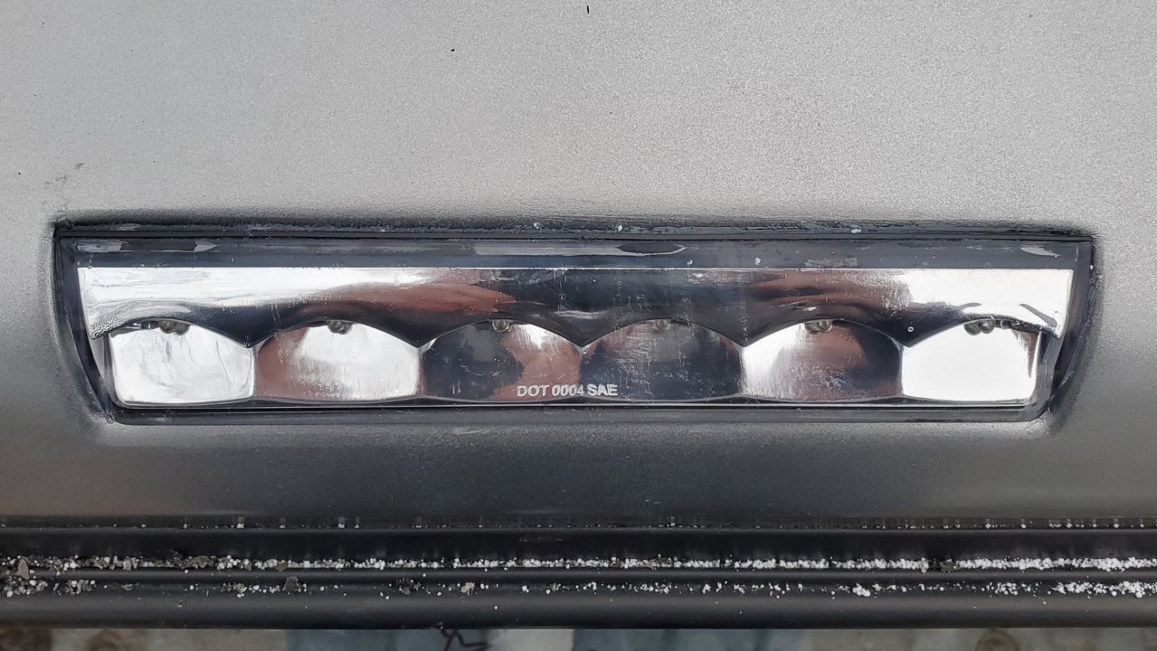

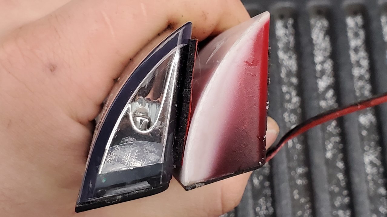

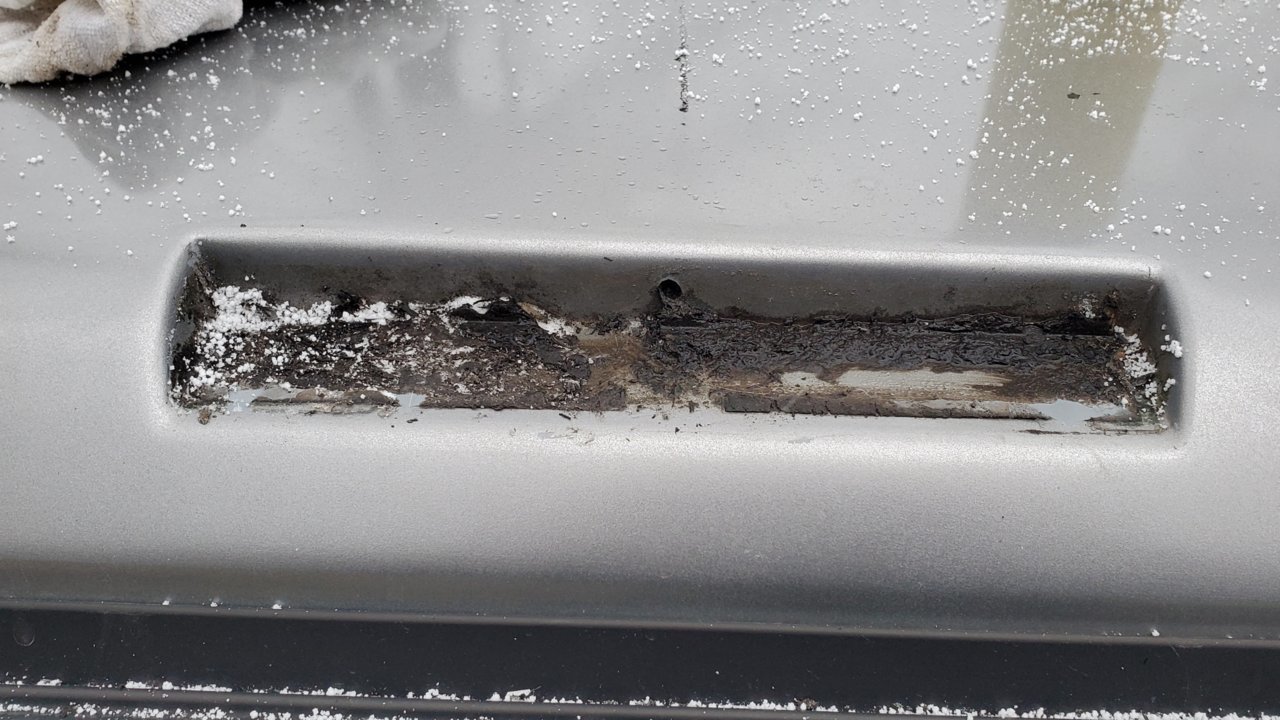

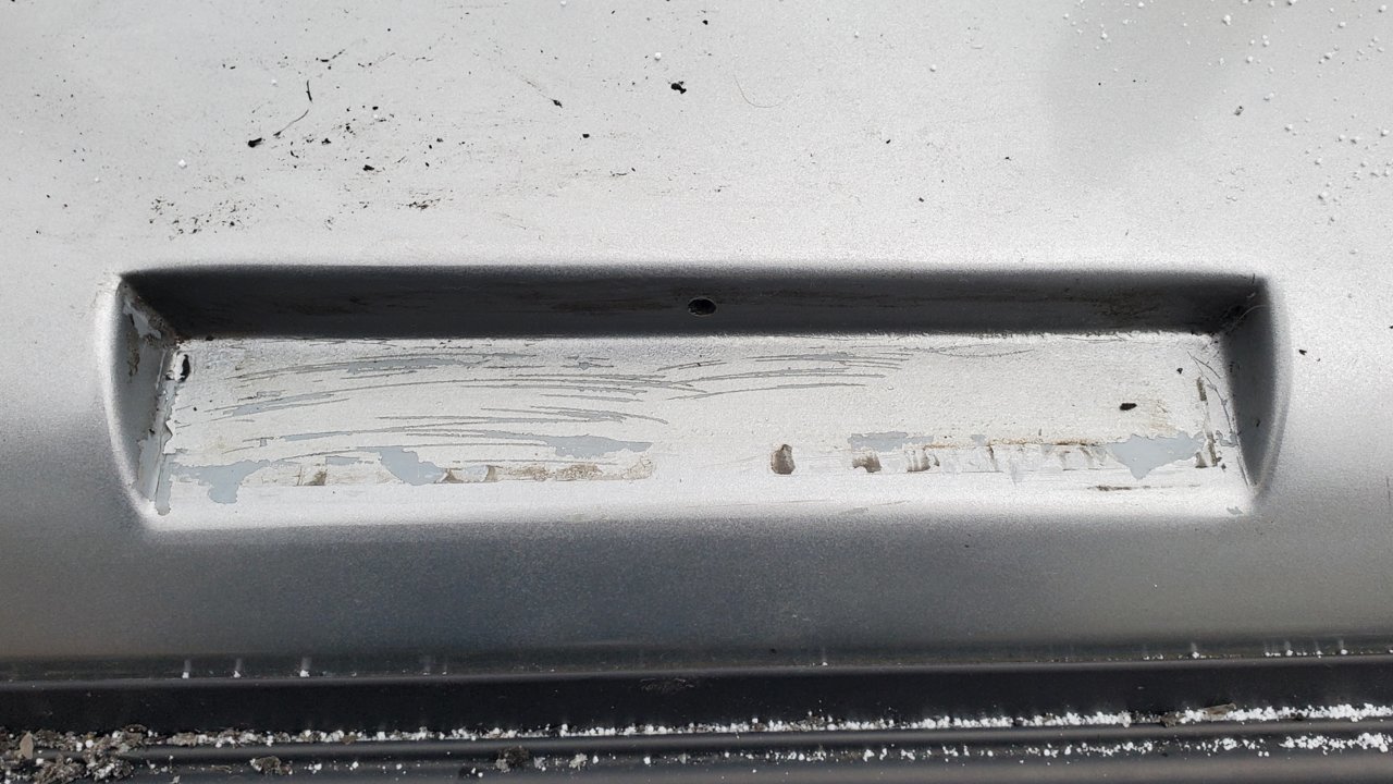

    Replaced the high mount stop light on the shell today. Pics of the old versus new before install.

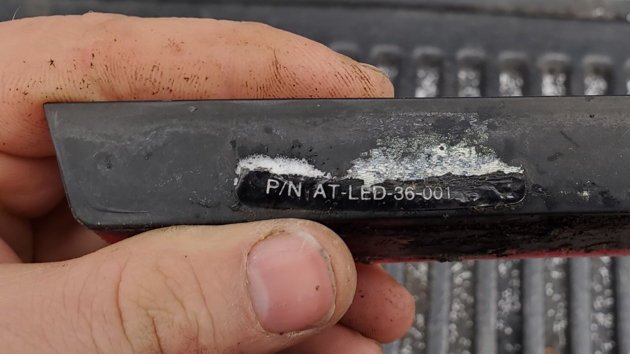

    And a part number off the old one. Haven't done a search yet, but will eventually.
    The old light collected a ton of dirt and debrizzle. Featuring snow! All the dirt was frozen so I used a heat gun to melt the dirt, and then wipe it away. Looks like someone had replaced it once before. The scratches on the left side are not from me, but where the adhesive was on the front edge is from me.

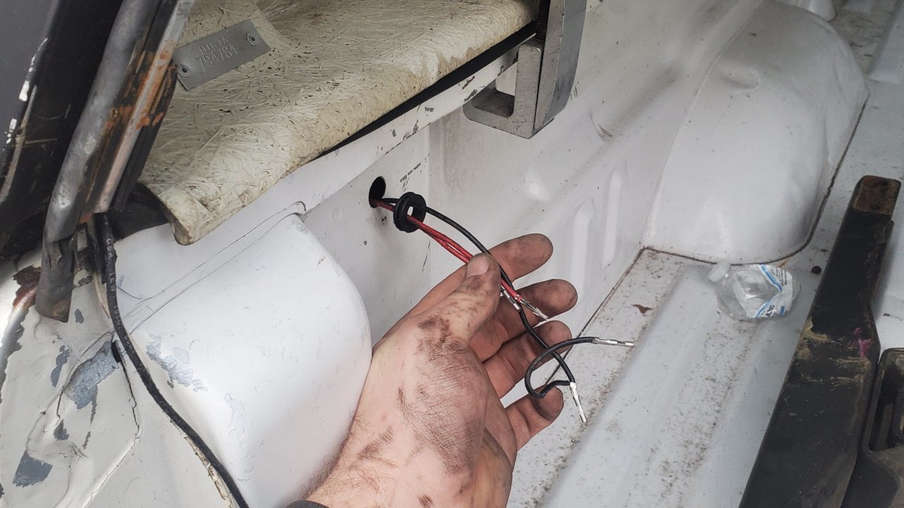

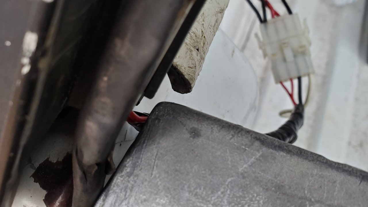

    @daveeasa my wire pass through hole lined up with my new one. Kinda regret not going with a red lens now, but kinda don't. Stuck in between I guess. Just happy that it's fixed. Ran a very small bead of flex shot along the top edge, and sides of the stop light assembly. Hoping to reduce the amount of crud built up behind it by the next time I change this out.

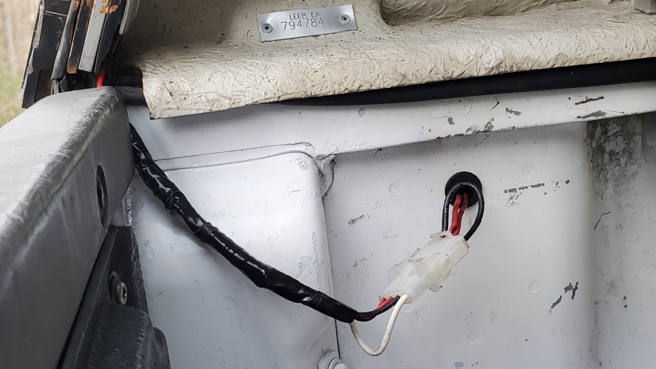

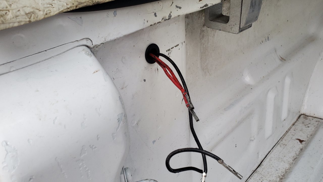

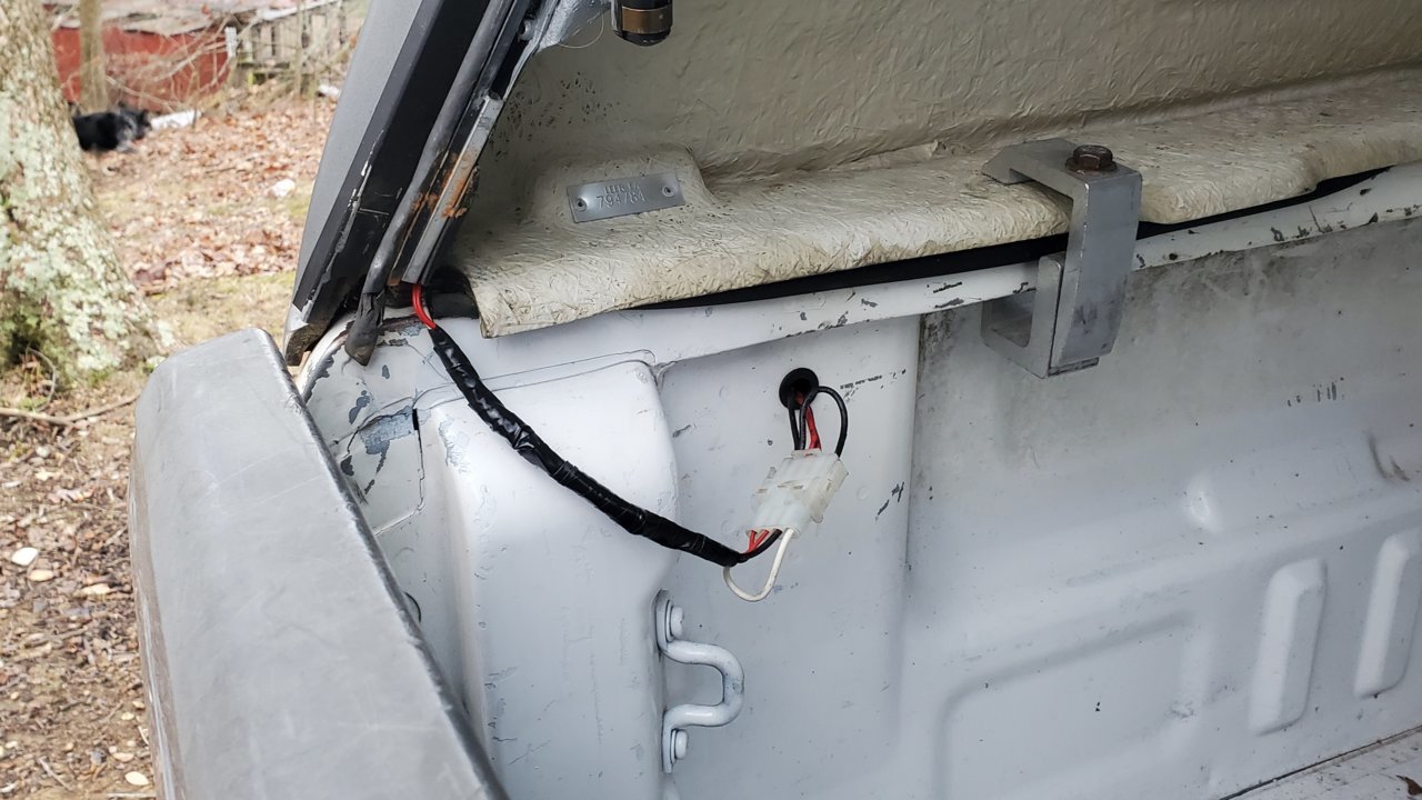

    T-tapped into the brake light, and then I fished the wiring into the bed of the truck. Slapped a grommet on the OEM hole. Not real sure what size this is as it was just whichever one fit from my grommet kit.
    I don't expect there to be any rubbing issues with the wires being run right here, but time will tell.
    Finally, finished product pictures.
    Pleased with this.

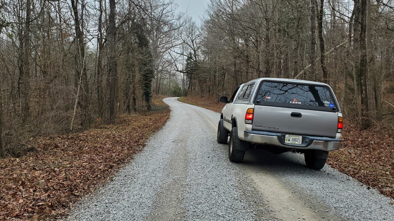

    Toolin around the backroads.

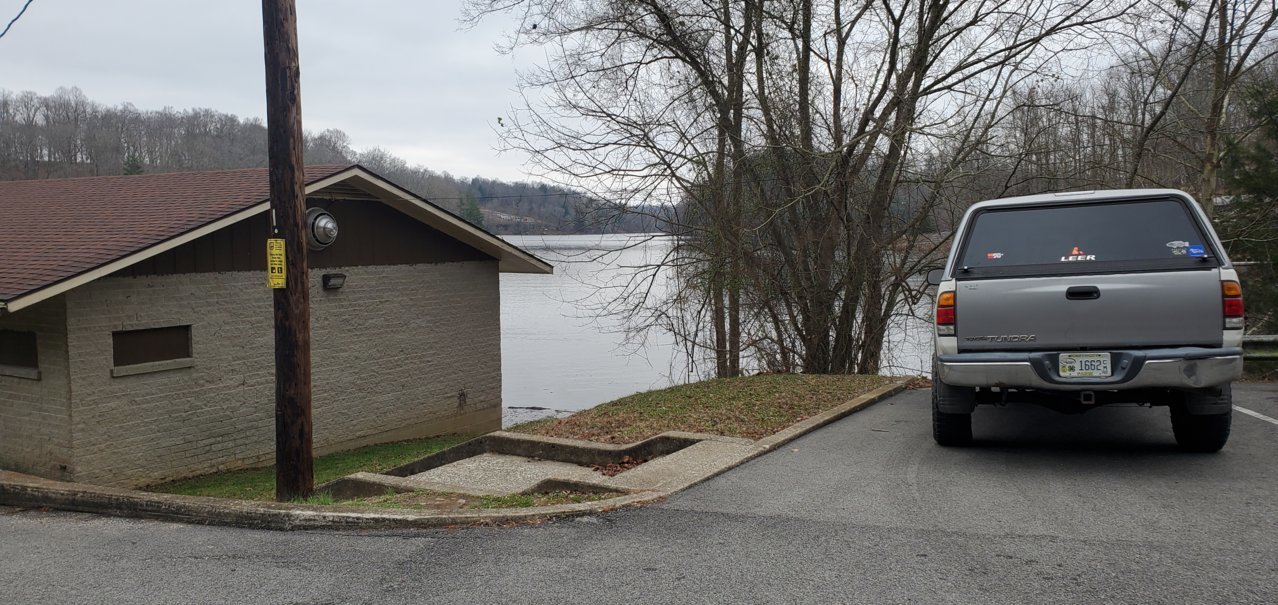

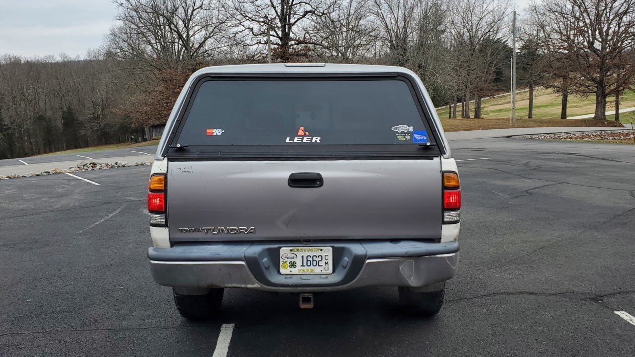

    Looks like it's leaning because the parking lot isn't flat.

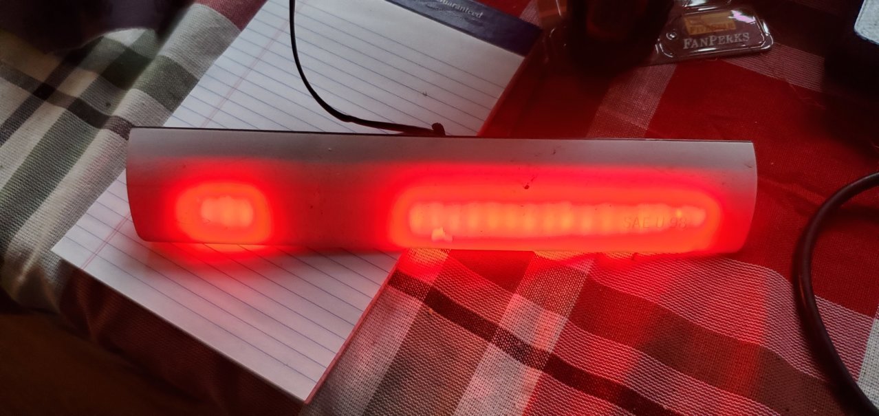

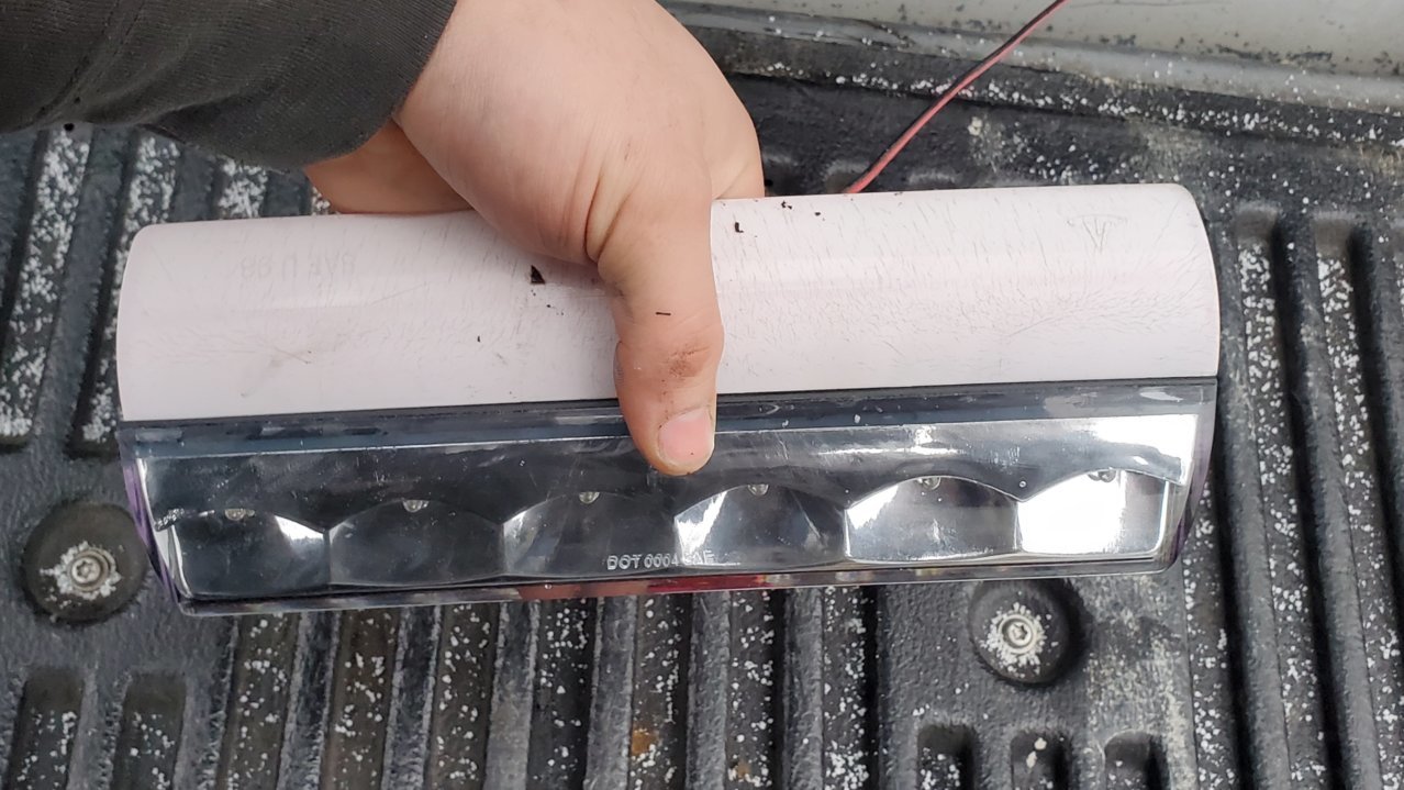

    For giggles, I hooked up the old high mount light to a battery. Lo, and behold it did work mostly. Guess the old pins were corroded. Glad I replaced it anyways.
    @daveeasa, I like the output of this one better, but you can see the sun damage on it. I can't imagine how it would be on your western side of the country.

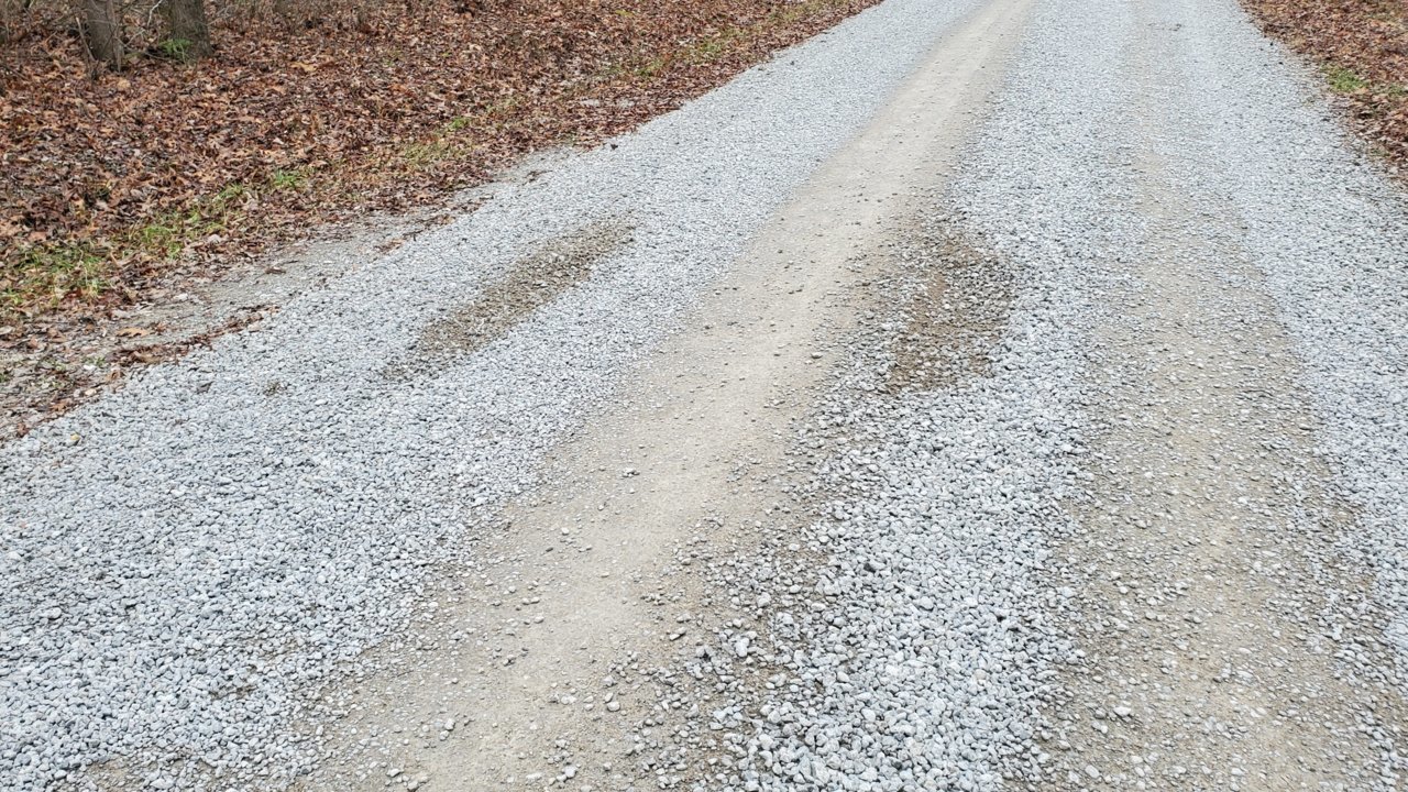

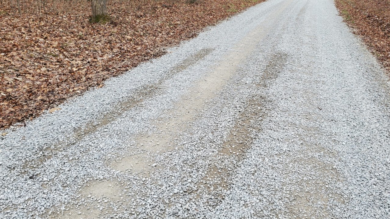

    Also, found a nice deserted gravel road for some 4WD testing.
    4WD:
    Truck:
    2WD:
    I'd say everything is working proper!

    Man. Looks like that thing never got a dose of 303 to give it some UV protection....
    Tundra2[QUOTED][OP] likes this.
  27. Jan 3, 2022 at 1:01 PM
    #1557
    Tundra2
    Tundra2 [OP] Zoinked
    Feb 10, 2019
    #25875
    12,460
    Noah
    Western Kentucky
    Agreed. I kept scraping and scraping and scraping with my pocket knife to see if I could get down to some red plastic again. I couldn't. That's the little bright spot you see on the left side of the right hand strip that's lit up.
    Next time I would go back with one of these, but not until the other one just outright quits or gets water in it.
    303 FTW!

    Any plans for dealing with the mis-colored tailgate or do you plan to ride ghetto indefinitely? :D

    Eventually this tailgate will go back to the V6 and then a new to me tailgate will live on crackie.
