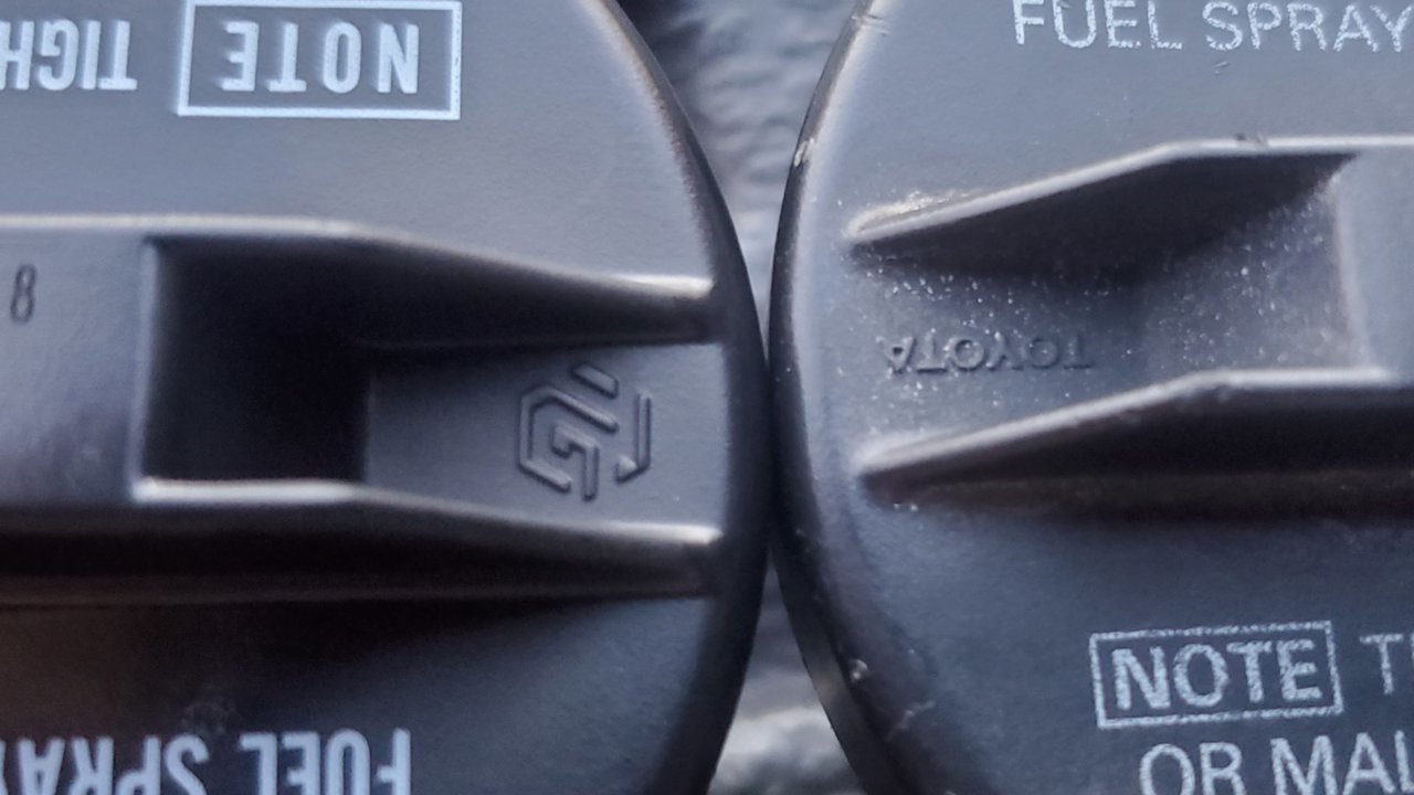

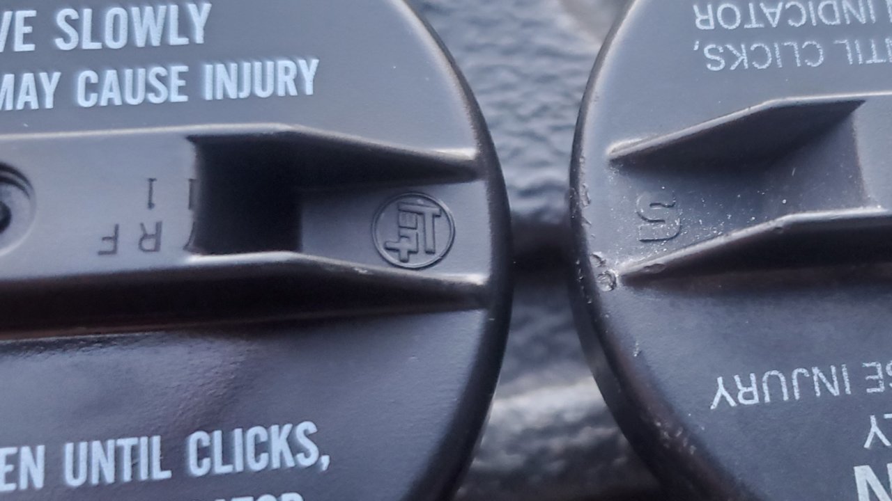

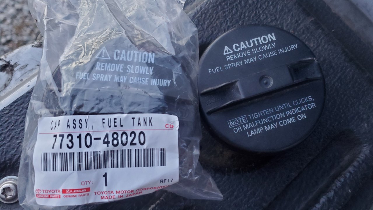

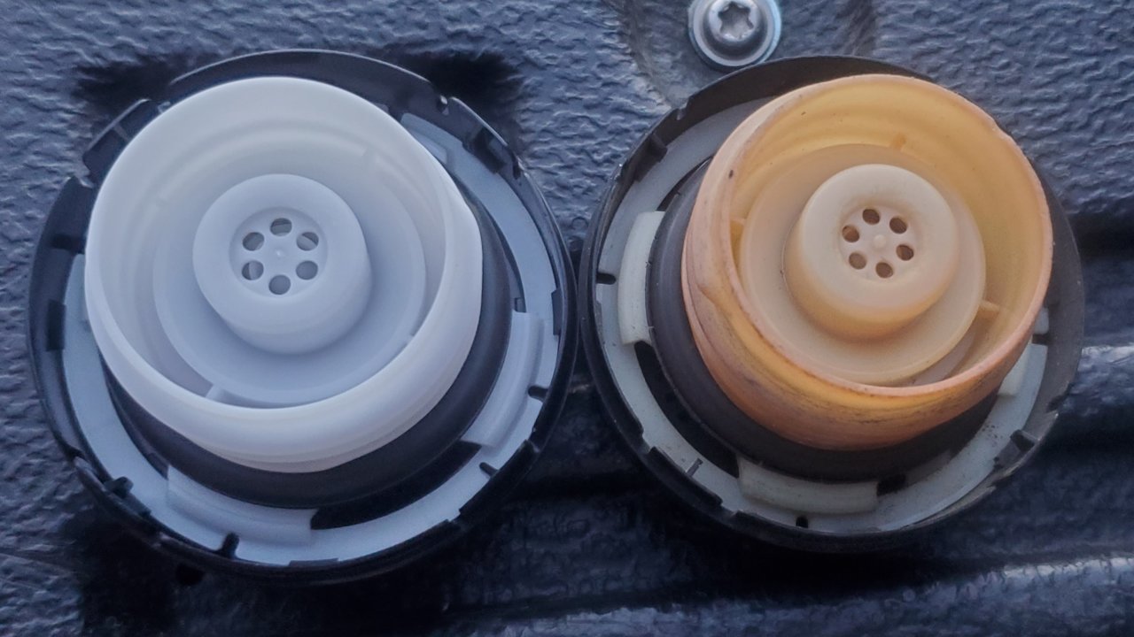

    New gas cap today. Subtle differences between 21 year old, and new OEM. New on left. Old on right in all pictures.
    Old cap says toyota, new cap says Toyoda Gosei. (TG) I can't escape that place, GAH! LOL
    Old cap says whatever that S thing is, and new cap says Teq.

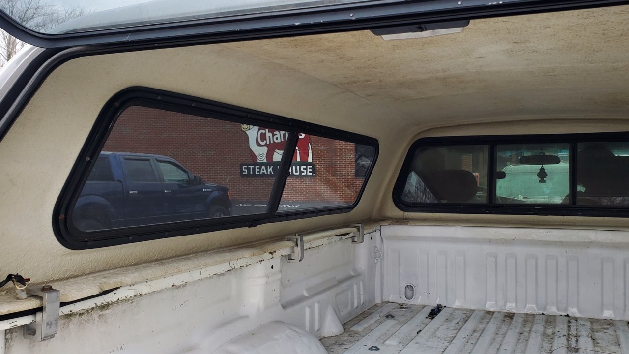

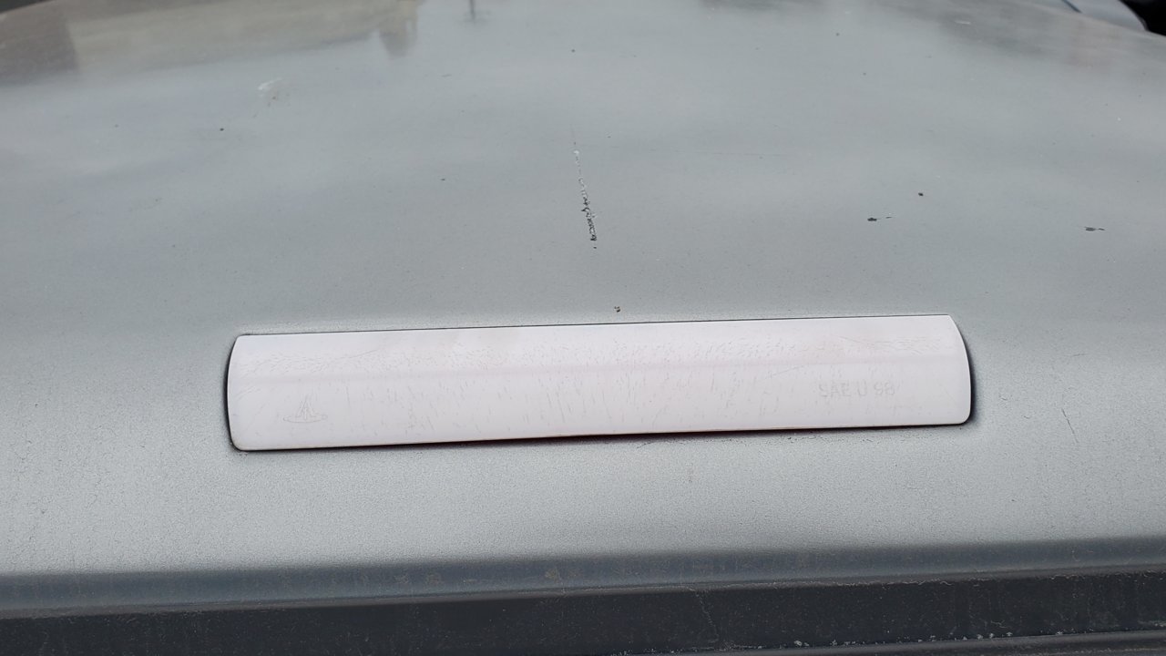

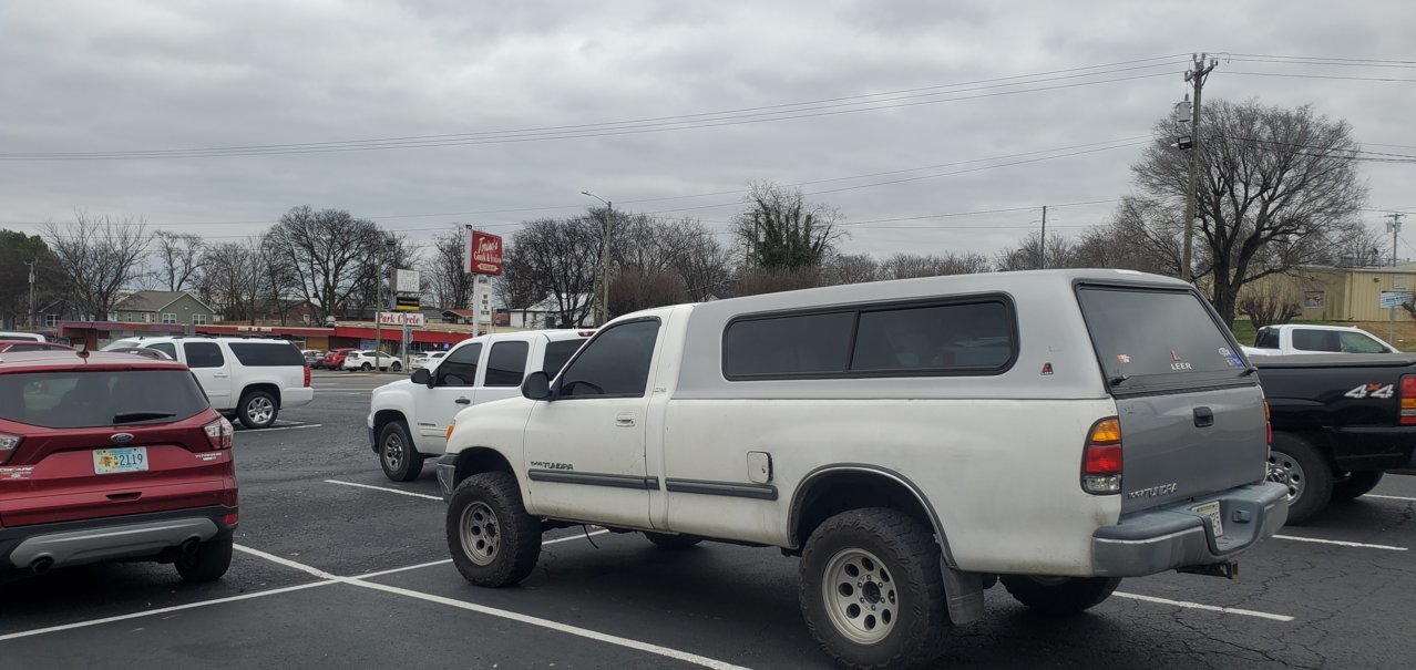

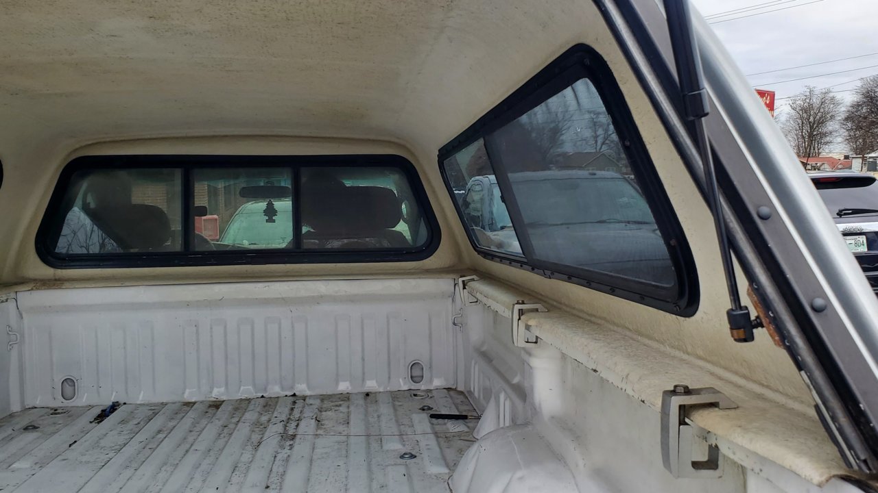

    Little bro and I headed south this morning to pick up a special item for crackie....
    Well today was the day! The picture below is in @Rocinetti's driveway. I bought this shell from him. Super happy with the purchase.
    Three hours down, and about 15 minutes to load up, clamped down, then a few more hours to meander on back home... here's some pictures from our walkabout...
    Little bro decided it was nap time on our trip home... I couldn't, just not take a picture.
    Anyways, back to truck stuff..
    The brake light assembly is bad, and I have another one on order. The reviews are mostly OK. I'll have to seal this up with some flex shot or something before I can mount it.
    Linky
    Gratuitous roof picture.

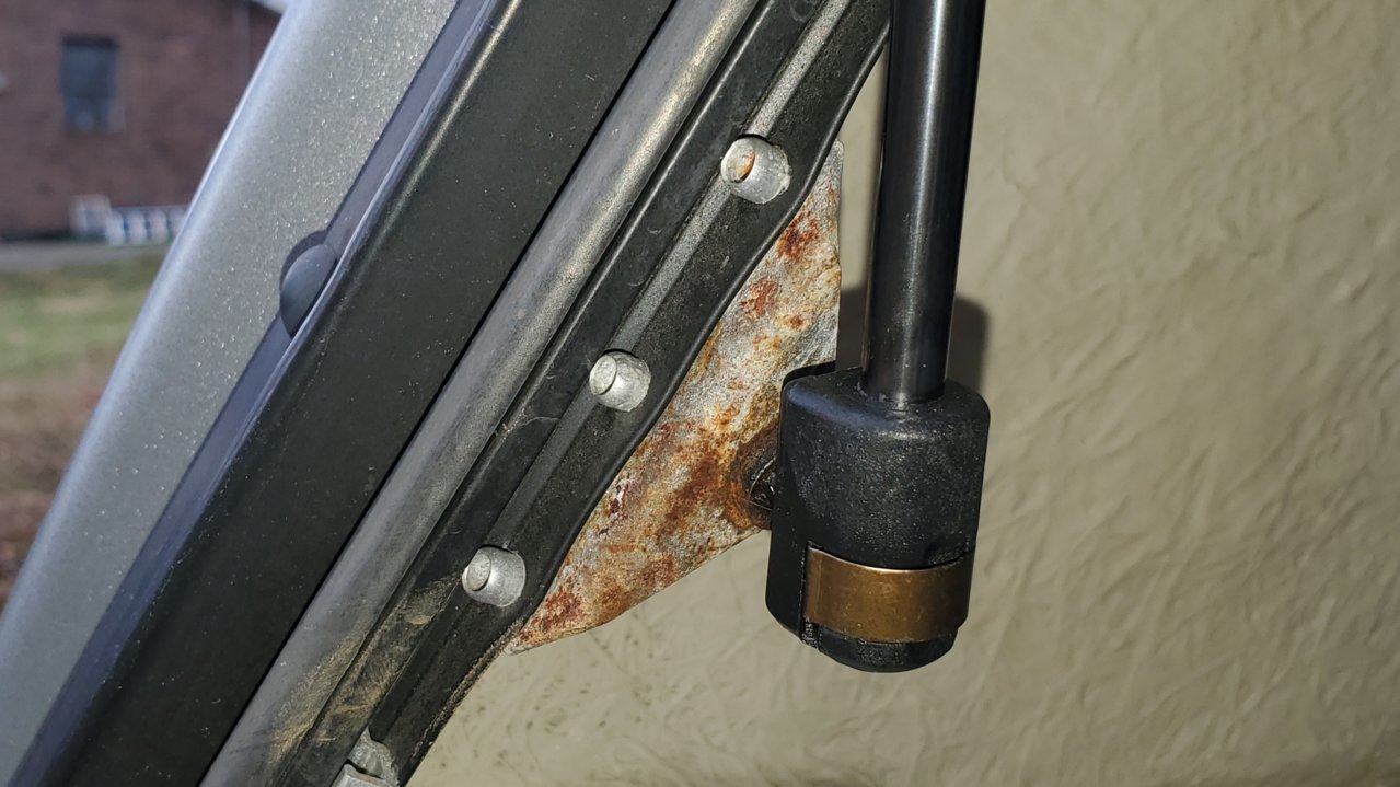

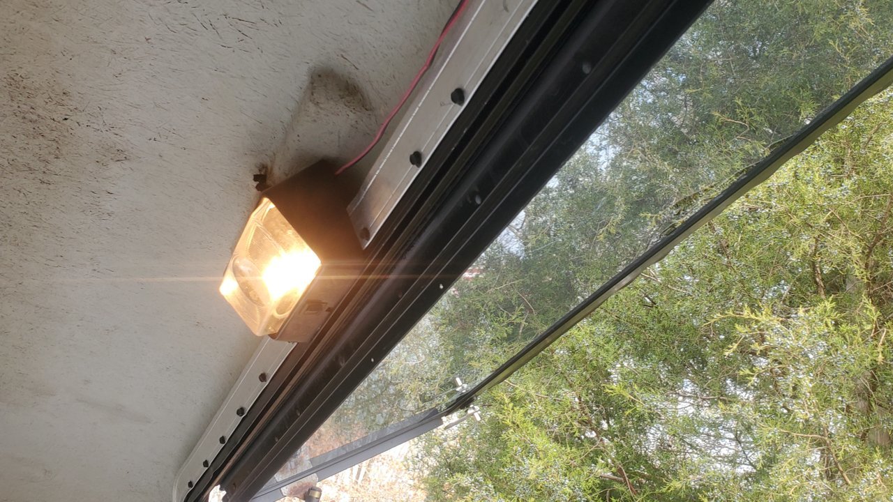

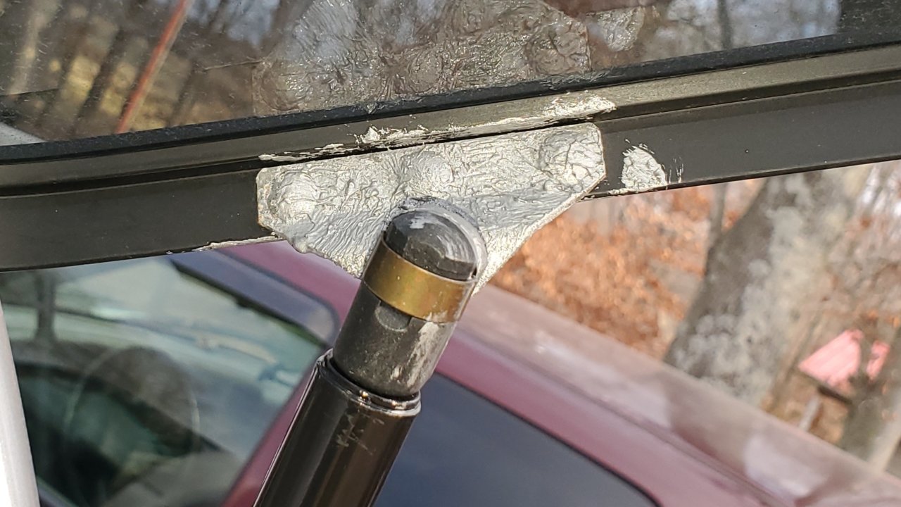

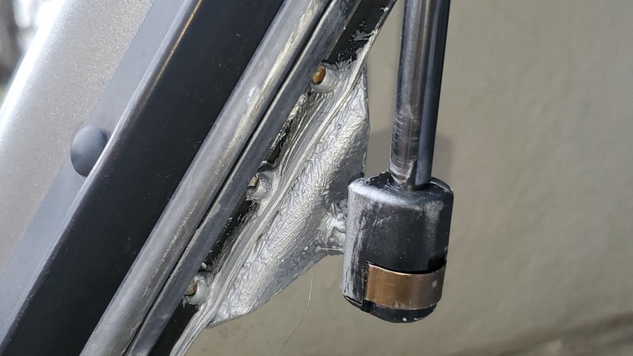

    This Cappppp not only came with brand new gas lift struts, the original leer clamps, but with pigtail for hooking up the interior light, and the brake light. The interior light does work, but the brake light does not work. Hence the linked part above...
    Needs an LED which I just happen to have a spare VLEDS wedge bulb laying around...
    This is also my 8,000th post here on the forum, and I'm so happy to be a part of this community. I originally wanted it to be a merry Christmas message on the Best Gen lunchtable page, but I'm fuckin impatient. Lol

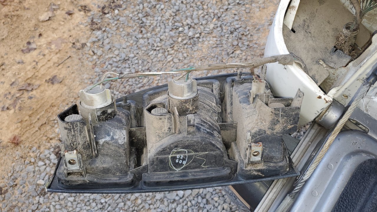

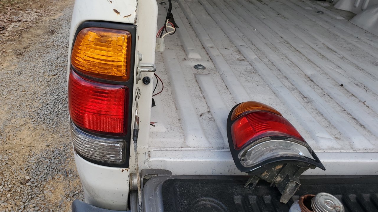

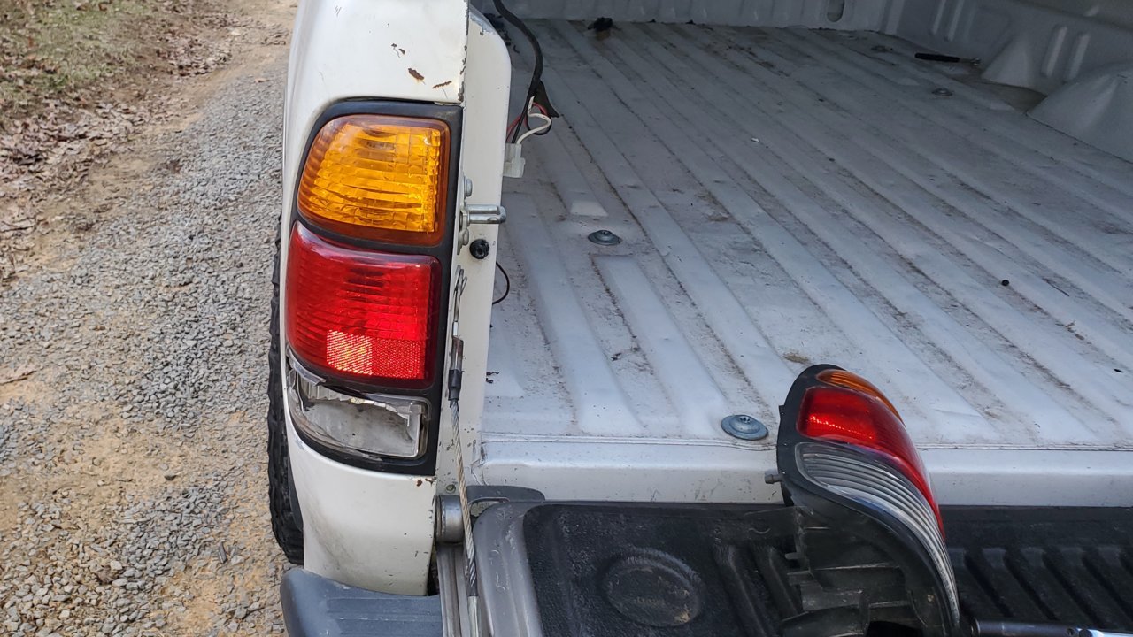

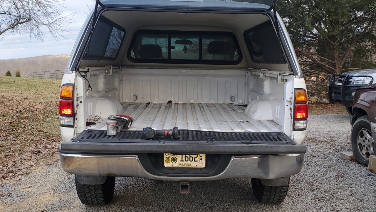

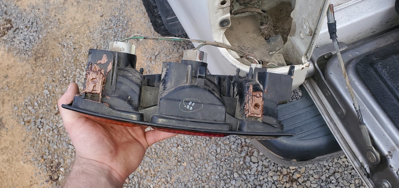

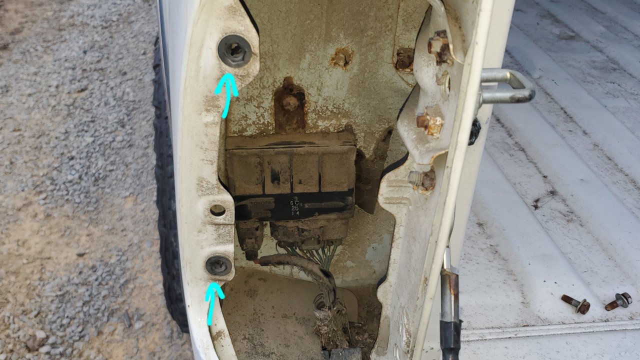

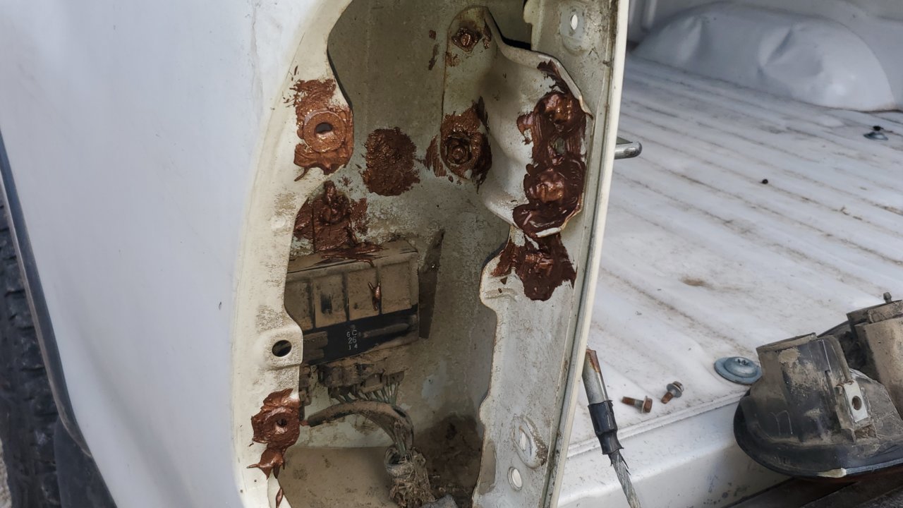

    Went out to change one tail light on the drivers side. Already had this one from the V6.
    Old tail light.

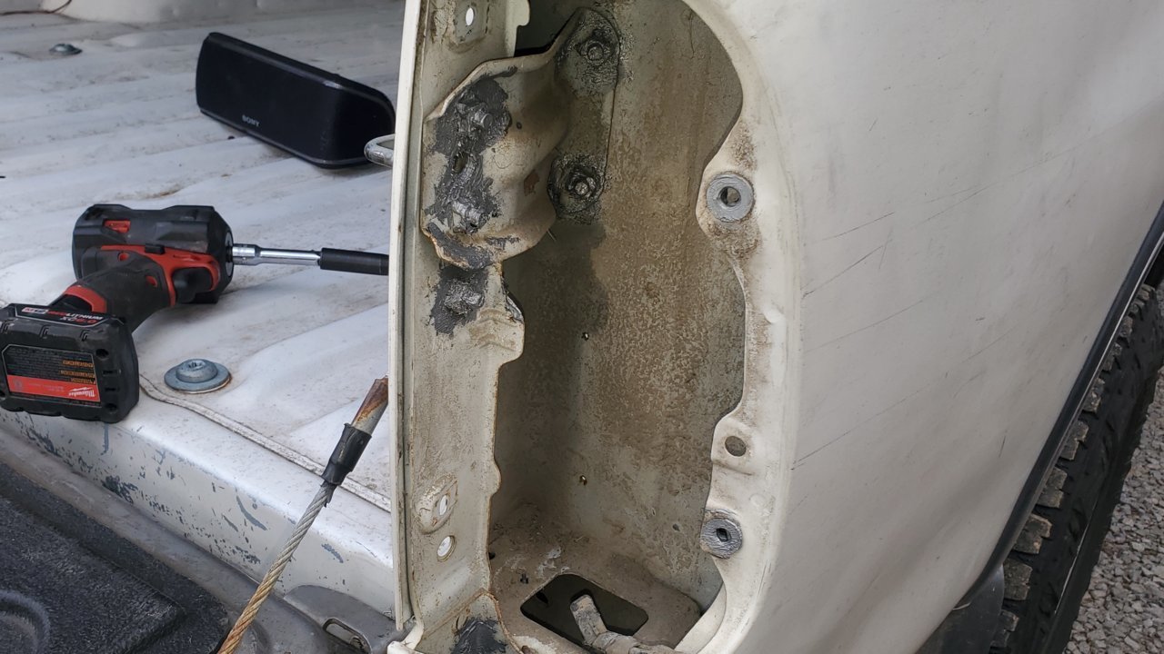

    I was surprised to see the wiring intact, and not fuckered. Also surprised that the tail light grommets appeared to be in good shape. Look at that rust in there. :rofl:

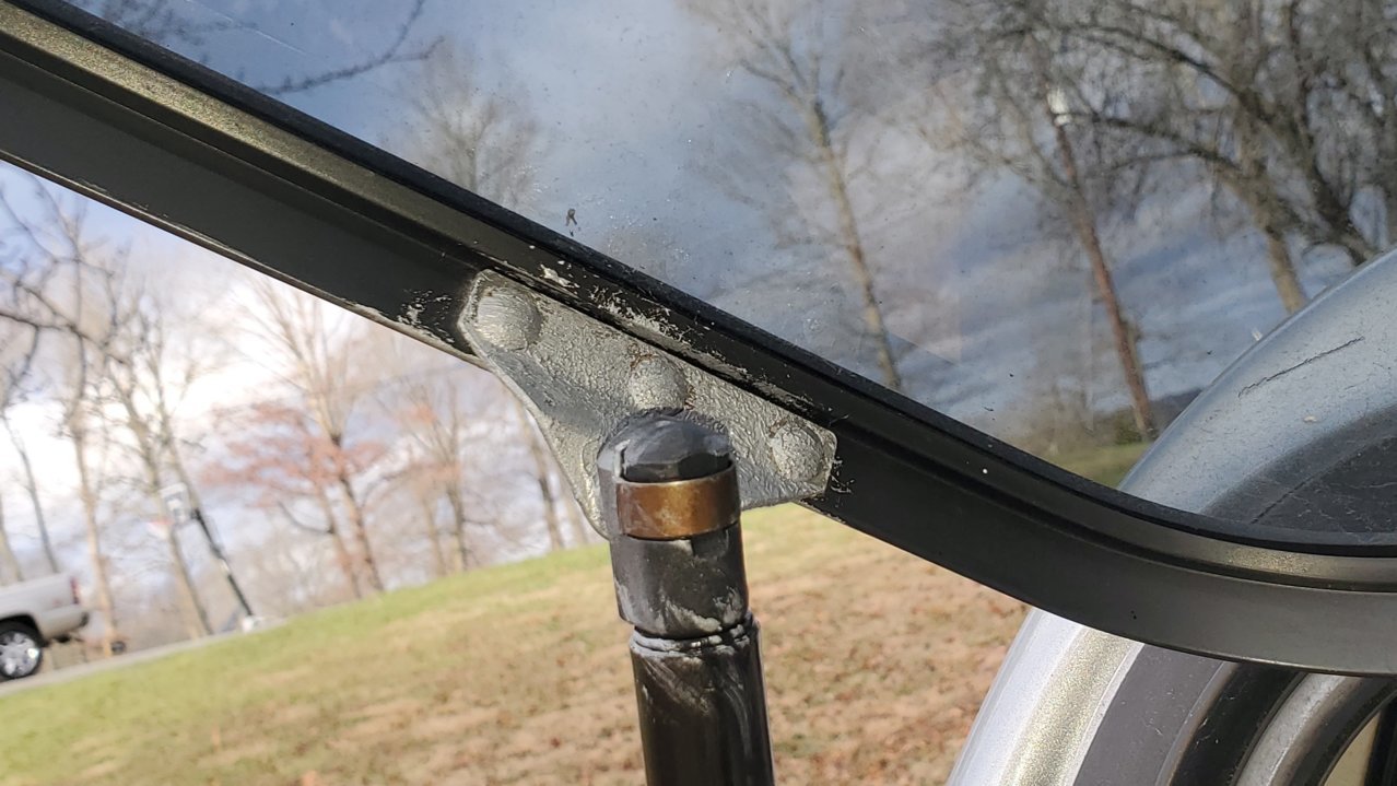

    Slathered some copper anti-sneeze on the rust, and the metal nut clips on the tail light. Really don't care what this looks like inside there. That box in the tail light cavity is for the towing harness, yes?
    Newness! Hells yeah!
    Also decided to do the passengers side while out here. Got the fancy silver since I was going to clean up a little bit of rust on the topper.
    I figured a light covering on the brackets would be fine since it was just surface rust.

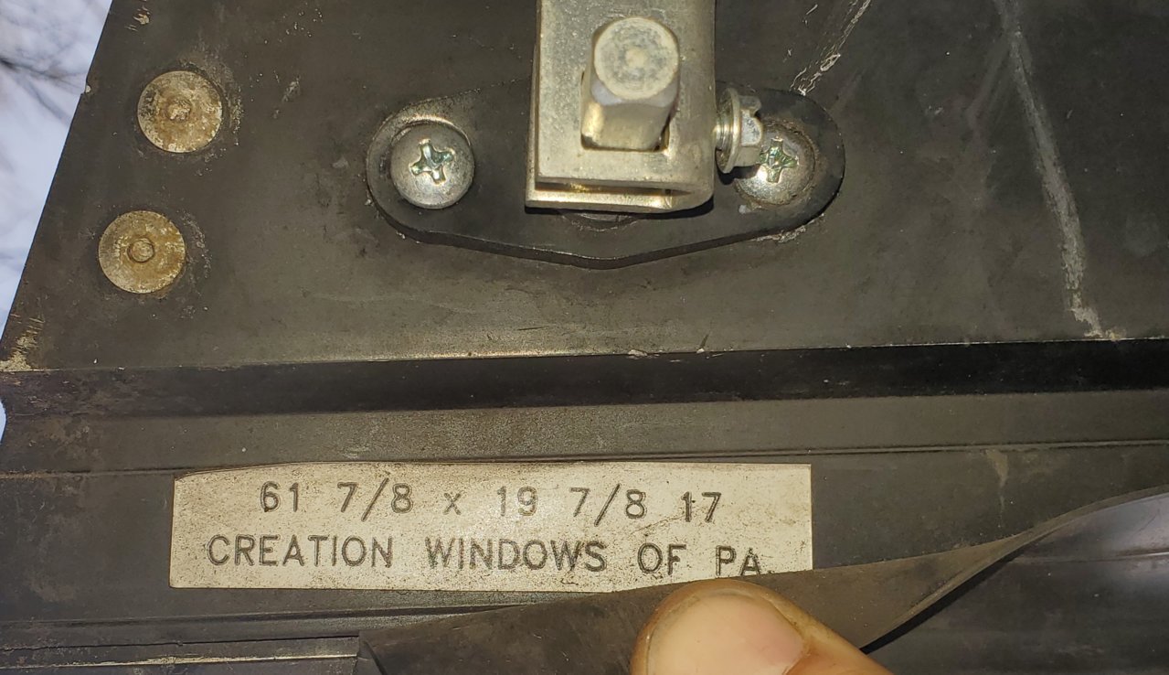

    Also noticed the window size sticker had a location on it.

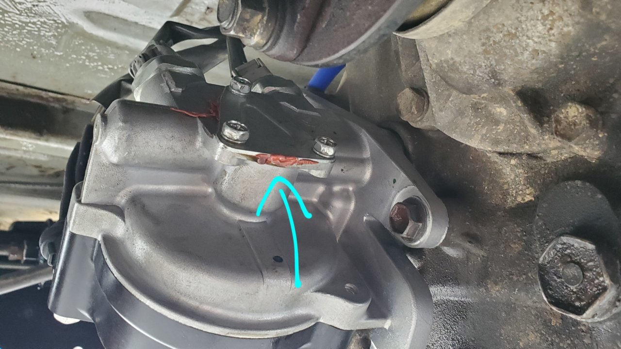

    Inching closer on the 4WD. Pulled rear actuator off the truck, and then reset the xfr case shaft to 2wd. Spun the front drive shaft by hand with the front end lifted off the ground.
    Put actuator back on, and pressed the button with the engine off, but truck on. Heard everything move, and then blinky light.... crawled under, and could not spin drive shaft by hand.
    Lowered truck, and pressed button to go back to 2wd. Crawled under. Spun shaft by hand. Turned truck over, and let warm up.
    Put it in drive, and went down the driveway about 10 mph pressed button. Shifted and...... blinky light. Crawled under. Could not spin shaft by hand.
    What gives? Front ADD thing now?

    Is it locking to the xfer or the diff?

    How do I tell the difference? One of them is locking for sure, but I am not sure how to differentiate between the two...

    So after actuating the 4WD a few times while in motion it eventually popped into 4WD. @Sirfive was correct. The steering definitely gets firmer on 4WD.
    I was able to go in and out of 4HI, and in and out of 4LO. That truck feels like it could pull a fucking stump out of the ground in 4LO.

    So what was it that made it work? Rotating the 4WD shaft?
    Tundra2[OP] likes this.
  27. Dec 25, 2021 at 9:41 AM
    #1497

    I think I had the position of the shaft coming out of the xfr case in the wrong spot. When I was unbolting the actuator, the shaft was pushing the actuator away from xfr case.
    Indicating that I had the gear on the servo motor on the actuator in the wrong spot. So once I pulled the gear out, and put the actuator back on, plopped the gear in, and bolted it up it was in the correct position.
    Now, something I noticed on the old actuator, but didn't say anything because "bad actuator" was a small amount of what I think is Xfr case oil was where the gear is on the actuator. When I pulled the actuator off this time there was the same amount of oil inside the actuator where the gear is.
    I assume that's normal, and that's why there is a seal on the access plate for the gear. Maybe @empty_lord could confirm when he gets a minute. I will get pictures to help clarify soon

    Oil from the Xfr case was in here where the servo actuates the shaft for the xfr case.
    Wasn't a lot, but it was enough to drip put once I spun the actuator around to take the gear out.
    All thoughts welcome.

    Yes gear oil gets there
