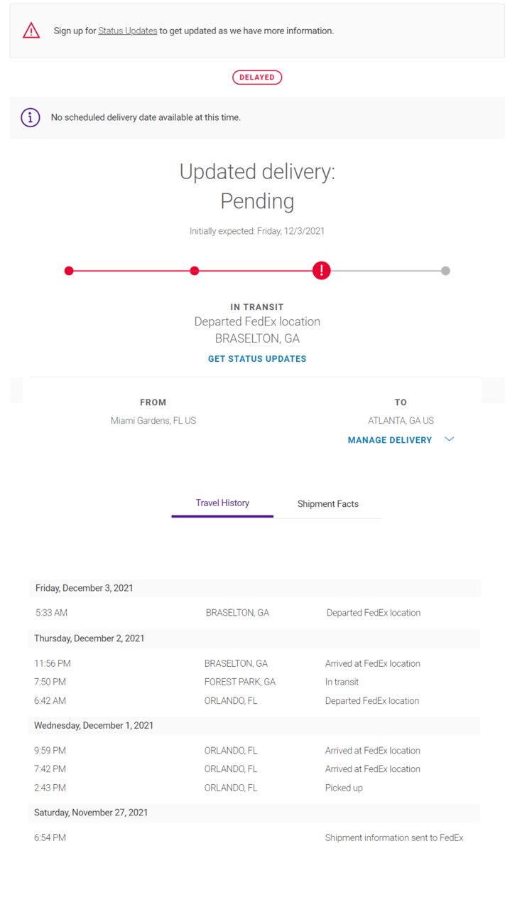

    Yup. Struggling w/FedEx now. Pretty sure this package is in the woods with a bunch of others. Gifts for the kids. Was going MIA -> ATL. Last stop is often Forest Park, then it's loaded onto the truck and delivered. Some reason, it went back on a truck and an hour north of town, up to Braselton. Guess they realized their mistake, put it back on the truck to go to Forest Park for fulfillment, but hasn't been seen since. Multi-fukkup from these jokers. I have zero doubts it's sitting in a stand of trees somewhere between Braselton and Atlanta. Meh.
    Tundra2[QUOTED][OP] likes this.

    My VLEDs package was like that. Real bumner. Well, I posted about it in the lunchtable thread sometime back, didn't I?
    Anyways, I did eventually receive it after contacting VLEDS. They issued a "trace" (think that's what they called it) with FedUp, and re-sent another package my way. Think they paid for express shipping because it was here much faster than the original estimate was
    Based on catext clues, I guess a trace is their way to cancel, and return product to their location?
    shifty`[QUOTED] likes this.

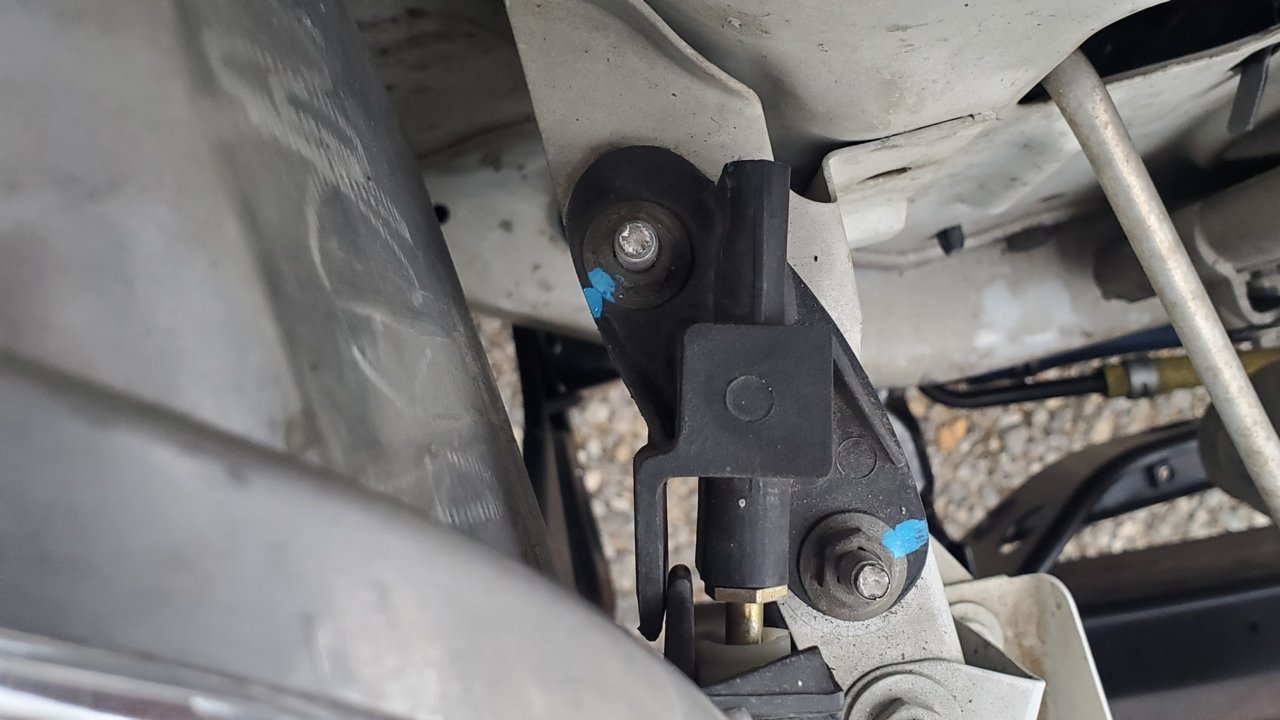

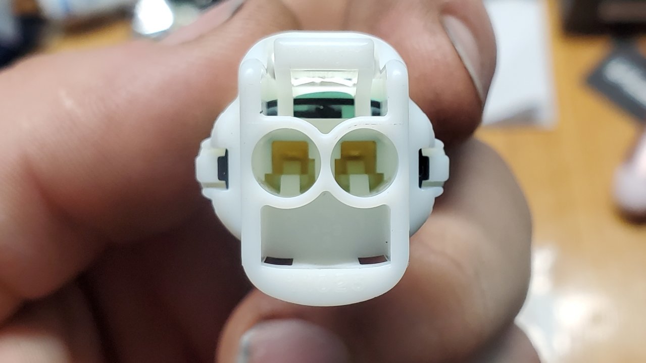

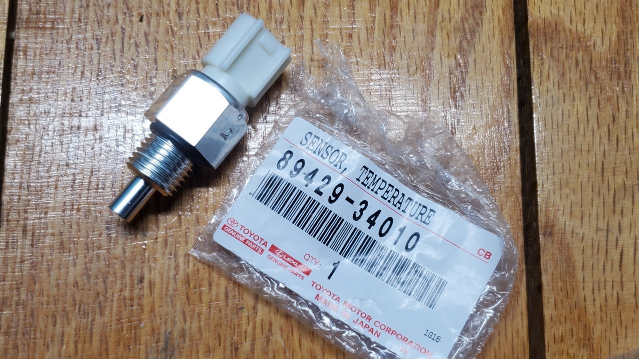

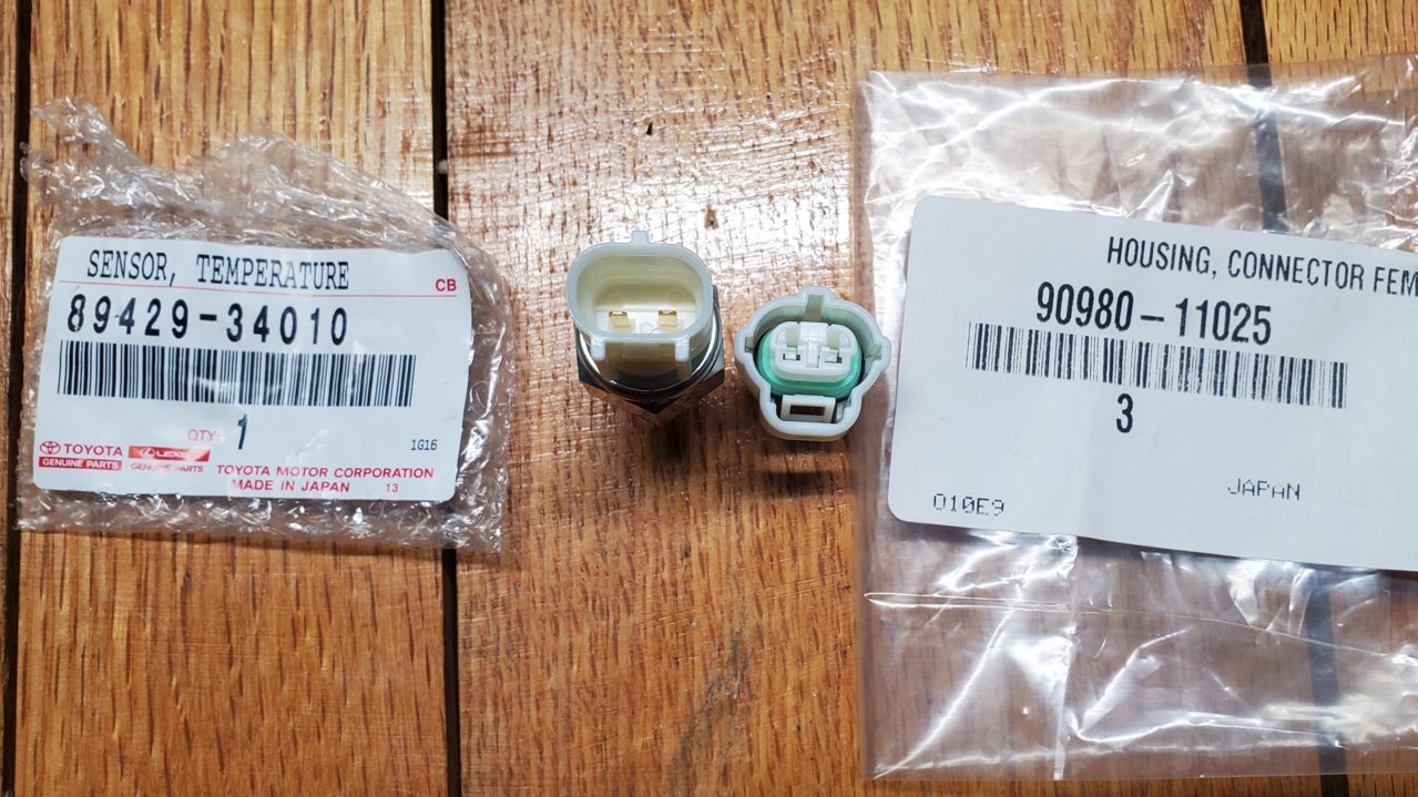

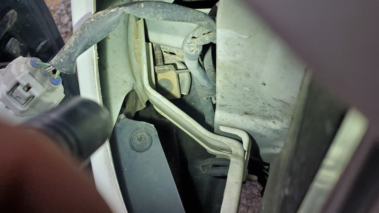

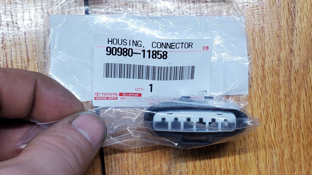

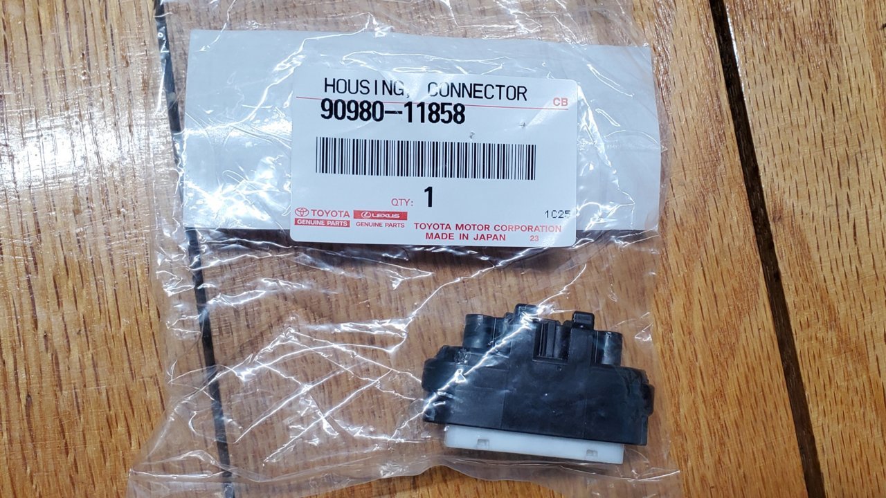

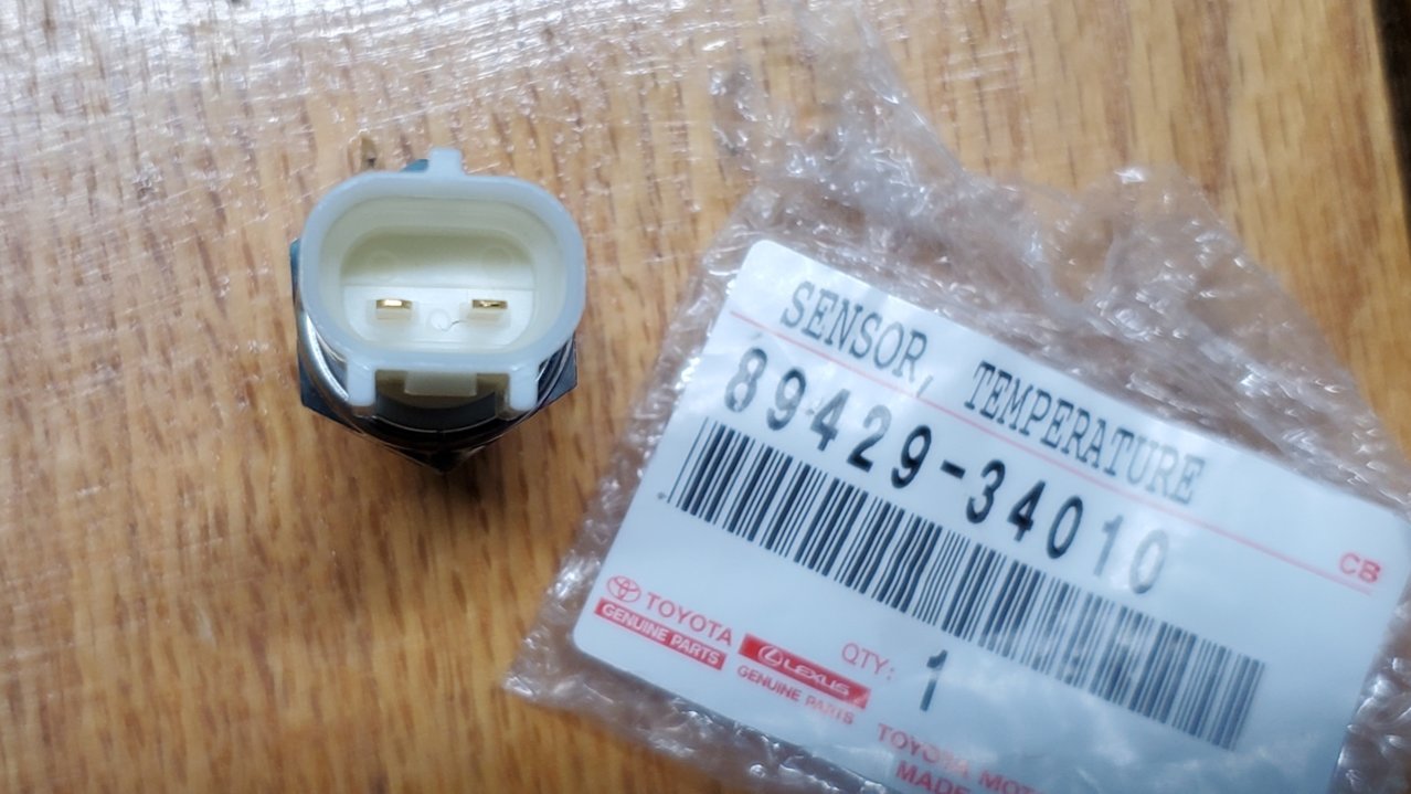

    4WD rear actuator connector.
    Transmission temp sensor with matching connector for the harness just in case I need it.
    Spare connector on the sensor

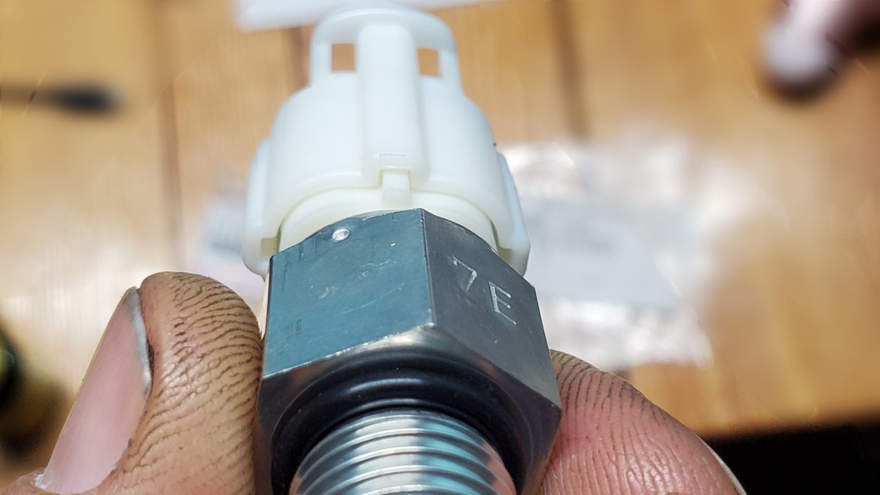

  13. Dec 10, 2021 at 4:27 AM
    #1393
    Tundra2
    Tundra2 [OP] Zoinked
    Feb 10, 2019
    #25875
    12,460
    Noah
    Western Kentucky

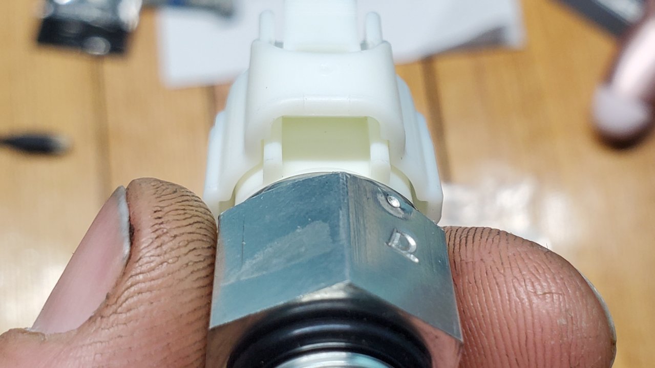

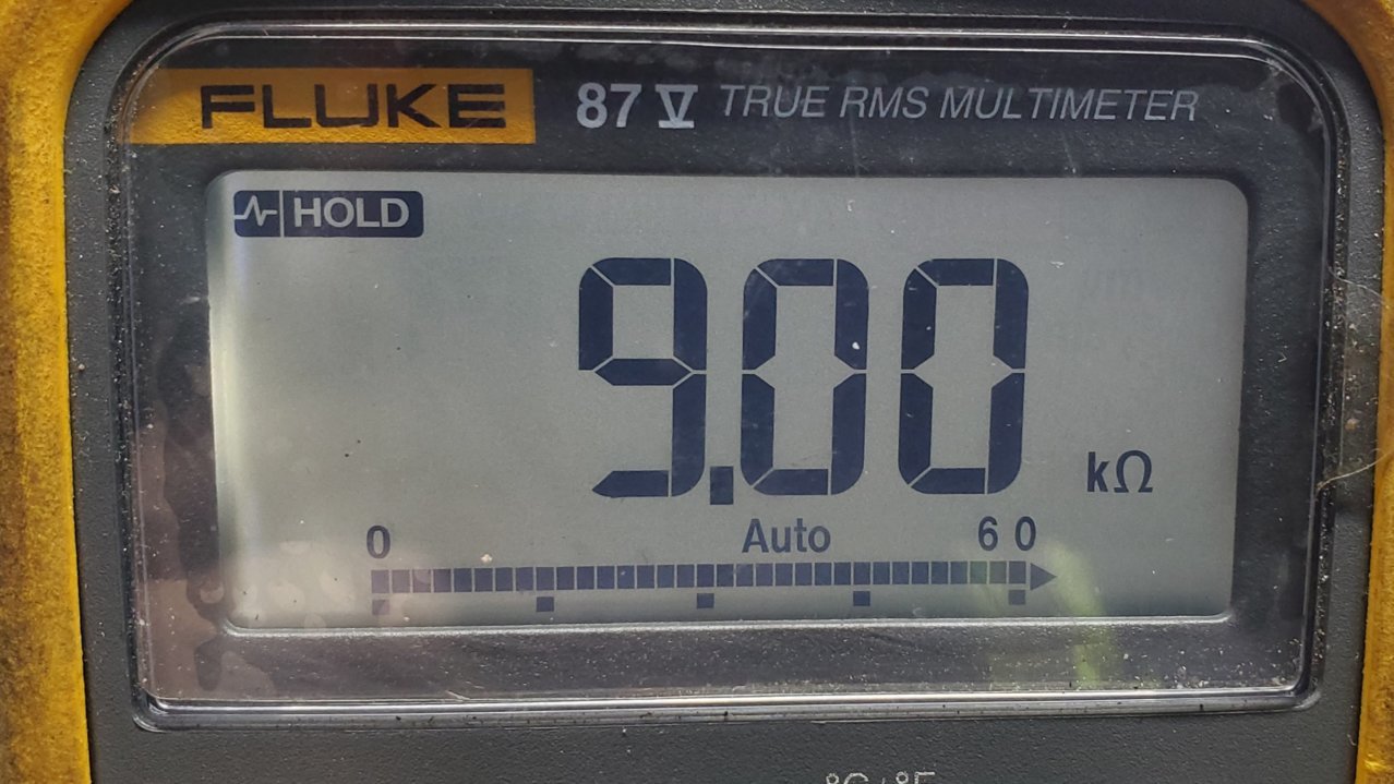

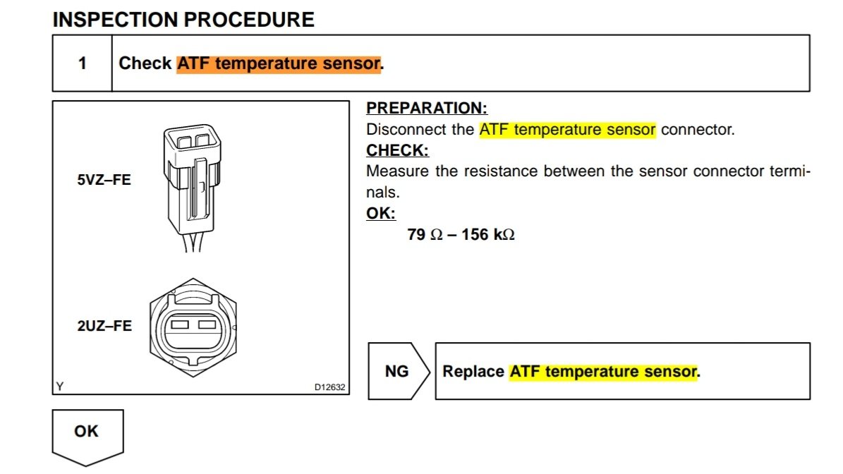

    New temp sensor checks as good if electrical brain maths are working. Room temp currently (70°F.)
    bmf4069 likes this.

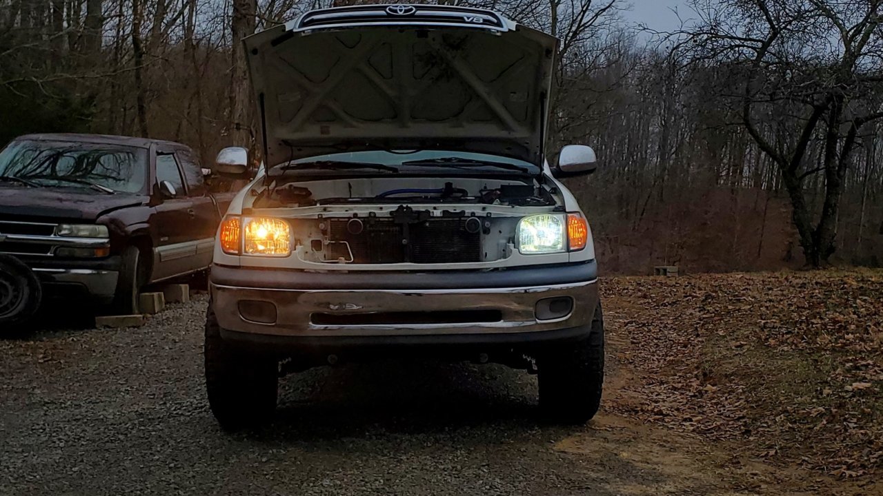

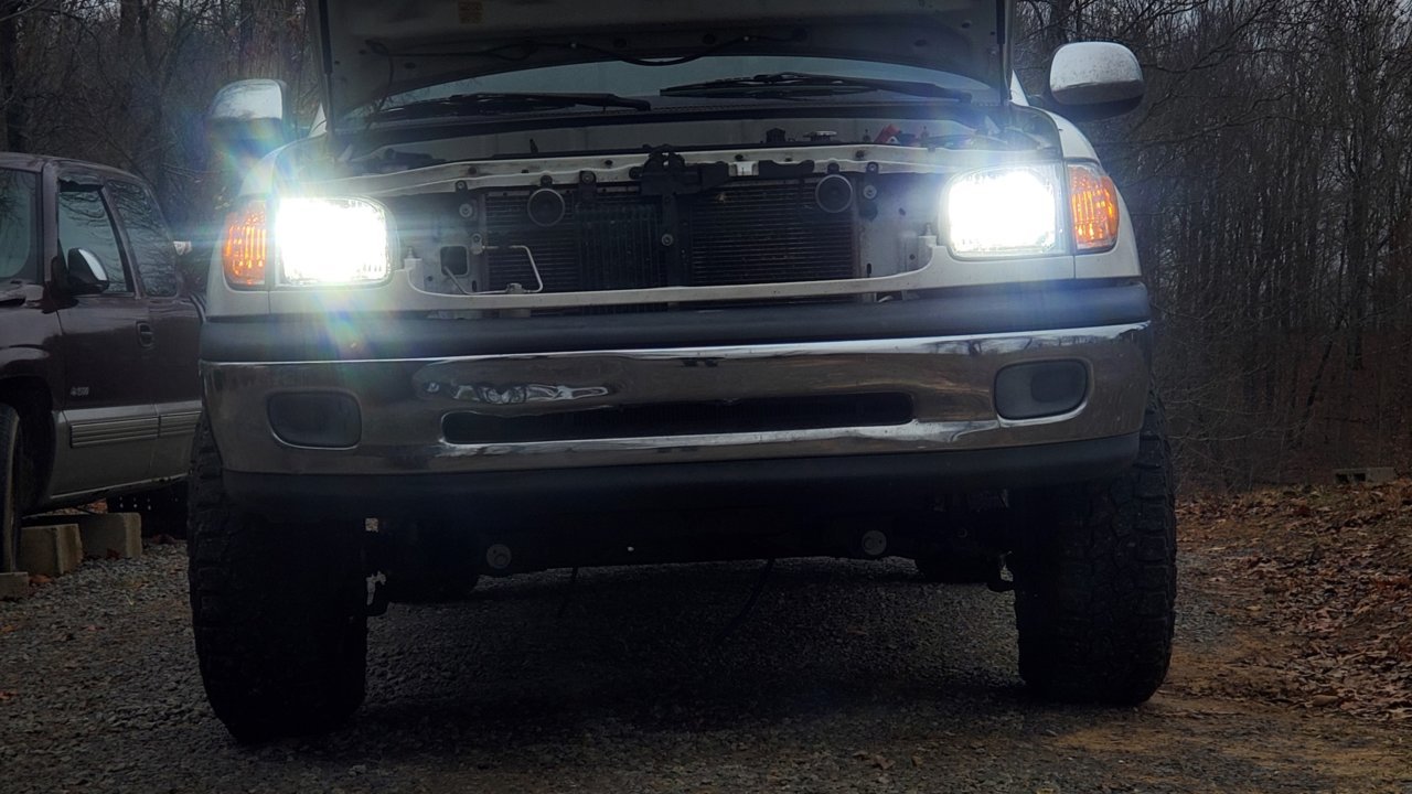

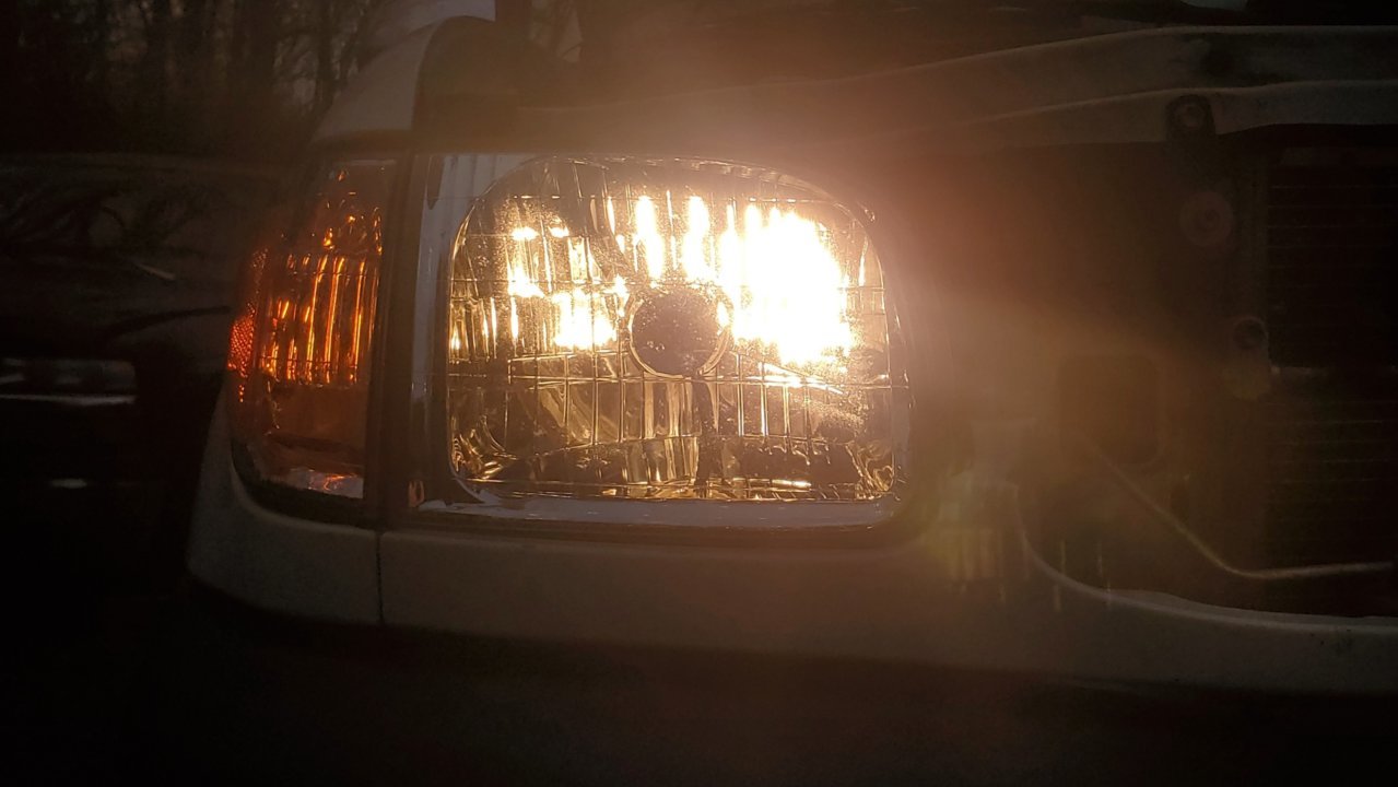

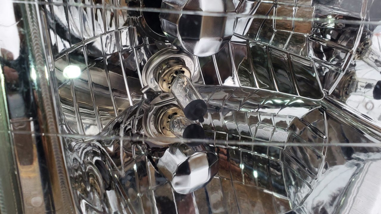

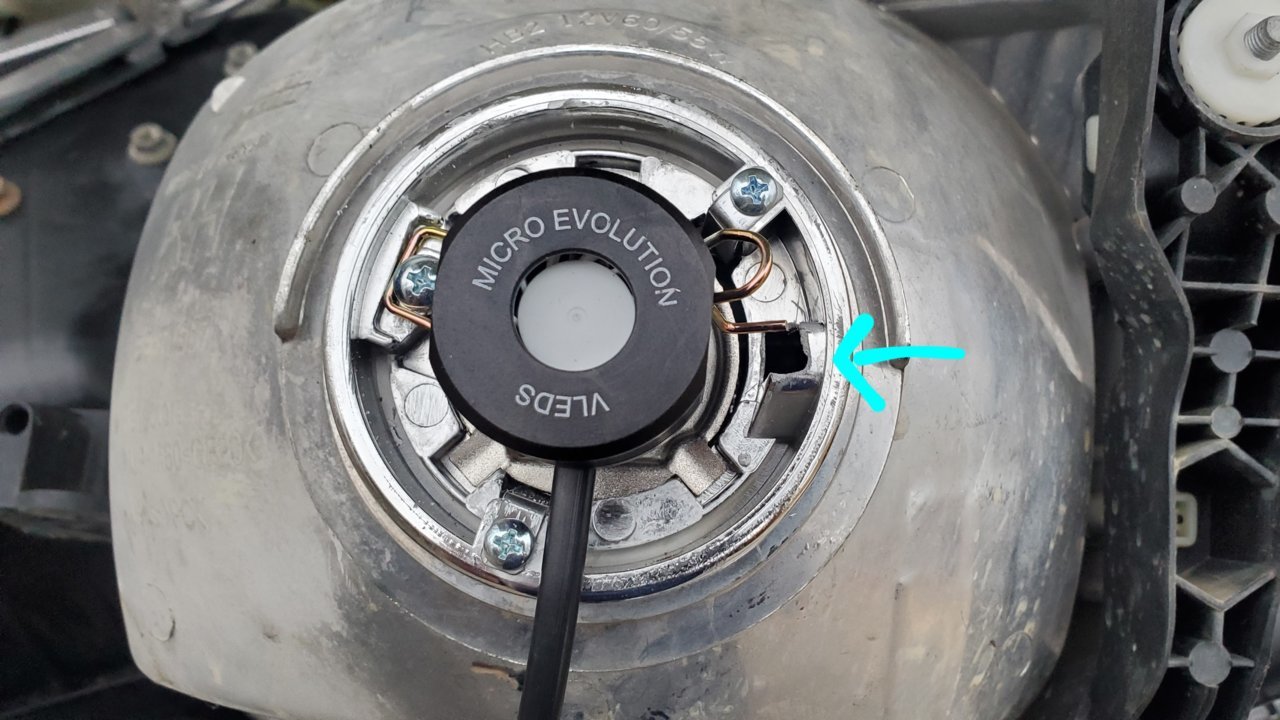

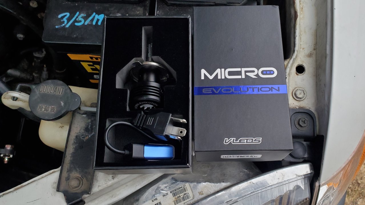

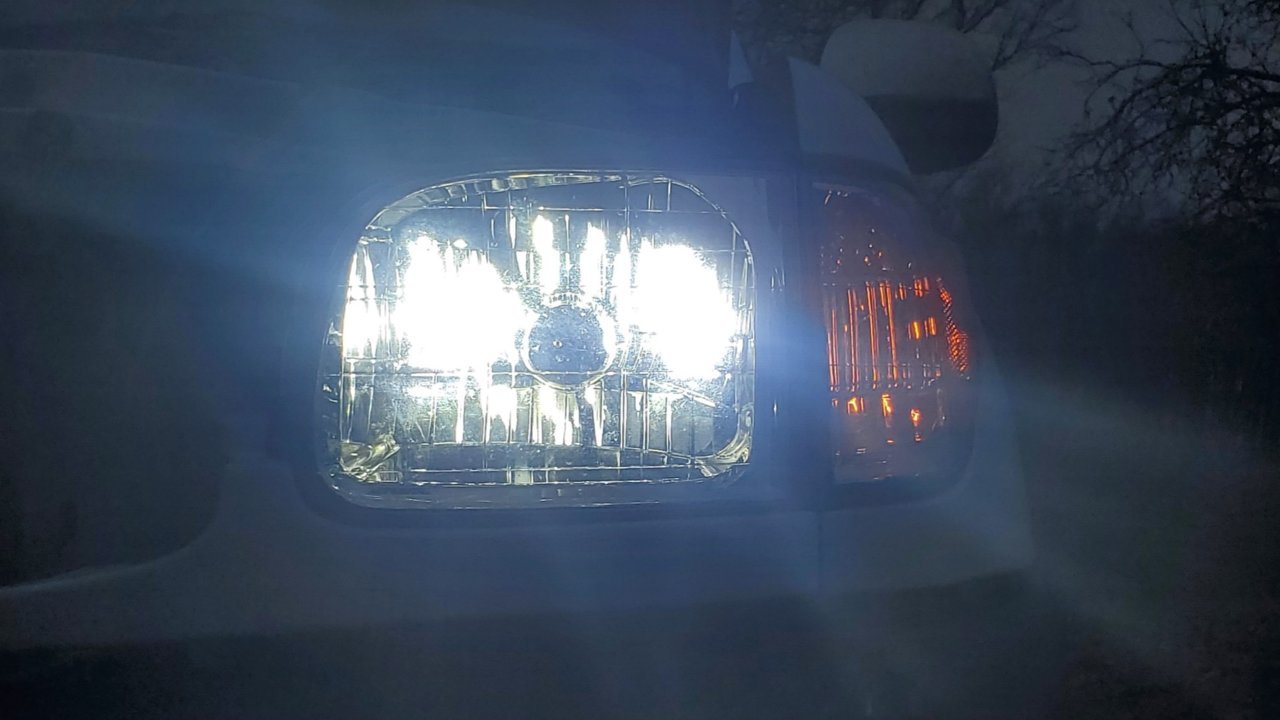

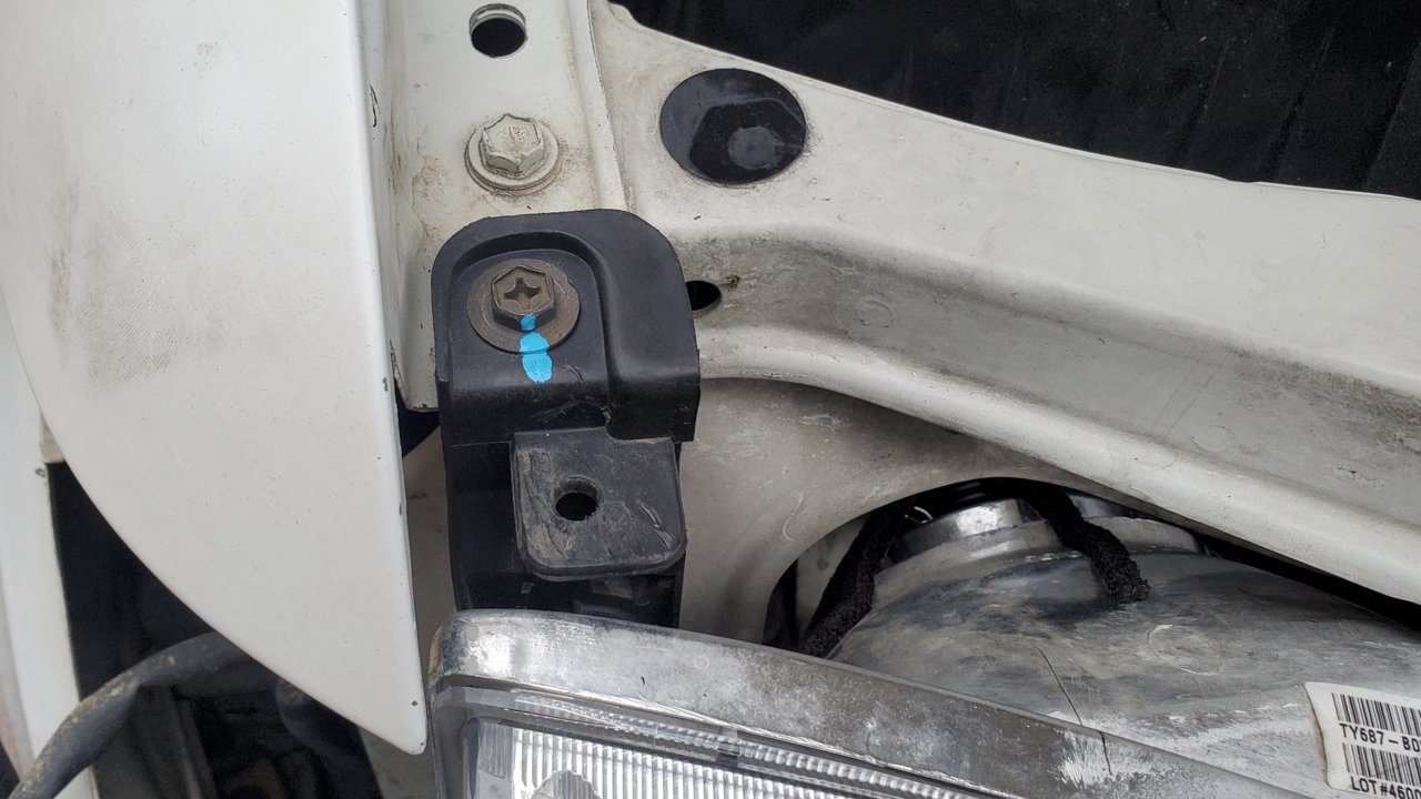

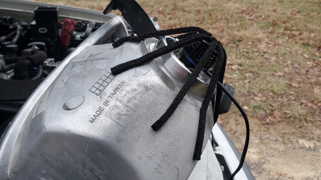

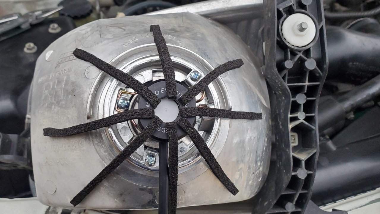

    Pulled crackie out of the tent of pain, and into the driveway. Pre-flight checklist engaged, and checked off.
    Quick reward style upgrade to LED with no resistors currently. Need one as no high beams indicator with High dolla VLEDS.
    As always, drivers side was routine. Passengers side? It was cracked up like crystal methany. Whoever had this before me used the metal tensioner, and the rubber boot to hold the the headlight bulb in. No pics because was fighting to remove. Then this happened...
    Removed headlight, and was able to fish it out.

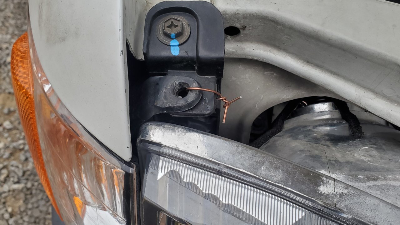

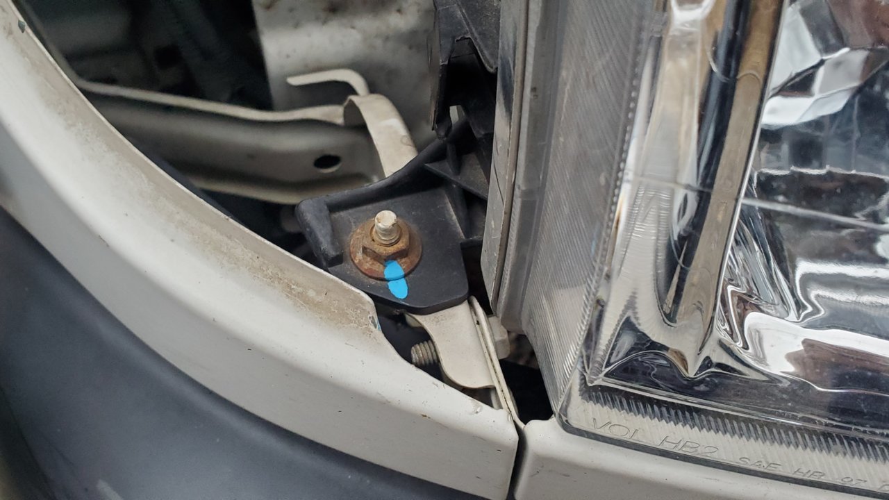

    Then I just happened to notice the top bumper mount on the body was not mounted. Unsure if this is crack-tivities or Toyota. Threads look shiny as if it was done recently. I'd bet Toyota.
    Broken bulb tensioner holder...
    Unfortunately, crack-tivites begets more crack-tivities on the short term. Used sticky weatherstrip sponges to hold the bulb in place.
    Added "torque identifiers" to the nuts/bolt.
    The money shot...
    Hunted for zipties with no success, but I did find a piece of mig wire from work. One last crack-tivity. Sigh.

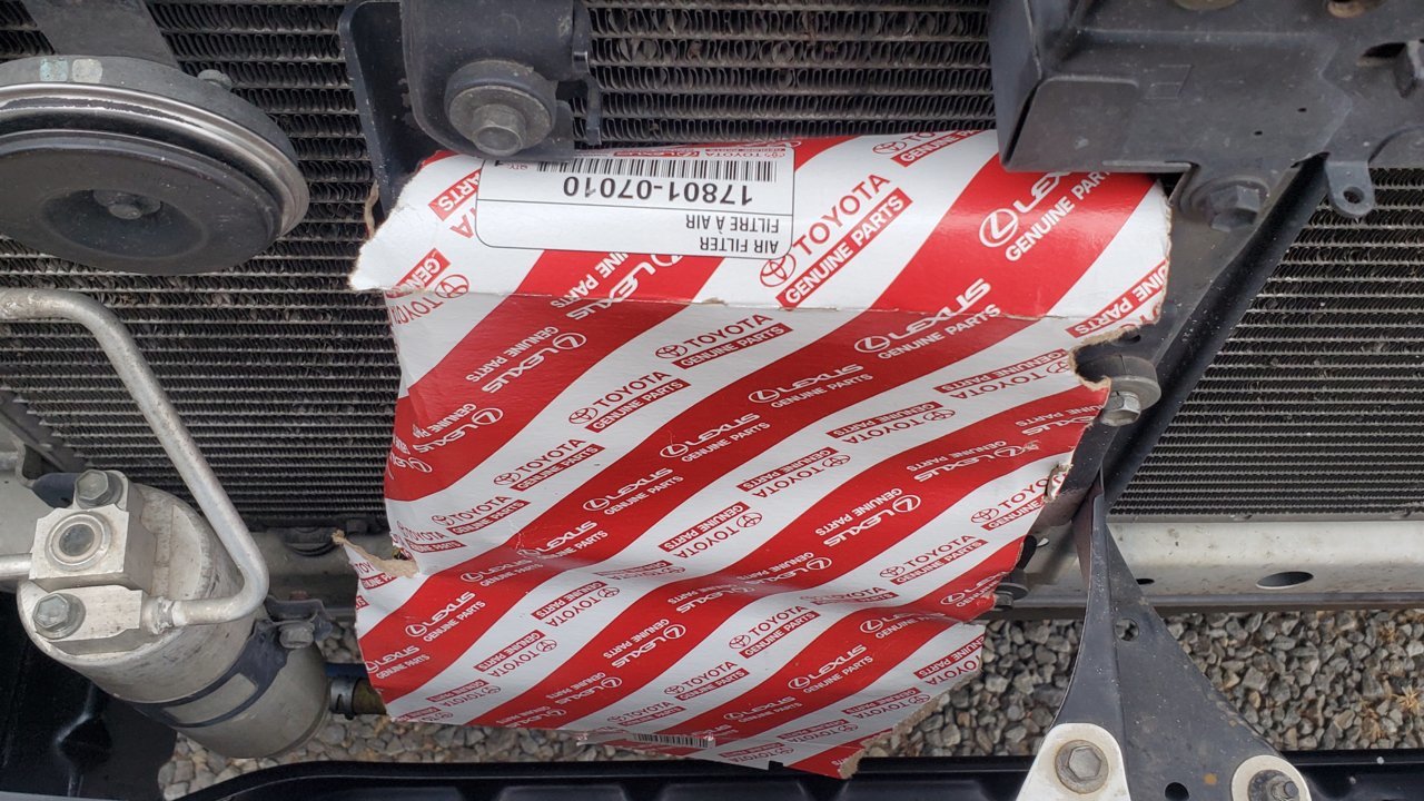

    Finally, the icing on the cake, the pièce de résistance...
    Found that box on the street corner so to speak... ;)

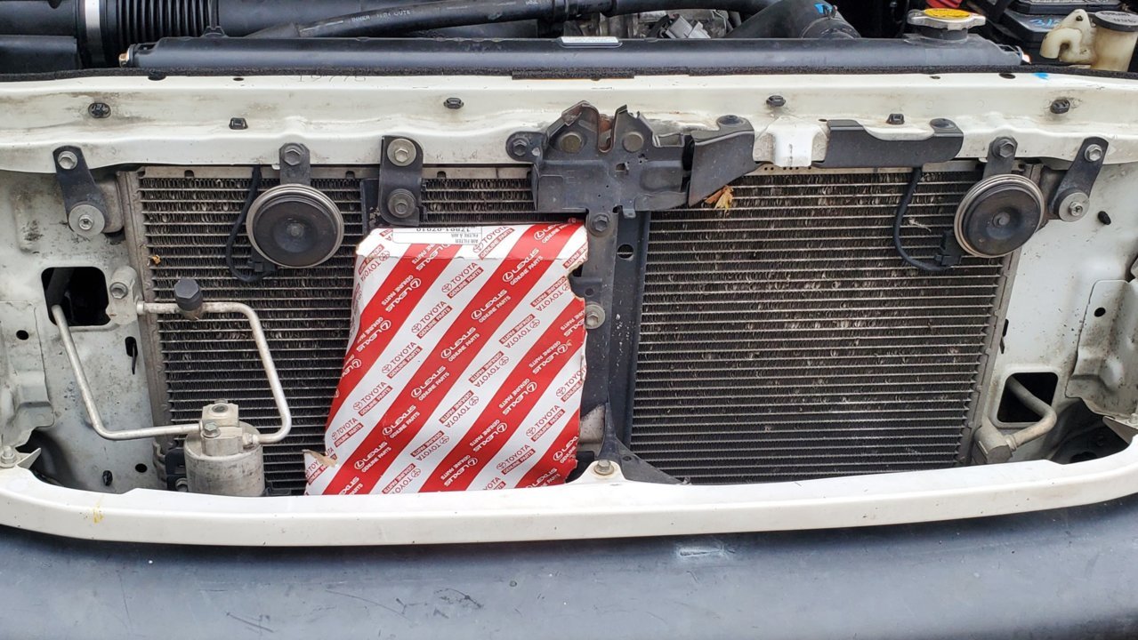

  15. Dec 10, 2021 at 6:34 AM
    #1395
    Punk1974
    Punk1974 former 2000 owner looking for a fg tunny project
    Nov 19, 2018
    #21934
    293
    J.P.
    2019 Silver Limited CM TuRD
    Bak Flip MX4 Tonneau cover, Spray in Bedliner, Tube steps, stubby antenna, red rear sway bar, looking to get back into a first gen tunny
    omglolzzz
    Tundra2[OP] likes this.
  16. Dec 10, 2021 at 7:09 AM
    #1396
    FirstGenVol
    Dec 13, 2018
    #22934
    14,387
    East TN
    2002 AC TRD 4x4 V8
    I don't get the last two pictures. What are you doing there with that box?
  17. Dec 10, 2021 at 7:12 AM
    #1397
    Sirfive
    Sirfive Socially feral
    Jan 24, 2021
    #58078
    5,728
    SATX
    ‘02 Limited AC TRD
    Bassani cat-back
    Areo mod. Send the air around instead of through. Just like nascar and their grille tape.
    Tundra2[OP] and RainMan_PNW like this.

    Western Kentucky
    Well the box definitely helped keep everything a consistent temperature, but I still popped the P0125. Here's 3 minutes worth of live data.
    https://youtu.be/TOHPefVEBnU
    Think I can start looking at other possibilities besides ATF temperature. Any suggestions on where to start?

    k ohms equals 9 x 1,000 which means sensor is reading 9,000 which means its out of spec bros.
    time for new sensor. liard failed algebraI but still did quik maffs aight??
  27. Dec 10, 2021 at 6:11 PM
    #1407
    10 blue trucks
    10 blue trucks New Member
    Mar 10, 2020
    #43789
    278
    04 4WD RCLB
    9k is above 79 and below 156k , he looks clean there.
    Tundra2[OP] and bmf4069 like this.
