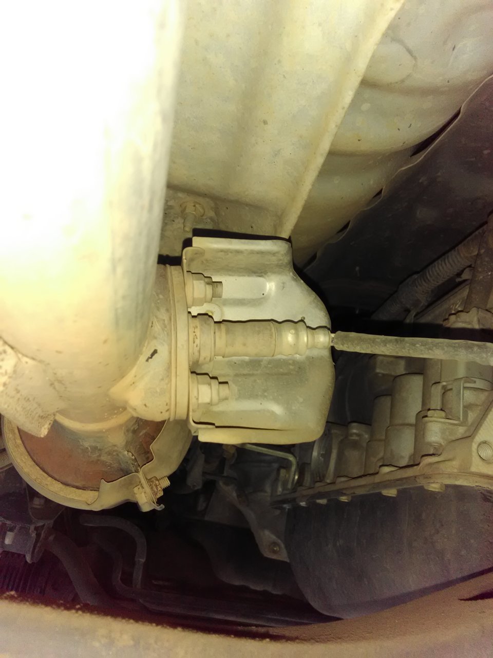

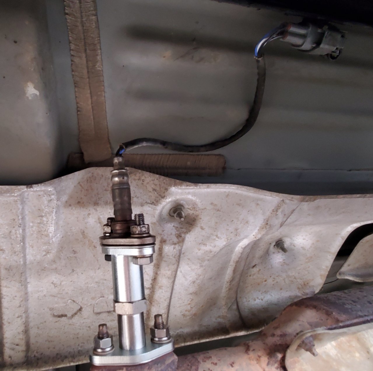

    Agree here. Swap all four 02 sensors for denso units. Are the rear ward oxygen sensors screw on or bolt on?
    Both of mine on the V6 bolt on with two studs which can be seen below.
    Whoever puddlefucked the exhaust bungs went with all screw in bungs. If the rearward ones BOLT on originally, I can get another set of foulers like the one above I used on the V6.
    Guess I could order the densos and find out for myself. Later date. Need to recuperate funds.
    Parts should be arriving at Swope tomorrow. Glad that the 4WD is getting taken care of, but the tech said there is always a chance that something else in the 4WD is gone or on the way out. I asked them to replace the ADD and diagnose any other issues with the 4WD. If the ADD doesn't fix it, let me know what's wrong, and I'll mend it myself.

    Thanks. That's what I thought. The front two screw in. I already have a tap that I bought for for corolla.
    So I've got the complete wrong rear sensors on it currently, but can be mended with foulers and correct sensors.

    Just to be clear, here is what I've got:
    Tundra2[QUOTED][OP] likes this.

    Yes. That's how the V6 was before my cats went bad.

    The sensors in the images you posted do look like Denso units.

    They do, yes. If the rear ones on yours bolt on, mine should too. Which means my rear sensors are not correct.

    Yeah, I believe they are Denso's but not the correct ones for your application. I'd hold on to them, they could be useful in the future.
    Edit: As a matter of fact, with prices and scarcity being what they are right now, if you have the space I'd tell Swope's you want all your take-off parts back.
