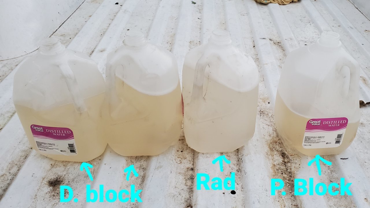

    Drained it. This is what I got out. Roughly 200 miles on this water.
    Pumped her full of Zerex coolant. Burped it. Went for a short drive up to the chapel. Pretty sure I'm stuck in 4WD. My idle is around 1,700 RPM now?
    Guess since I just hooked up this battery that I need to let it re-learn.

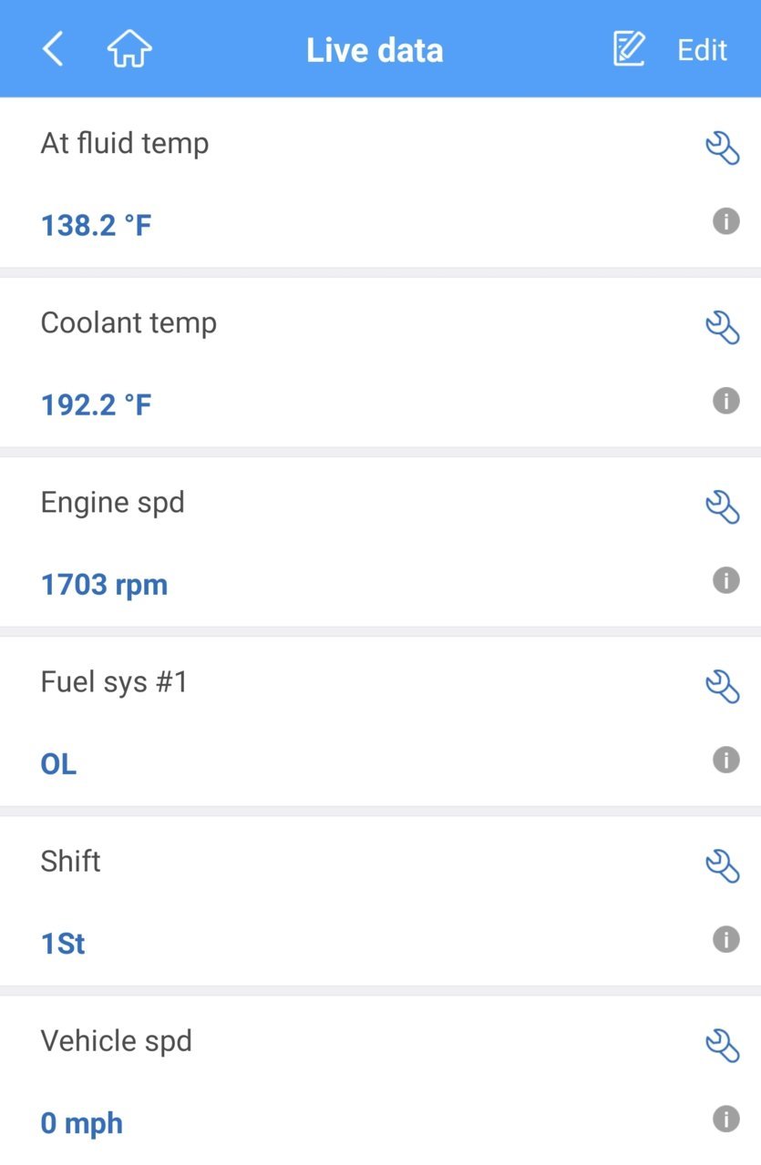

    Went for a short half hour drive. Watching live data sporadically. Never went into closed loop until I put it in Overdrive, and then finally went into closed loop fuel system. Topped off the fuel tank with another $63.
    About 9 or so minutes into my live data video at the bottom of this post.
    Idled down to acceptable 800-1000 RPM. Everything was feeling normal. Started cruising home, and then popped back into Open loop fault about 25 minutes into the video.. Pulled off the road, and turned it off for a second. Fired it right back up, and popped back into closed loop. Idled back down to proper range.
    @Desert Dog. I guess water doesn't transfer thermal energy the same way that anti-freeze does. Trans temps were anywhere from 130 to 160.
    https://youtu.be/x_v-Yd4abqw

    I know but it was one of those things you had to find out for yourself. Lol.
    I firmly believe that until you get the exhaust squared away with proper O2 sensors the open-loop/closed loop gremlin is going to haunt you; they have a lot to do with their functions. In very crude terms the ECM is struggling to manage a function at all times that it wasn't intended to. I could be incorrect but I'm pretty certain the O2 sensors (or a suitable substitute) are the root cause of the problem.
    NUDRAT and Tundra2[QUOTED][OP] like this.

    Thanks for letting me figure this out in my head, and my own way. Now that I've done it, it's in my head now. If you had just come out, and told me I'd probably forget...
    I'll do some part research for densos, and some foulers tonight.
