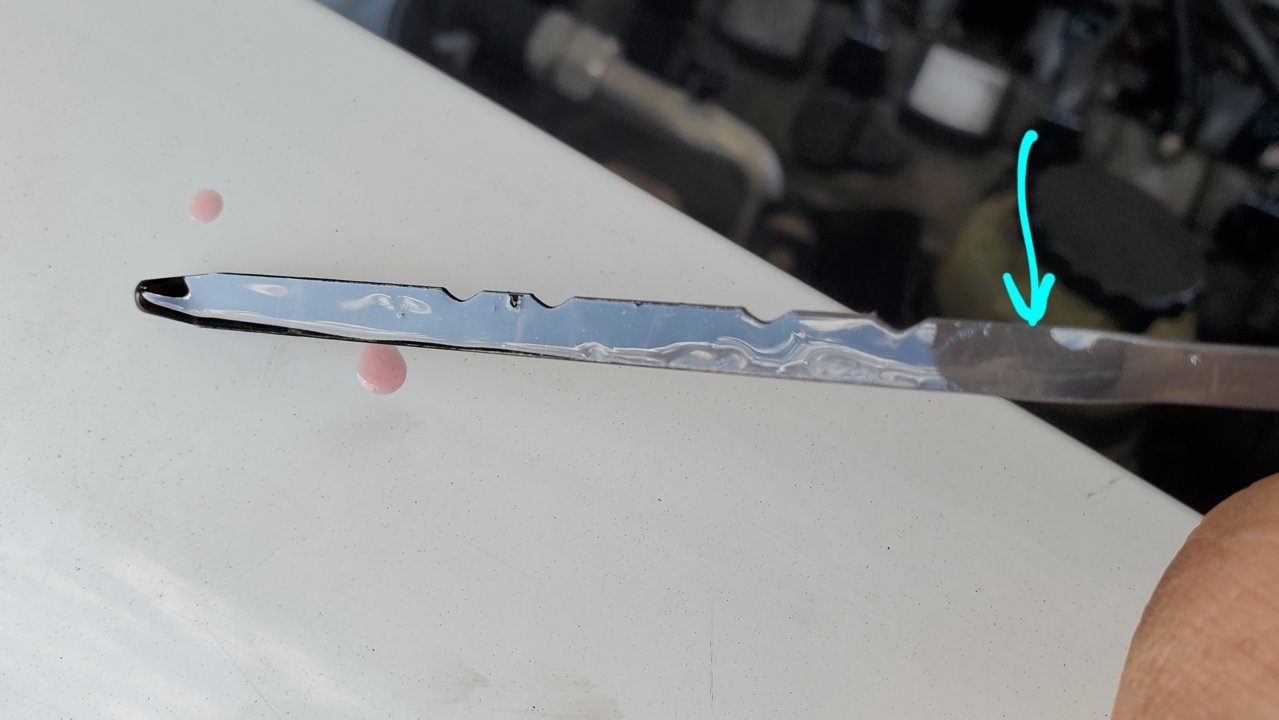

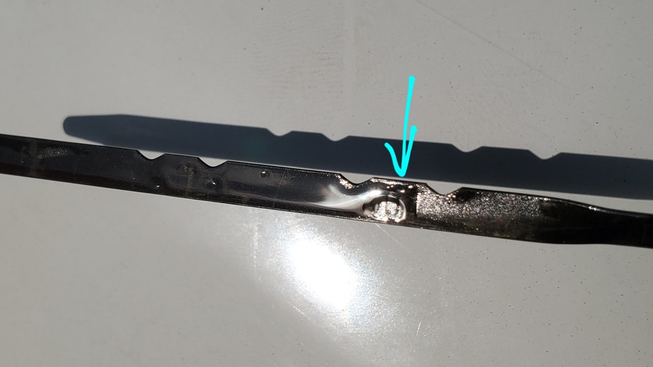

    Oil level looks good. ATF is a bit high. Will drain off some before heading to work.
    Not quite sure how that one happened.

    Pull into a diy carwash, use a spray bottle to degrease everything underneath, wait 10 min or so, then clean off all the old grease, being careful near electrical connections, and hit the zerks with a couple pumps. Check the fluids 20-50 miles later, and look for milque, and look underneath for fresh oily bits.

    Tomorrow as I'm out if time today. Great idea though! ATF at 160° with slight drain, and fill to proper level.

    Top it off before the cleaning. Keep it topped off while hunting.

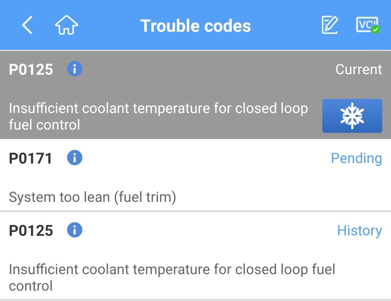

    And here I was celebrating. Just filled up with 87 octane marathon go-juice.
    Too lean is new. Live data shows the coolant temp at 190°-195°. Not sure what's next.

    Low temp code could be left over from when flushing with the engine running. Lean code could be from before hooking the manifolds back up.
    Clear them and see what comes back.

    @Tundra2, the easiest way to determine which component(s) are at fault here for the P0125 code is to measure the voltage across the coolant temp sensor as the motor comes up to temp. Unsure of the factory specs but if you check the sensor voltage and it is within spec then basic logic says it is exhaust related, probably front O2 sensor. Check the voltage and go from there.

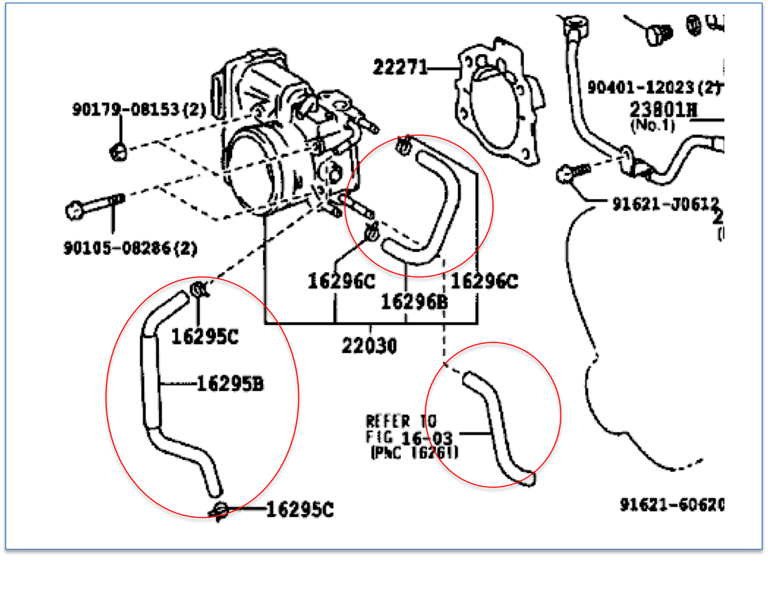

    Hmmm...check those new coolant bypass hoses to the throttle body. There's a definite in and out flow, maybe they are reversed? Or kinked?
    Tundra2[QUOTED][OP] likes this.

    Definitely not reversed. One hose is like 1/4" and the other hose on top is closer to 1/2". Be hard to reverse that.
    That bypass hose you linked from RA might be kinked, but it connects to the brass fitting on the bottom of the throttle body. That brass fitting is like a miniatures thermostat with a temp call out of 83°C. Not 100% sure if it opened or not.

    Just a thought. There are in fact 4 hoses in/out of the TB...

    I don't have the U-hose circled in the middle of that diagram. I only have two. One on top that connect to the y-pipe that goes down to the oil cooler, and the little hose from the water inlet to the bottom of the TB where the brass T-stat is.
    Am I missing something or are the earlier trucks different?

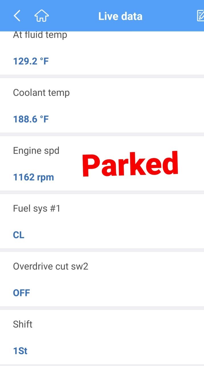

    Watching the live data shows a problem.
    https://youtu.be/_jfAW9ZvsYw
    Once the ATF temp hits 122°F it popped the open loop fault. Has nothing to do with coolant temp as it was Rock steady as shown above in the video.
    So, what to do now? Check temp sensor wiring on transmission? It's 45°F here. Live data is currently showing ranges of 116°F (with o/d engaged) to 135°F being the highest I've seen pulling hills in 4th gear.

    @Tundra2, you're right, that code is just a generic code and had very little probability of having anything to do with the cooling system considering all the effort you have put into it. That's why I said just check the voltage sweep as it came up to temp.
    Anyway, that code and the open/closed loop issue probably don't have anything to do with the trans either. Again, it's a genetic code, it's almost always due to faulty/failed O2 sensors. I would focus on getting the exhaust system back up to snuff and sealed before putting any effort into anything other area. Didn't you say the exhaust is boogered-up? It's the most likely culprit here. Be sure and use Denso or NGK/NTK brand O2 sensors.

    Not sure anyone is going to watch this or not. But here's a longer live data video where I play around with different O/D on/off and driving styles to see what the ATF temp does.
    https://youtu.be/75upAnJi2VI
    Synopsis: I didn't go WOT, but I did push it pretty hard. While running 80MPH+ ATF was 111.2°F which doesn't make any sense to me, but maybe I'm missing a piece of the understanding puzzle.
    Once I let off the throttle the temp started coming back up.
