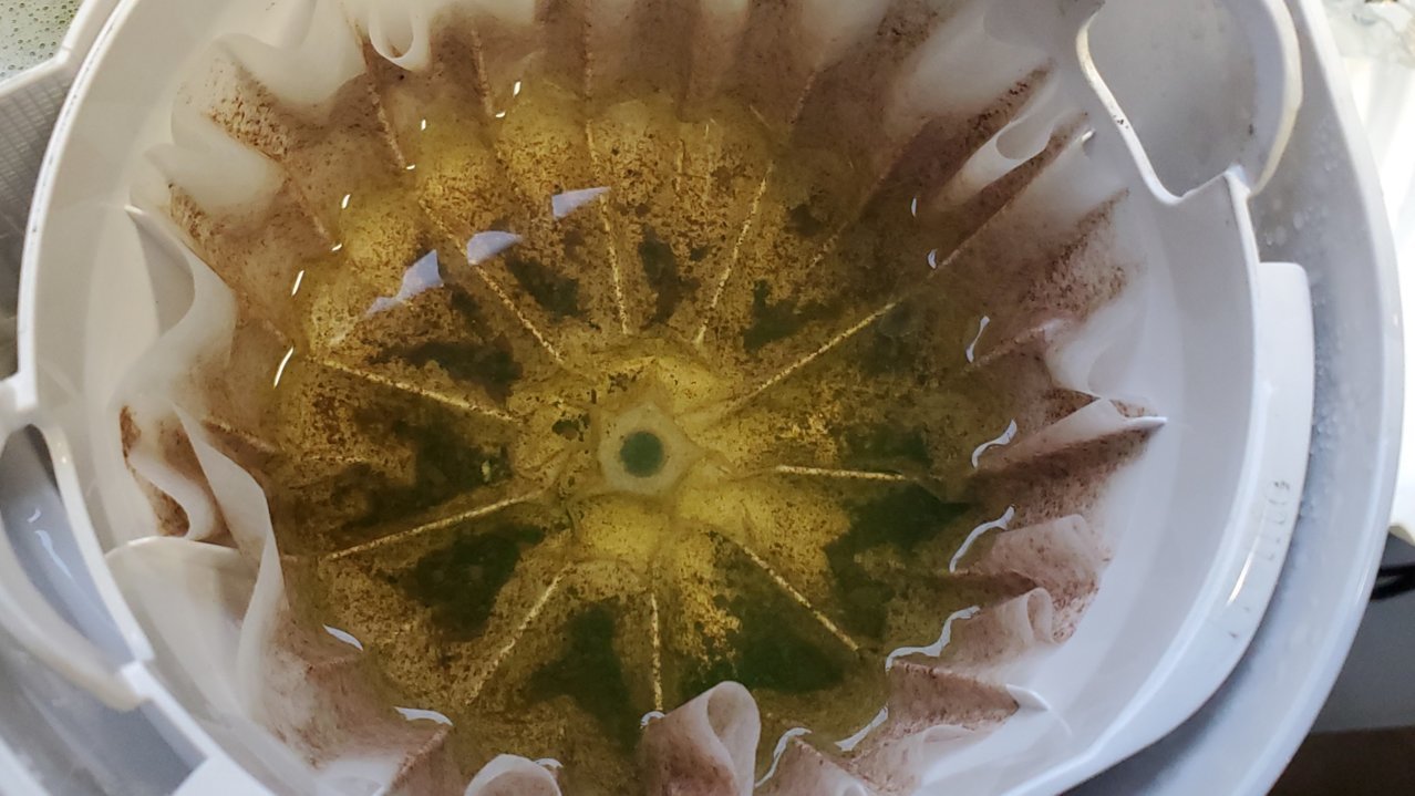

    Paint that coffee maker red and black, slap a snap-on sticker on it, and call it a coolant inspection station or something. you could probably get a couple hundred bucks for it after youre done.
    bmf4069, NUDRAT and Tundra2[OP] like this.
  2. Oct 11, 2021 at 2:53 AM
    #1082
    Tundra2
    Tundra2 [OP] Zoinked
    Feb 10, 2019
    #25875
    12,450
    Noah
    Western Kentucky
    That's not a bad idea!

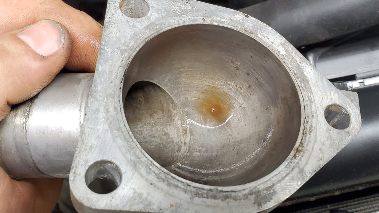

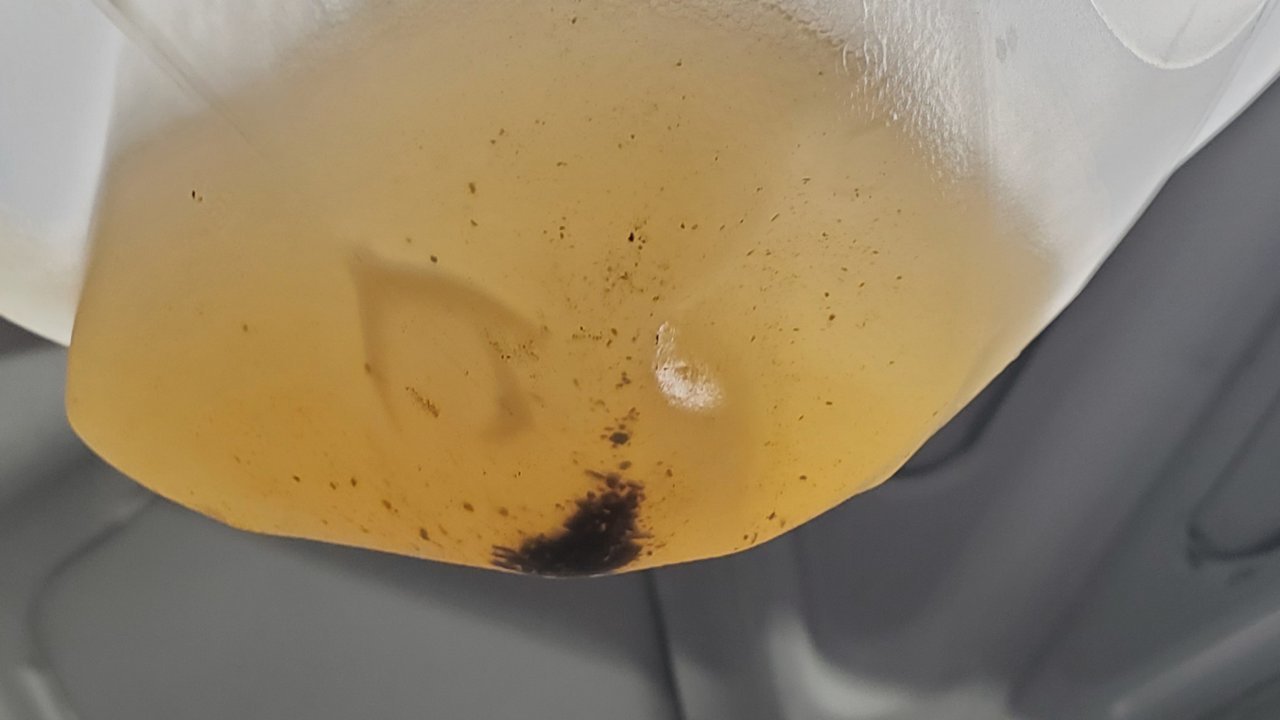

    Blown straight out of the heater core. I have much more flushing to do.
    Added liqui-moli rad cleaner directly to the heater core.
  4. Oct 11, 2021 at 3:18 AM
    #1084
    Sirfive
    Sirfive Socially feral
    Jan 24, 2021
    #58078
    5,507
    SATX
    ‘02 Limited AC TRD
    Bassani cat-back
    Is it rust or mud? Like does it smear or stay gritty?
    Tundra2[OP] likes this.
  5. Oct 11, 2021 at 3:20 AM
    #1085
    Tundra2
    Feb 10, 2019
    #25875
    12,450
    Noah
    Western Kentucky
    Some stays gritty. Some smears. Good mixture of both.

    At some point, I'll need to pull the oil cooler, and the throttle body to check for packing of bull shit

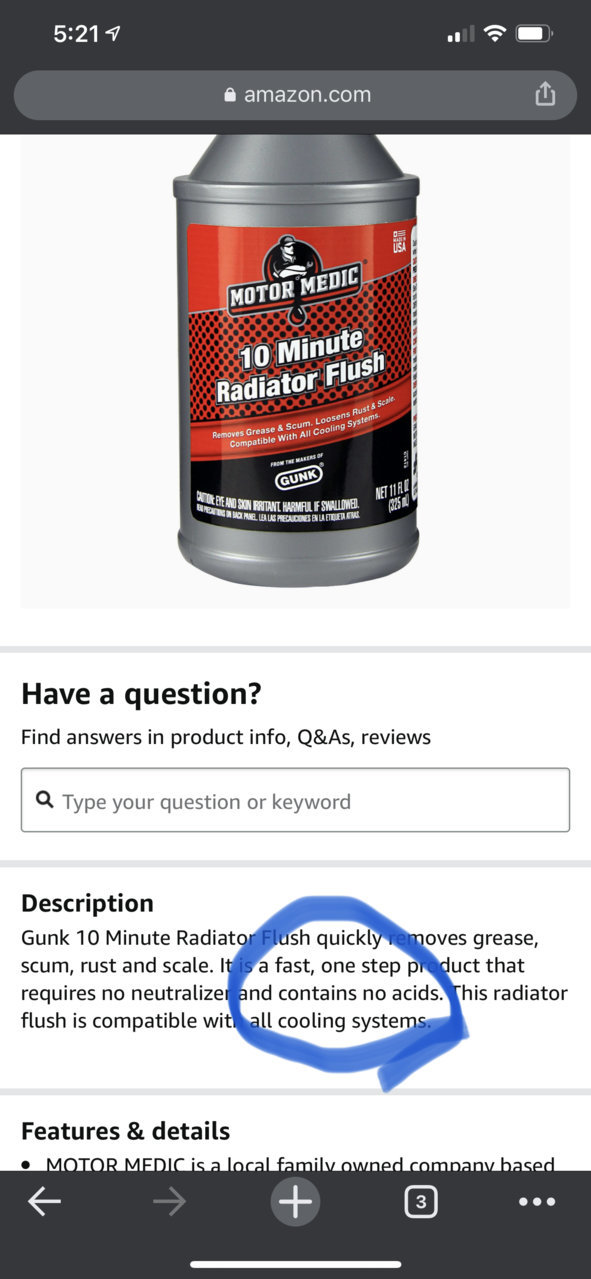

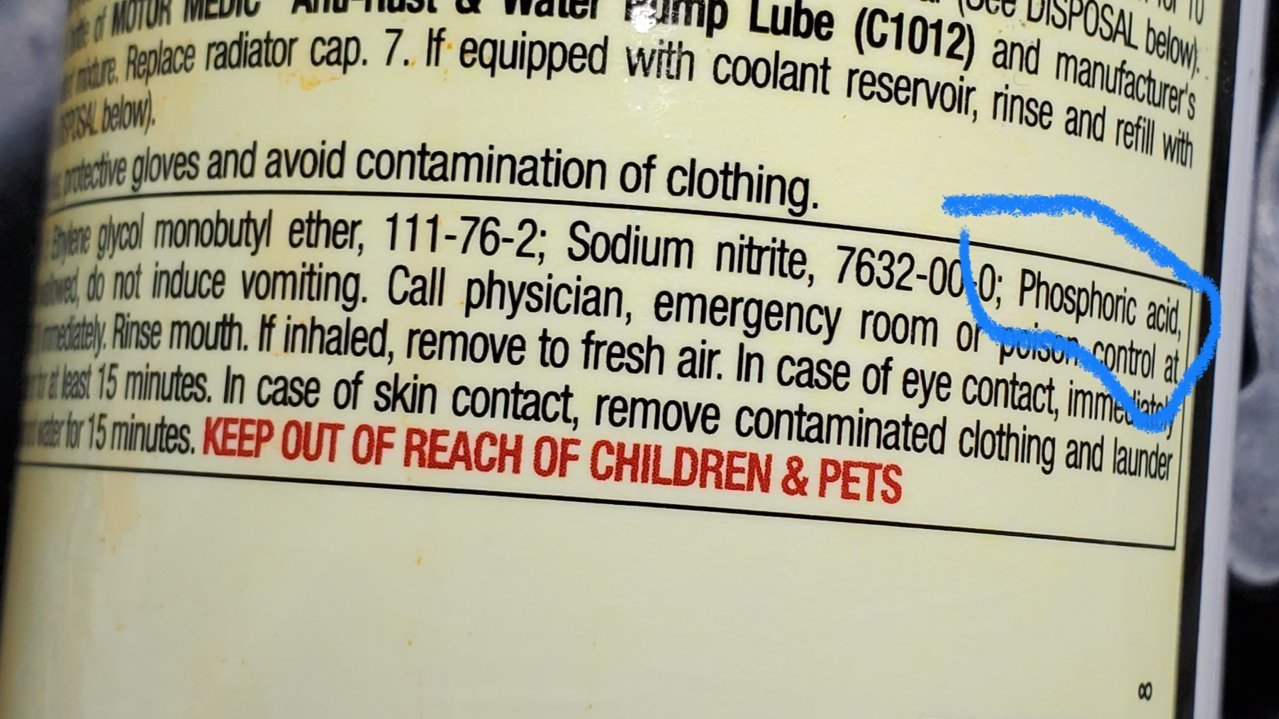

    I think phosphoric acid is what makes coca cola clean metals.
    bmf4069, shifty` and Tundra2[OP] like this.
  8. Oct 11, 2021 at 3:25 AM
    #1088
    Tundra2
    Feb 10, 2019
    #25875
    12,450
    Noah
    Western Kentucky
    That's the right bottle too. It's probably so diluted that they can advertise that it has "no" acids.

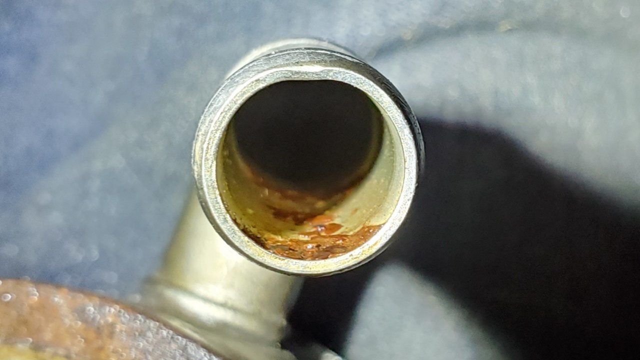

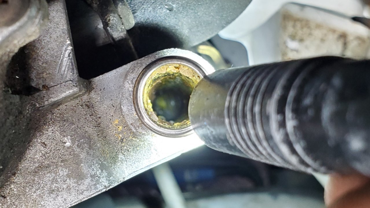

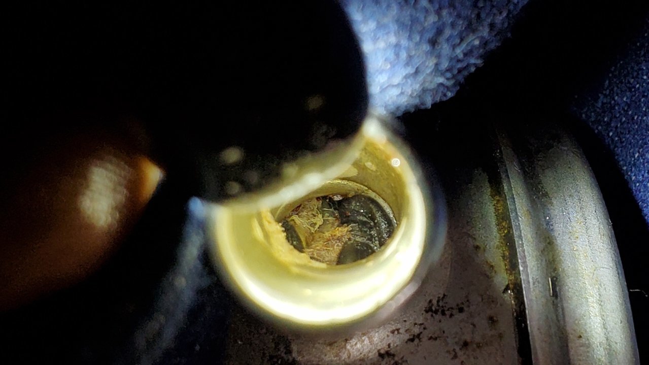

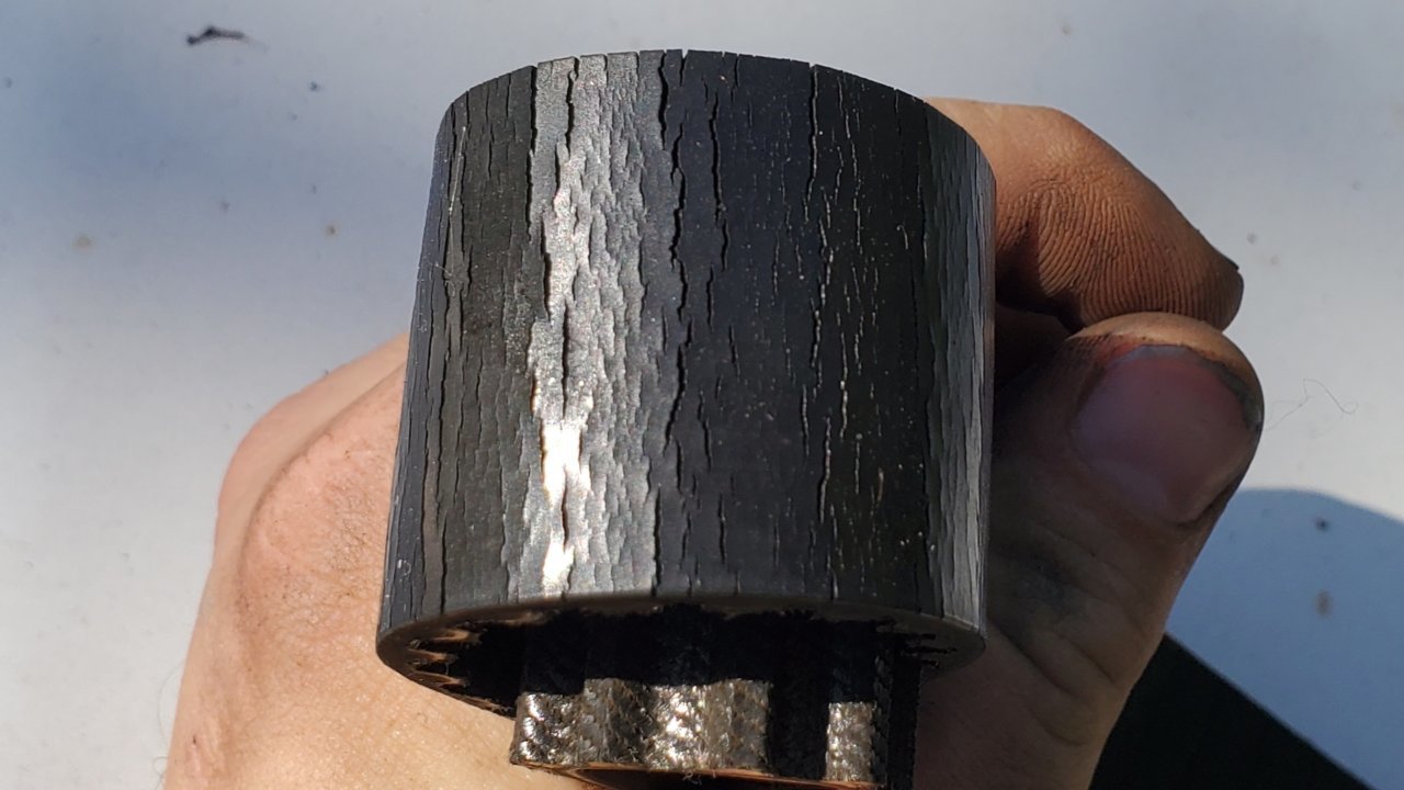

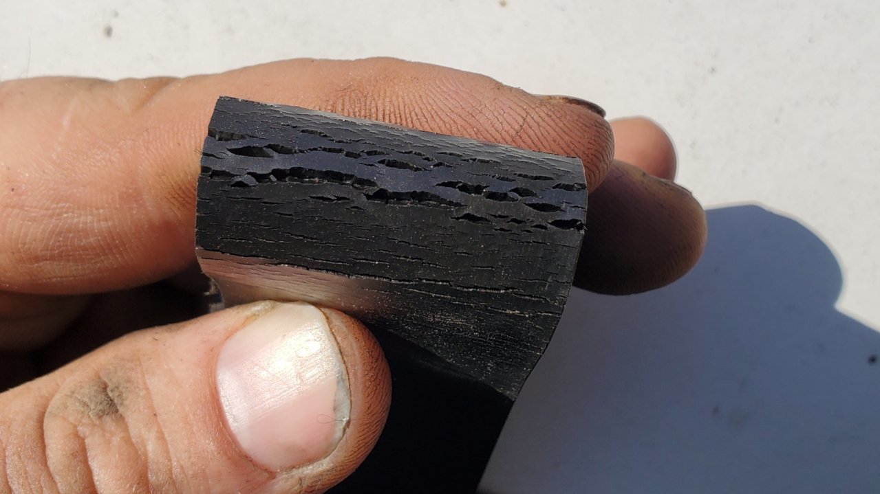

    Pulled the oil cooler, and investigated. Wasn't packed full, but definitely had a blockage that I cleared.
    Inlet below had small amounts of rust flakes.
    Outlet had some sort of fabric, and seals blocking it. Wasn't able to get all of this out, but did get most of it. Kinda bummed on it as this is the newer one.
    I hooked a hose up to it, and blew into the hose while holding closed the opposite side. Didn't get anything through the middle of it so not sure if it leaks or if I can't generate enough PSI with my smoker lungs... swapped sides, and still no leak.
    Pulled the throttle body, and found it was still warm. Tells me there was coolant flow through it which is good. Small amount of gunk in it. Mini-t-stat is working properly. No visible signs of leaks. Also good.
    Will fill back up with strained water as I'm fresh out of distilled, and run the truck checking for leaks. I broke two of the spring clamps for the oil cooler. Guess I need to find a link, and then slap them on the next OEM order.
    FrenchToasty and shifty` like this.
  10. Oct 11, 2021 at 5:27 AM
    #1090
    Tundra2
    Feb 10, 2019
    #25875
    12,450
    Noah
    Western Kentucky
    Trapped contamination thanks to ye olden coffee pot.

    Naval jelly coating for 15min bath was the old-school way, but not convenient. If you've never used Evap-o-rust, I cannot recommend it enough. IF you've never heard of this stuff, it's freaking phenomenal. You won't believe how well it works and it's non-caustic, environmentally safe. Wire brush off the big garbage and flakes. Put nuts and bolts in a glass jar. Barely cover the pile in the jar with Evaporust. Leave it soaking overnight. The stuff is re-usable, so don't pour it out! Just dump the contents through a screen into another jar the next day to get your stuff, then rinse your now-rust-free items with water and treat with whatever anti-rust product you like. Run the leftover liquid through a coffee filter or cheese cloth and re-use a few more times.
    Everything works better with acid :D
    Could just be the pH is in a certain range they don't need to qualify it as 'acid'. But I laughed when I saw this.
    Sounds considerably better than the first startup after TB/WP a couple pages back. I dunno what the low idle thing is on the back side of throttle, I only have experience with the VVT 4.7 at this point, though.

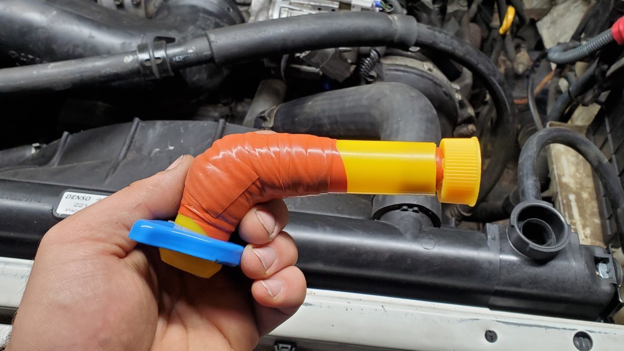

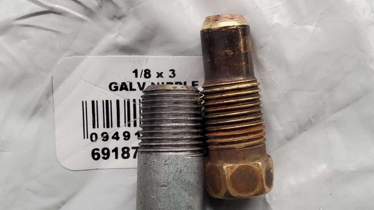

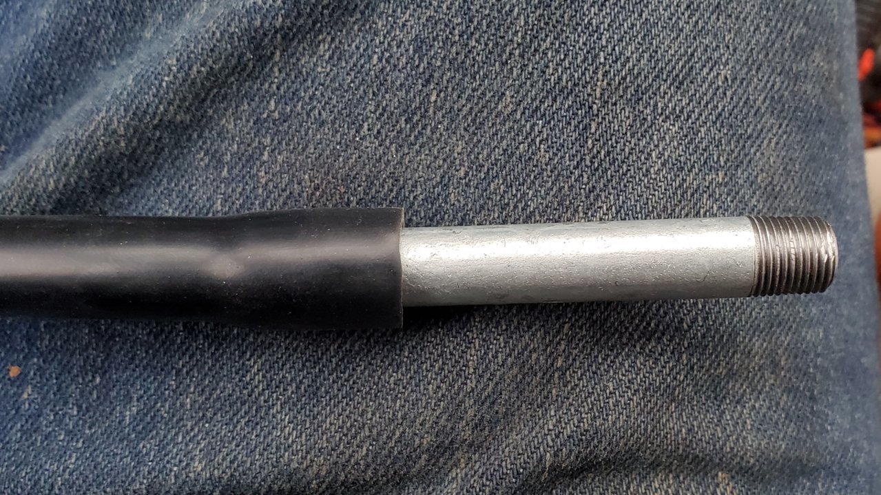

    Made one final Wallace wurl run. Picked up a prestibe flush'n'fill kit to butcher. Added radiator attachment from my oil funnel kit seeing as how I have two of the same kit now.
    Couldn't get it over the 80° bend so I heated it up with my heat gun, and then formed the adapter over it... which promptly ripped a hole in it I sealed it back up with self Vulcanizing tape. Since this will be under almost no pressure, I figure it will be fine.
    Cut up the two way adapter thing the kit comes with, and added some self vulc on the shaft. That created a seal. I slid the whole damn thing inside the radiator funnel adapter.
    I'm taking one of the drain plugs with me to a local hardware store. I suspect that it's 1/8 NPT. If that's the case I can make some hose barbs that screw into the block, and then run those hoses into buckets for one final fully open system chunky flush with no air pressure. Just water flow.
    Now that I feel confident that I've gotten all the big, chunky, blockages out, I just need to get all the other particulates out. This should do it. Course, there's going to be shit that comes out of the oil cooler, the heater core, and the radiator from here on out unless I replace all those items...
    Heater core would be the hardest, and most expensive.

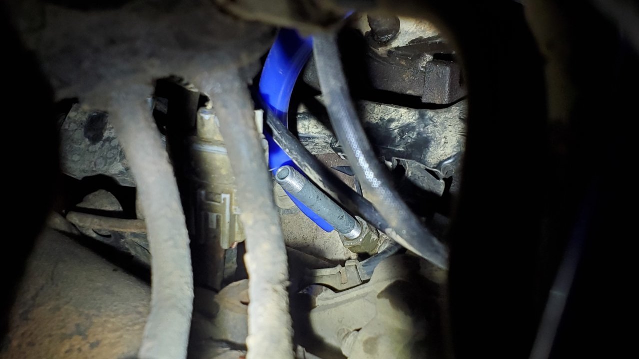

    Local hardware store had zero brass nipples which I'd prefer for this. Grabbed two 3" 1/8NPT nipples. Damn close!
    My section of hose I brought for test fitting slipped right over this snuggly so no need for fancy couplers, nor hose barbs! Cost savings! $4.00 + tax.
    I'm not sure if this is @FrenchToasty approved or @Sirfive! Either way, shits happnin!

    Sirfive approves all hairless nipples. Forgive my ignorance, but is this a block drain plug? Ive got enough faith that you know what your doing, but something tells me 1/8” isnt going to flow enough. If the particles get suspended in water, they could settle before they drain out. But i dont know. I was lucky, the inside of dads infiniti was pretty clean when i did the radiator.

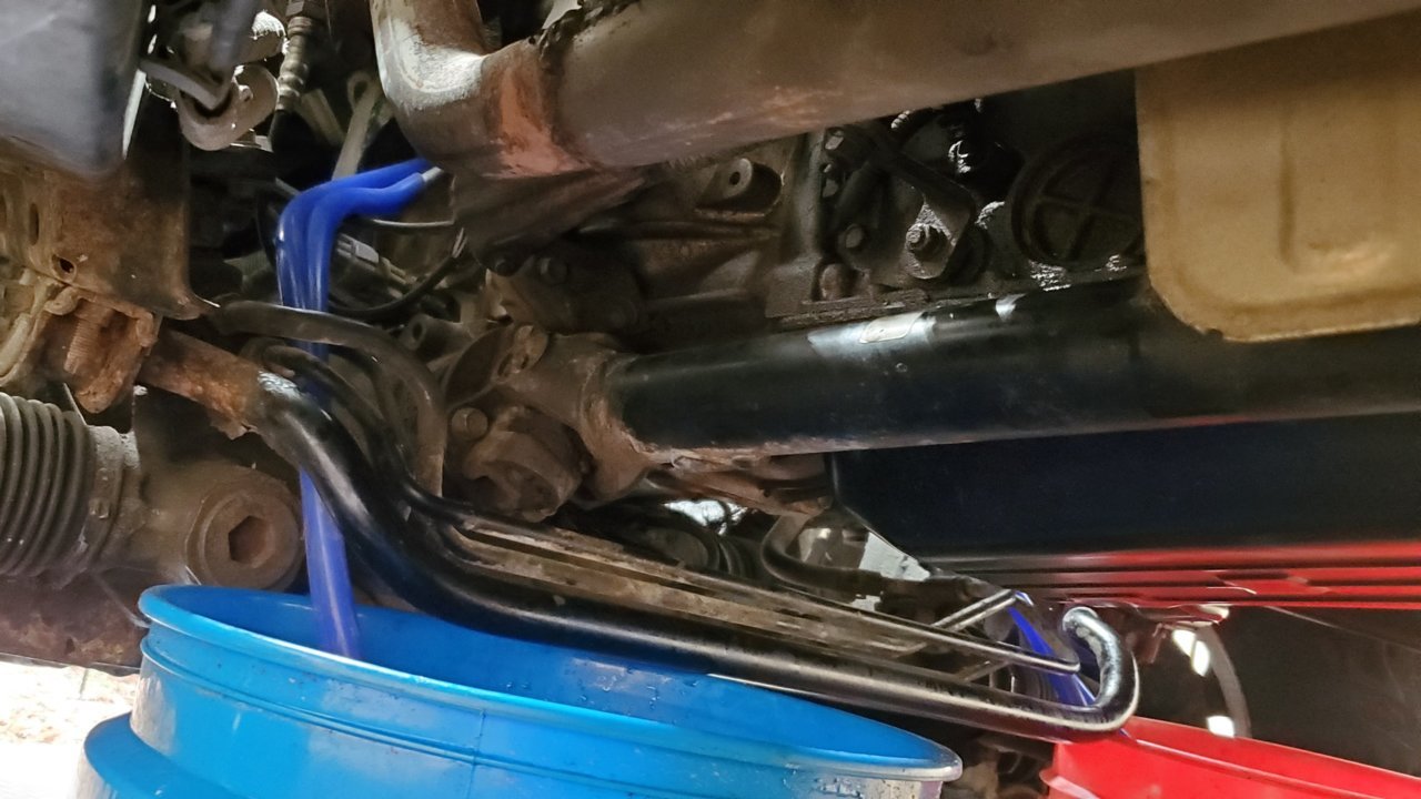

    Completely removed T-stat all together. Small amount of dirty water, but no chunks!
    Attached my nipples to the block. Less than hand tight. One or two threads. Seen below is the drivers side.
    An overview shot of the whole set up. Two lines per bucket. One from the actual drains, and one from where the drain plug would live.
    Time for some video activity.
    https://youtu.be/i_-Sq_U6EPc

    I think those are 1/8 BSP, not NPT. But for just attaching them finger tight it'll be fine.

    Sometimes it feels like the video is more about your crotch than the truck, but, I mean, that's cool /nohomo
    So this was a cold flush with line-level pressure? Just curious if I missed something, got lost after you put your nipples on the block.
    Produce any interesting result?

    Sorry about this. I crop the video afterwards to upload 200MB worth of data to the YT instead of 1.6 GB (which would take 10 hours here.)
    Line level pressure flush with both engine drains completely open. Sorry for the confusion, but I figured the pictures would speak for themselves.
    I got some particles in the passengers side bucket, but didn't check the driver side bucket. It was WAY past bed time. They will all have settled to the bottom of the bucket by the time I get home.

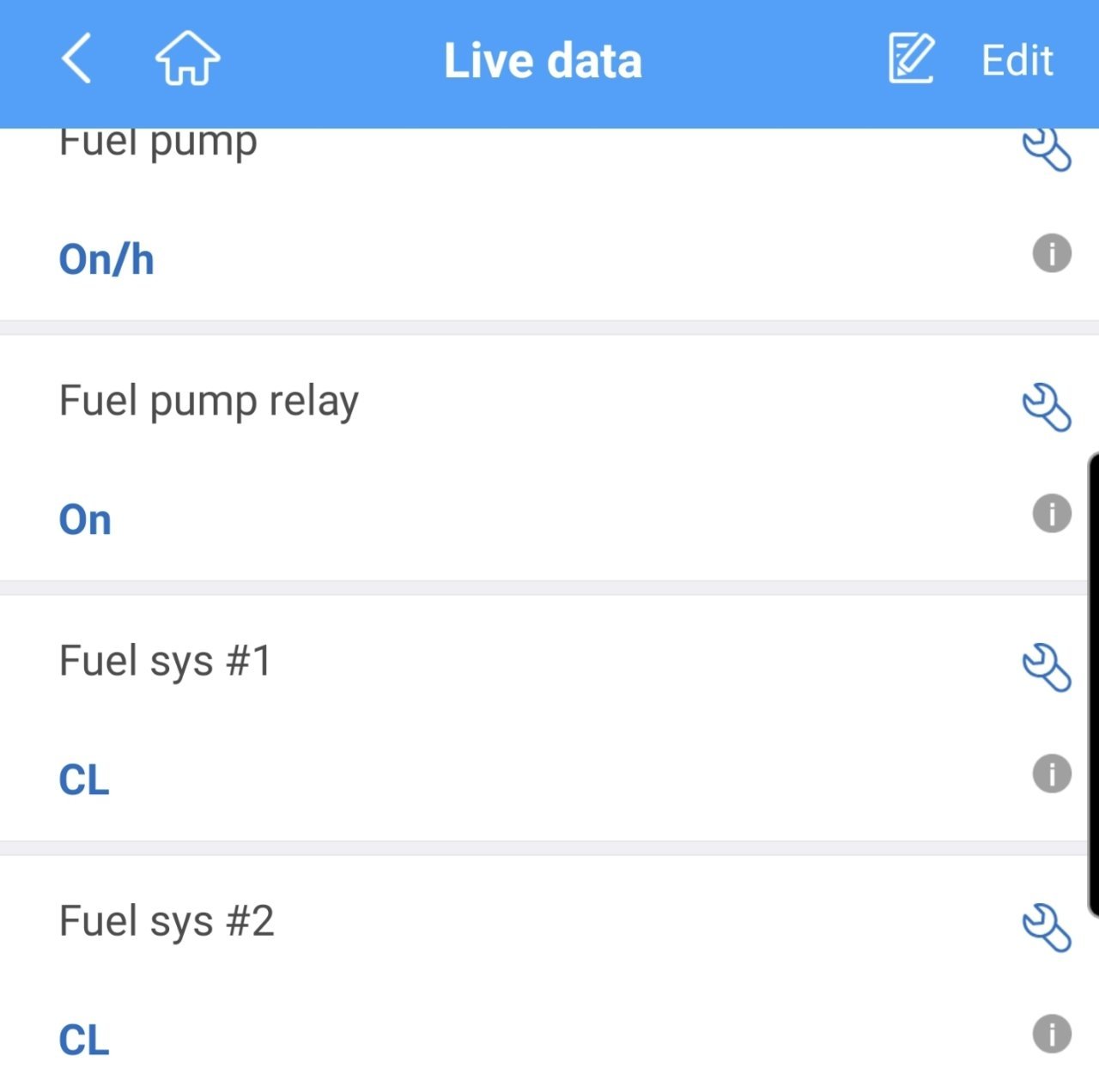

    Fuel system is now CLOSED LOOP!
    :D:yes::taco::yay:

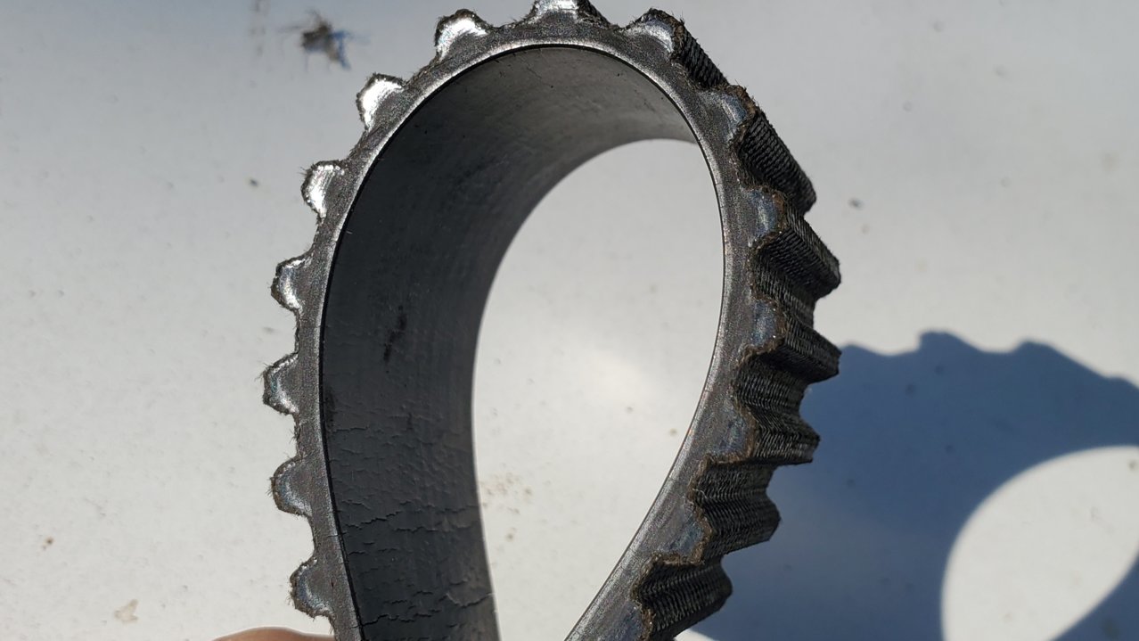

    Final pics of ye-olden timeth belt

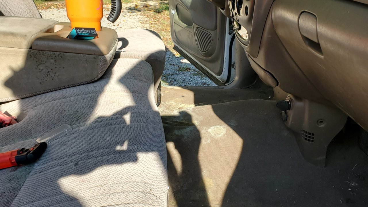

    Carpet has developed mold while sitting for a month...
    Will continue to check Live data while on the level at the chapel
