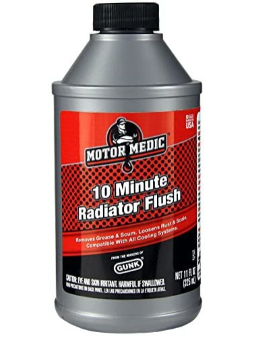

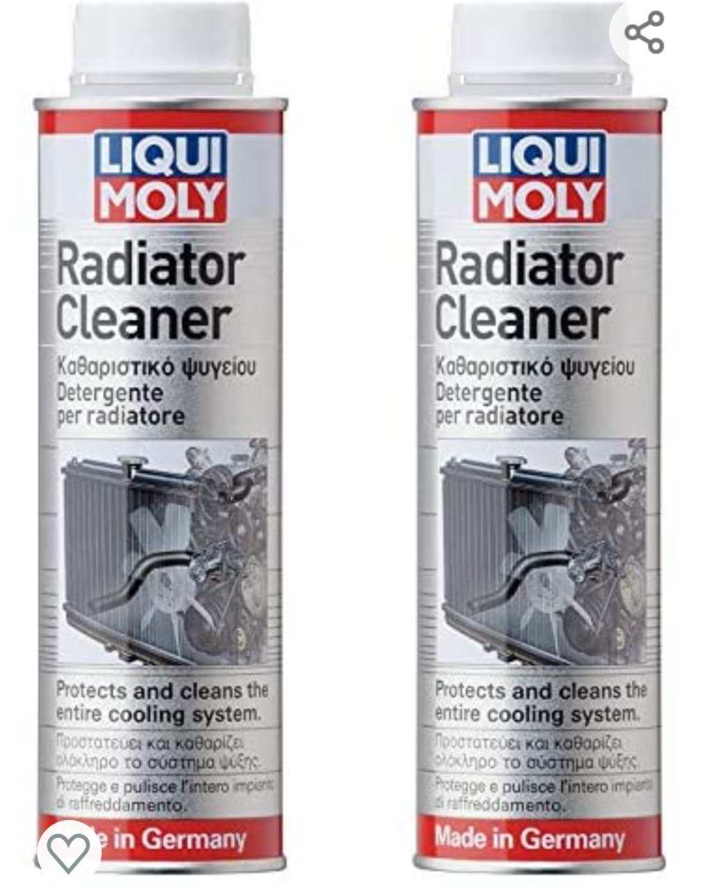

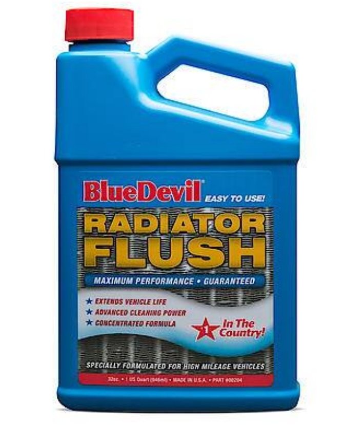

    I had no plans on driving it. Just letting the water pump push all the cleaner, and distilled water through it.
    Unless I should actually use coolant as a flush if it would work better with the cleaner stuff I have. Below are three screenshots of the three different products I have on hand.

    No need for precision. Just snip them with some cutters.
    Ah. Yeah, that's true. If only idling no issues.
    Ah, then that won't be a problem.
    No idea on the coolant flush stuff. Any youboob comparison vids out there?

    Liqui moly in my experience produced superior products in the flushing world.

    I'll have to order some more then. Wasn't sure who was "good" or "best" just knew I needed a lot lol
