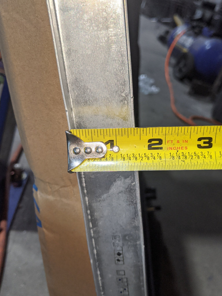

    Looks like the old was original and the new denso is not larger than the 1.25" listed. Good to know.

    Larger than 1.25"?

    They both look 1.25" to me. I think it's an optical illusion, the old looks smaller edge-to-edge in the pics if you look at the metric side of the tape.

    Whoops. Meant to type 'not larger'. Editedy above post.
    Glad I got the Koyo which matched my OEM.

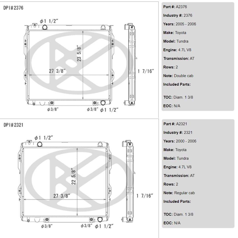

    I know you mentioned it before, but how thick is the koyo?

    EDIT: See the 'Note' field to see which is for DC, which is for AC/RC.

    Confirmed.

    Yes

    They were both the same in my eyes. 1.25"
    Optical illusion from the angle of the picture or the tape. I had to really flex the tape to get rid of the glare from the lighting. Of course, the glare was right over my measurement...
