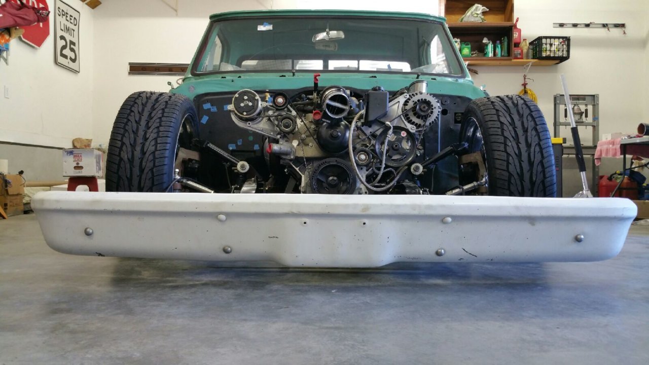

    All you need to do is find one with a straight ass-end. Get a pneumatic hammer with chisel bit, it'll take the heads of the rivets off in about 10 seconds each. Remove the donor crossmember. Get grade 8 hardware. Bolt onto the framerails after removing the rotten crossmember. Easy freaking peasy, seriously. Definitely not difficult, @Tundra2 I've done this with a number of projects in the past to beef up crossmembers and when doing LS swaps into vehicles that probably should never have one.
    4x4 beam and engine hoist. I took the cab off my '68 C10 about 10 times while doing LS1 LS1/T56 swap using this hack, and it didn't throw anything out of alignment. Granted, maybe it's not the case with our FGT, or maybe you'd need to pool noodle around the 4x4, but this is a very effective way to move cabs on/off frames.

    (you can also use a pulley system with hoist if you have a stout tree nearby. And yes, I'm all about good 'ol boy hackery also, when necessary)
