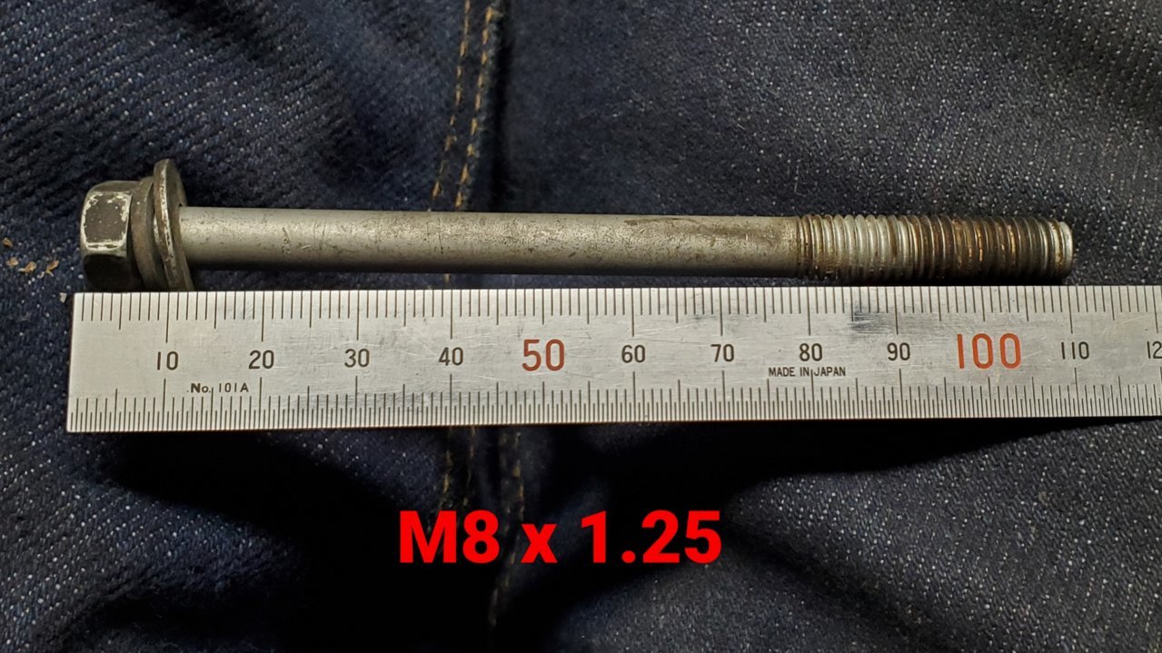

    Tundragirl putting extra hardware in your nut/bolt pile?

    I
    I told him he did the same thing the manufacturers did but better because it’s less parts lol… he wasn’t happy with that response

    Weight reduction.
    its a tundra superleggera now.

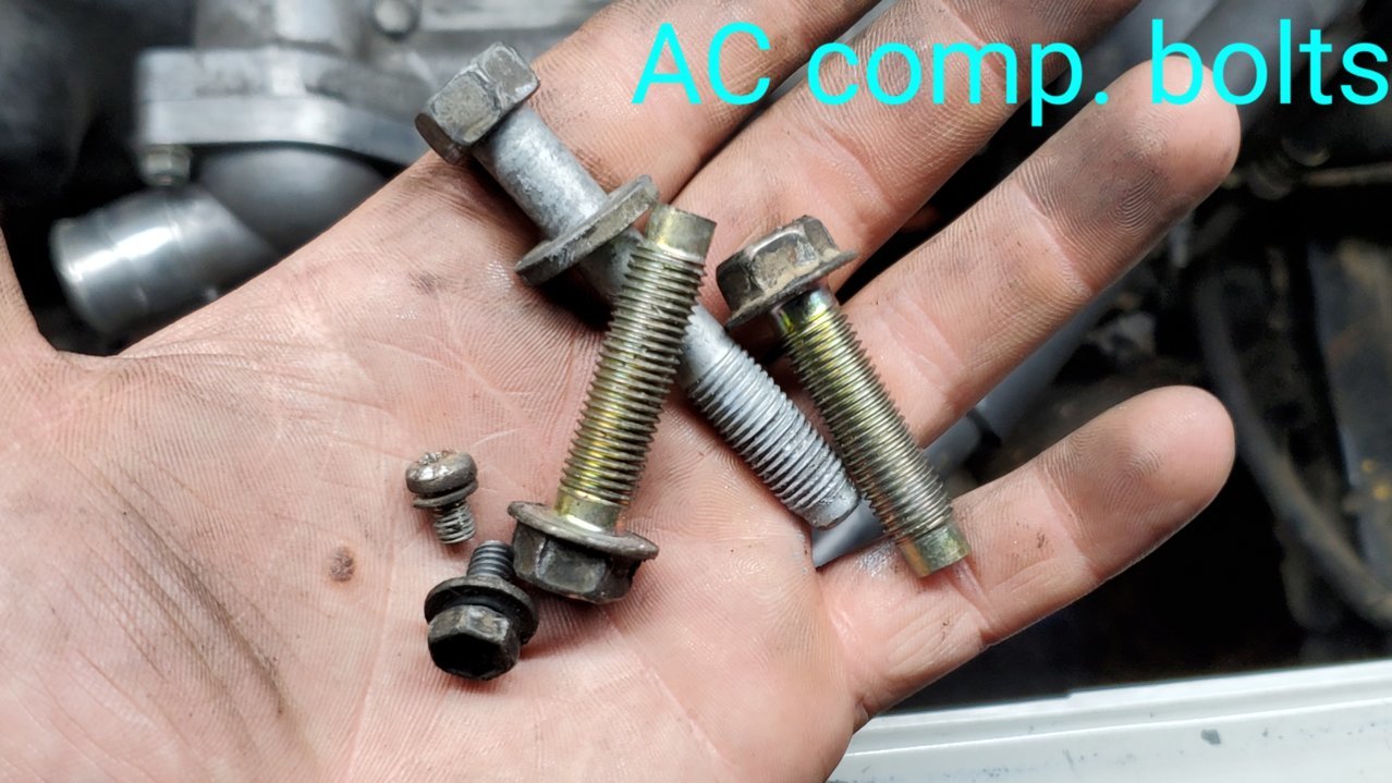

    FirstGenVol
    Dec 13, 2018
    #22934
    14,387
    East TN
    2002 AC TRD 4x4 V8
    That long bolt in the 2nd picture looks like one we had to remove when doing John's alternator. It's either for the alternator or power steering pump I think. We had to unbolt the power steering pump and swing it out of the way to remove the alternator. Some of those smaller bolts could be for the serp belt tensioner...?
    Edit- just noticed you already have the small ones figured out. 95% sure that big bolt is what I wrote above.

    dbittle
    dbittle Middle Age Member
    Aug 10, 2020
    #50632
    244
    Huntsville AL
    2006 V8 RCLB 2WD
    There’s a long one on the thermostat housing. 4 for the ac compressor one on the water pump and one over by the power steering pump if I remember right. Mines an 06 though.

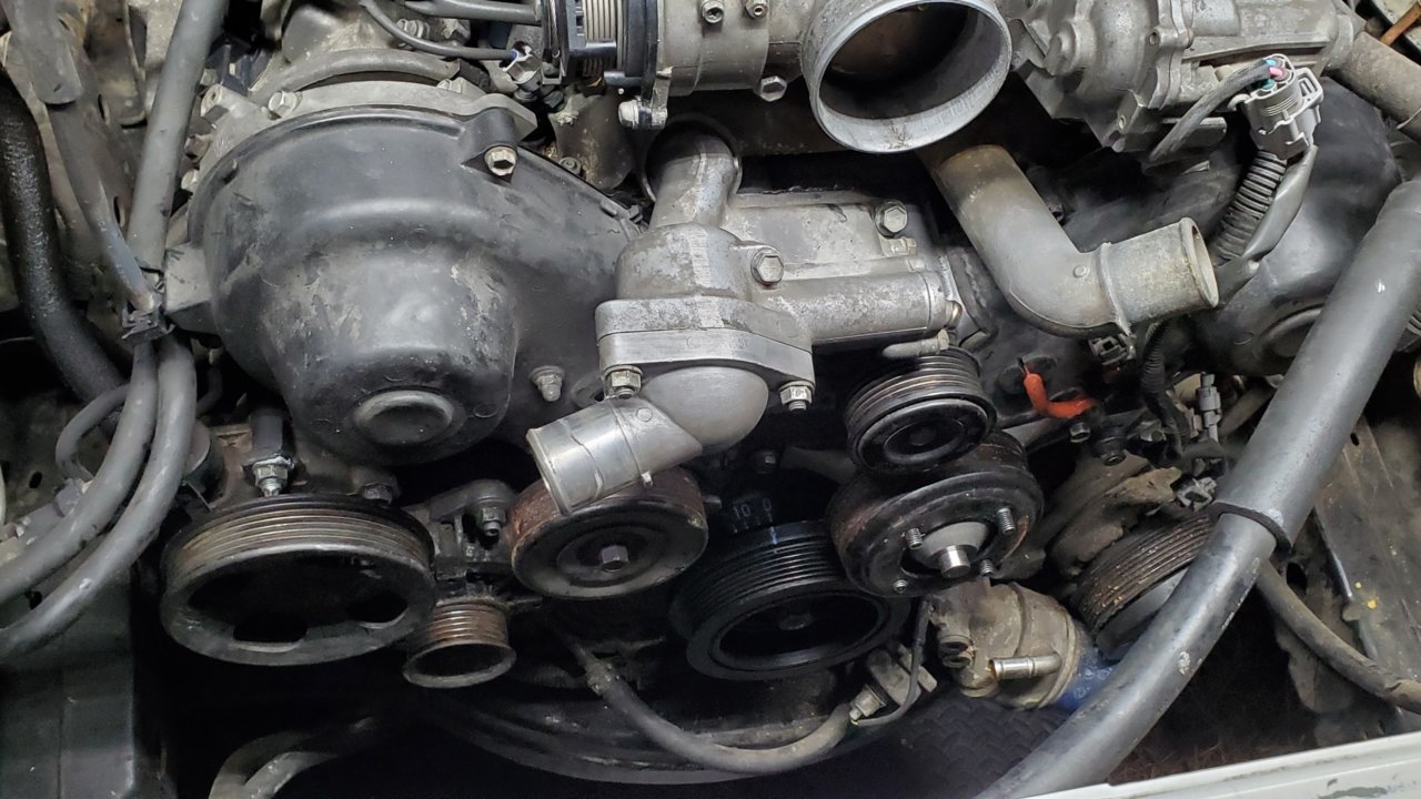

    TundraGirl2
    TundraGirl2 New Member
    Aug 12, 2021
    #66681
    58
    Kaitlyn
    Western Kentucky
    He’s got both timing belt covers off and the number 2 timing belt cover. No sign of anything where the left over would fit. Taking the fan bracket off now.

    @Tundra2 here. My phone is dead as a doorknob. Anyway, think I figured out where that 12mm bolt lives. There’s a bolt just underneath the bolt for the serpentine belt tensioner. Think that’s where it lives. It threaded in, and snugged up.
    Still not sure where the 12mm nut lives…

    empty_lord
    Feb 1, 2019
    #25441
    10,148
    Dan
    Indiana, Chicagoland
    05 rollover special
    that bolt is the one that can be replaced with a stud to allow the use of the newer 130 or 150 amp alternator without having to modify it. (for anyone that cares)
    bmf4069, NUDRAT and Tundra2[OP] like this.

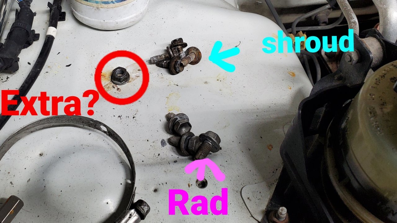

    Okay, so I've still got one M8x1.25 nut (12mm head) without a home. Everything else has been accounted for.
    Water pump is good. PS Vane is good. Alternator is good. AC compressor is good. AC comp reinforcement bracket is good. Serp tensioner is good. Water inlet is good. I'm not sure what else is missing.
    Found one loose motor mount bolt which I snugged up...
    Not many pics because cold, but the oil cooler coolant lines are packed full of shit. I cleaned this out, but can't get much out of the oil cooler itself.
    The throttle body is packed full of shit too. I can't clean all that out. Same type of grassy, planty type shit.
    Also, I'd really like to replace the clips on the left hand TB cover. Anyone got any kind of links?
