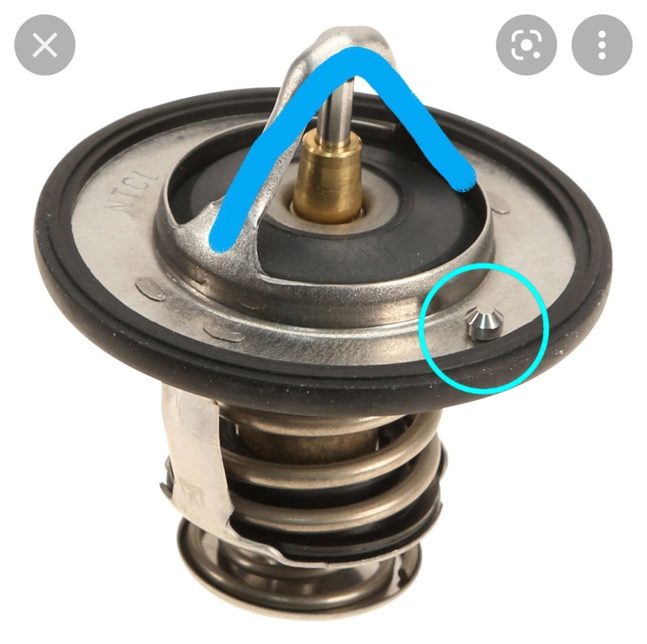

    So this?
    Why does it matter, and could the other one have been installed incorrectly?

    It's to help bleed the air out of the system. Not all thermostats even have them.

    Thanks Nick
    I'll have to look in my scrap pile when I get home, but I'm not sure if the moto-rad thermostat I pulled out had one.

    My 170° motorad had one but it was on the inside area closer to the seal/center. It was under/inline and tucked up that arched piece.
    I drilled a 1/16" hole on the outside like where the valve is on the OEM.

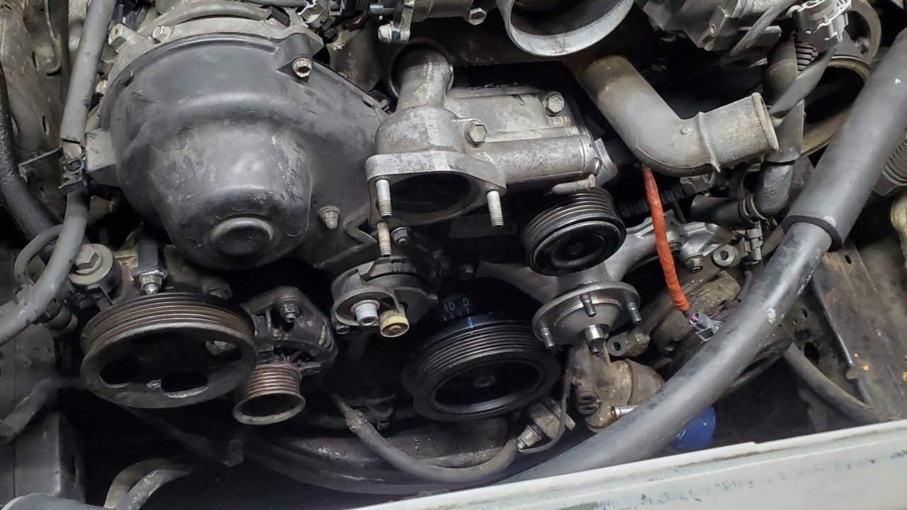

    I'm rolling the dice. I feel like everything is well.

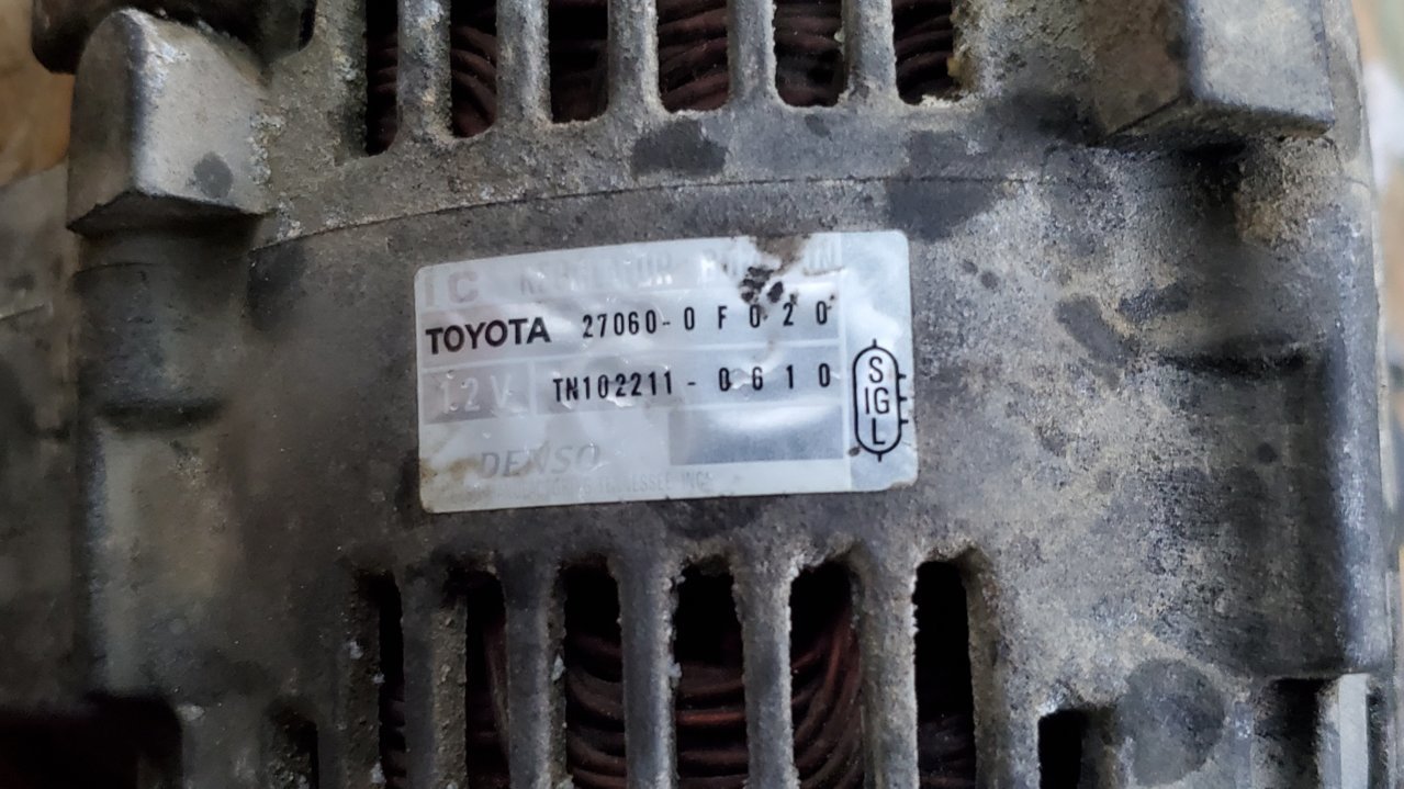

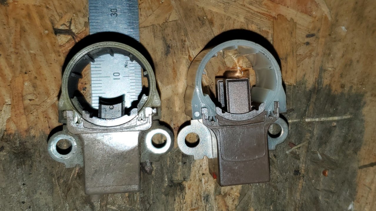

    Pulled the alternator, and was happy to discover a Toyota alternator.
    Pulled the rear cover, and replaced the brush. Glad I did. Down to the dot.
    Got the #2 timing belt cover on, water inlet with new O-ring/FIPG, power steering pump, alternator, and the RH TB cover.
    Cleaned out a bunch of rubber bits from the grooves of the PS Vane, and the alternator pulley. Brushed the grooves out with stainless steel brush. Really need a damn air gun.
    Had to brush a lot of the bolts for thread dirt. Treated with small amounts of anti-sieze. Lowered torques by 25% which I think is status quo for using anti-sieze?

    Good call on checking the brushes now. Be a good idea to saturate the windings in the alt with some CRC electronics cleaner or the equivalent and get some of the old dirt and debris flushed-out as well as possible. Clean windings allow heat to dissipate quicker. Ergo, cooler running alt/longer-lasting alt.
    Tundra2[QUOTED][OP] likes this.

    Okay, admittedly I need help. I have an extra bolt, and nut. Both are 12mm head. Currently, everything is installed except for the AC compressor, and the radiator.
    I'm not sure what I missed...
