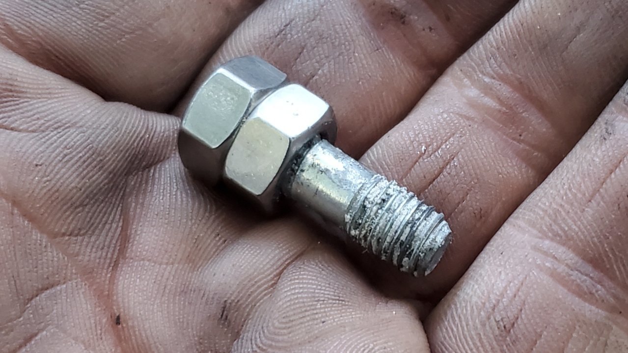

    Decided to cool down the work ethic by removing the studs from my fan clutch from the shitey Chinese fan bracket that was on the truck.
    Two M8x1.25 jamb nuts, and two 13mm wrenches made quick work of it.
    Cleaned up the mating surface of the fan clutch. Spick und span!
    Gave the mating surface a light coating of anti-sieze because I'm not ready to install it yet, it's bare metal now, and being stored outside where it's humid. This will mostly be wiped off before install.
