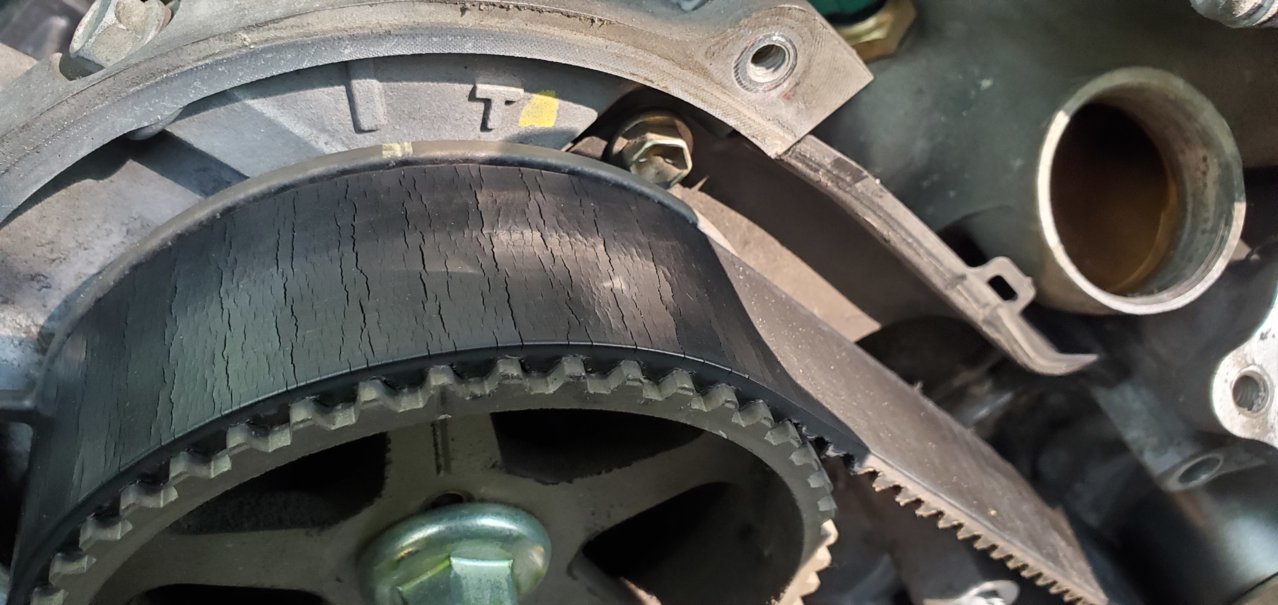

    So I'm about halfway torn down on the engine right now. Been following along with 1A-Auto video linked below.
    https://youtu.be/6TZTn1Arjho
    Got to the part where the AC compressor bolts come out, and needed extensions. Decided it was a good time to update, and take a break.
    Looks like the wires are chewed up on that sensor just behind the driver side timing belt cover. I think PHM had something similar happen. Thankfully, it's the sensor wires, and not the actual wiring harness wires. According to the video, it's the crank position sensor.
    Fan bracket studs came out with the nuts. Though that was odd... fortunately looks like crackhead didn't mangle too much on the engine.
    I'll snap some pictures after my break.

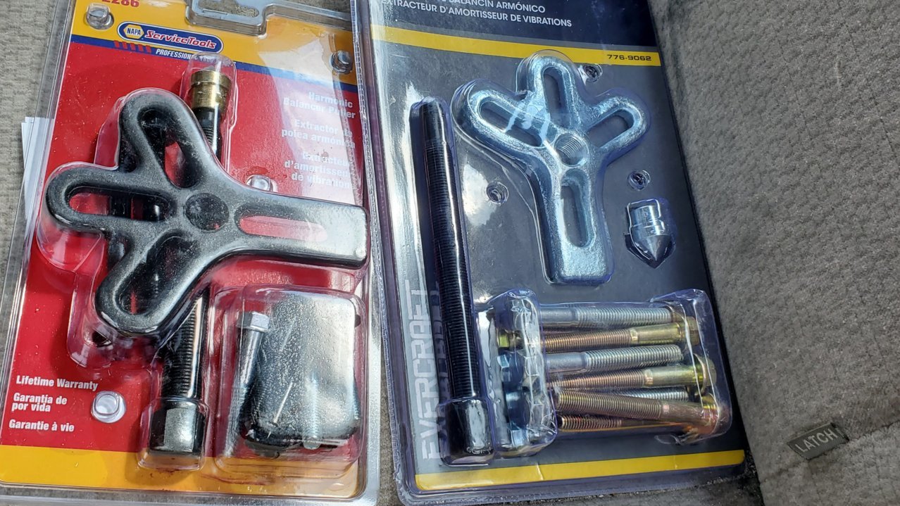

    Second, that's one of two pullers I have, and the one I've used most over the years for HB and all kinds of other stuff, including a couple of steering wheels. Good kit to have.

    Thanks again @shifty` and @dbittle for the positive reccos on the puller. The 7-ton three-jaw I rented today was honestly too big to fit in the space.

    Western Kentucky
    So progress is slow. Deep has worn off and sun is setting. Skeeters are getting fierce lol
    @shifty` @bmf4069 @BubbaW @empty_lord

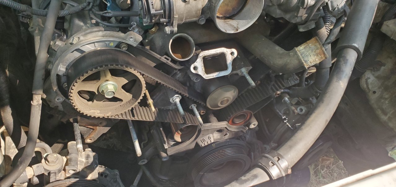

    I bumped the passengers side cam when taking the old belt off. It's now sitting like this.
    It was straight on with the timing mark. What do I need to do? A full revolution until back on mark? I don't want to proceed until I hear from yall.

    If you just bumped it that degree, just bump it back?
    arent these engines roller followers? Dont listen to me, furthest ive gotten into mine is sparkplugs, but if theres a reason this valvetrain is one way only, i’m interested to know why.
    my bad, google images looks like cam on bucket.

    I appreciate the feedback, but I'll wait for more replies before trying. For now, I'll clean up the water pump seal seat.

    Grab the cam gear and turn it back to it's original position. This has happened to me many, many times.

    If you only bumped it small degree, you can get it back when putting belt on.
    Suggest watch starting at 12:30 mark where he first adjusts driver cam after putting belt properly on crank. He then adjusts pass cam.
    Toyota 4.7 Timing Belt (updated) Part 3 - YouTube
    Tundra2[OP], FirstGenVol and bmf4069 like this.
