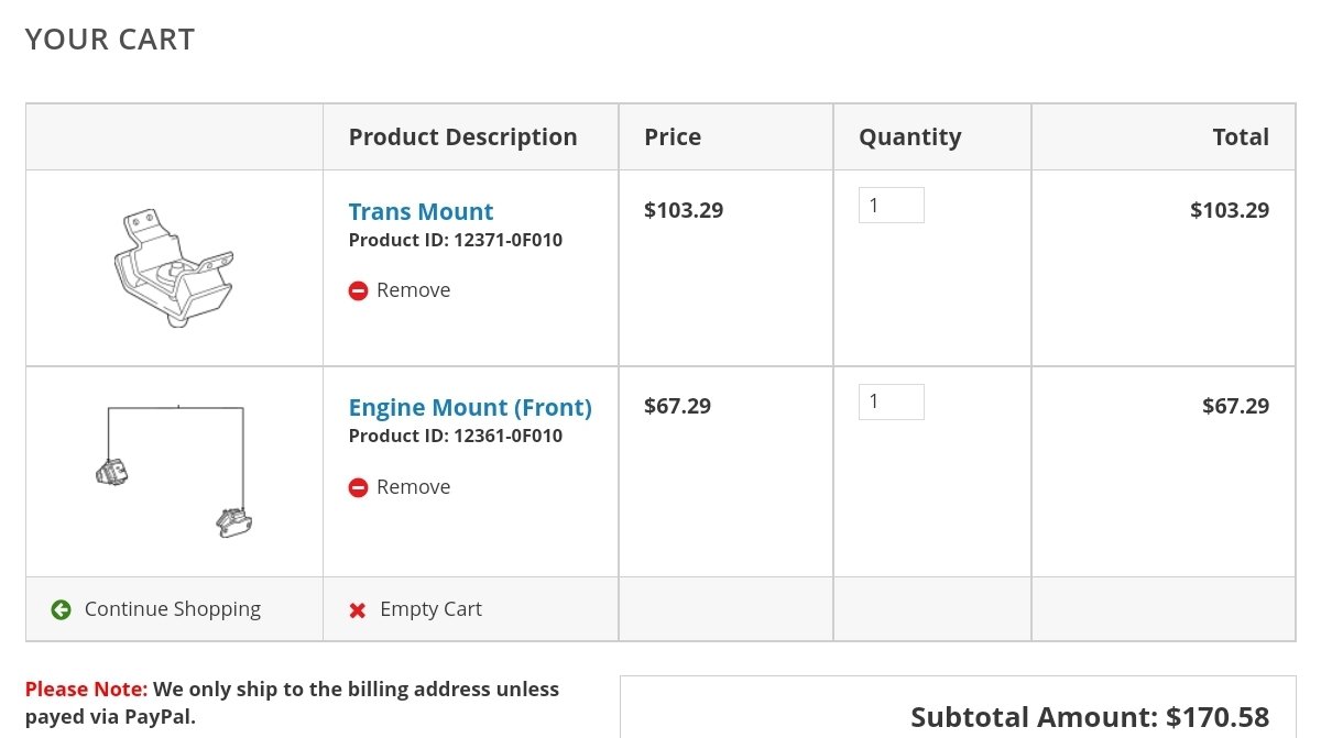

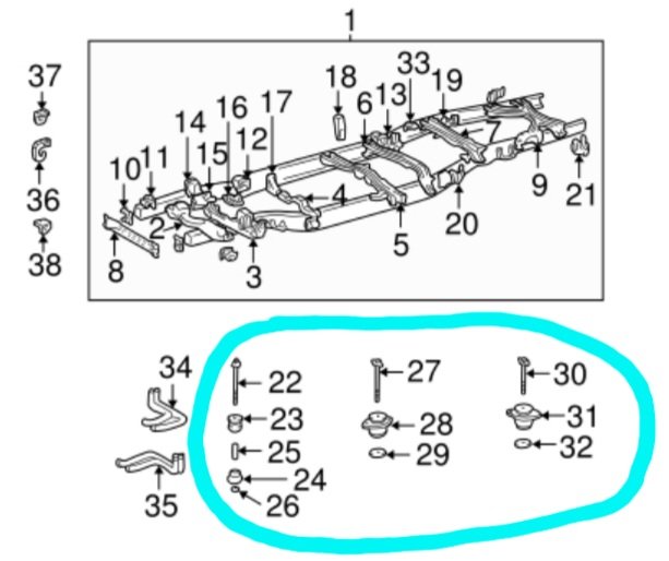

    Lots of ideas have been discussed here. Decided to just go down the Toyota list first. Knock out one category at a time.
    In my mcgeorge-fu search I've found all the left side body mounts, body mount sleeves, bolts, and everything circled in this picture below.
    Here is a link to the page if anyone else wants to help me confirm.
    The parts listed on that page all say front left, center left, and rear left, etc... I'm assuming that these are universal like sway bar links. Never seen a Left/Right designation on sway links!
    My mcgeorge-fu is weak this AM. At the time of this post, I've only got the engine mounts, and te transmission mounts in my cart at McGeorge.

    I believe you got it correct. It is slightly confusing that they designate a left but not a right. If in doubt though, ask them to verify.

    Your diagram screenshot is much more clear than mine! Looks like @jpink 's steering rack bushings. Scary! But yes, looks to be very two piece like...
    I've sent an email to Mcgeorge staff. Thank you for reminding me about rusty Wallace also. Should really compare prices...
