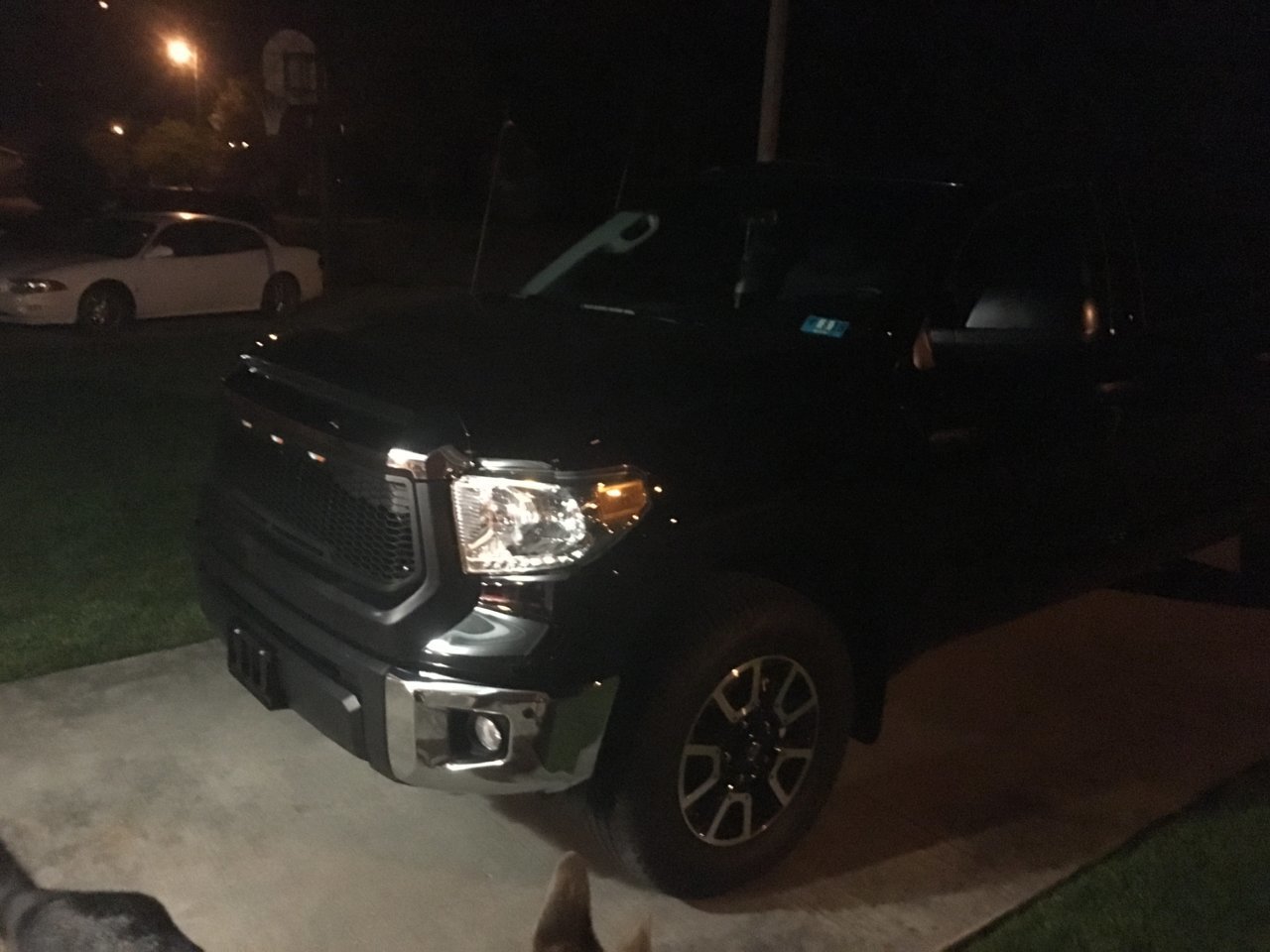

    First, anybody with any advice for wireing the 3 amber lights for the EAG Raptor Conversion Grille? Second, I'm looking to lift/level the truck. Will a suspension lift do the leveling or will I need both? Third, I have the stock chrome Grille and a blackout overlay for the Toyota emblem. Anyone interested?

    First tell us if you want the raptor lights to be on constantly or with parking lights.
    Second, use bilstein 5100s all around with the front set to the middle setting with a coachbuilder shim on each side and then you're level and will have a better ride than lift blocks.

    I just wired mine up today. There is a connector for the dtrl on the driver side in front of the battery. I connected the red wire from the grill to the purple wire from the connector and the black wire to the white black wire from the connector. This will run the leds with the parking lights.
