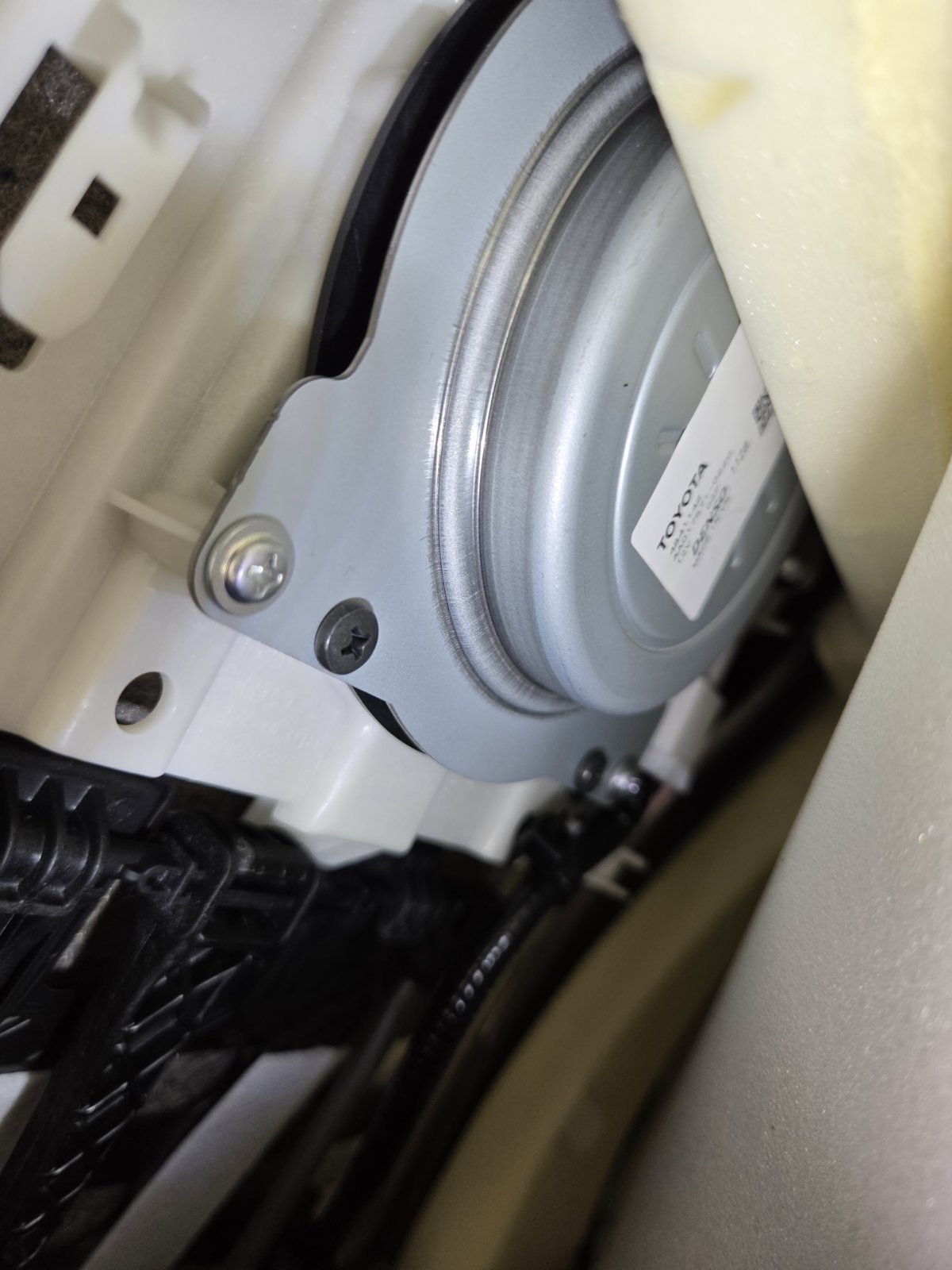

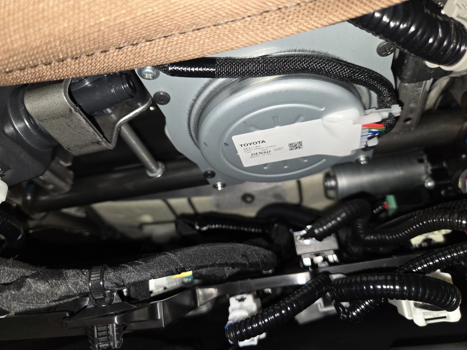

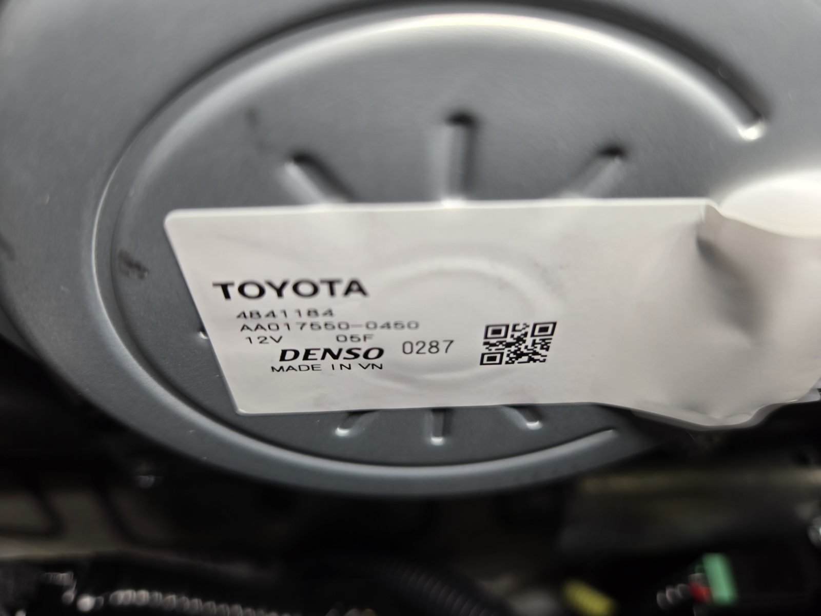

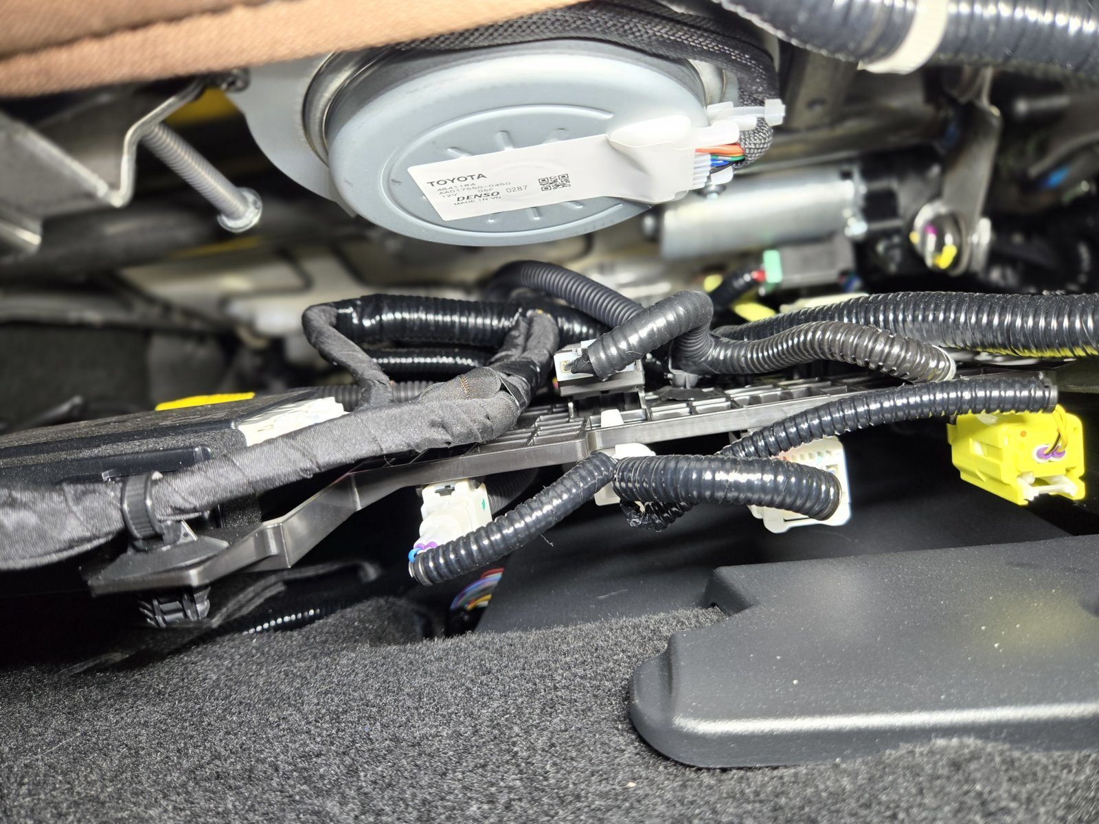

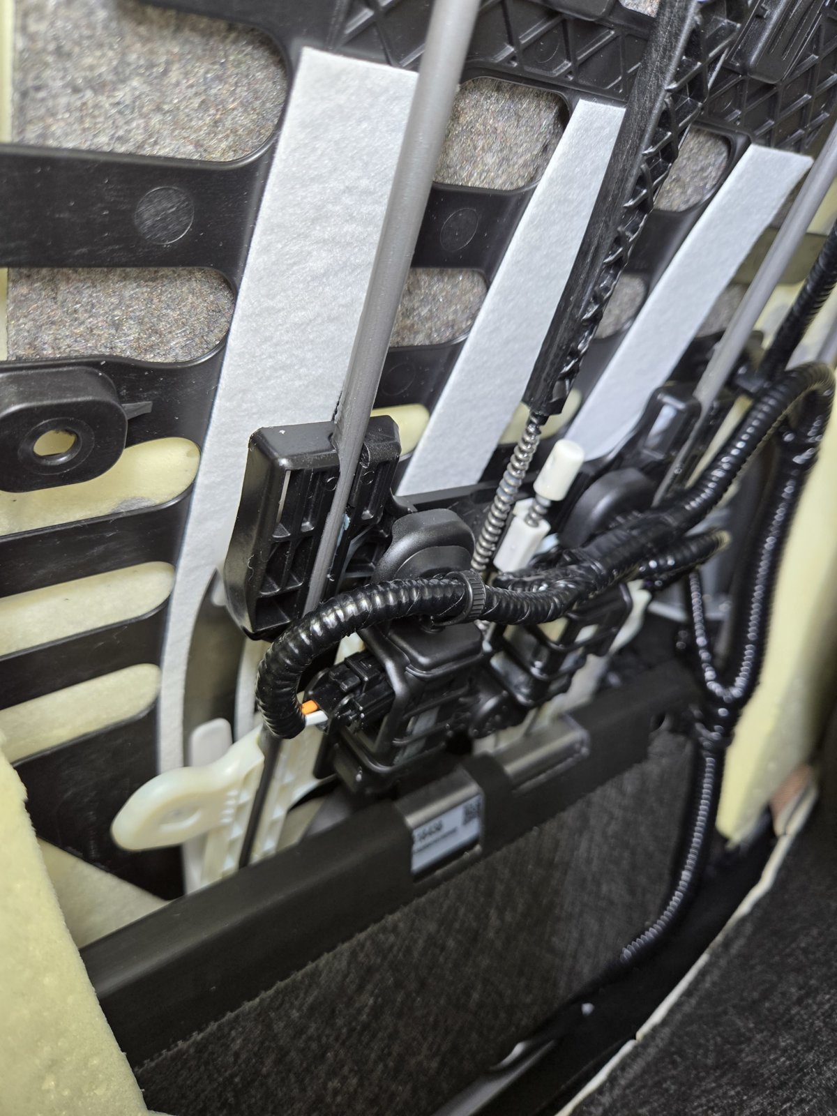

    Ok here are some more!
    20240817_184506.jpg 20240817_184446.jpg 20240817_184701.jpg 20240817_184735.jpg

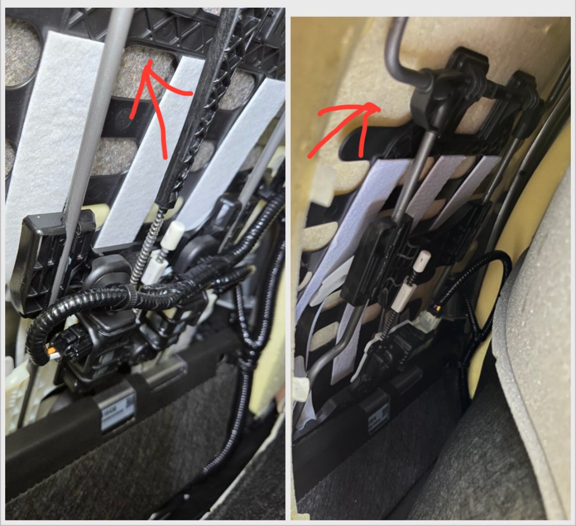

    @MrKABC, this is great!
    We’re at the beach this weekend. Not in front of my truck. Kids won’t sleep. So here I am! lol
    Looking at just the back for now, seems like there’s more differences than I thought. I see more overall structure, more lumbar support things that require plugs? And from what I can tell, the top half has some grey mesh-type material I’m guessing to diffuse some of the air to the back from the fan?
    Mine just has the same dense foam material and yours has the grey looking mesh. I can tell the fan is mounted higher in the back seat from your pictures. Yours is on the left below and mine on the right in the side by side.

    I also see a good bit more wiring back there in your picture. I followed the path where your split for the fan was and don’t see that in my picture. Something tells me it’s a different master wiring harness all together.

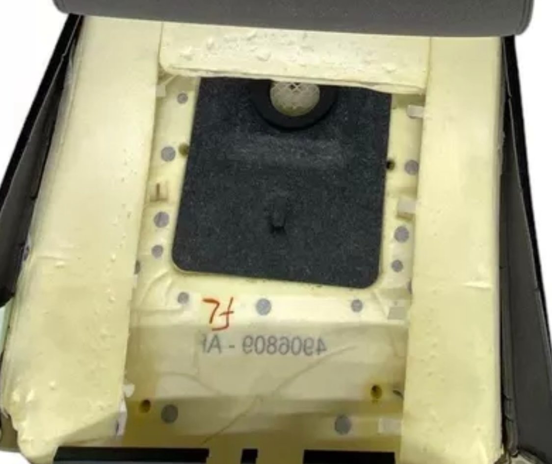

    Then I see things like this online (which is supposedly from a limited) showing a larger cavity back there and a mount point for the fan. Maybe the filler grey mesh was taken out on this pic? I just have so many questions for what’s going on with all this.

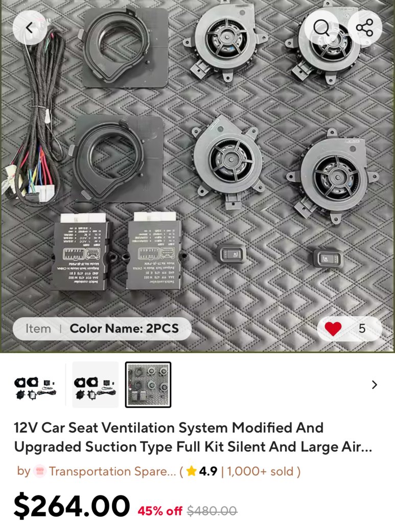

    I had my eye on this. Very interesting. I’ve always thought a seat ventilation system was a fan that blew air on your butt and back but this looks like a suction where it pulls air. Wonder how well that would work?
    https://a.aliexpress.com/_mrU3lQr

    With the suction, it seems like there wouldn't be any flow where you make contact with the seat. Although the seats are very porous, so air may suck in all over. My old boss had an f-150 the cooled seats had actual a/c air blowing out. It was great.
