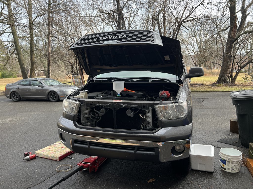

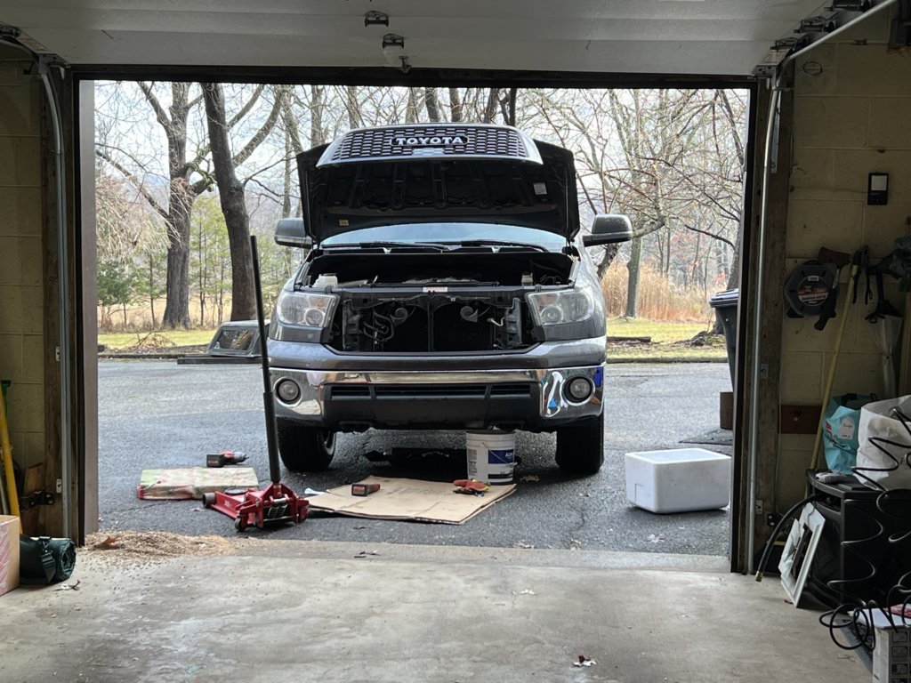

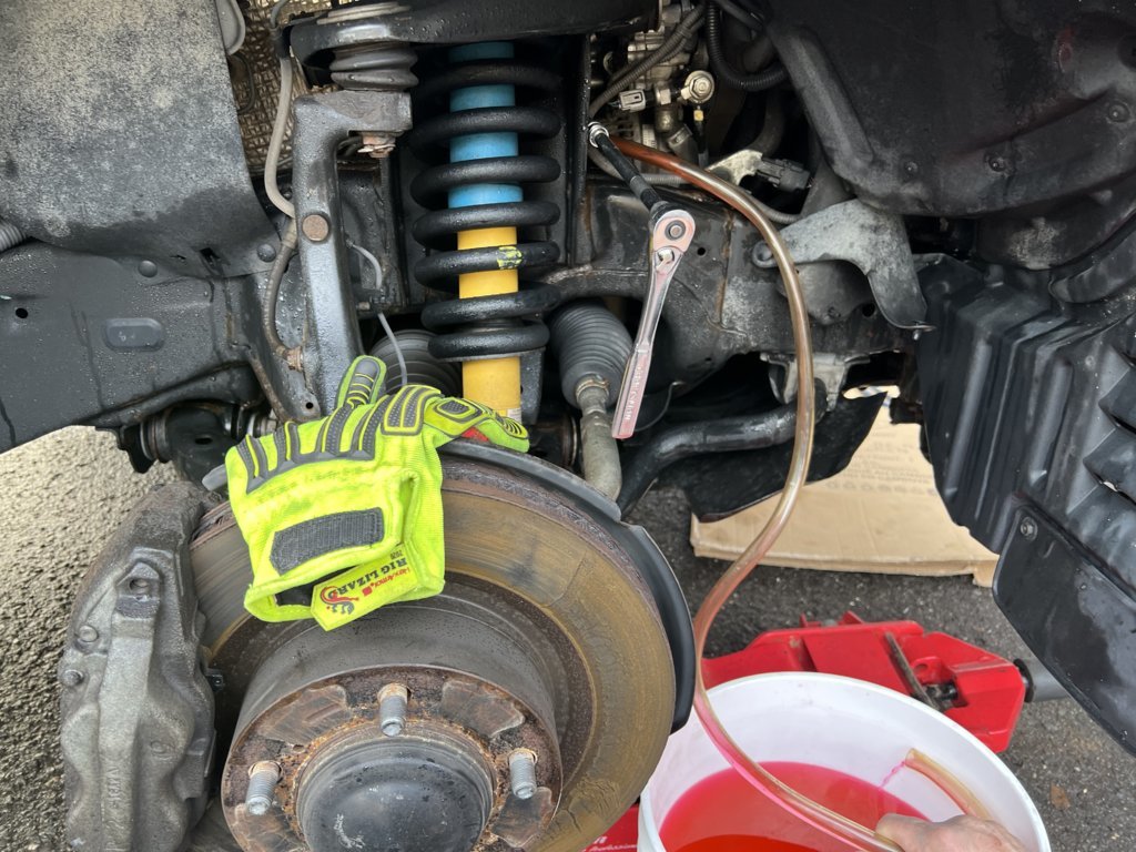

    Tundra coolant drain and fill
    I currently have 39.5K miles on my 2018 Tundra.
    I read the above posts and watched a couple videos which inspired me to DIY coolant replacement. I used Zerex Asian Red coolant, as I have had good luck with non oem coolant in the past.
    I took the cap,off the radiator, attached a 5/16 tube from the petcock drain (driver’s side) to a bucket. Opened the petcock and drained about a gallon, then put the cap back on and this drained the overflow. Once the overflow tank gets to the near bottom, about 1 inch, I took the cap off the radiator again to get the rest of the radiator drained. Closed the radiator petcock.
    Drained the engine block passenger side only, as not much comes out of the driver’s side per reports. The engine block passenger drain is located in front of the engine behind the rubber shroud. Remove the rubber shroud to get access, (I left the front most clip on and moved the shroud out of the way). Attach a 5/16 inch id hose to the drain pipe to the bucket. 10 mm socket with extensions to loosen to open drain. Drain till it stops. Close drain, reattach shroud.
    Fill the radiator, burp it by running the motor to open heater vent. Attach cap. Fill reservoir to fill line. Be sure to check again when cooled and after a drive cool cycle. I used about 2.6 gallons in the refill of the radiator and overflow tank.
    I used a funnel kit to reduce splash (Amazon $20).

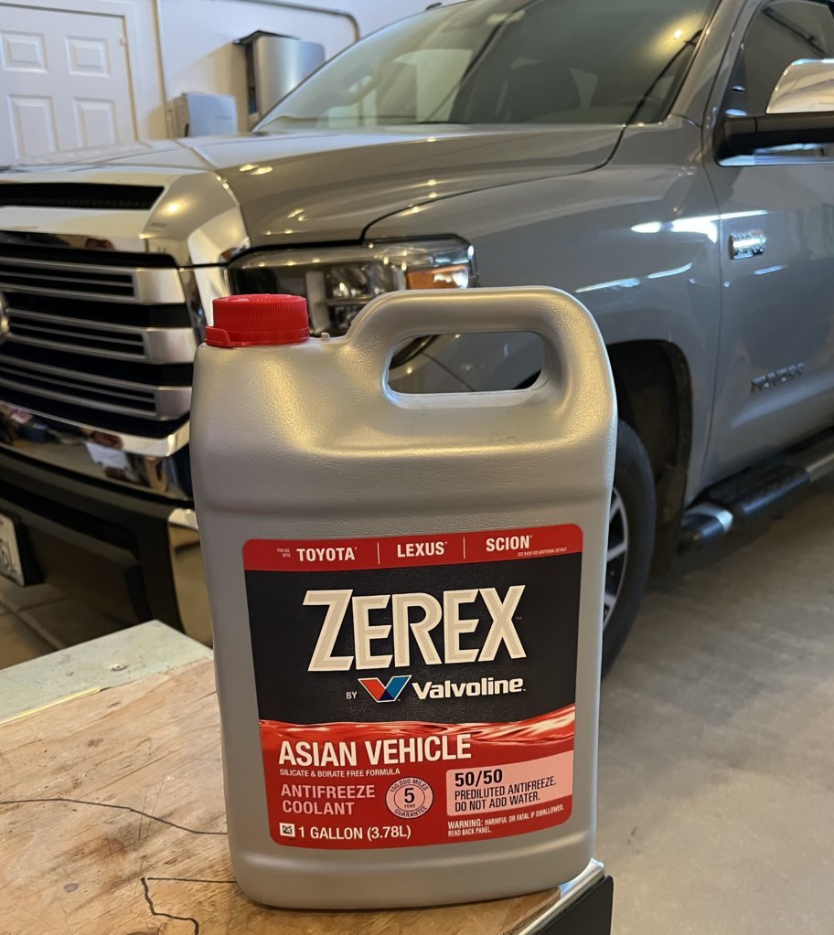

    Well boys and girls, I didn’t buy enough coolant. I finally got myself to get this done and managed to drain over 2.5-2.6 gallons. My driveway is slightly slanted, so to counter it, I put rear on ramps, which elevated it slightly above the front. I think this may have been contributing factor to getting well over 2 gallons of coolant out.
