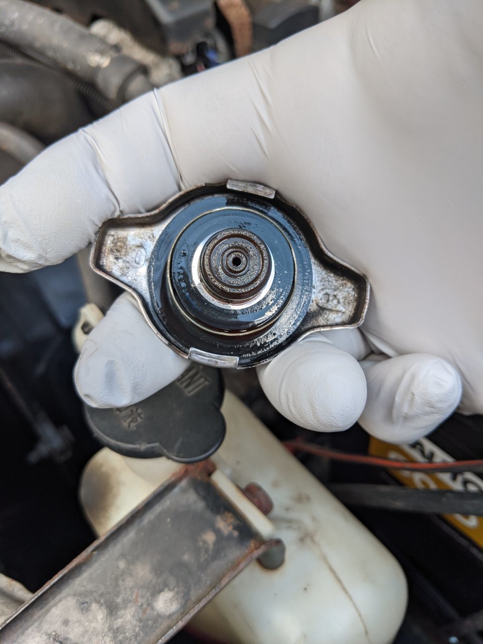

    Maybe I’m blind also but this looks like rust colored water. If the inside of that radiator looks anything like that hose clamp your beyond flushing. Maybe a new radiator?

    Take a pic of your Radiator looking down into the hole with the cap off. Grab a pic of the Rad Cap as well.

    ThatYeti
    ThatYeti [OP] New Member
    Mar 28, 2021
    #61069
    352
    2000 Tundra SR5

    I would consider it. Worst thing that could happen is the corrosion between the junction where the transmission fluid enters/exits the radiator and the coolant in the radiator itself. At that point you’ve entered “pink milkshake” territory and could cause extensive damage.
