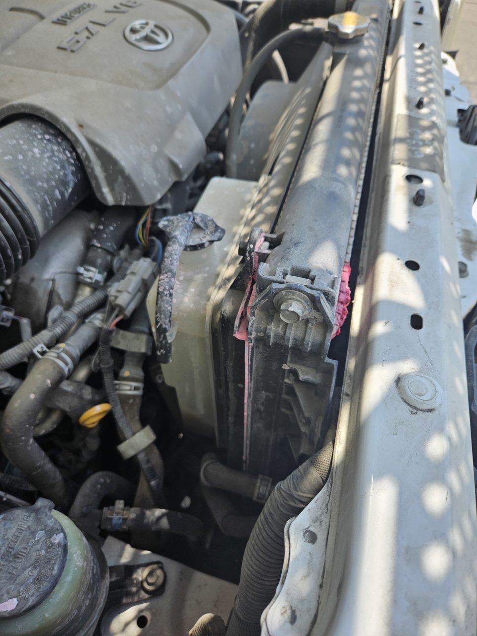

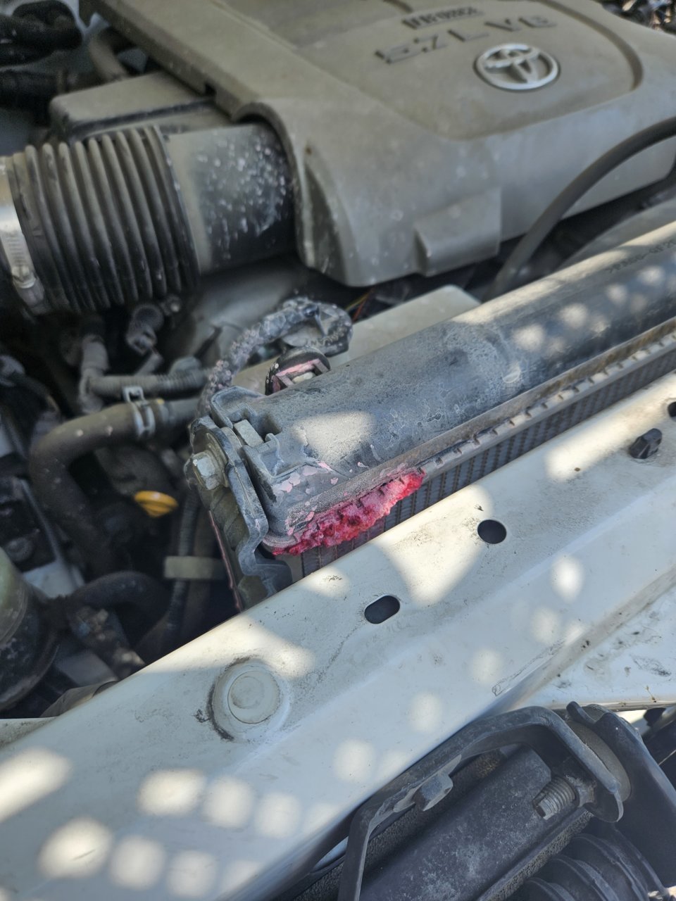

    I noticed coolant leak and splatter under the hood. Any thoughts on what the issue is and how to fix it?

    Looks like you need a new radiator.

    Is it safe to drive?

    If it holds a little bit of pressure, you can limp it for a while. I wouldn't go on a family road trip to Arizona in it though.

    The plastic on side crack after awhile. I’ve had three rads all leak on side.

    Only until it isn't. Ignore/botch it with Radweld at your peril...
