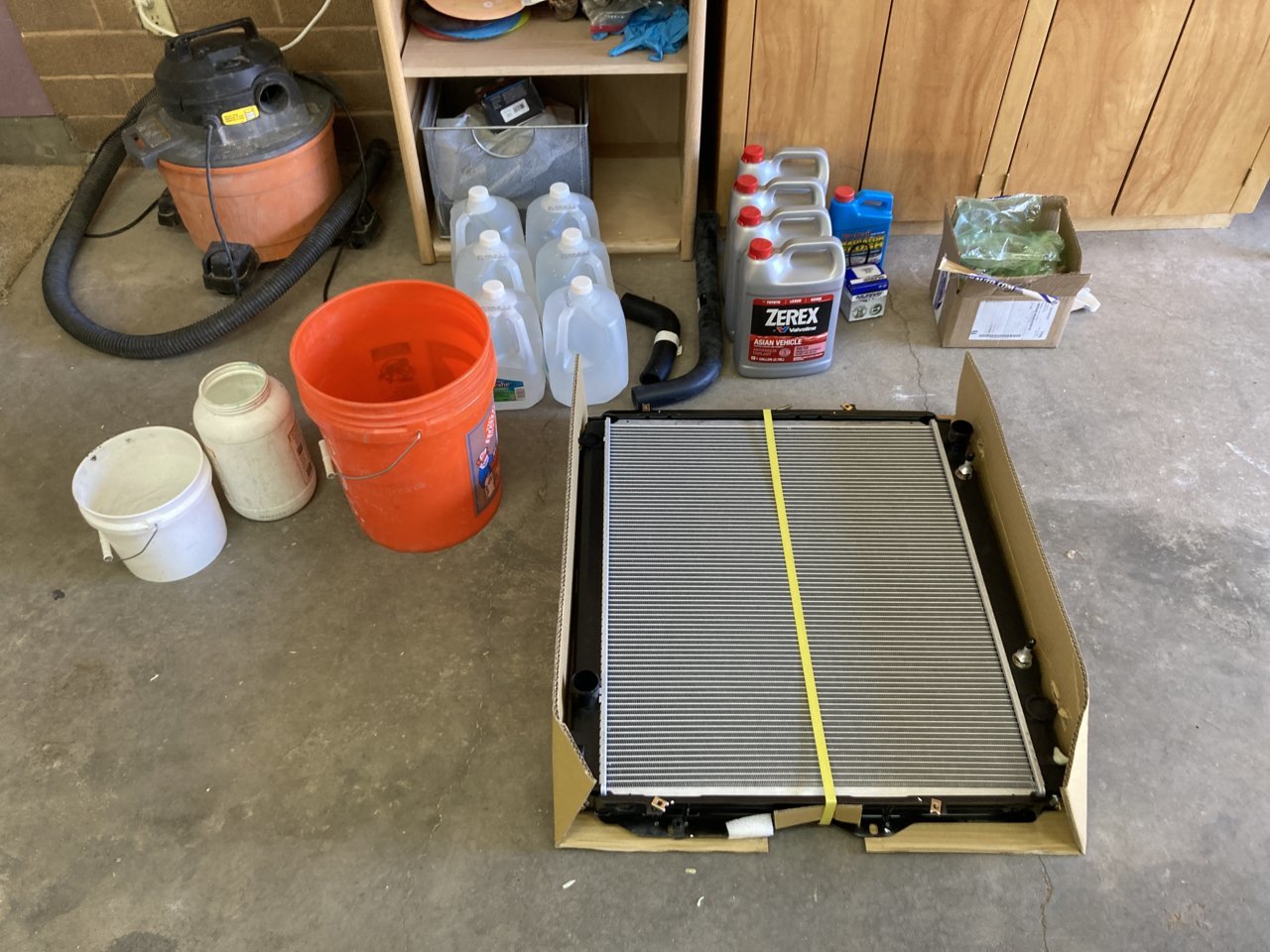

    I went ahead and got the thermostat/gasket locally but the store didnt have the upper radiator hose. I am hoping to find that elsewhere today and start the process later this morning.

    I'm finally getting around to changing the "all vehicle" green antifreeze for the correct one. Looking at Toyota Parts they sell 5 different types of coolants both red and pink. Which is best for 2000 Tundra.

    Game day

    lol petcock wings immediately snapped so i removed the lower rad hose to drain. dont do this! i took a little coolant bath

    Drained
    Fill with water, run 15 min
    Drain
    Fill with cleaner and water run
    Drain
    Fill with water run
    Drain

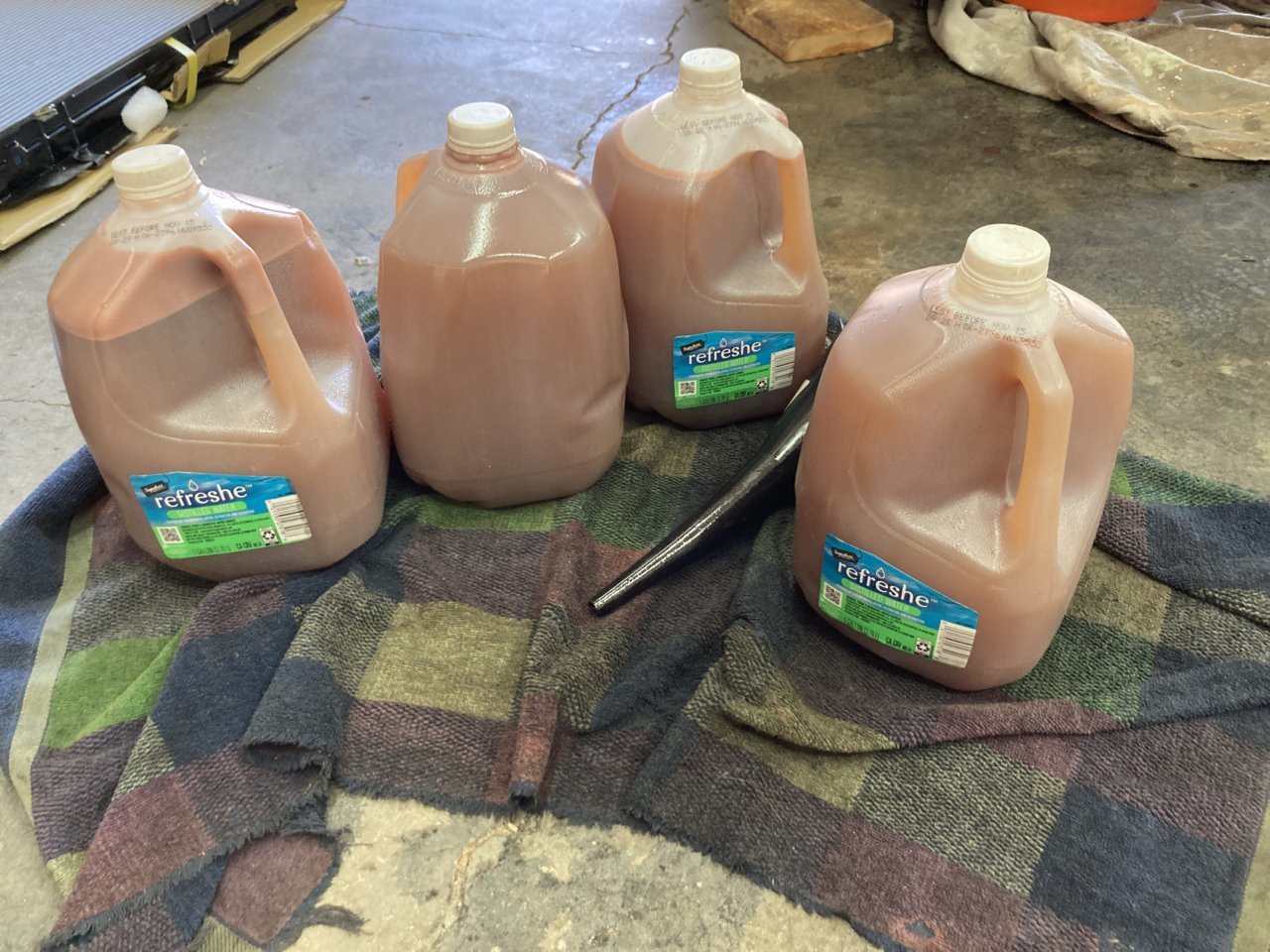

    Fill with water run.
    Lots of sludge came out but last drain is clear-er.
    Old fluid and drains:
    Time to unbolt rad and get at the thermostat as well.
    FrenchToasty and bmf4069 like this.

    If it wasn't already mentioned, did you know about the drain plugs on the engine block too?

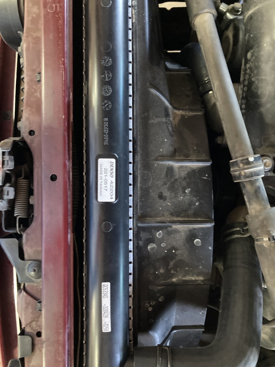

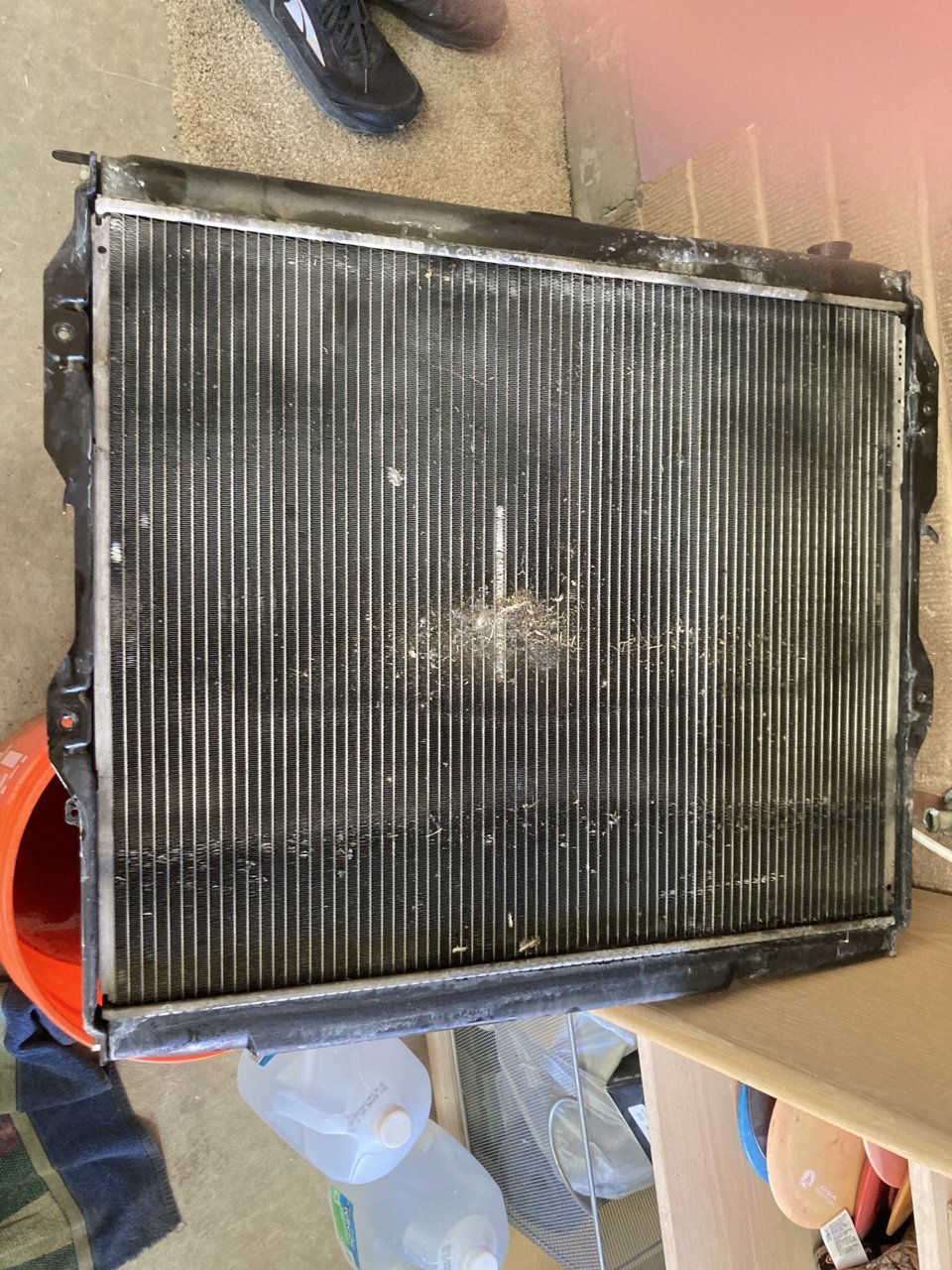

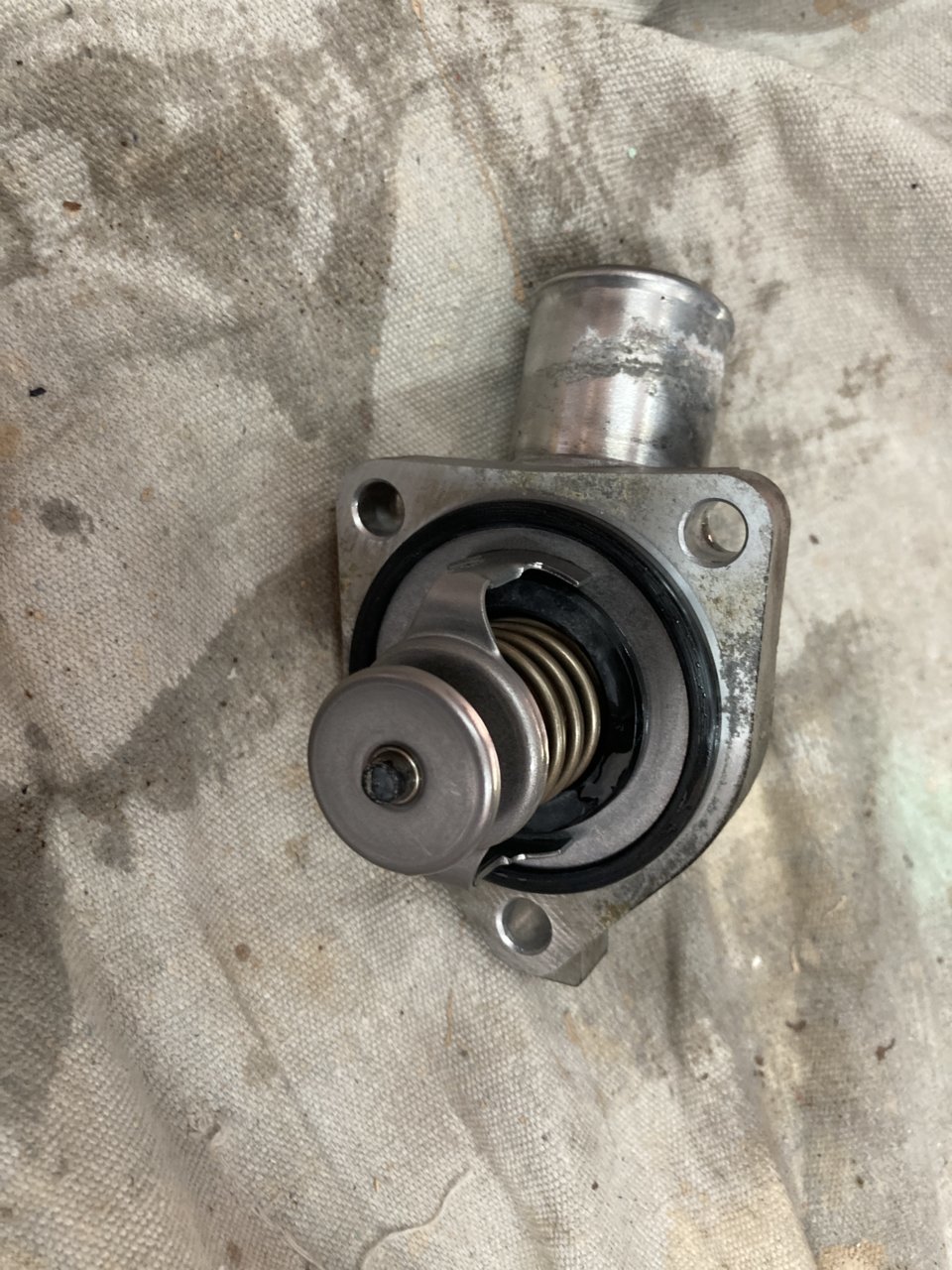

    all set.
    need to go for a test drive.
    that was not hard at all.

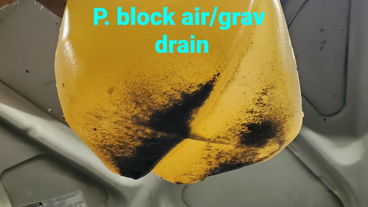

    Meh. Drain plugs are overrated. They're great if you want to fully drain an engine before pulling, but for stuff like this, where you're going to be flushing repeatedly, I feel like it's maybe overkill. Granted, if you did use them, you could probably shave off a flush or two, just because you'd have less contaminated water in the block after each flush.
    Sludge out is GOOD! That's a lot of sludge on the left.
    Hell, I'd have kept going. I'm shocked at how little change there is between each gallon :D
    scAmazon has a 6pk of Prestone flush, product num is AS 105. That's usually what I get for a full flush, and, as much as some people would disagree with me on this, I run the flush with a straight-up hose water. I've seen guys hook up a waterhose straight up to the t-stat housing neck, and leave things open on the other side to flush out (after draining completely and capturing the existing coolant so you don't kill anyone's cat or dog).

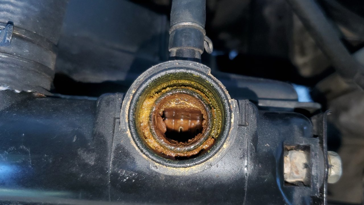

    I'd have used the drain plugs, but that's just me.
    Here's what I got out of the passengers side engine drain using a NPT 1/8" nipple with a hose going into my water jugs.
    This is what I started with though so.....
