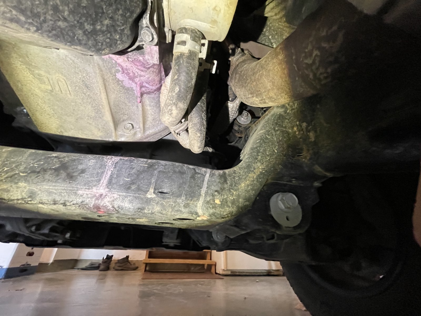

    Saw a dried puddle of coolant on garage floor. Climbed under and saw signs of leak. Idea of what this can be?
    pics try to show area
    2018, 5.7L, 40k miles
    Bought extended warranty. Will take it in. Would like to go in informed. thanks y’all

    Update. Leaking at heat exchanger. Dealer said warranty not covering because they consider this a wear item since a rubber tube. Does that sound right? Going to call myself but seeing if any advice before I do

    Thanks. The video said heat exchanger needs to be replaced then he corrected and said resealed and probably o rings. The service guy said warranty told him it’s a rubber tube so won’t cover it. The heat exchanger is a metal plate, right? May be a service person not informing them correctly?

    Update. I had to call warranty myself and sounded like confusion btwn them and dealer. Two issues to be repaired: Heat exchanger plate seal and the inlet pipe/ o rings.
    heat exchanger covered and pipe is not. Went from $2200 to $750. Where it’s gets gray area is the labor charge for either and how that got divided up. I went ahead and will sort it out further w Toyota

    Update. Lots of BS w dealer. Warranty team has been fabulous. I wish I knew at the start what I know now thanks a lot to this forum.
    Warranty covered the Fipg on heat exchanger plate but not the water inlet pipe. Here’s the bs:
    Dealer didn’t need to replace metal pipe, just orings. Ok only added $20 part. But they charged me $730 labor. After many calls w warranty I realized only the part was denied and they indicated no labor should be charged as it’s part of same repair. Videos everyone shared confirms this. After many calls w dealer were unsuccessful and service manager w no reply, I finally filed a complaint with Toyota brand engagement. I got 540 of the 730 labor refunded. I’ll accept this and call it done and lesson learned.
    I don’t know how dealer service is really handled but I wonder if they purposefully replace pipe instead of just orings as they know it will be warranty denied and an opportunity to add lots of bs labor.

    There’s normally zero reason to replace that pipe. It’s made of stainless steel, and simply doesn’t have corrosion issues. Nor is it damaged during during R&R of the valley plate (Toyota’s heat exchanger description is weird, probably a translation issue) or timing cover jobs.

    Just read this post...I am filled with rage based on your dealership experience. Those shady and incompetent f_cks! That was clearly just a coolant valley plate reseal that should have been completely covered under warranty. That coolant valley plate has been such a common repair on the 5.7 V8 for the last decade. The parts list should have been 3 gallons of coolant, 2 O-rings, a tube of coolant fipg, and intake plenum gaskets. Parts & labor should have been all under warranty.
    I am sorry you had to f'n deal with these a-holes. To be clear, I was a dealer tech for Toyota & Lexus for 10 years. Not all dealerships are like this.
