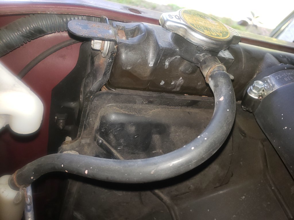

    I noticed my coolant bottle was empty so I filled it. It seems to empty after about 10 miles of driving. I figured the leak would be easier to find if I let more coolant spill out, so I kept refilling the bottle. The inside of the engine bay is splattered with pink spray all over, but the leak did not become obvious. I think its in the front and the fan is spraying it everywhere. Every time I've checked the radiator when the engine is cold there has been coolant visible at the top and the fins in the radiator looked submerged. I have gone through 2 gals of coolant and stopped filling the bottle since the level in the radiator seemed stable. Now the level in the radiator is lower.
    How should I find the leak?

    If you're spraying all over the inside of the engine bay, it sounds like your radiator cap is fucked. Might want to address that. They go bad, you know.

    Oh, and the directional spray suggests it is, in fact, the radiator cap. We have some pics on here of someone who actually had the bottom half of their cap fall out. It's spring loaded underneath the cap. Not asking you to be a CSI detective here and look at blood spatter, but spatter directionality and voids will tell you a lot about where stuff is coming from. Just know: Liquid will ricochet off stuff, so ...

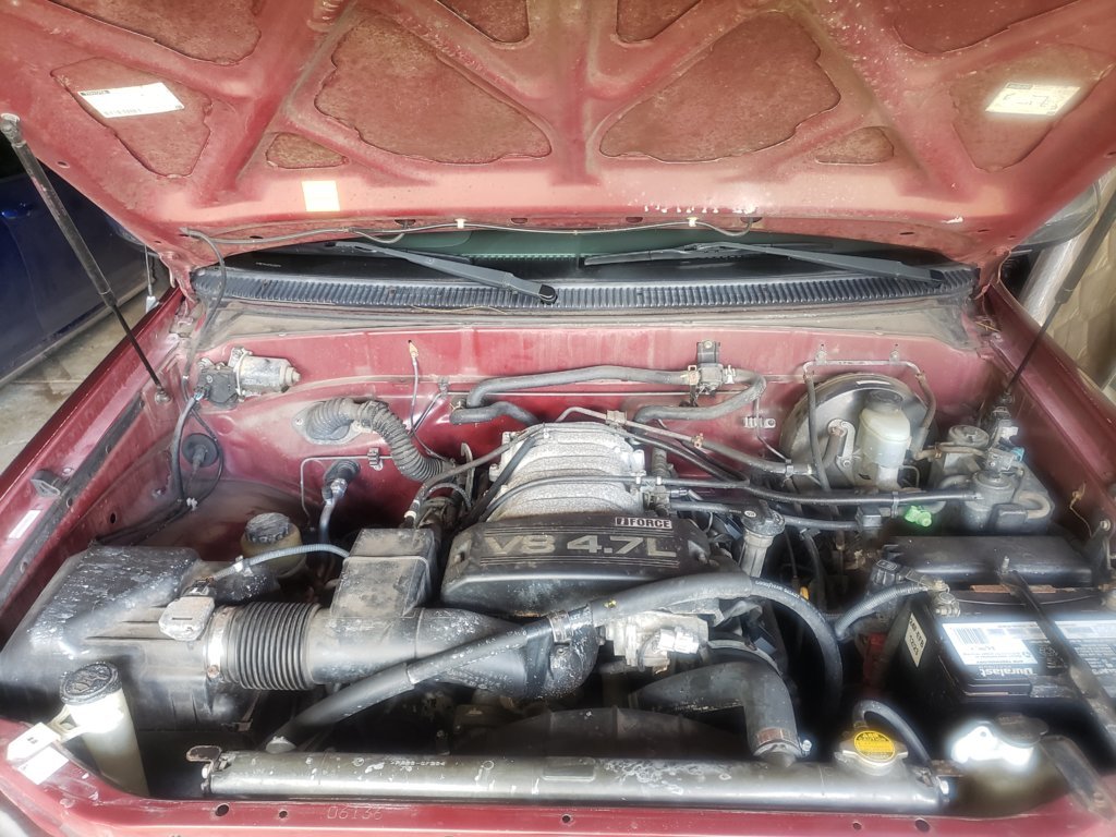

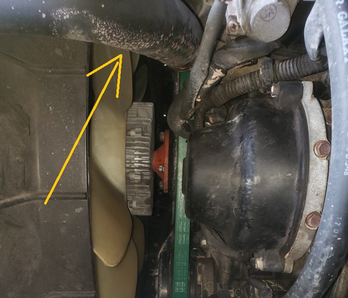

    That is an understatement. I thought letting it spray more would make the source more obvious but there is so much spray everywhere its really been puzzling to me. It seems to be hitting that refrigerant hose and the oil fill spout a lot. The hood is getting a lot of spray too.
    My cap seems relatively clean, no obvious collection of coolant. I didn't realize it was a pressure release and there is no spout/outlet. There is no puddle in the bottom of the engine bay either. I definitely think the leak is somewhere in the top front/ near the radiator. Cap is $30 from my dealership. I'll see if that works then buy a pressure testing kit.

    Yeah, it definitely doesn't look like it's coming from the cap, I agree.
    A few places to look at:
    • Check your larger hoses for possible pinhole leaks.
    • Radiators are a slab of metal fins with plastic caps, and thin liquid filled tubes throughout; they tend to leak at the base of the plastic cap, and at those tubes, but sometimes it doesn't show up until you're at-temp, and revving the engine.
    • There's a small coolant hose that passes thru the bottom of the throttle body, check it carefully too
    • There's a bolt hidden behind the smaller tube in the pic, about 1-2" up from where the overflow tube meets the overflow bottle. I think it's a 10mm. Pop it out, push the fan shroud forward; any fluid on the back of it? Repeat on the other side, there's a similar bolt there.
    • Look for voids, places where there's no coolant spray, and see if you can figure out an angle fluid could spray and leave a void in that spot. Look for puddling, pink coolant usually leaves crystalization when it puddles.
    Really, people should be proactively changing their radiator at the same time as the timing belt, if you ask me. They're usually good for 125k-150k miles, but I wouldn't trust them much past 125k. Especially not when you consider you can destroy your transmission if the trans cooler line passing thru the bottom of the radiator leaks. Your coolant needs to be changed every 100k if you're using the correct pink SLLC coolant Toyota urges you to use, so why not do the radiator and timing belt at the same time, y'know?
    But if you can track down roundabout where the coolant is coming from, you'll answer your questions. Is it above, behind, left or right of the radiator? Or is it possibly one of the hoses, or is it maybe seeping from one of the metal housings/bibs where the coolant hoses clamp onto?

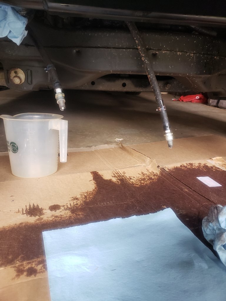

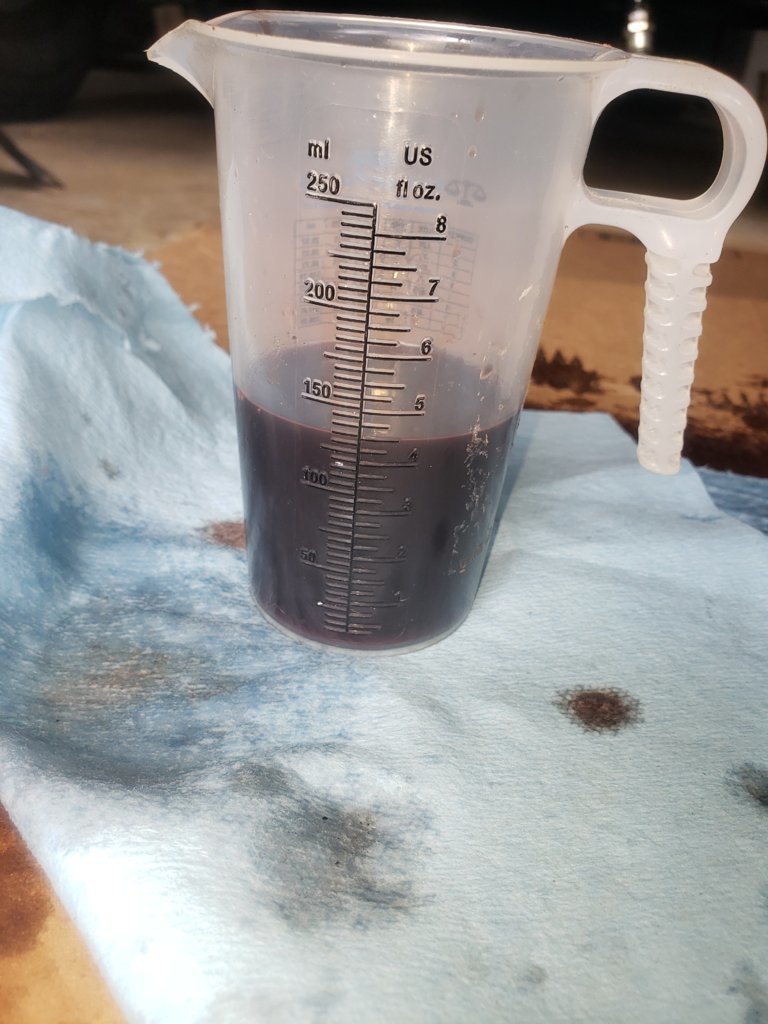

    If it has sat for a while most atf will have run down towards trans. Your'e going to loose a little ATF.
    What I did was use an old, CLEANED, spark plug and popped it in each hose as quickly as possible just in case.
    I caught all of the fluid, and poured it from the cooler into a small jar to measure for topping off the transmission later. I think it was about 3 ounces.
    No I would definitely not reuse any coolant, or transmission fluid.

    Answers to questions in post #11. Get a couple of golf tees and you can plug the transmission line so you only lose a few drops of ATF. Drain the radiator and disconnect the hoses. At that point you can replace the radiator but if your coolant is more than a year or two old, you may want to drain the block at the little drains. Be sure heater knob is rotated full hot. Use only Toyota pink coolant. I also recommend swapping out the OEM side brackets to your new radiator.

    You'll only loose the ATF that is in the cooler/warmer but it wouldn't hurt to plug the lines.

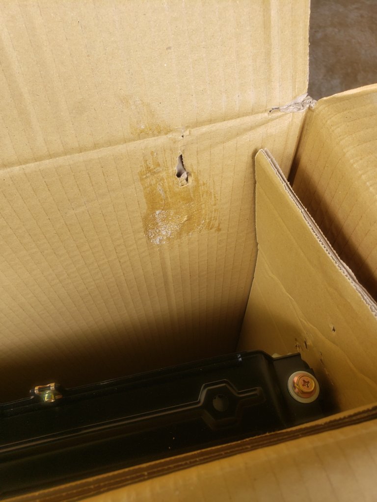

    I got the new radiator in and wanted to thank the forum again. If it weren't for the high quality contributors on this forum this job would have been way harder for me.
    For whats it worth I wanted to upload my experience.

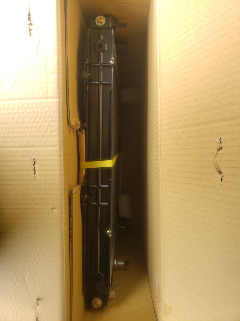

    The Denso radiator from rockauto seemingly arrived ok, but the box was damaged and there was surprisingly little packaging material in the box.
    I collected 1 gal of coolant and 4.5oz of ATF. I spilled a bit of coolant taking the radiator out and a little bit of ATF when disconnecting the lines. The old spark plug idea worked perfectly. I also used the rubber caps that were on the new radiator's ATF spigots to stop the drips from the old radiator while I pulled it out. Then I attempted to pour as much ATF from the radiator as I could. I collected about 2oz ATF from the lines before getting them plugged and another 2.5 oz of ATF from the radiator. More coolant came out when I attempted to pour the ATF, I should have expected that but it wound up on the floor. (Most of spillage in the pictures is from pressure testing to find the leak, the spillage from pulling the radiator was relatively minor in comparison).
    Putting the new radiator in was quick once I realized the fan shroud was in the way. The ATF spigots got caught on the bottom of the fan shroud (which was resting on the fan). The tabs on the radiator were through the holes on the truck but the bolt holes weren't aligned. Since the tabs made it to their holes I didn't realize the radiator was caught on the fan shroud and I tried to wiggle the radiator into proper position. I hope I didnt put too much force on the spigots or the fan. I read the spigots are a weak spot leading to the pink milkshake problem, and the fan bracket ages so may not have much life left in it.
    I pressure tested this morning up to 11 psi for about 5 min. Seemed great since the old one leaked at 5 psi instantly. The radiator didn't leak, but the coolant lines going to the oil filter housing starting dripping slowly after the 5min mark. I didn't warm up the engine before pressurizing so I'm hoping at temp that doesnt happen. Also based on my earlier testing it seems the coolant doesn't get to 11 psi often. Afterward I noticed a wet spot on the lower seam of the radiator, no drips though.

    Always appreciate a good followup, hopefully this resolves your issue.
    If not, you may have gotten a damaged radiator - smart idea to take pics. If you install a part and it shows issue, you can email RockAuto back (either using their website form, from your account page or by replying to the order email, IIRC) and notify them with pics of the box and pic of the leak, and they should resolve the issue for you.
    Denso is, sadly, known for the lack of insulation in their packaging. It's not a problem for vendors who get 10+radiators in a bulk box. But when you order from RA specifically, they often have RA drop-ship directly to the customer, and in singular format, they don't always survive as well. With vendors like scAmazon, you're pretty much at the mercy of however the person at the warehouse is feeling, and how much abuse they've seen from getting tossed around whichever warehouse they shipped from.
