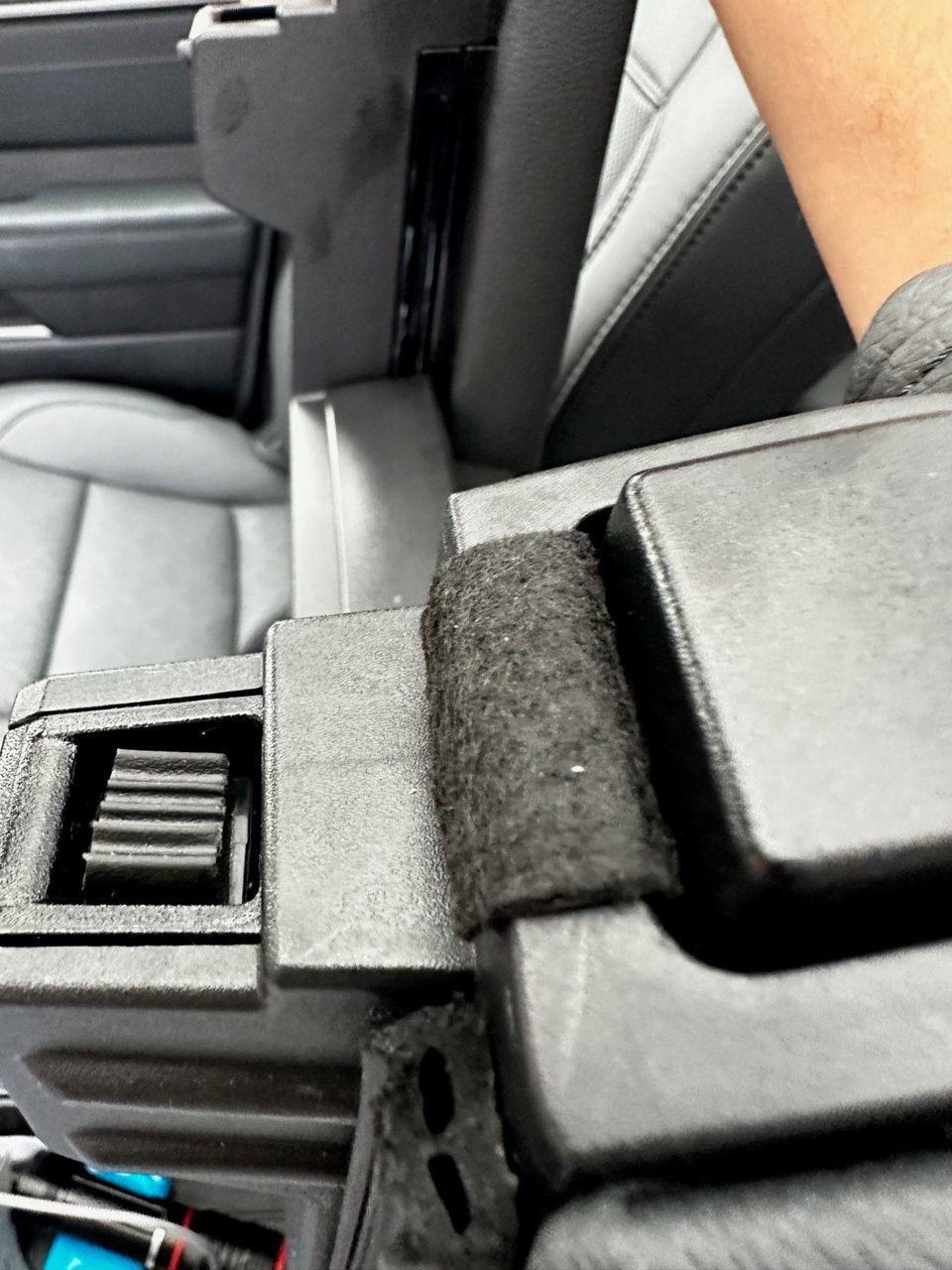

    Ok so I have been dealing with the creaking console issue. After seeing this post I decided it was time to experiment. I found that the passenger side latch was greased but drivers side was not. So I greased it and it got a little better. Then added bumpers below the latches for a tighter close and it does seem more solid. I’ll report after I have it for awhile.

    Ok creaking is better, but gonna try a thicker bumper. When I figure it out I’ll post pics

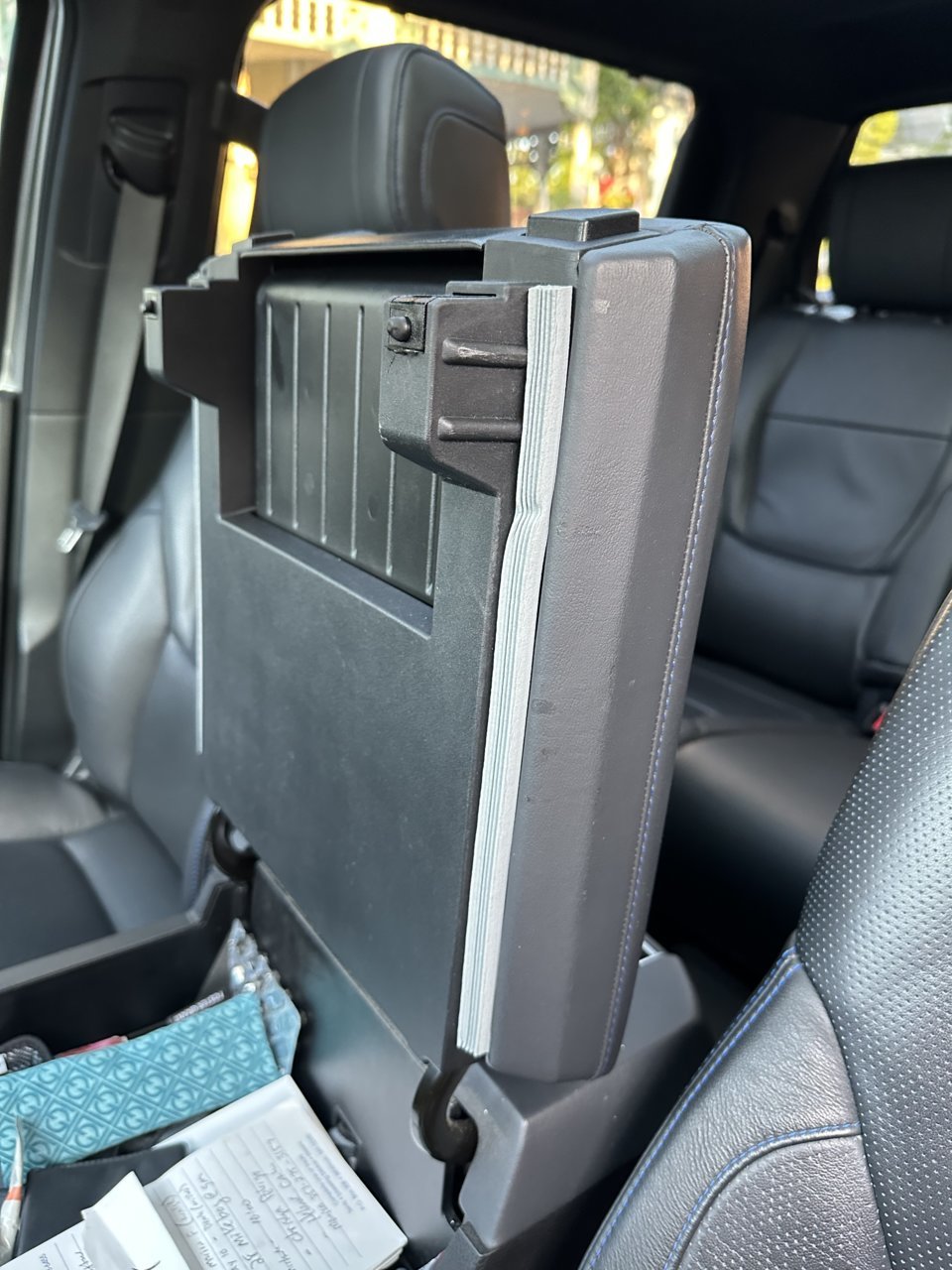

    I had the console creaking too. I bought stick on weather striping at a hardware store. Creaking is gone and it feels more solid, no play at all. I forget the size but it was the biggest they had and it was like $7 for the role. Simple fix that is unnoticeable

    That bend in the weatherstripping is where my phone wire just was

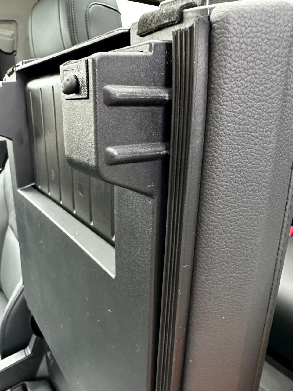

    I copied the weather strip this weekend and it made a big difference. I also added felt under the release button to take up some space and eliminate the rattle from the button. I would say I got about 80% of the noise with these two fixes. Thanks!!!felt.jpglid.jpg

    Wanted to chime in as I was also having creaking in my 2022 tundra and it was driving me crazy. This thread was a life saver. Thank you all for posting! I used the same 5/16" weatherseal as noted above on the underside of each side of the console and it drastically helped the noise. I bought mine in Black at Home depot for around $10.
    Also wanted to mention that after I installed the weatherstripping I was still getting some creaking from somewhere in the cab. It sounded more like from the dash area in front of the passenger seat. Turns out it was the divider/shelf thing in the glovebox. It was loose and the weight of the owners manuals was making it rub/creak. Removed the owners manual and clicked in the divider/shelf and no more noise. Thought this may help someone in the future.
    My creaking is pretty much gone now.
