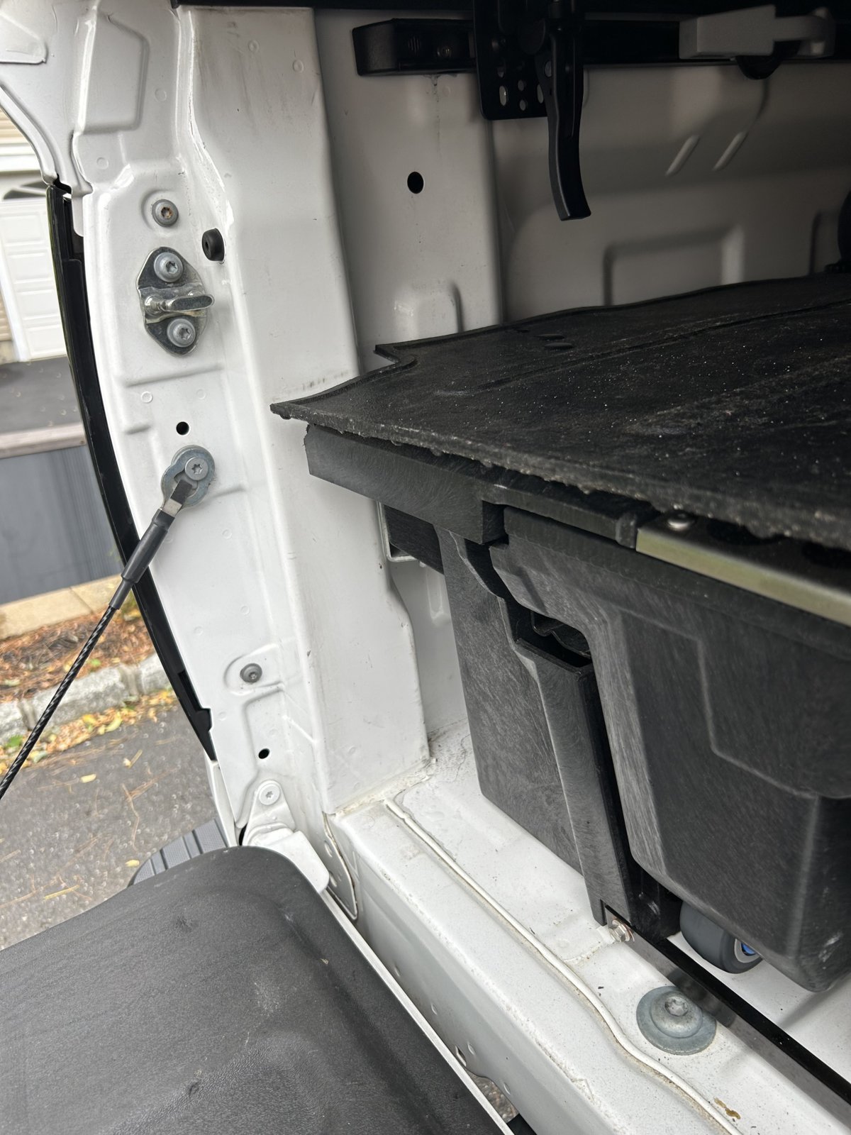

    Just wondering if any of you guys have run remote battery terminals to the bed. I’m considering putting them on the d/s just inside the tailgate. A set up like this:
    I’d like to be able to run my air compressor from the bed where I store it, rather than have to attach it under hood like I do now. Is it worth the time and expense of 20ft. X 2 of heavy gauge battery cable? Would I need anything else, in-line fuses, or relays? I’d try and stay along the d/s frame rail and up into this area:
    and use that grey torx as a ground, or would that not even be necessary? Thanks guys.

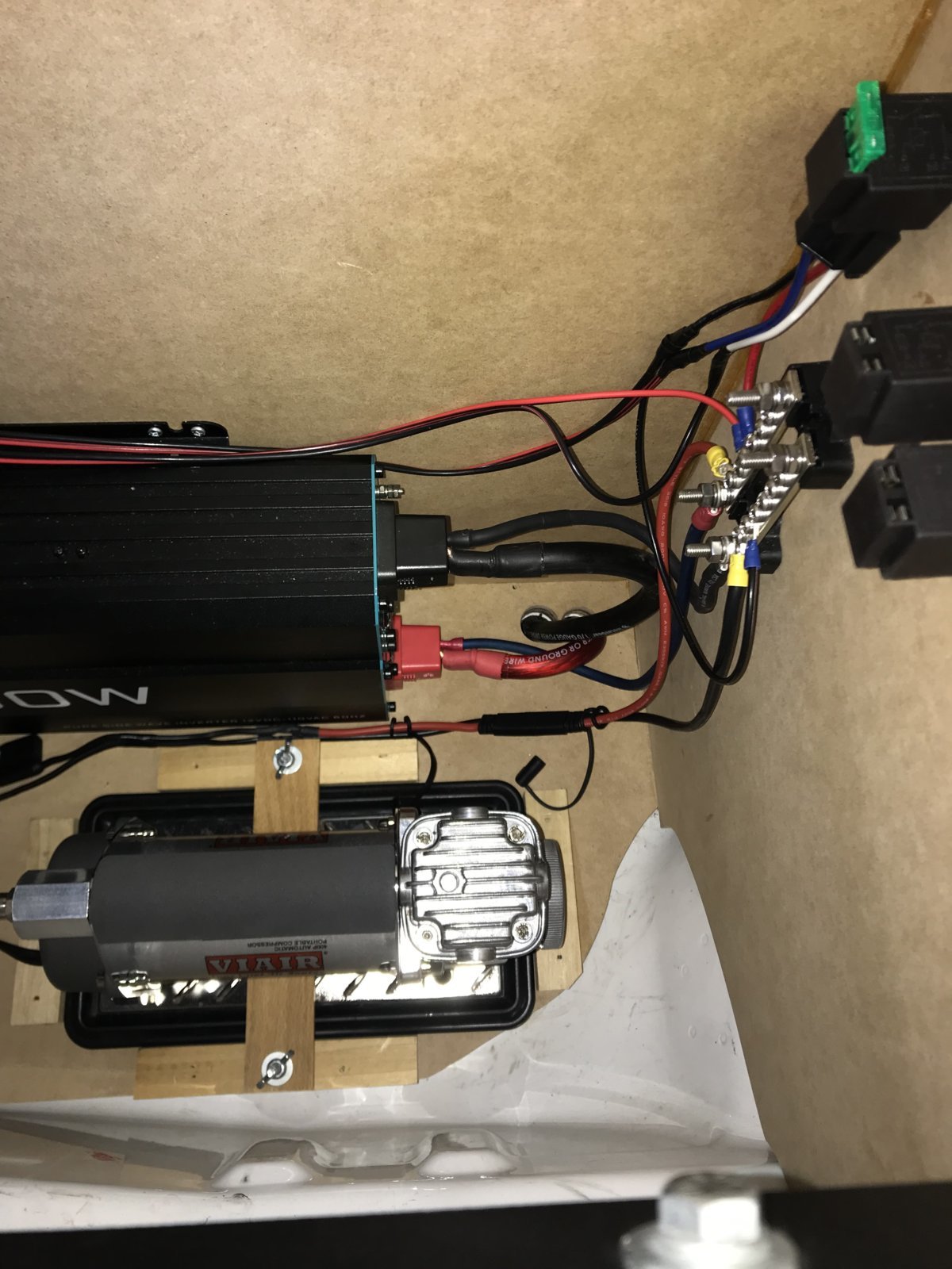

    The trailer plug does have a 40 amp fuse to it - I also have an inline fuse in my Viair - I just cut off the alligator clips and wired in a 7-way plug.

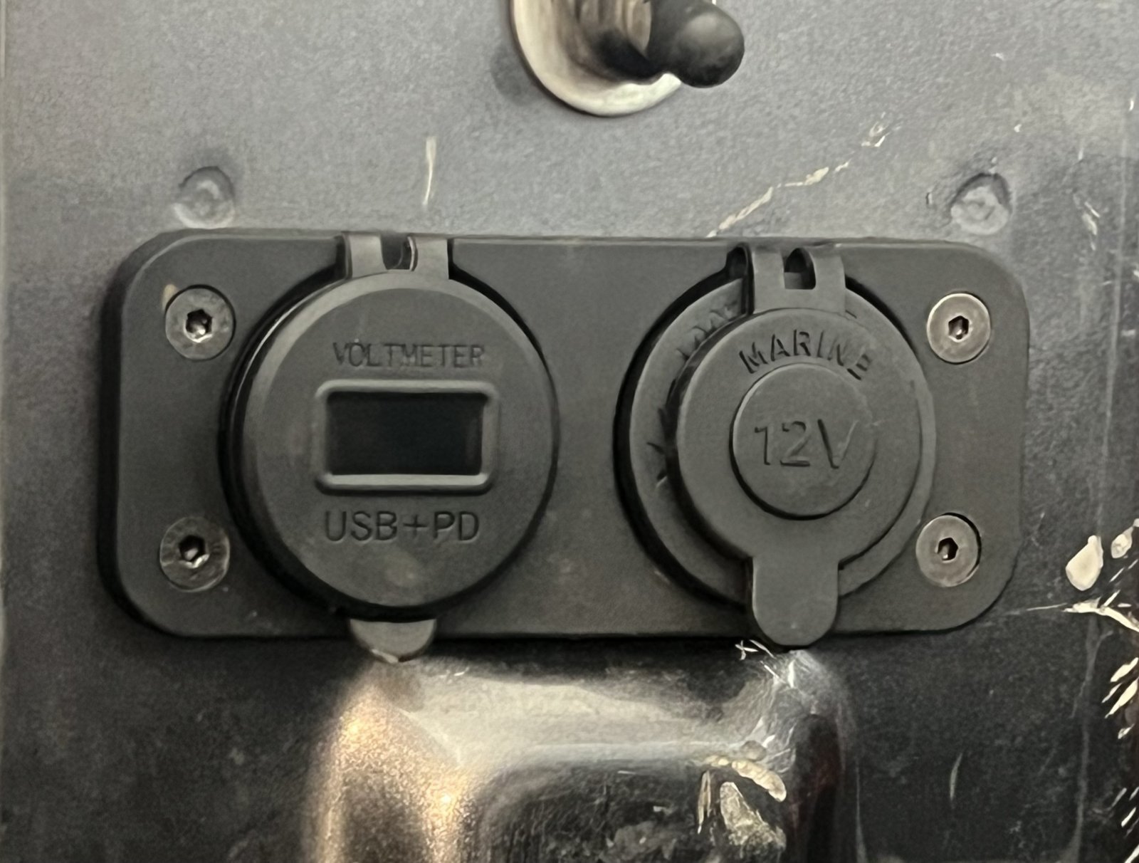

    I recently added a USB and 12v outlet to my bed - I don’t see the use for battery terminals.

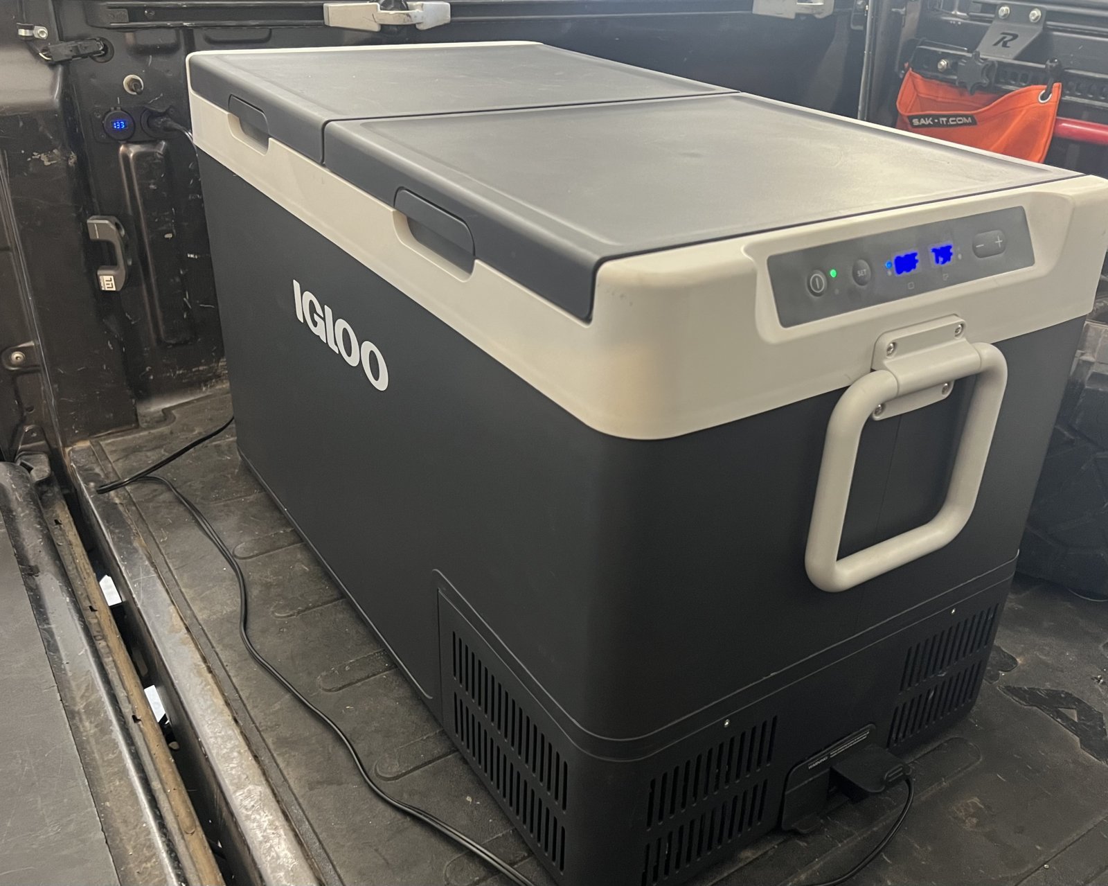

    Alot of them
    I love bed power lol.

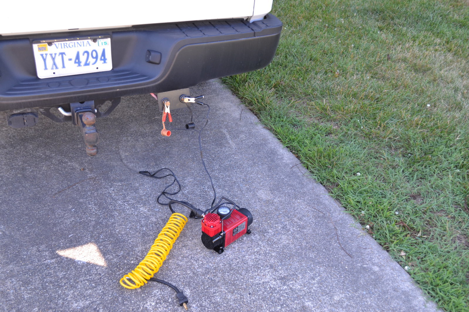

    I added remote battery post years ago, under the bumper. I wish the 7 pin plug would have been available then. Would've been much cheaper. I've since upgraded the air pump. It was fine for the OEM tires, but too slow for 295s.

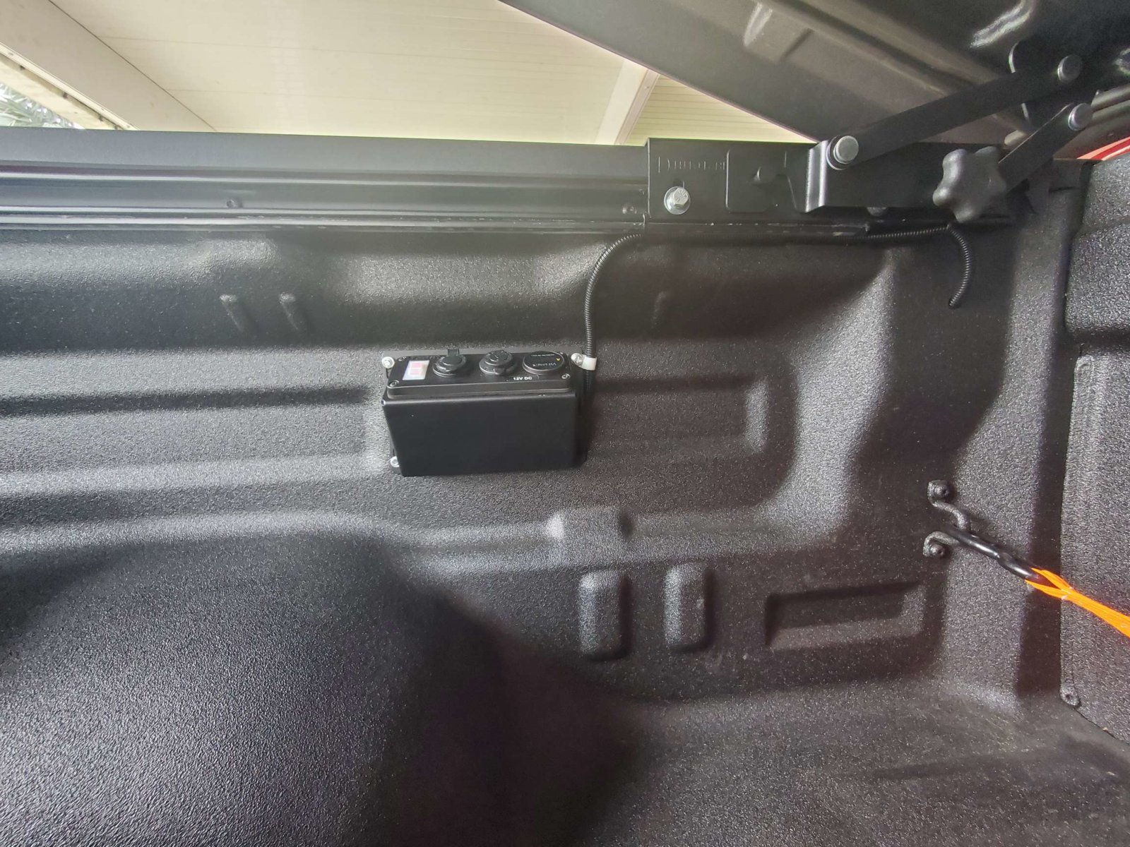

    A few... Definitely more than 2

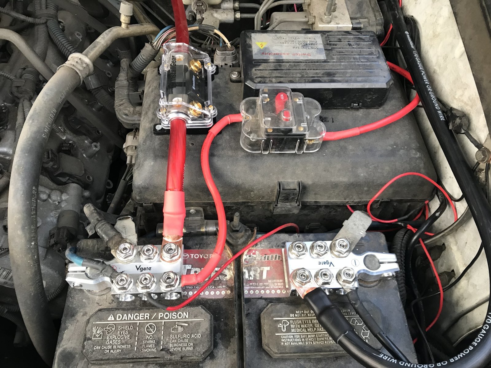

    I’ve done it 0 gauge. But if all you are doing is a compressor it is not really worth the effort.
    My compressor has been updated since this picture and technically I think it could trip the 40 amp trailer plug in the right conditions so mine is sorta justified.
