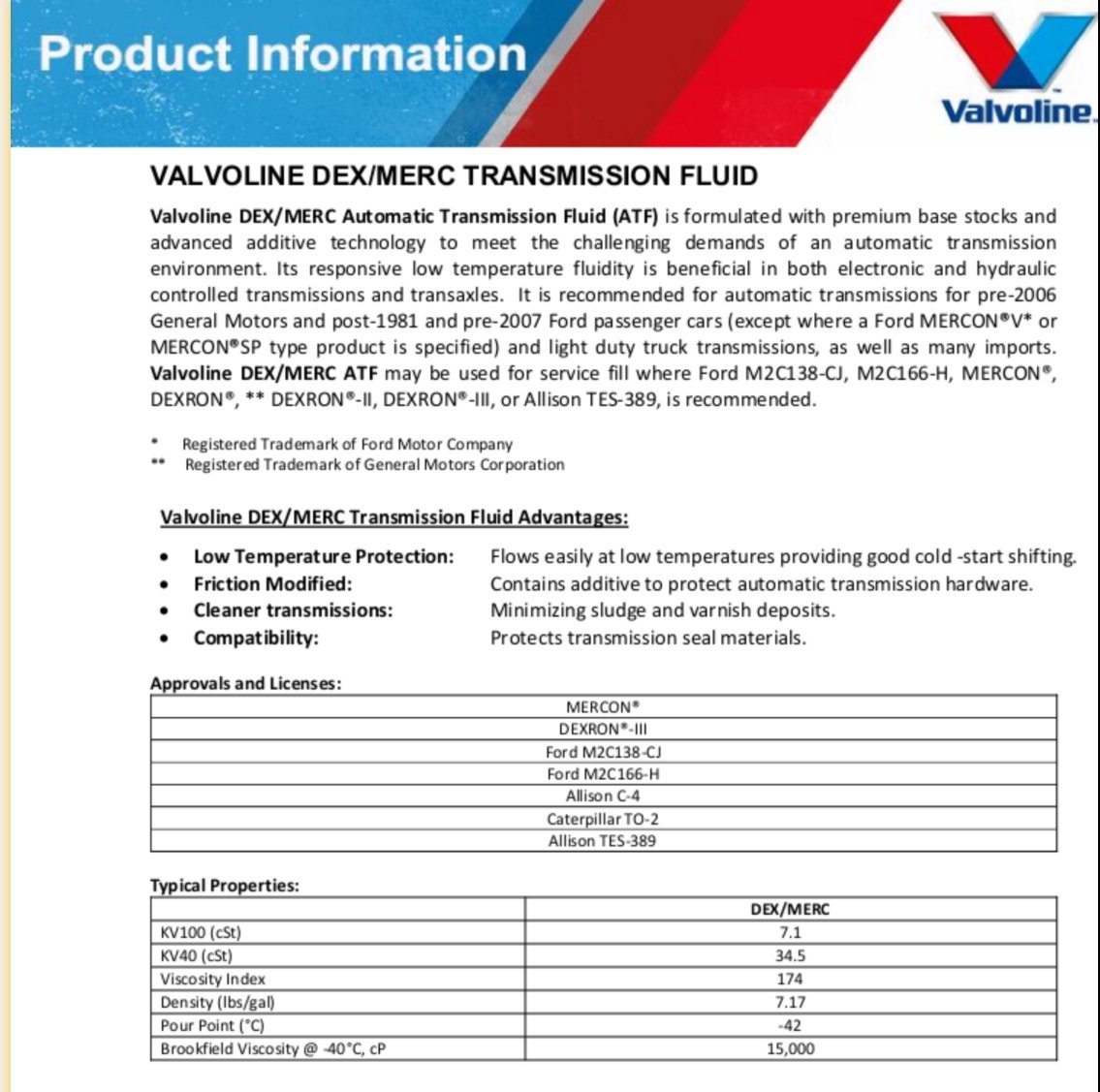

    If I do a drain and fill several times what are the chances that something bad will happen? I just bought a 2002 Tundra with 179,000 miles. I have no clue what kind of fluid in in the tranny. I was going to use Amsoil since I really like using it. I had a friend say not to worry but I read on here that doing that is horrible if you are not using the same fluid.

    Professional Hand Model
    #14878
    14,993
    Fred
    Hand Protectors
    Wally Wurlldd $14. Cheap and meets/exceeds spec. Do multiple drain and fills until your last drain looks like this pouring out.
