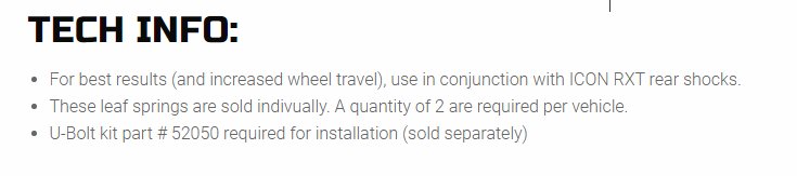

    Figured I'd drop this in here before making a new post. I know the 2 options for aftermarket sway bars are the TRD one and the hellwig one. I know I can make the TRD fit with longer end links for my huge lift in the back and I know hellwig comes with the longer end links already. My question is what is the difference between these 2 options? Both larger then stock but what makes hellwig twice the price? Looking to get new front and rear sway bars so just trying to do research. Thanks guys.

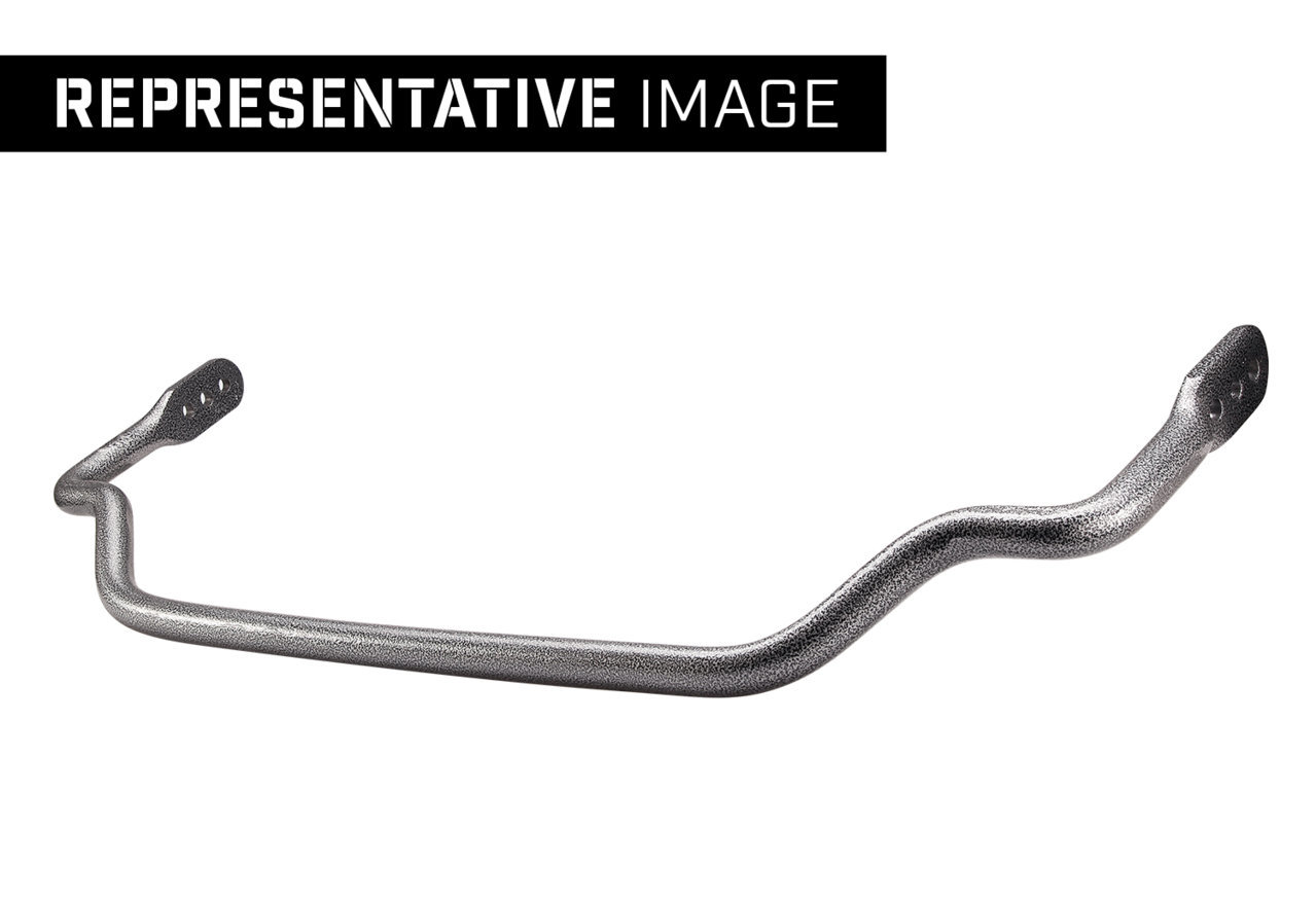

    Adjustable in what way? Not meaning to sound rude, I literally have no idea, I know I'll need longer end links but I thought that was the only adjustment that needed to be made.
  25. Aug 10, 2021 at 12:02 AM
    #175
    Winning8
    Winning8 New Member
    Jul 4, 2019
    #32819
    2,039
    Da Bay Area
    2019 MGM DC 4x4 SR5
    Mumba 18x9 ET 12, BFG KO2, FOX suspension, diamond back HD cover w/ rack, LED head & fog light bulb, TRD rear sway bar, timbren enhancement, RAS helper spring, avs auto shade, Carhartt front seat cover, bench seat cover
    their sway bar rate is adjustable
    closer holes stiffer, holes on end softer
  26. Aug 10, 2021 at 12:05 AM

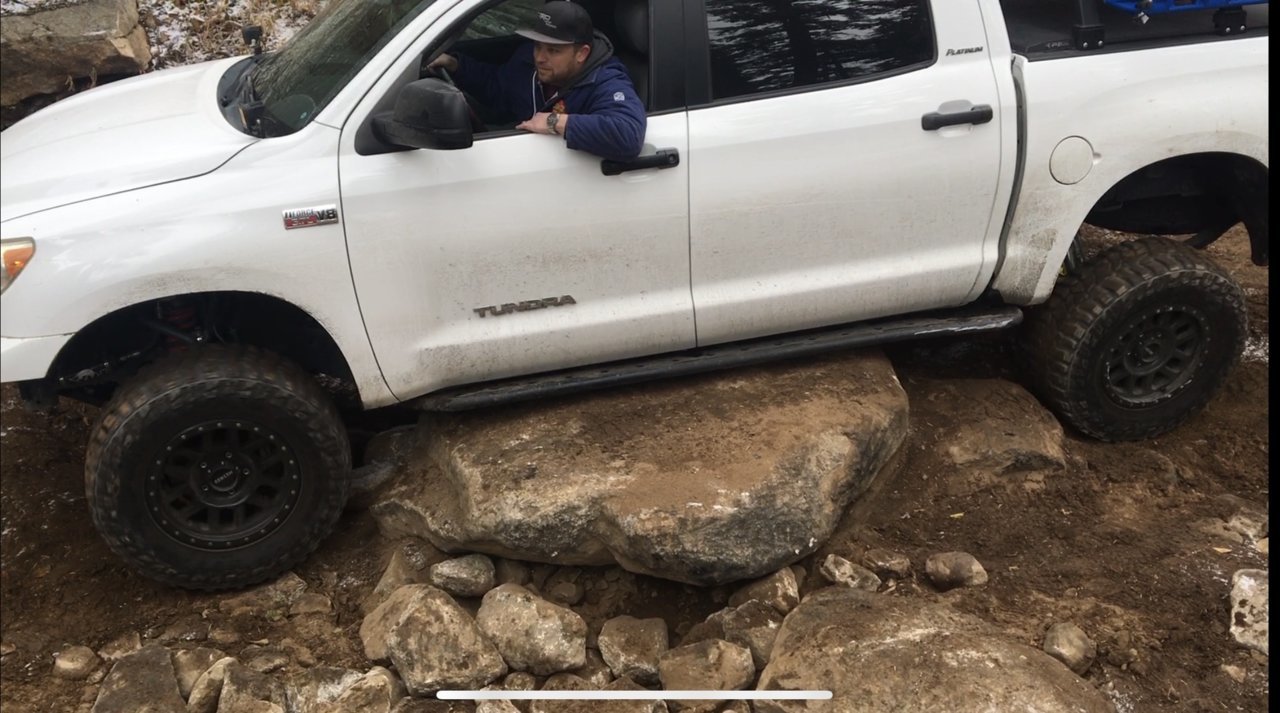

    What makes you want to add in the rear sway bar and beef up the front? Most people that start building a rig as capable as yours take them out to get the most flex out of your suspension. Had one in the rear for a bit when I was driving 70 miles a day across windy mountain roads, but removed it once I added the RXT leaf springs. You will never be able to utilize that leaf pack or your front coilovers with sway bars on your truck.. just my 2 cents and want to make sure you thought about the impact before adding these to your truck.
    I now drive with no sway bars and it takes some getting used to, but the amount of travel it enables is unreal.
    EDIT: RXT full droop with no sway bars, cause I turtled :rofl:
