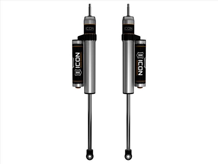

    Coilover part pulls up right part but rear pulls these up and this is not what I have. How would I figure out exactly what I have? I'll look for a part number on them tonight.

    That's what's making me think they bumped me to the 2.5 rr Omega

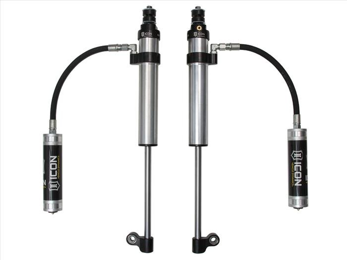

    9072209E-6849-4DF1-A4AD-E317408A5489.jpg This is stage 7 rear shocks, and yours doesn’t look anything like it

    They are not Omega shocks. I'm guessing you received 57720P rear shocks based on the pictures you posted

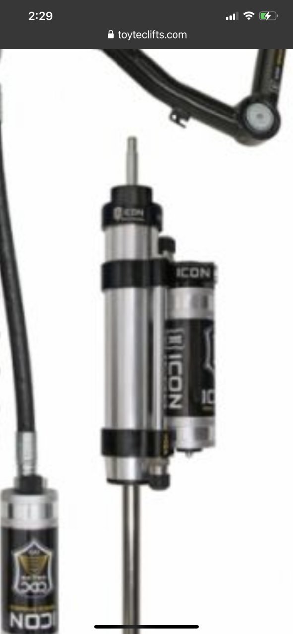

    If not much trouble take a picture of the lower shock mount. If it doesn’t look like this pic then they are not RXT shocks for RXT springs. If they are, your good, RR(remote reservoir), or piggyback(what you got) is no big deal. Idiots still installed the reservoir in wrong orientation, so don’t expect much obviously.

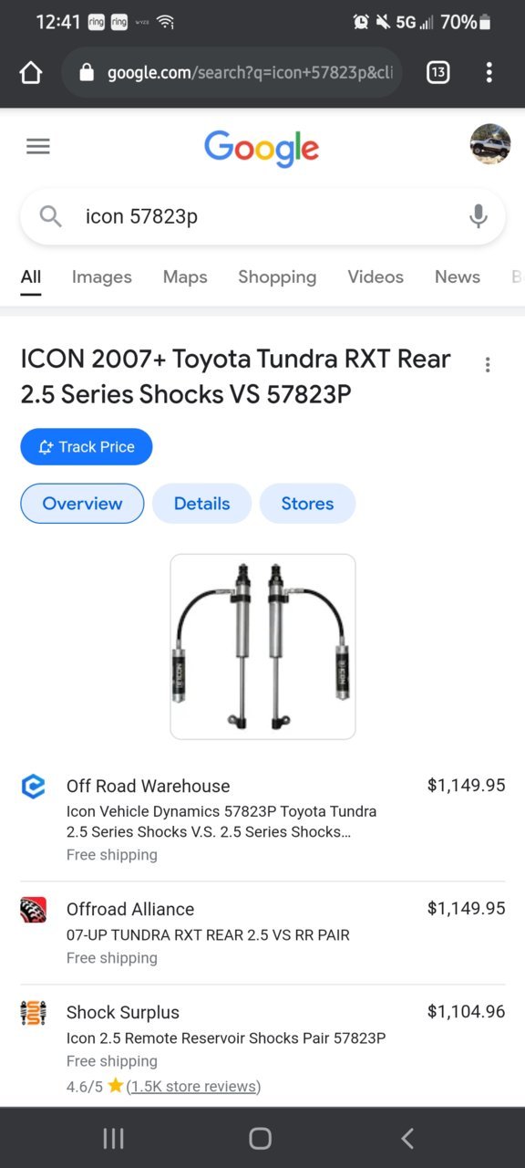

    07-UP TUNDRA RXT REAR 2.5 VS RR PAIR
    SKU :57823P
    Price :$ 1207.45
    FEATURES & BENEFITS
    • ICON’s internal “Bump Zone” increases damping by 20% to provide more control as the shock approaches full compression
    • PTFE lined spherical bearings and application specific mounting hardware
    • Adjustable coilovers provide 2.25-3.5” of front lift height
    • 6061 aircraft grade aluminum CNC machined components
    • One-piece impact extruded aluminum cylinders offer excellent corrosion resistance and consistent finish
    • Remote reservoir design improves heat dissipation to reduce shock fade during prolonged use
    • Premium grade 5WT shock oil for consistent suspension damping along a wide temperature range
    • Nitrogen charged monotube design with remote reservoir
    • Double-sealed Schrader caps reduce risk of damage
    • One piece digressive piston design with vehicle specific valving for unsurpassed performance and ride quality on and off-road
    • 7/8” diameter induction hardened, chrome plated shock shaftS
    • 100% Rebuildable
    • 100% Revalveable
    SKU :57721P-CB
    Price :$ 1081.45
    FEATURES & BENEFITS
    • Polyurethane bushings, zinc plated sleeves, and forged steel mounting stems for OE factory type fitment
    • Nitrogen charged monotube design with piggyback reservoir
    • 100% Rebuildable
    • 100% Revalveable
    • All ICON 2.5 Series Piggyback and Remote Reservoir shocks can be upgraded to ICON’s Compression Damping Control Valve (CDCV)

    From their web, it looks like they have similar construction, but it don’t say there’s a difference in valving. But definitely RXT is more expensive

    I don’t trust Icon options/availability from internet searches. They do secret squirrel stuff, one of my friends ran Icon stage 1,000. Lol.
    If your shocks bottom mount doesn’t look like that, you are not using the full travel available with the RXT. :notsure:

    Yeah, more expensive but could just be that the resi is separated and more parts equals more money. I think I'll just keep these and not use this place again. Shame because if they had taken care of me I already had plans to get the rear end redone on my 4runner and I had them quote me on rims, tires, and regear for the Tundra. If he had said flat out, hey we can't get the RXT shocks for months, I can get you these for slightly less and I talked with icon and they told me they are very similar shocks and will work I would have been completely happy CHOOSING these and been set. It's the fact that they tried to slip it past me and didn't know my friends (you guys) would know the difference.
