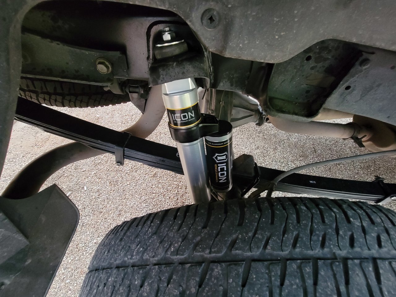

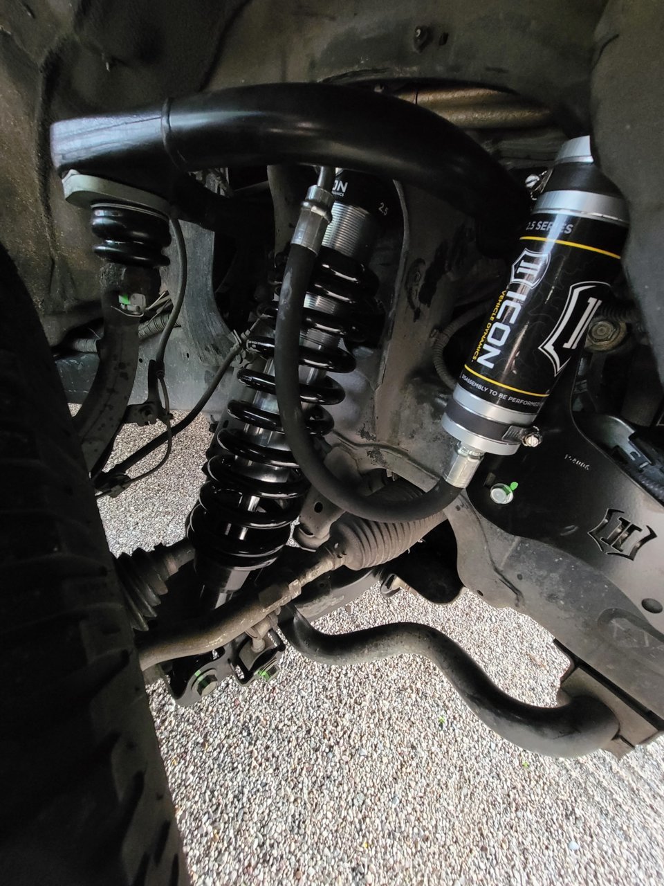

    @TucsonTundra1794 Looks like the reservoir on the rear shock in the 3rd pic is clocked wrong. Should be behind the shock on the passenger side and in front driver side so it doesn’t hit the axle housing.
    https://images.iconfigurators.app/pdf/Icon_Dynamics/I57720P_REVA.pdf

    Good to know! I'll inspect and call them if needed. I already asked if I could just grab the parts and do it myself and he said no he wants to make sure everything is torqued properly... bs but whatever.

    After reading the instructions and looking at the truck they did indeed put the resi on the wrong side. I'll be bringing that up Wednesday as well. Thanks guys! I knew something was off but i would have never knows about the shock position.

    If I wanted to just deal with this myself, how difficult would it be to turn the rear shocks myself? Could I just rotate them or do I need to unbolt them and swap them around? I think I'll just do it this weekend if it's easy I just don't want it to mess with the warranty they have through the installer.

    should unbolt the bottom and spin it around, also need a jack and ply bay

    Don’t think you need to unbolt the bottom, can loosen the top mount and rotate the shock body to proper position unless they are left and right specific.

    ill try spinning them before removing the bottom bolt. i just wasnt sure if i would damage anything by trying to spin them with my hand

    Oops, I forgot the shocks body is on top…lol

    The shock appears to spin with some force, could I just spin them in place and not unscrew anything?

    Wouldn’t hurt to loosen the top nut a little. It will relieve tension on the bushing

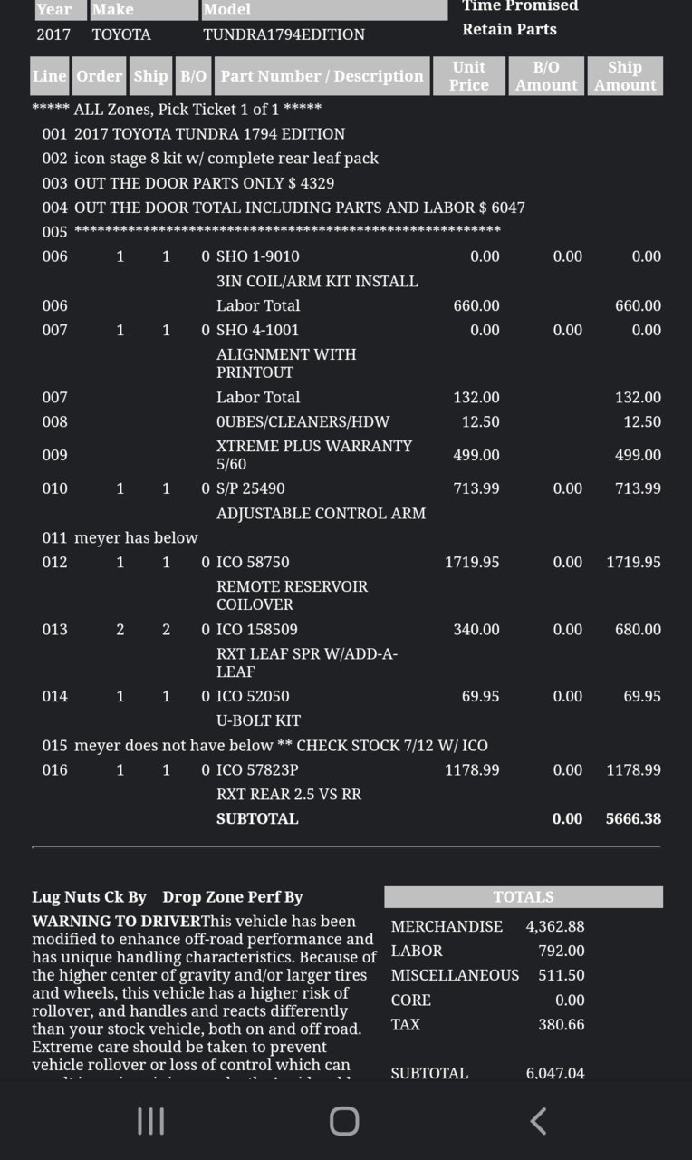

    Alright, I'm starting to look deeper into what exactly is installed on my truck. Can someone tell me which 2.5 shocks these are? They don't look like the ones in the stage 8 kit.
    D4x4TRD likes this.

    Da Bay Area
    2019 MGM DC 4x4 SR5
    Mumba 18x9 ET 12, BFG KO2, FOX suspension, diamond back HD cover w/ rack, LED head & fog light bulb, TRD rear sway bar, timbren enhancement, RAS helper spring, avs auto shade, Carhartt front seat cover, bench seat cover
    Looks like stage 6

    Yeah those are the piggyback, not RXT. WTF did the shop do to your truck?!?

    I was leaning more towards stage 7 2.5 RR CDCV with 2.5 RR OMEGA in the rear. Which I assume is better then the 2.5 in the 8.

    I think it’s a stage 4 with RXT
    Stage 7 is adjustable shocks both front and rear…

    What's the difference between what I have and what it should be?

    This is my invoice, I'll pull part numbers when I get off work. To busy now

    Might wanna nuke or crop that screenshot to get your info off there

    go check item number with ur list, and those kit don't include any carrier bearing drop or TC drop. I know the rear shock look like stage 5 or 6, stage 7 have 2 adjuster between shock and reservoir, stage 8 rear shock have remote reservoir with 7/8 shaft.

    Those are not Omega rears. The Omega shocks have bypass tubes
    The part number for the rear shocks on your invoice is correct but it's not what you have installed. They should not be piggyback shocks
