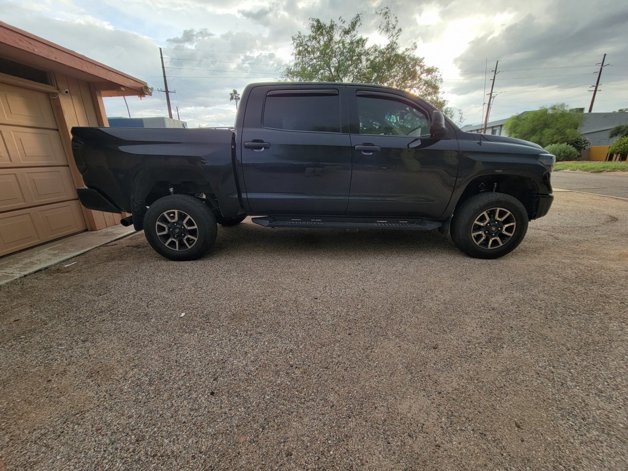

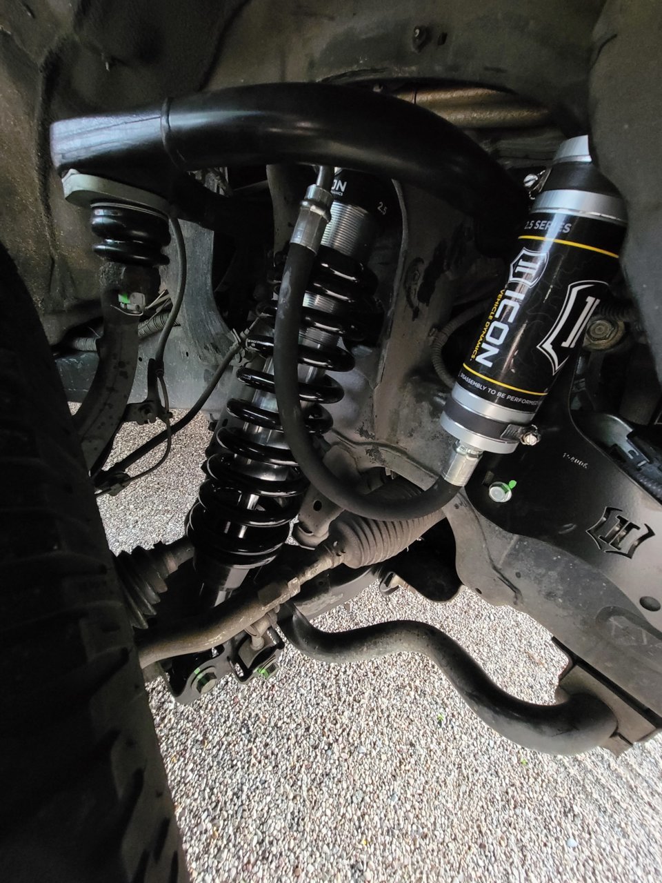

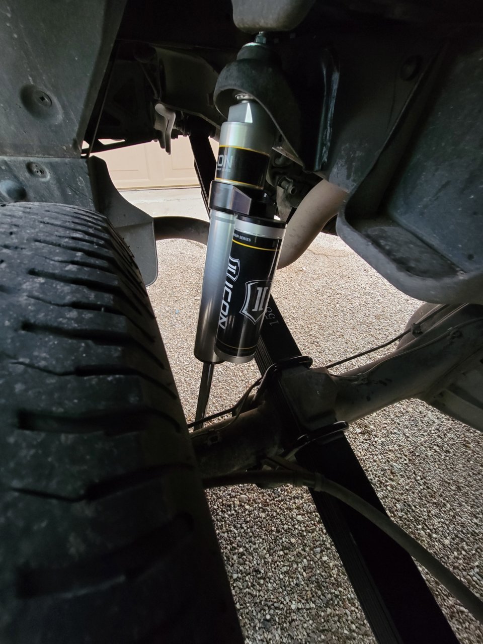

    Figured I'd update this thread too since you guys helped me so much. Got the kit installed. Icon stage 8 with 2.5 coilovers in the front and 2.5 resi shocks in the rear with full RTX leaf swap and SPC UCAs to finish the package. I think it looks amazing. I like rake and this has more then I thought it would but I'm ok with it. I was at 39" from the ground before lift and haven't measured the new lift yet.
    D4x4TRD, SC_TRD and TRDFerguson like this.
