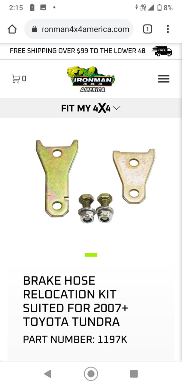

    You might want to add a rear brake line relocate kit, cheap insurance when it droops.

  24. Jul 10, 2021 at 12:11 PM
    #54
    TucsonTundra1794
    TucsonTundra1794 [OP] ASCM #6-11 I'll buy if you're willing to ship
    Mar 8, 2021
    #60155
    2,995
    Anthony
    Tucson, AZ
    2023 1794 Edition TRD Package
    These?
  25. Jul 10, 2021 at 12:14 PM
    #55
    2mchfun
    Dec 31, 2020
    #56879
    6,971
    Dan
    Nope, google OME Tundra rear brake line relocate kit

  27. Jul 10, 2021 at 12:22 PM
    #57
    TucsonTundra1794
    Mar 8, 2021
    #60155
    2,995
    Anthony
    Tucson, AZ
    They had those on the Toytec site too I thought they were the same thing. I'll order them
