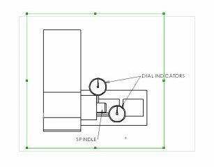

    Probably a dial indicator, like this.

    Each tic mark on the dial is .001".
