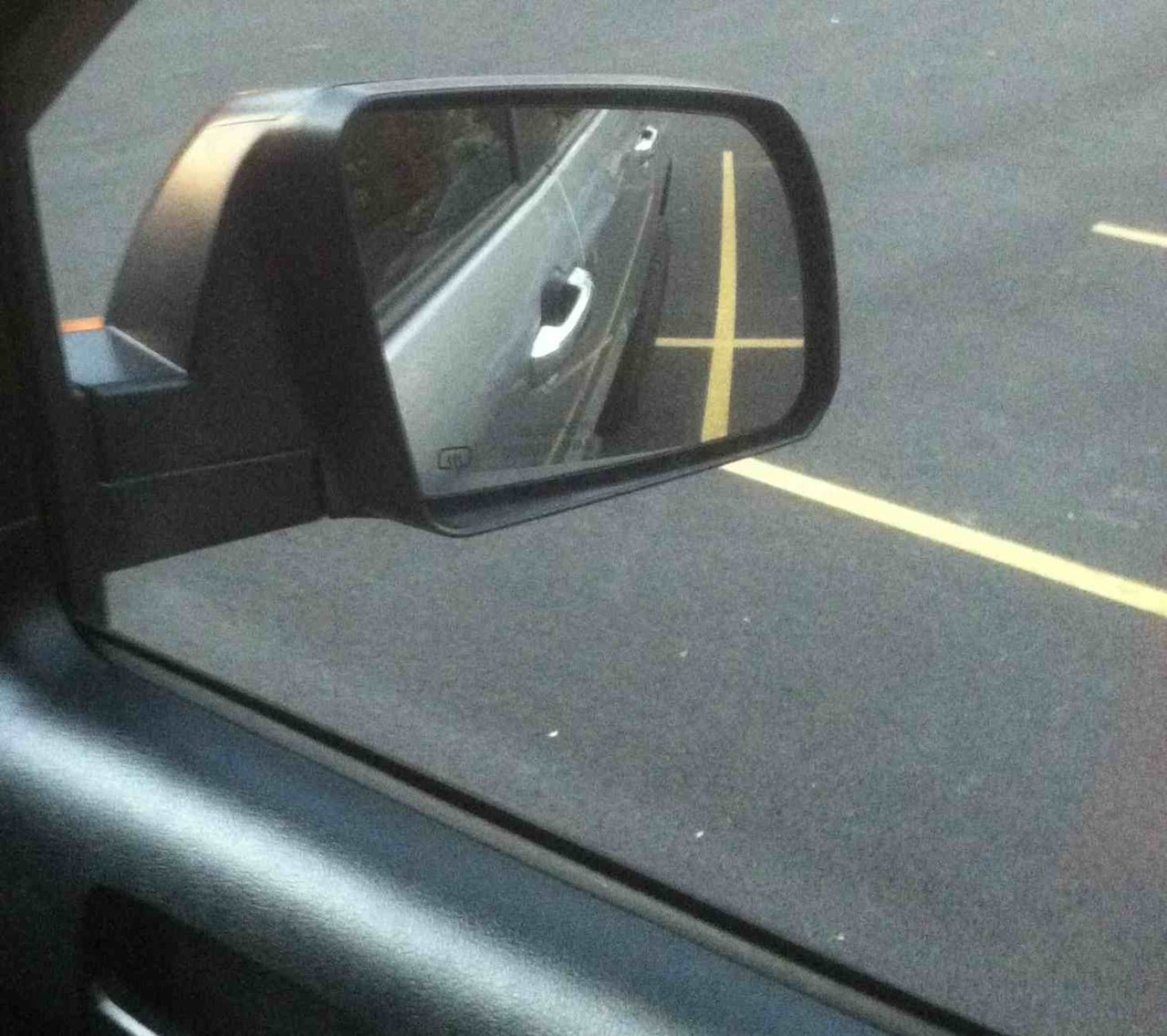

    If you want your tires to poke out beyond the fender, you will either have to get a set of after-market wheels or use wheel spacers.
    If you decide to go with after-market wheels, get something like 18x9 with 30-35 mm offset. That will make the tires poke out a bit. Lower offset wheel will push out more. For reference, here is mine (18x9 18 mm offset with factory tires 275/65/18). Don't get 18 mm unless you are planning to get some fender flares.
