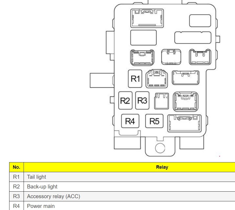

    So was 62 blown? R3 looks like a relay

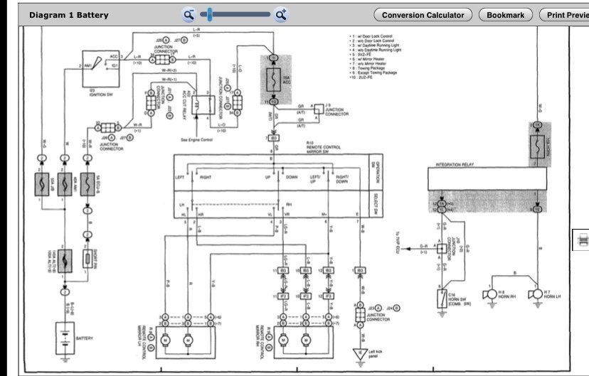

    So at this point we are only diagnosing your side mirrors not working? Everything else is good I’m trying to make sense of all the post I still don’t know what cab configuration you have extended cab and crew cab have different wiring schematic

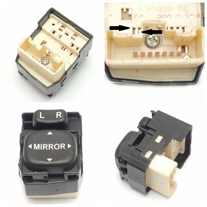

    that’s the side mirror wiring schematic, it’s easy to see if the pin pushed back that’s very hard to happen I never seen it happen. That number 62 has a clear top so you can see if the fuse is burnt

    Thanks man, don't know where you find these, but thank you for them. Well that fuse is terminal is not pushed in. And if I use the little tester that came in the fuse case I bought, it shows good. However, if I use a single pole that is ground to the frame, it is the only one that does not show working. I am at a point where I may just take it in and pay the outrageous price to have it fixed. What pisses me off is that I created this issue, by looking for a rear window issue that wasn't. grrrr...

    So I have been shown this several times. Saying this is the R3 I need to check. But I have nothing like this, unless it is hidden somewhere. And apparently the R3 that I changed(under the hood) could have been a EFI.. lol

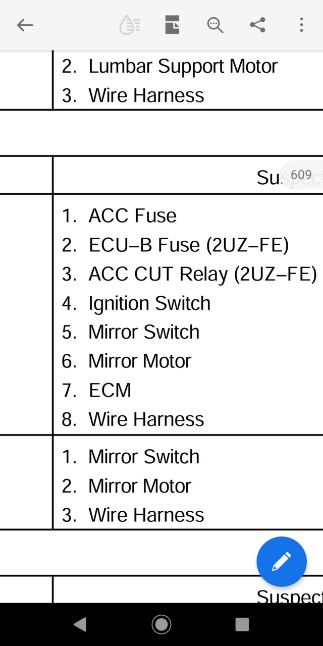

    Here is what the fsm show to check for mirrors not working.

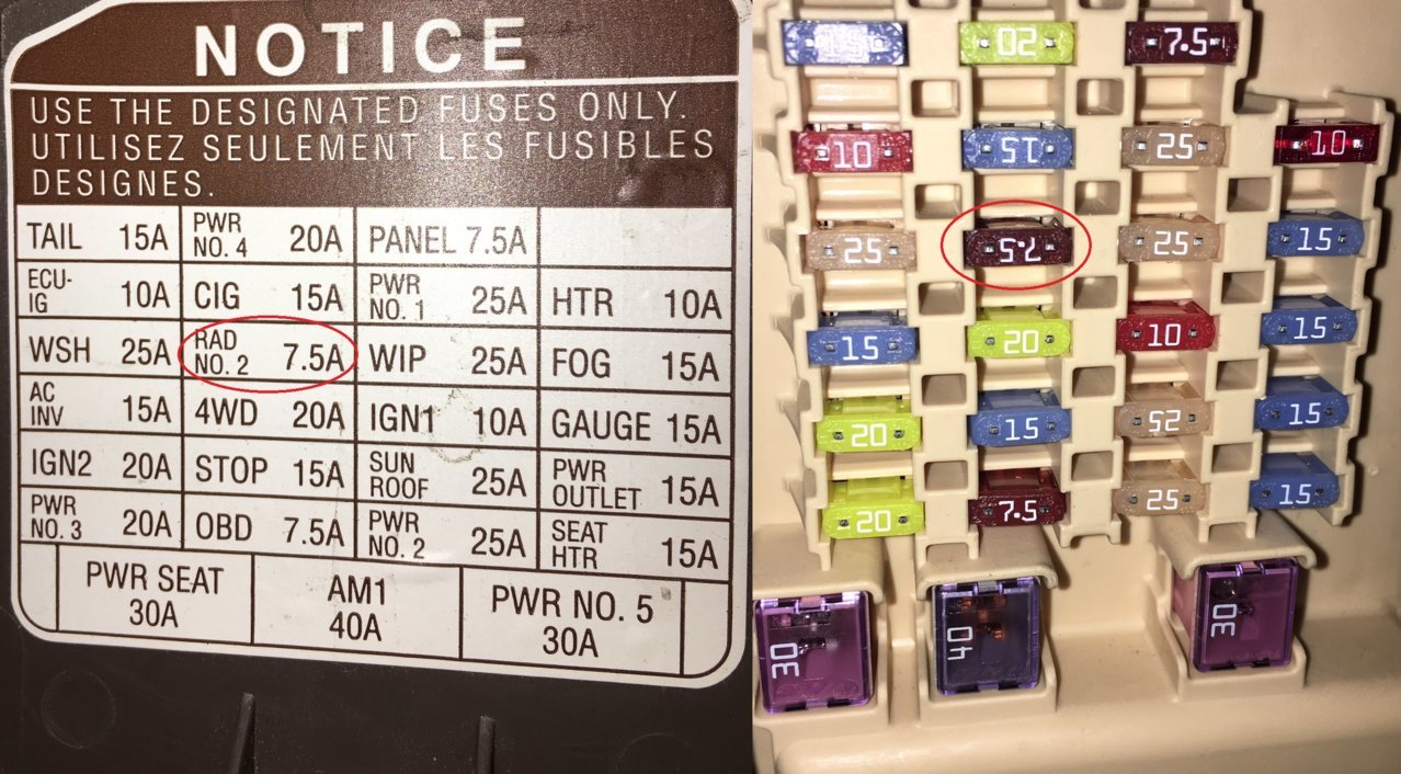

    The reason I ask is because when you've been giving #'s, your #22 you mention in OUR owners manual 2004 DC, is labeled as #52(PWR OUTLET 15 A: Power outlets). The reason I mention that is because in following it appears these pictures you are posting is not the same as OUR owners manual ?
    The below is from the OwnersManual for 2004 DC and if you look on pg 454-459, it gives pictorial of what we are dealing with. If those numbers are used it might help.

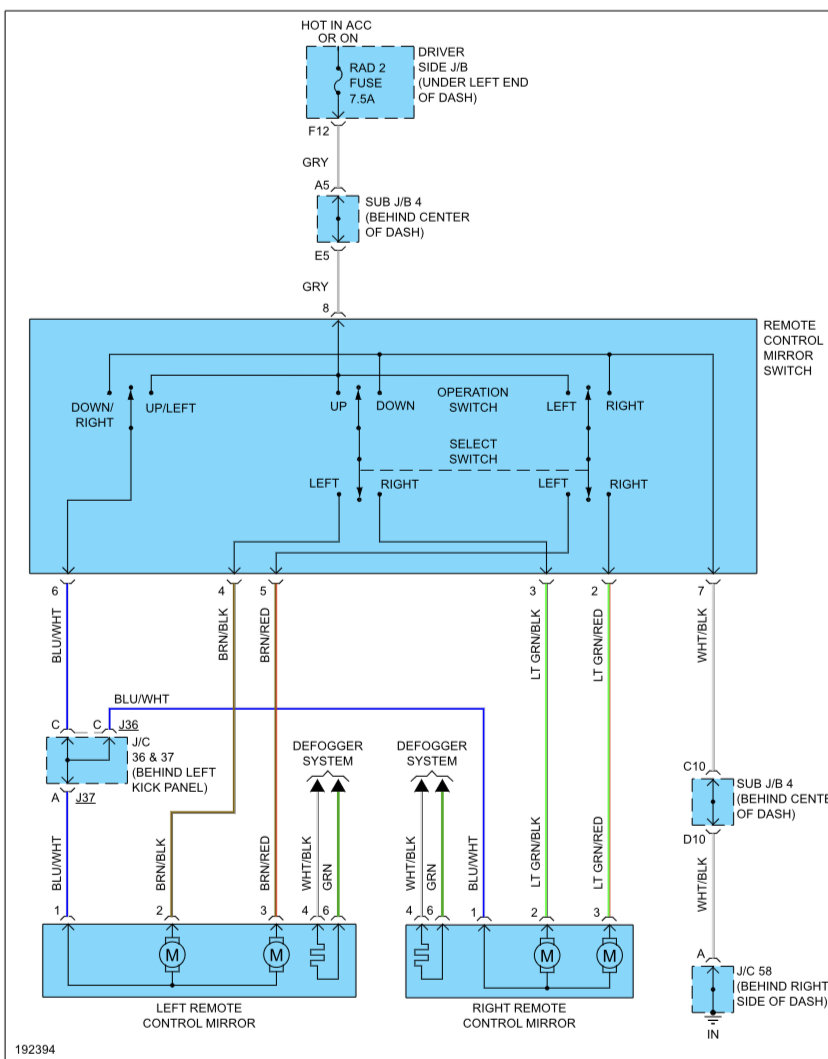

    this is more clear. And it’s showing F12 7.5A fuse to be the Mirror power

    For some reason the #'s I found online are numbered different, but the #52 is in the same spot as the #22 I was referring to. Going by the owners manual #52 shows it has power using the supplied tester that came in the fuse package, but when I use my single pole tester, it doesn't show any power but does to all the rest.

    Dang, going back out to see if I can find that F12, on the left end of dash. Thank you

    Issued was solved Sunday morning! Thanks everyone.
    ** always check fuses with your own two eyes or one eye, and not rely solely on gadgets.

    Acc fuse??

    #39 Rad 2 7.5A

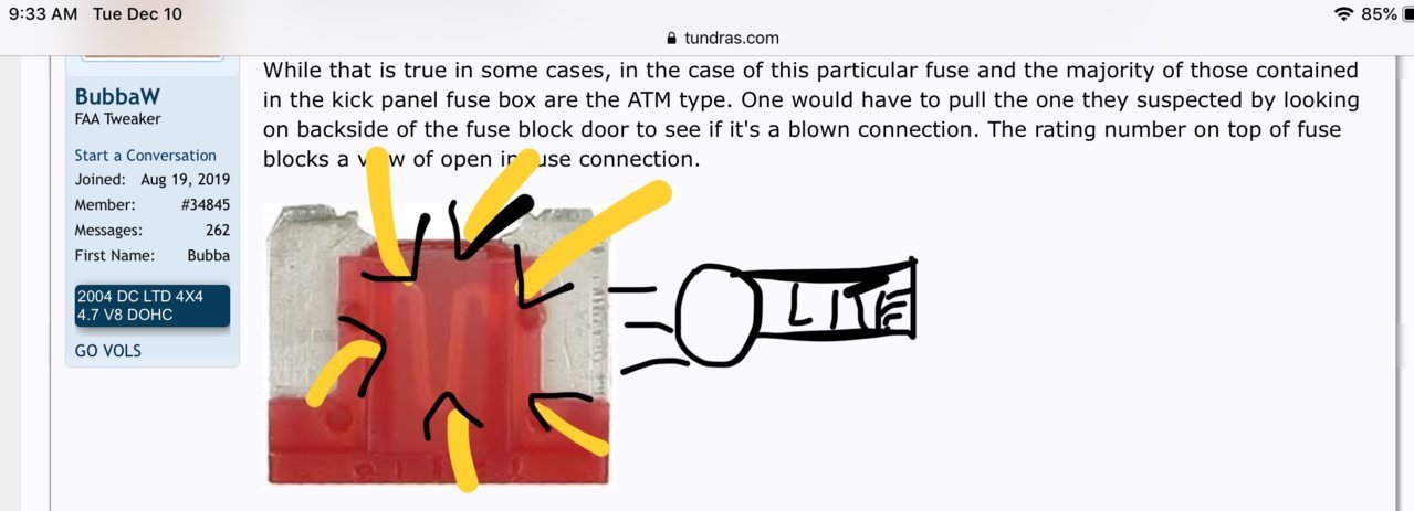

    Glad this problem was figured out. Its a pain to pull the fuses and look at them. I’ve found using a flashlight shone from behind the fuse helps to see if the connection inside is blown. Even with good eyes and daylight its hard to see. The backlight helps contrast things.

    While that is true in some cases, in the case of this particular fuse and the majority of those contained in the kick panel fuse box are the ATM type. One would have to pull the one they suspected by looking on backside of the fuse block door to see if it's a blown connection. The rating number on top of fuse blocks a view of open in fuse connection.

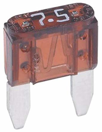

    Is this the OP’s fuse type in question?

    No, I grabbed the wrong one but similar to one blown but for accuracy, it's actually the one below which is from a 2004 like his....Rad 2....7.5A. Had a conversation with him the other day and suggested a few things offline and one suggestion was to pull the little fuses one by one since you can not tell otherwise or from top side and physically see if it was blown. He did and found Rad2 blown.

    The RAD #2, under dash and a 7.5 fuse
