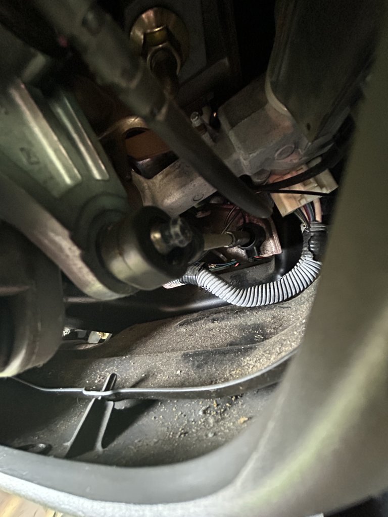

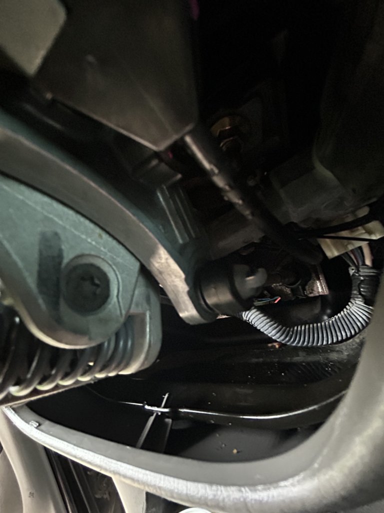

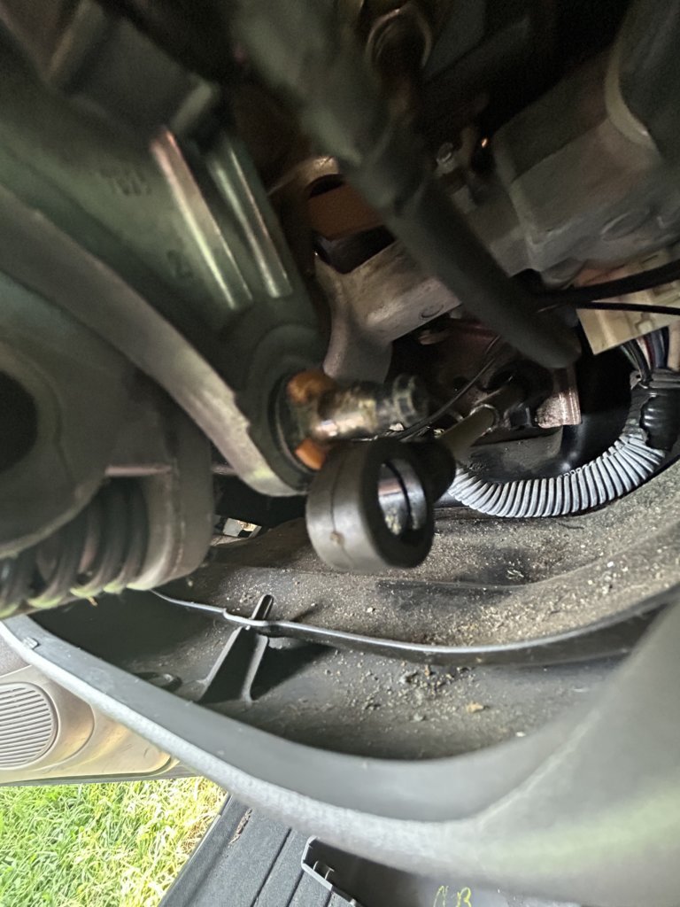

  18. Jul 13, 2025 at 5:50 PM
    #78
    The Black Mamba
    Sep 6, 2023
    #103472
    5,350
    BlackSnek
    Flower Mound, TX
    Black 00 SR5 AC 5VZ PreRunner
    Imma keep it stock
    As @shifty` told me earlier today, I’m an anomaly
    upload_2025-7-13_19-50-38.jpgupload_2025-7-13_19-50-38.jpgupload_2025-7-13_19-50-38.jpgupload_2025-7-13_19-50-38.jpg
