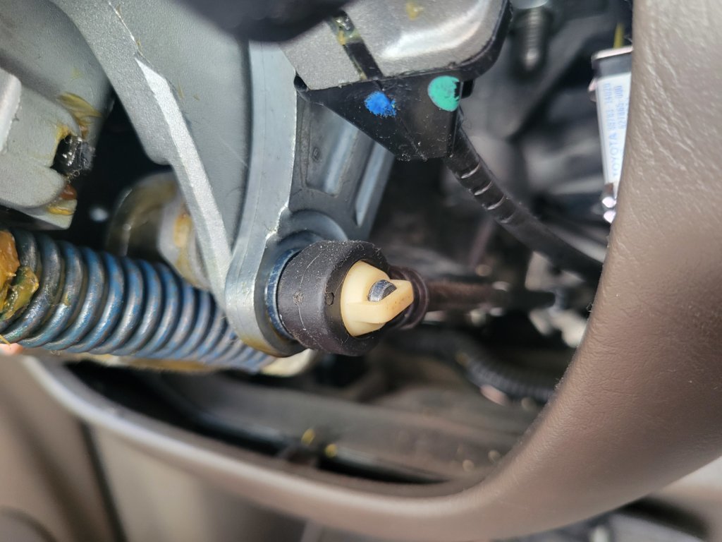

    Today I opened up the steering column on the 2007 Sequoia to have a look at the shifter for comparison. It is factory, and as stated previously, it feels perfect, unlike my 2005 Tundra, which seems loose.
    The factory bushing seems to be in good shape, but otherwise I don't see any difference.
    A few pics and a short video:

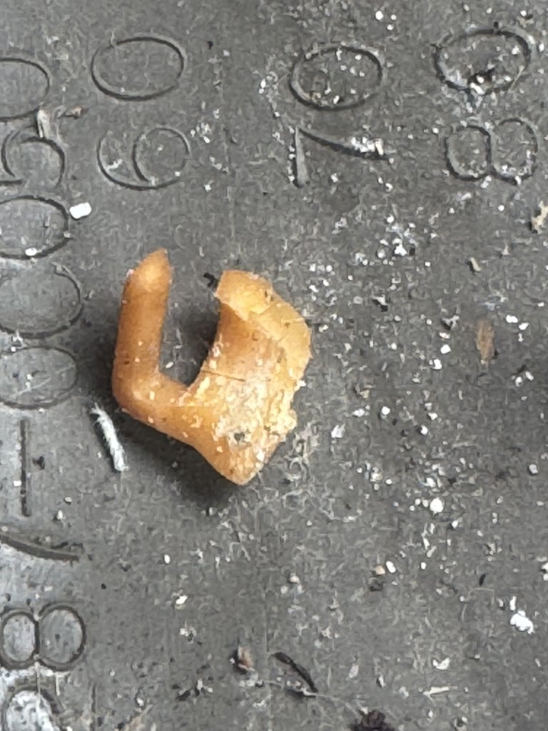

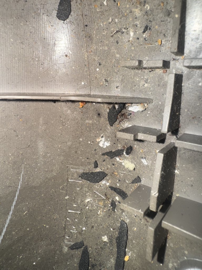

    There was nothing left of mine. The remaining piece was on the bottom of the clamshell and it disintegrated when I picked it up like others reported
    damn mine was nasty under there. Also found a random white clip but can't locate the source
    Also couldn't find the source of those black flakes of plastic on the blinker switch side
    this explains some problems my brother reported when he borrowed my truck early last year before I started the restoration. He was having a hard time getting it in drive at times. I was afraid it was something much more serious. I think The cable must've almost totally come off. It did it to me when I got it back but then I just moved the shifter slowly back-and-forth from park to Drive a few times. and it's worked fine since. Albeit with a lot of play.
    fortunately, the parts store has it in stock, so I don't have to wait for scamazon. I should be able to get it fixed in a few minutes and have time to go back to New Jersey and fly my super duper drone with the new light kit tonight
