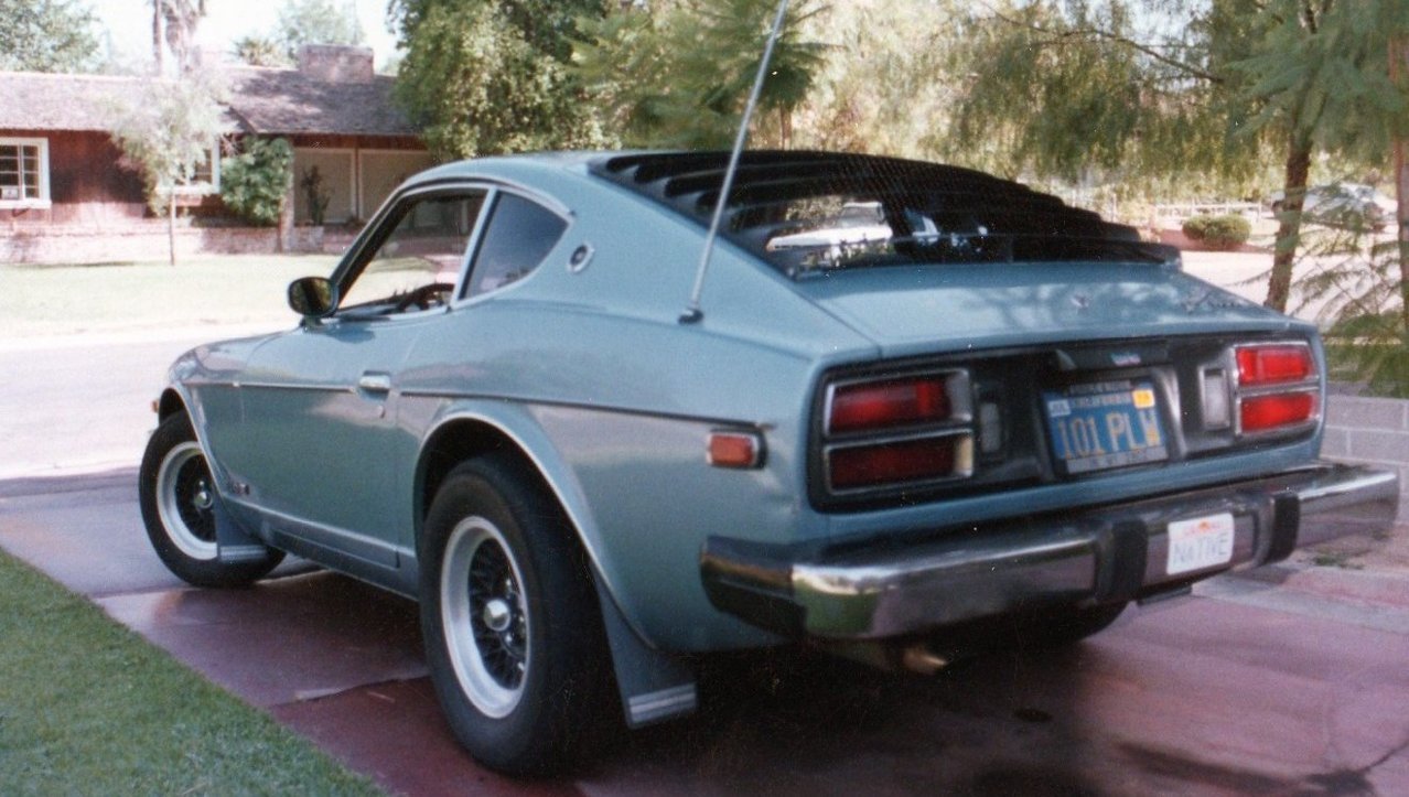

    Truck overall looks great and well thought out. The bumper just turned out fantastic and I think it's the best looking of the style I've seen yet. Great job.
    BTW: Nice Z in the background there. Here's a pic of one of my favorite teenage cars circa ~87 (I grew up mostly street rodding but this was a brief but enjoyable vacation from big V8's).

    Thanks @diableri, I appreciate it. I didn't grow up working on cars and have really enjoyed doing as much work on the truck myself as possible. Really makes you think through the plan and try to do things the right way.
    Nice Z as well there. This one is going to be my 15 year olds first car. It's been a great project for the two of us, learning how to rebuild it and get it running again. Worth the money spent just for the time spent with him working together. Not looking as nice as yours yet, but we're working on it. Amazing what you can learn to do on youtube now.

    That's a lucky young man! Such a great little car and an incredible way to build some father/son experience. Not stupid fast but certainly fast enough to put a smile on most faces. Hope it's a stick! Love the truck, following your build.

    I like the fact that it's a manual that doesn't have power steering. There's no way he can text and drive with that. Also doesn't have a back seat (can't take groups of friends around). It is sporty and fun, but a 40 year old inline six isn't going to get him in too much trouble I hope. But a blast to drive.
    The biggest thing is the father/son experience. We hadn't done much together the last few years. His interests have diverged from mine and he'd rather be off playing a video game than hanging out with me. But now I get home from work and he asks if we can go work on the car together for a few hours. That's worth a lot.
